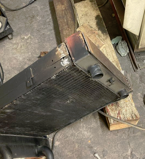

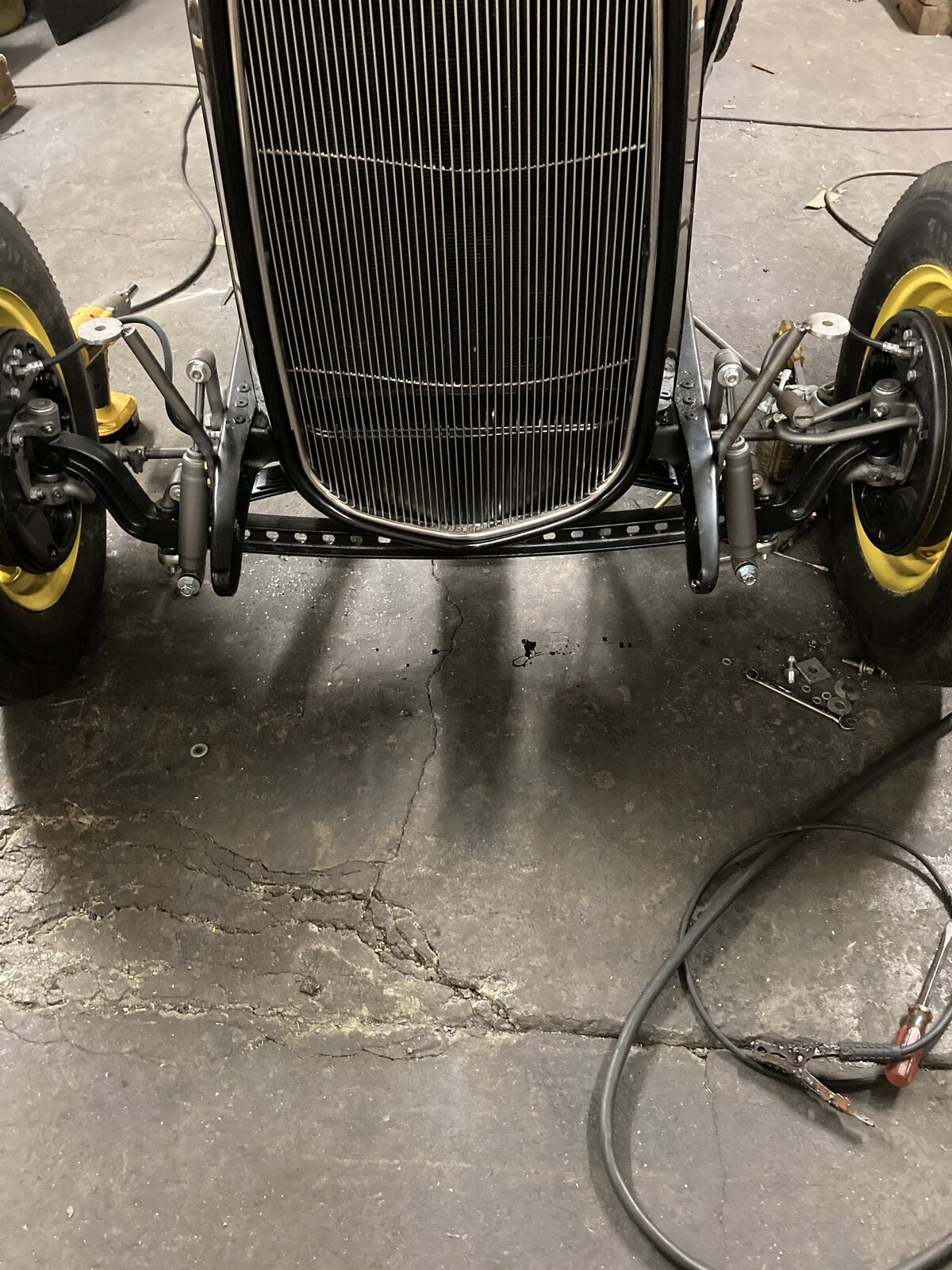

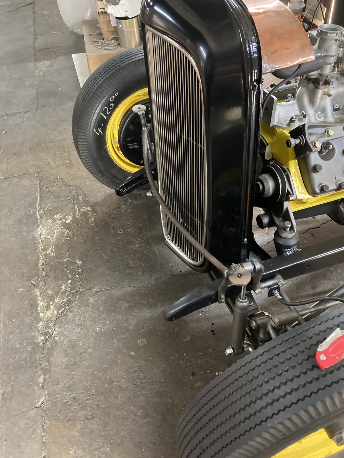

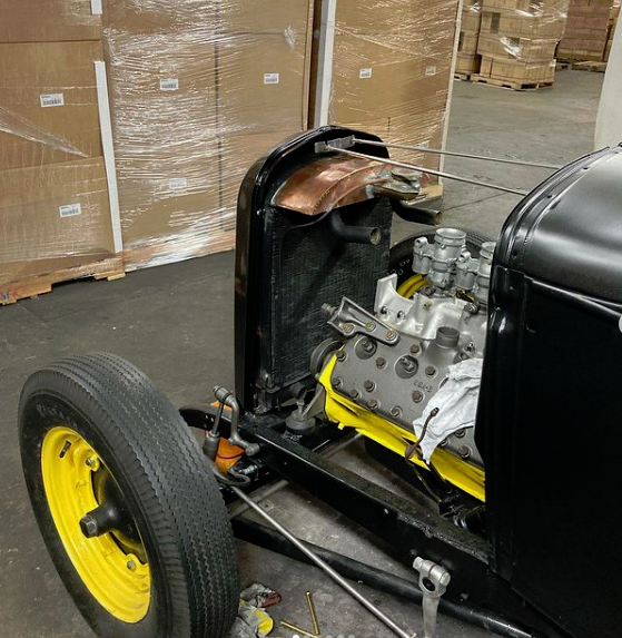

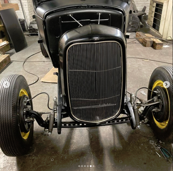

    Still have a TON of tweaking to do to get it all synced together. I wound up using a radiator I picked up a while back with a batch of parts and had to modify the mount brackets. I basically inverted them. I got so excited when it came together in my head, I only got the one pic of the radiator while I was modifying it. Cheapie radiator dimensions are WAY off and it would’ve been more work....I still have some brackets to make, lower the grill some, slot the radiator mount bracket holes some, secure the side pieces and put some compression on them for some rigi***y and a bunch of other things. This radiator HAS been pressure tested and repaired by a reputable radiator shop, so it should be good to go!

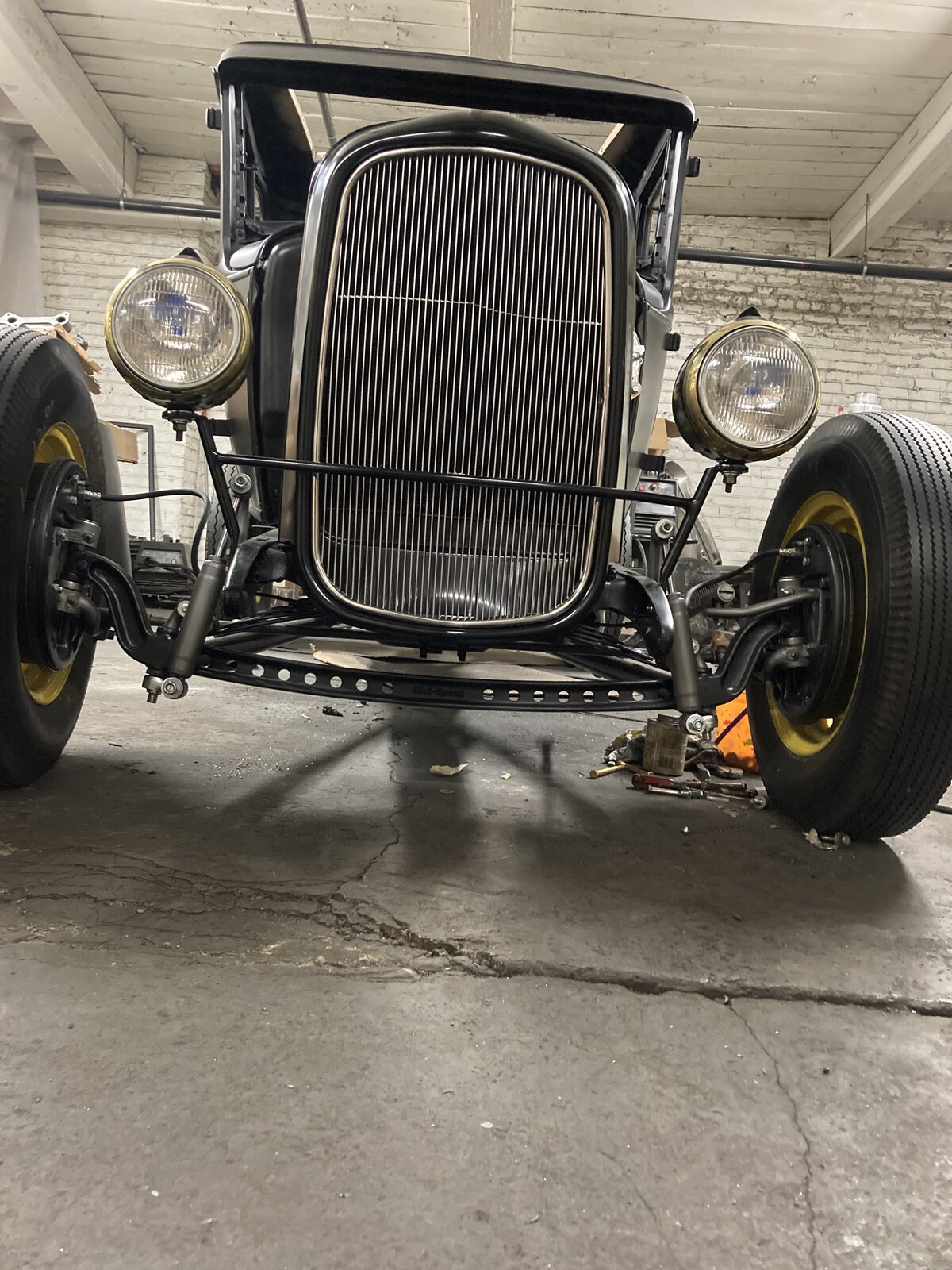

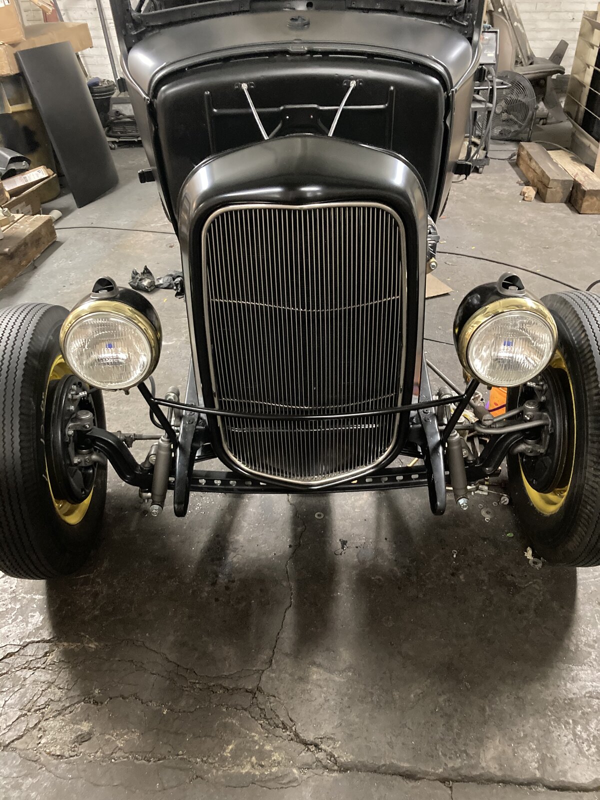

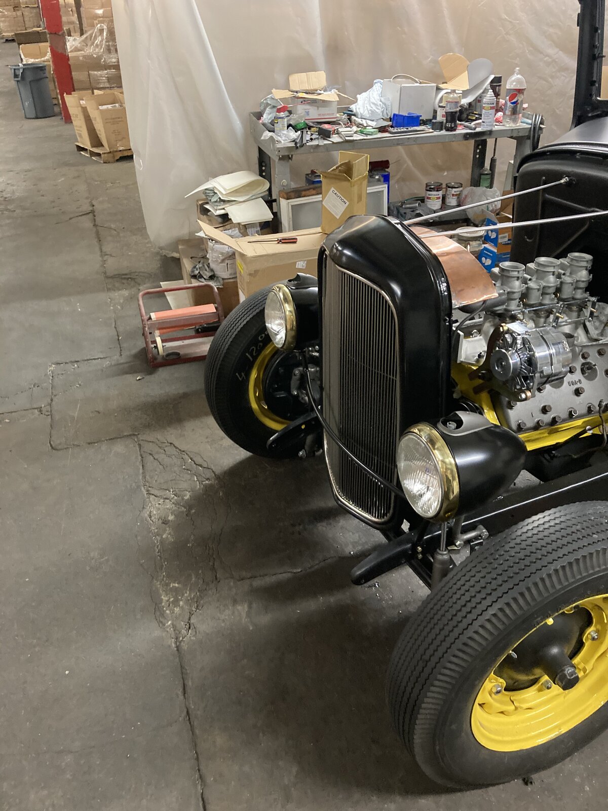

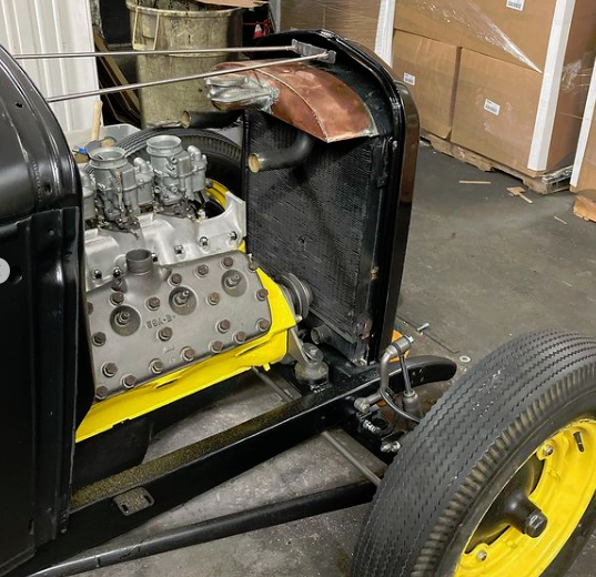

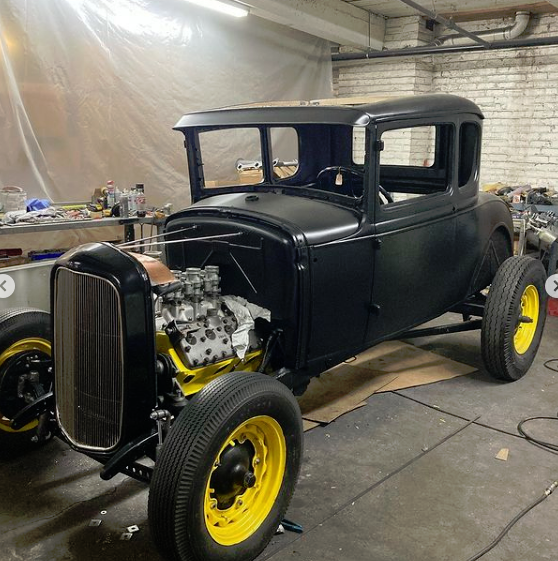

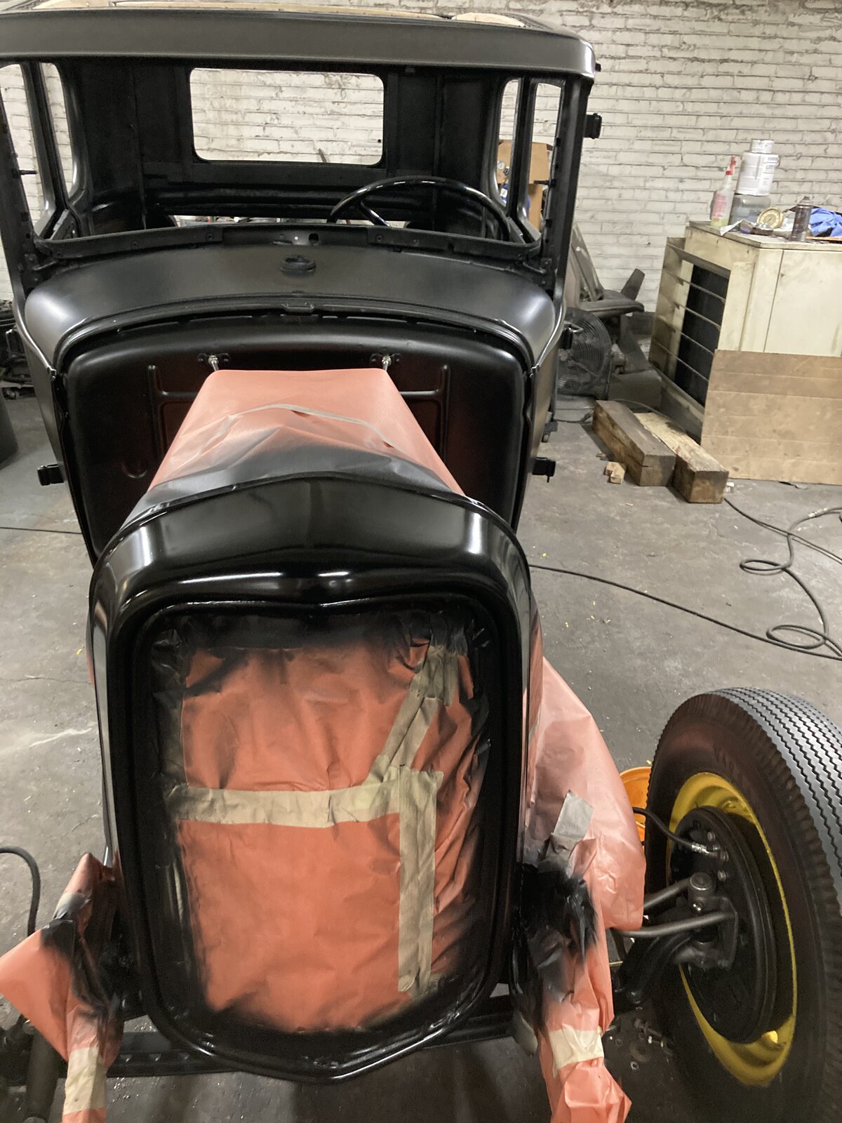

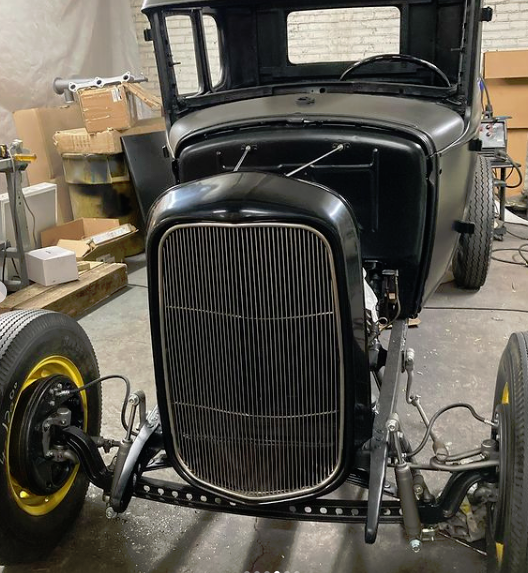

    Just need to make the lower grill shell brackets and I’m callin’ it done! Aside from some paint and a level 1 radiator/grill tidy.....Thanks for lookin" fellas!!

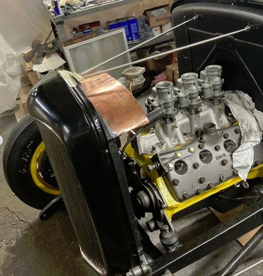

    Gonna have to! This is not the radiator I was gonna use, but cir***stances have dictated it's commission into service.....:D After the modifications needed came into focus and were applied....I kinda like it! I did polish it at one point, but it sat for a while....it comes up awesome when polished!

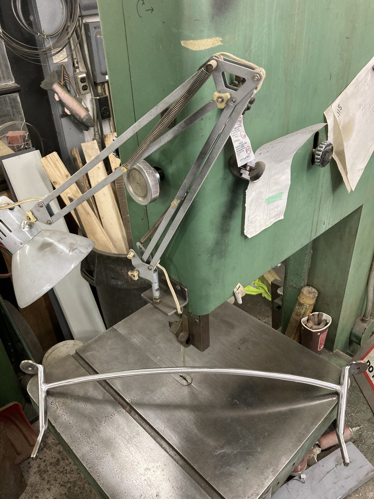

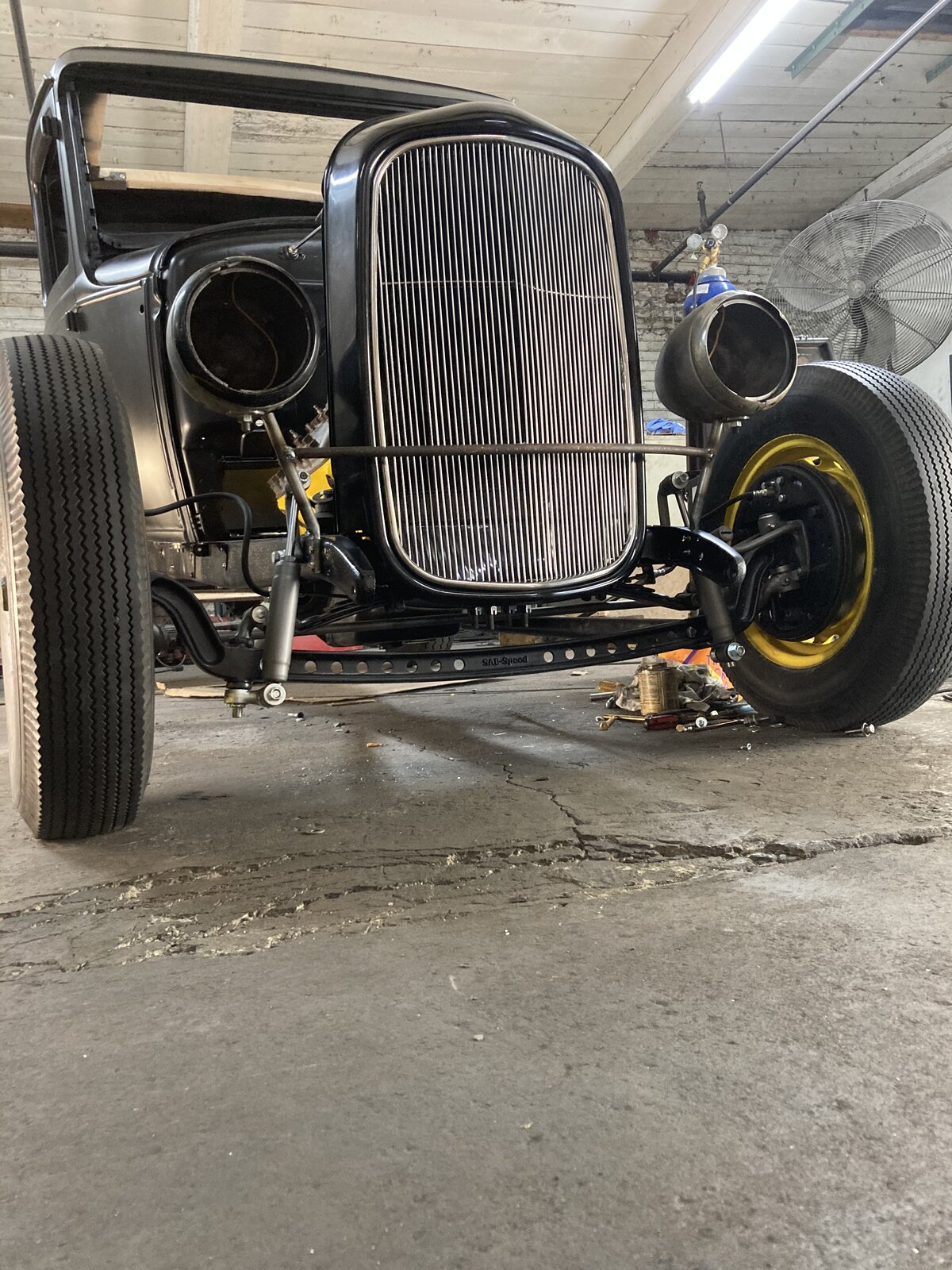

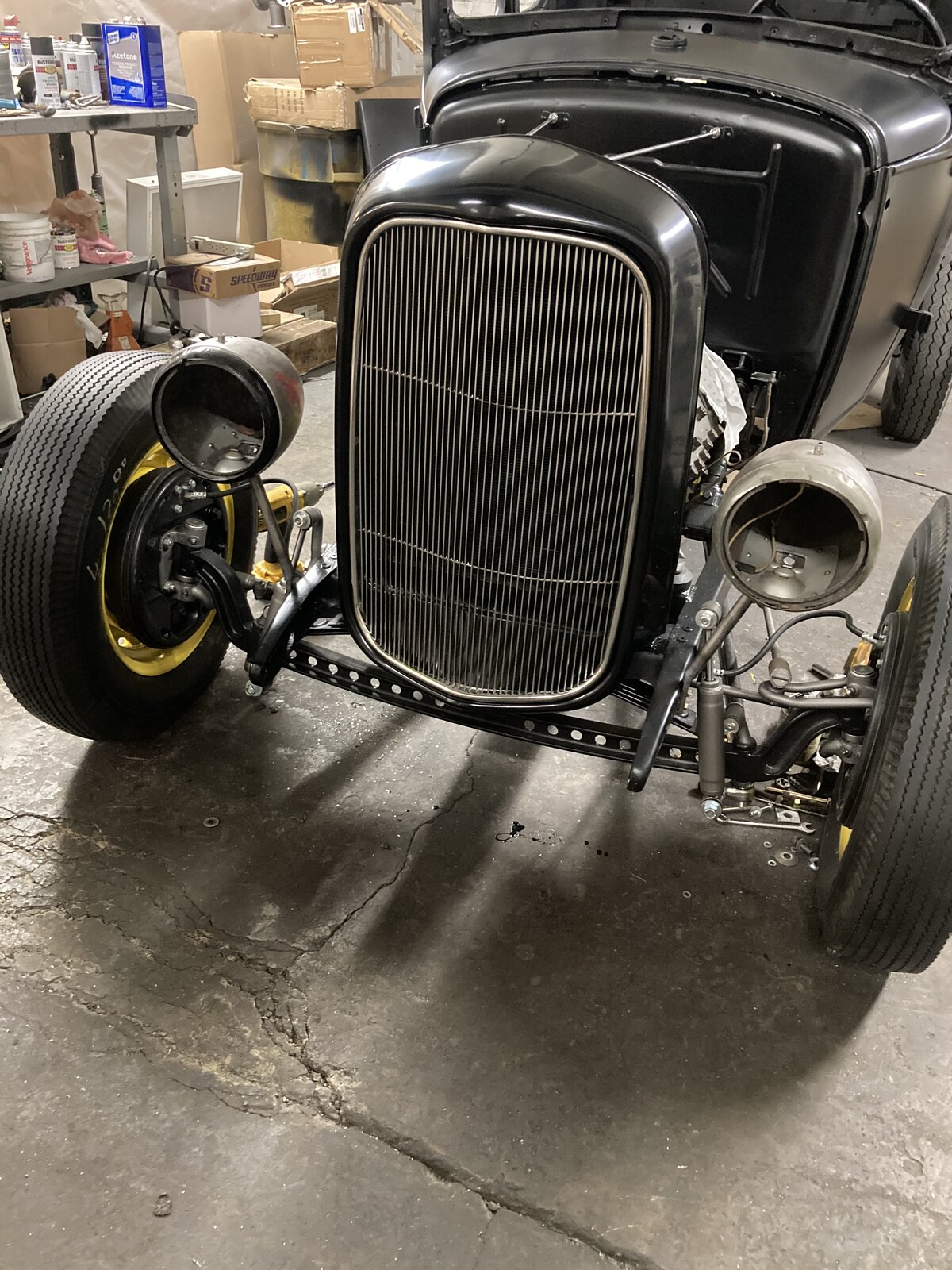

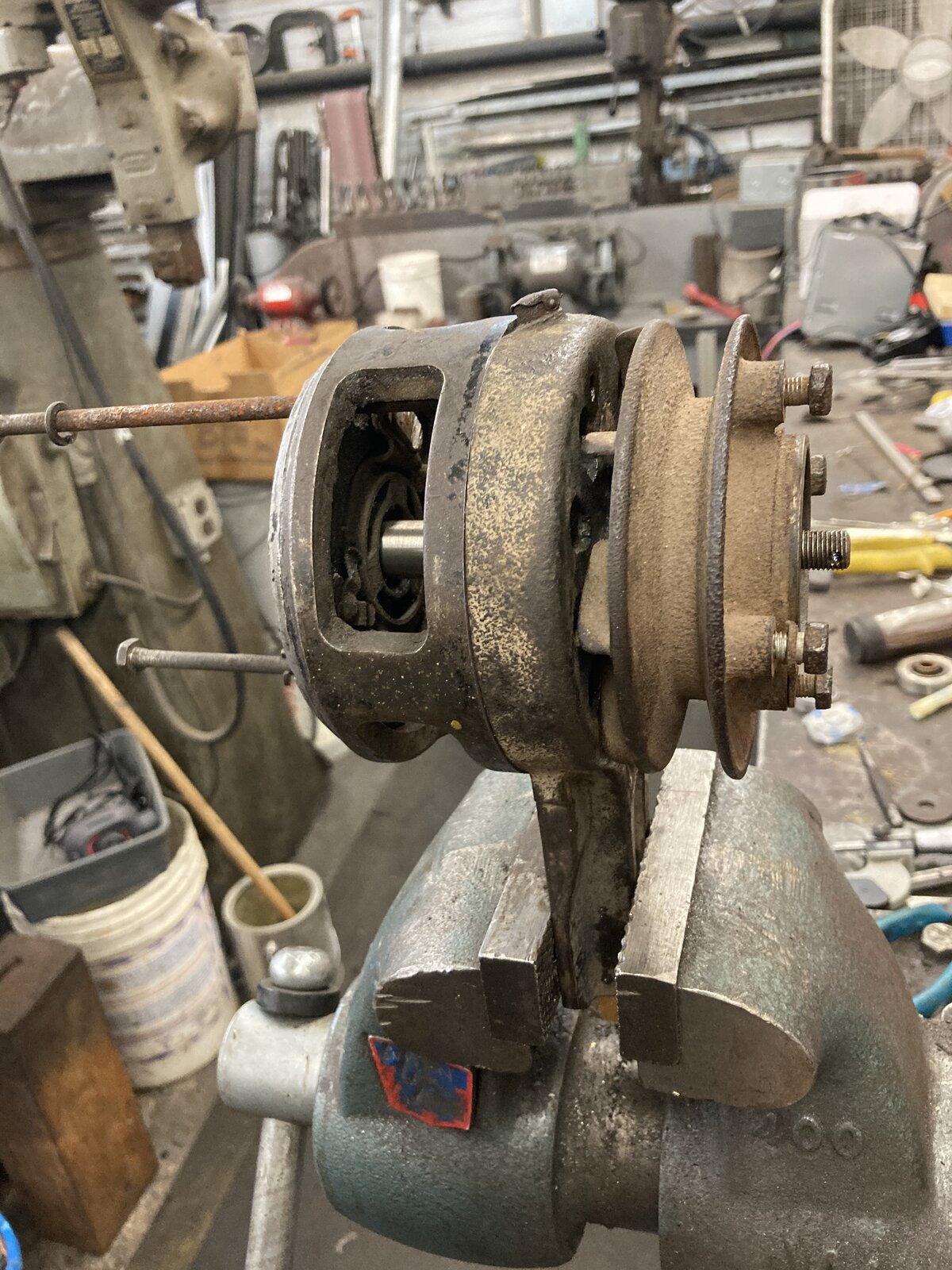

    Headlamp brackets and I’ll be making a crossbar....made an idler too.....can’t use it though so it’ll be going on the block for sale to make my money back.... 2285A5BD-FA7D-4996-9641-3F4DF7CC6729.jpeg D4508BF4-69DE-4E3F-B14D-0DA483FF719C.jpeg 20F49621-00C4-4730-AC92-81DBD56D50CE.jpeg 7E758FB7-AAFE-41DD-95C3-27EDB99B1181.jpeg 259F8F2B-AB05-4956-8D05-526231DD74D1.jpeg 0A421B28-7A1D-4826-B8D9-D876BA23806D.jpeg
    patman, loudbang and guitarguy like this.
  18. Piewagn
    Joined: Mar 25, 2009
    Posts: 1,542
    Piewagn

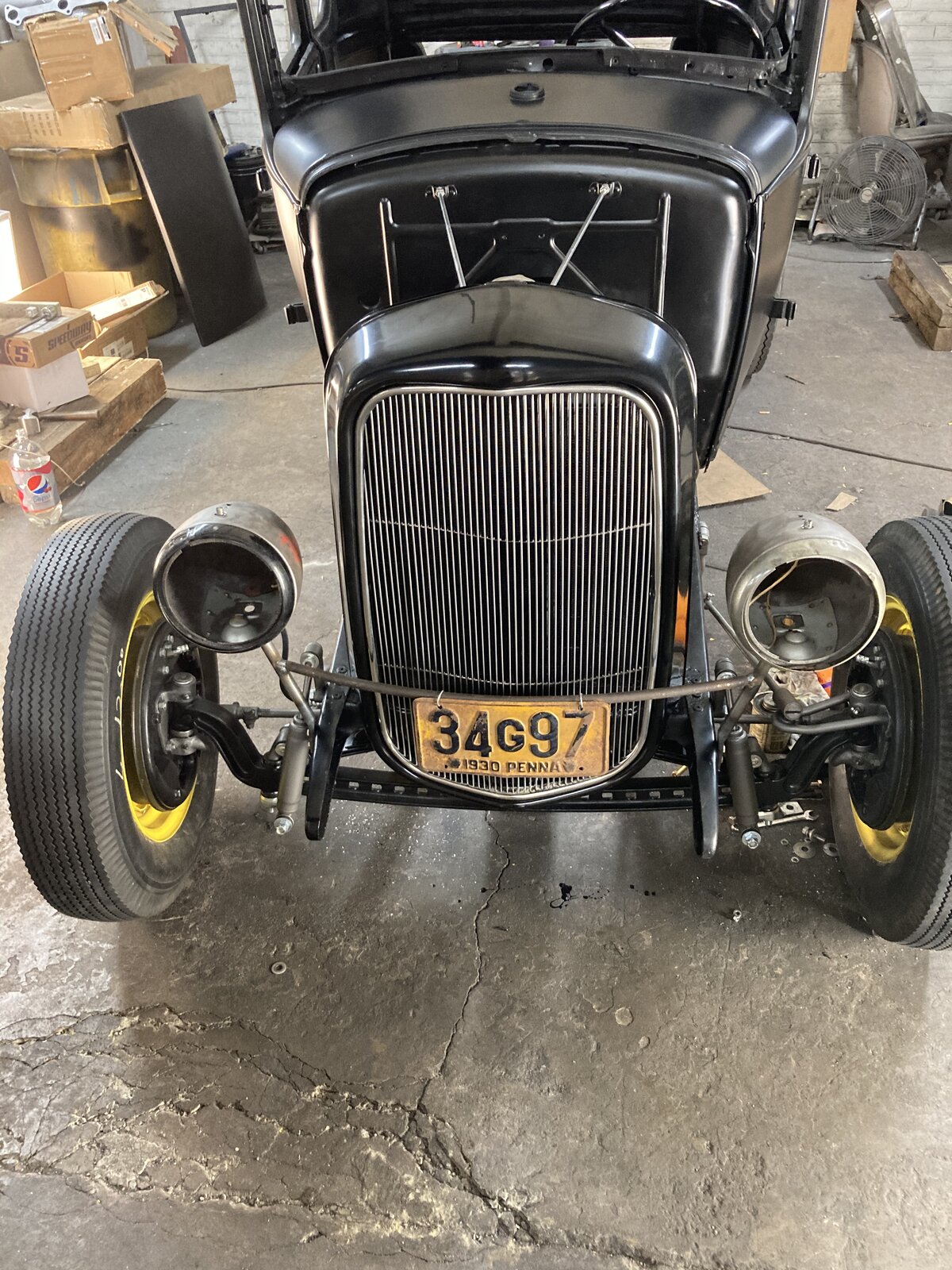

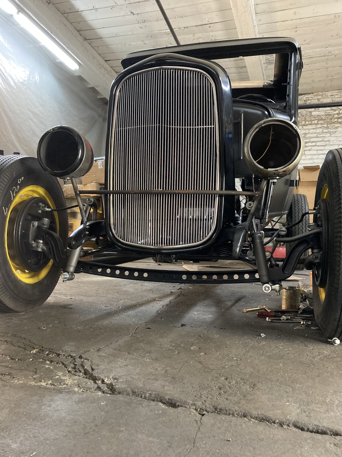

    Crossbar and headlamp bracket ***embly finished! I’m likin’ it! Definitely have a face now!! Just have to knock the welds down and paint it.....Onward and upward....thanks fellas!

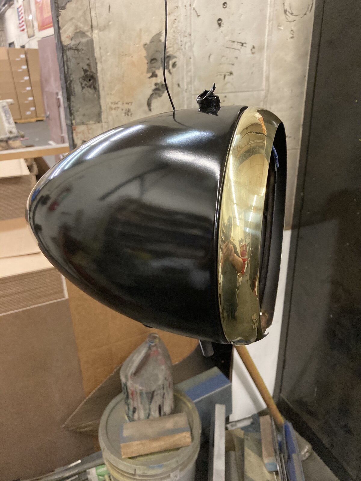

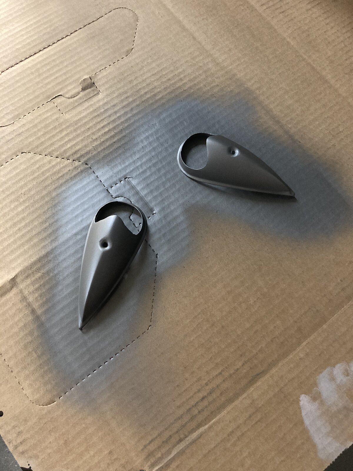

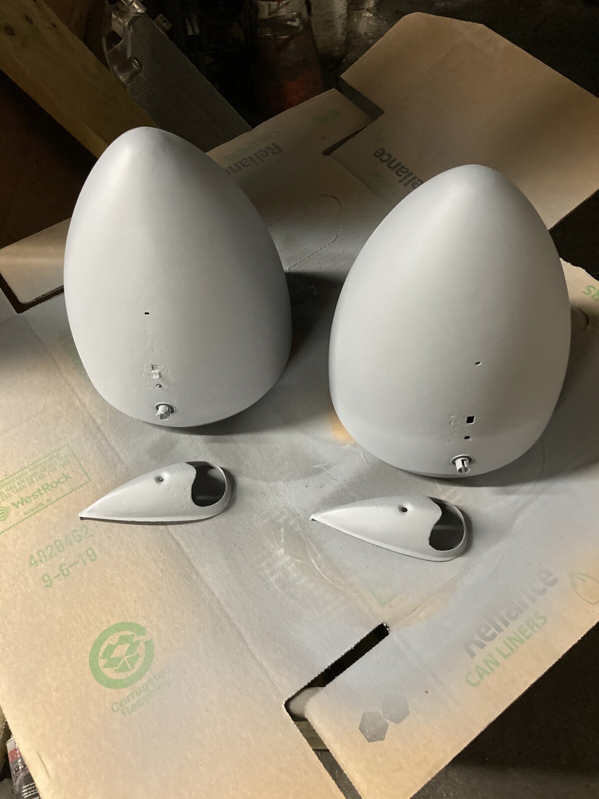

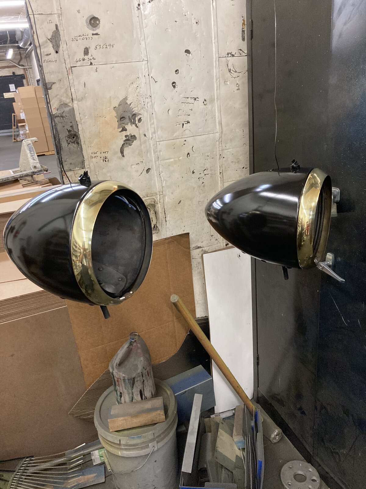

    Headlamps done and ready for final ***embly! Finally painted my grill shell and headlamp bracket ***embly....Geez... the amount of time and labor that went into just the headlamps and bracket ***embly.....no wonder I’m tired when I get home! Happy Father’s Day weekend all you dads...enjoy your weekend!

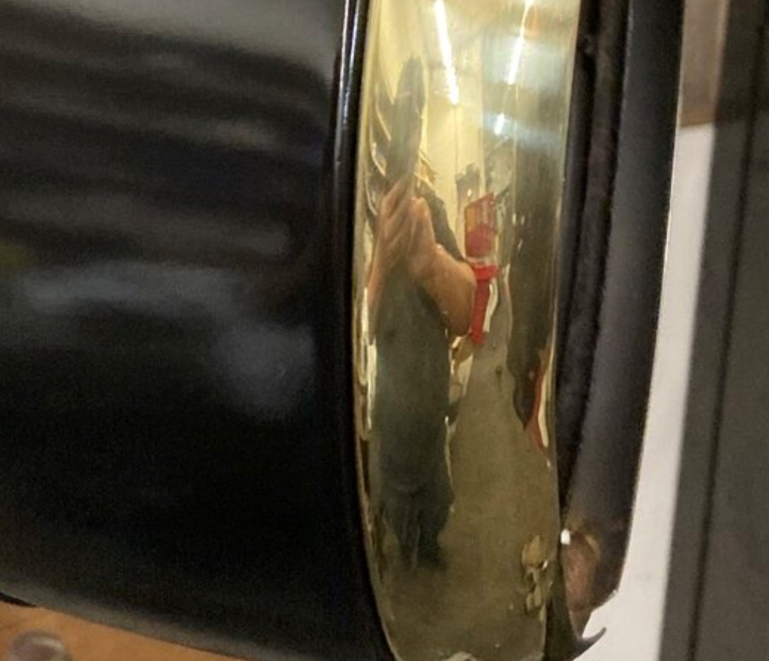

    And caught yourself for posterity to boot. Photo makes it look like your legs are really SHORT LOL. :rolleyes:

    They were no fun polishing! They were really ratty chrome, then I saw the nature of cracks in one of them and knew they were br*** underneath that ratty chrome.....blasted off the chrome, soldered up the cracks and started polishing on the rouge wheel....
    I’m gonna make a polished br*** waterfall for my ‘36 dash to match....with a clock in the center....

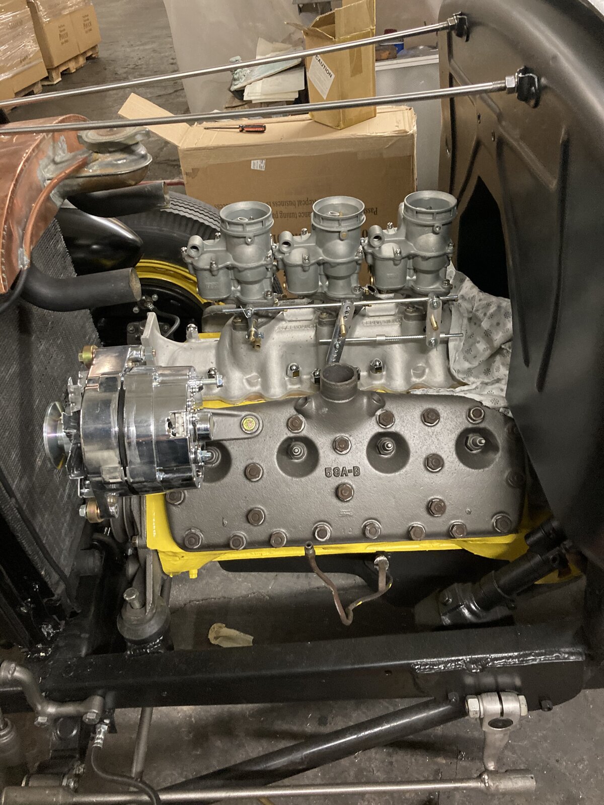

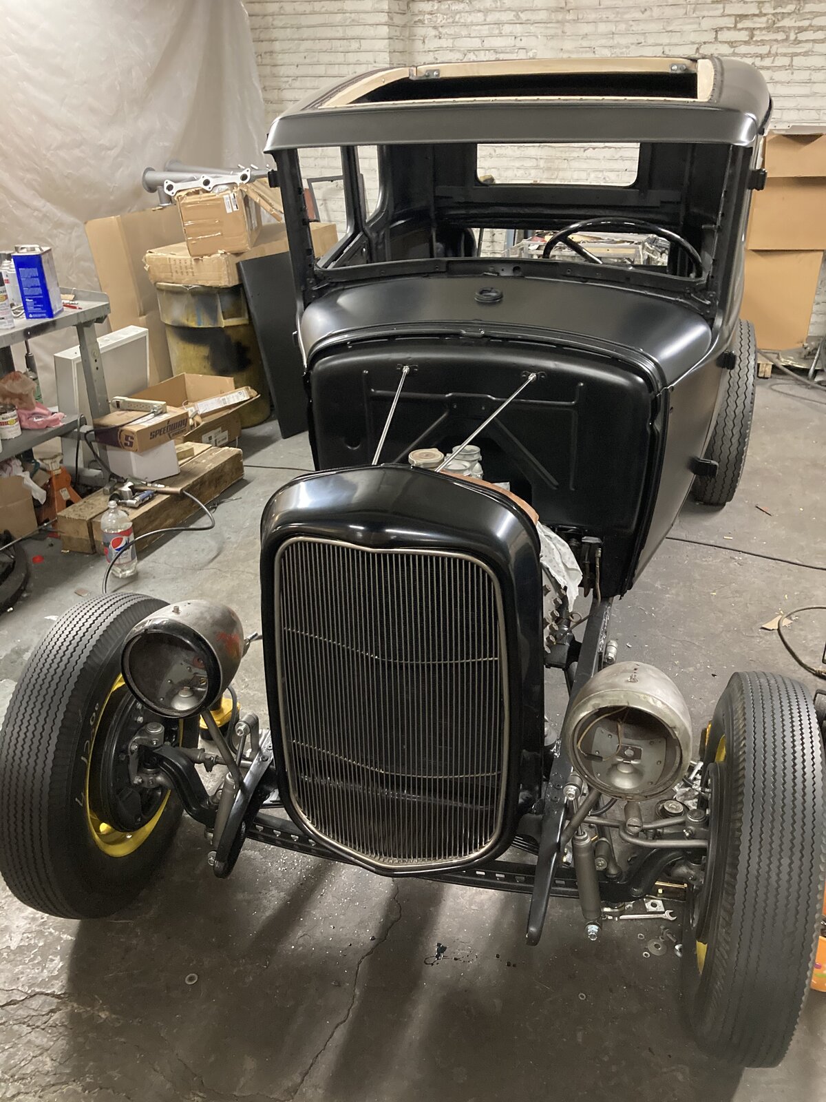

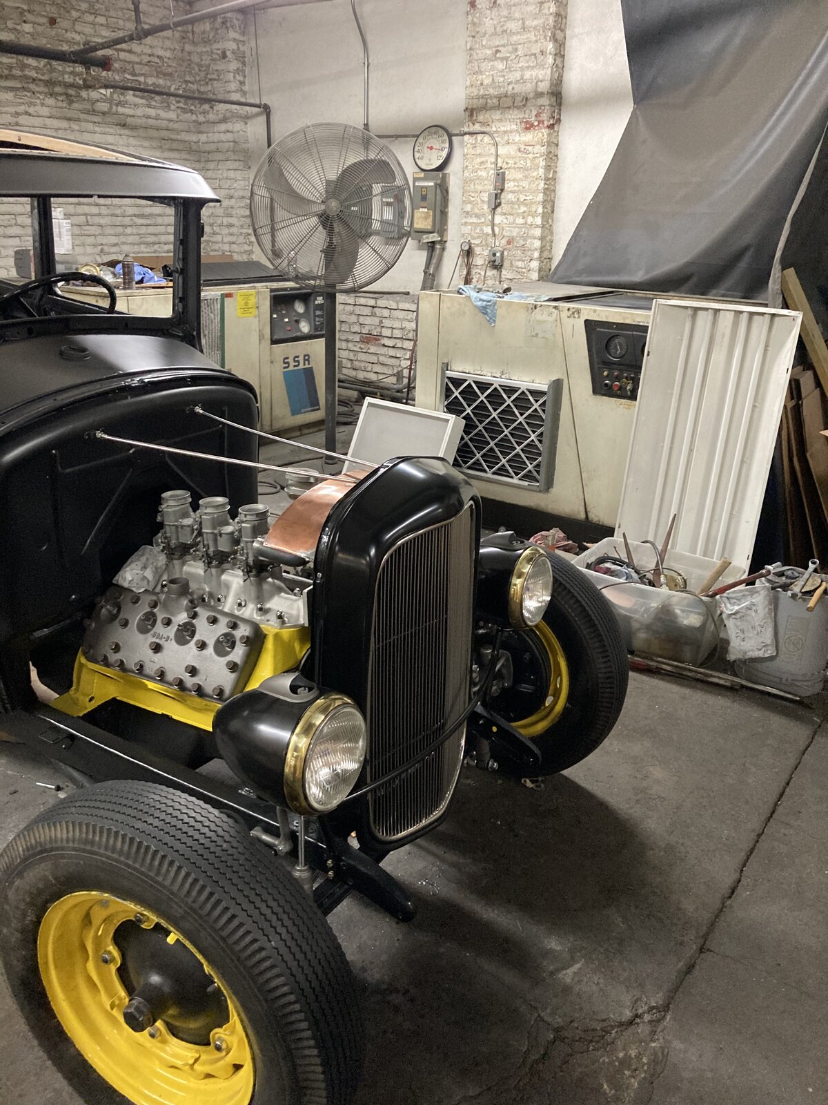

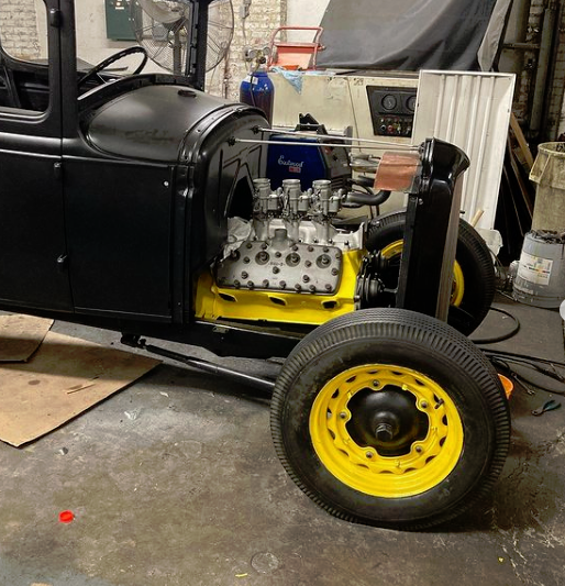

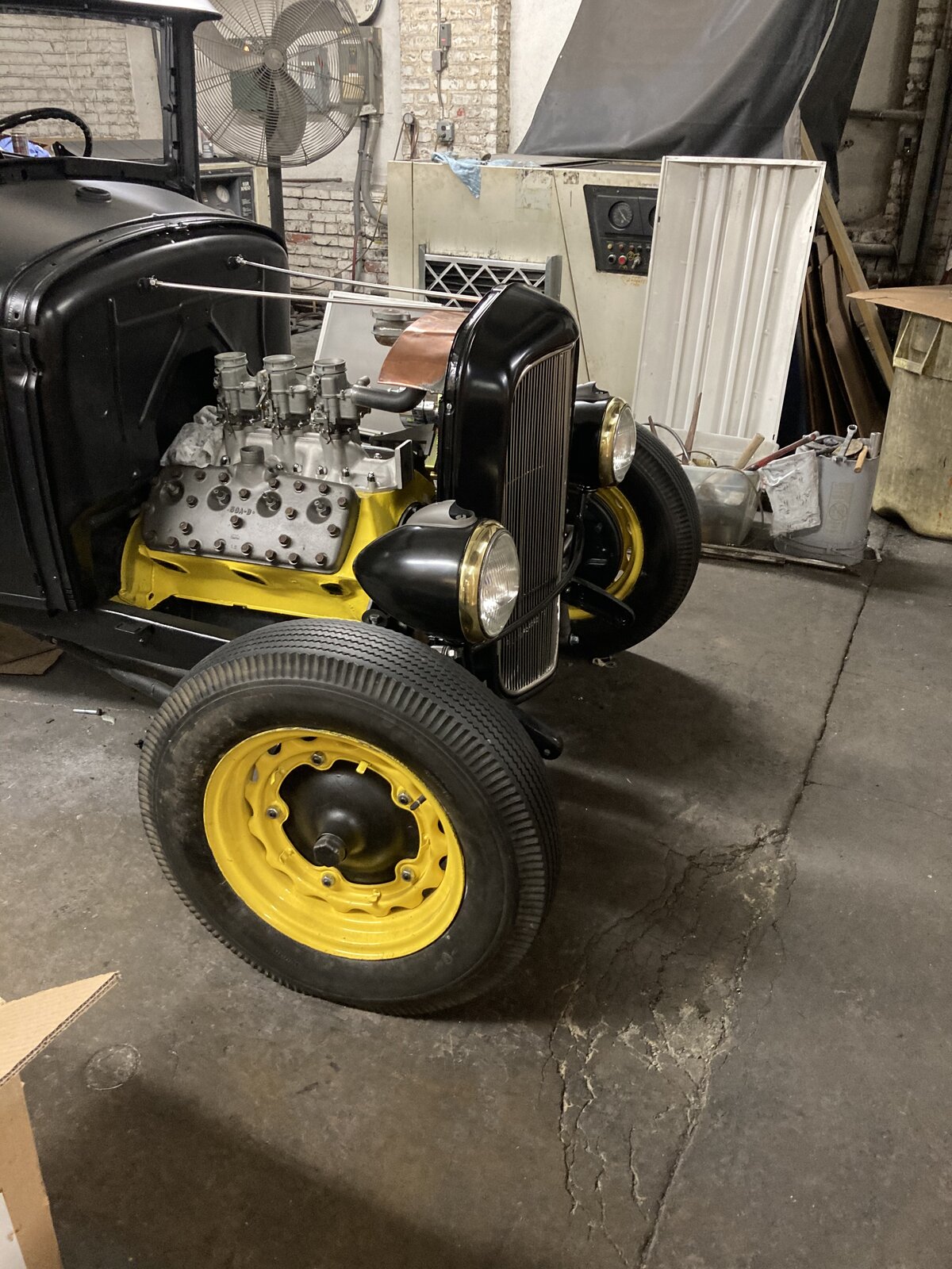

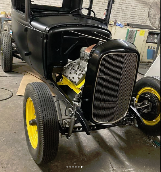

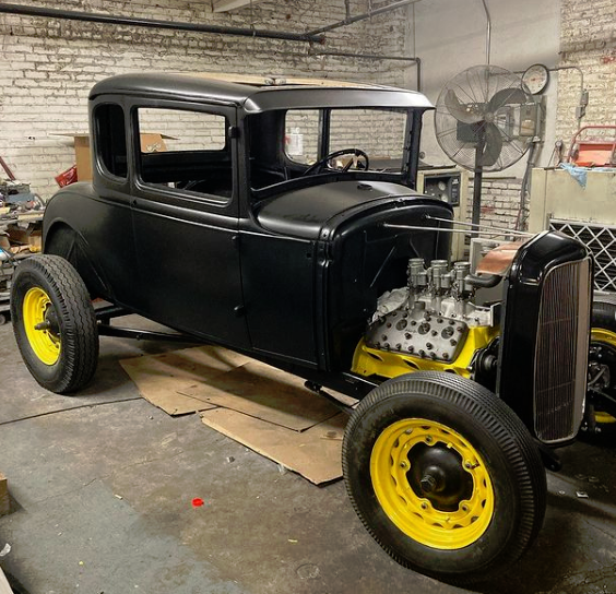

    Carbs mounted permanently, I installed the 12deg throttle plates in the secondaries and longer shafts....everything still needs to be adjusted and tweaked....the alternator was a gift from my boss, so I’m using it. Headlamps mounted for the final time....its time to start the wiring and plumbing the fuel system....thank for checkin’ in fellas!
