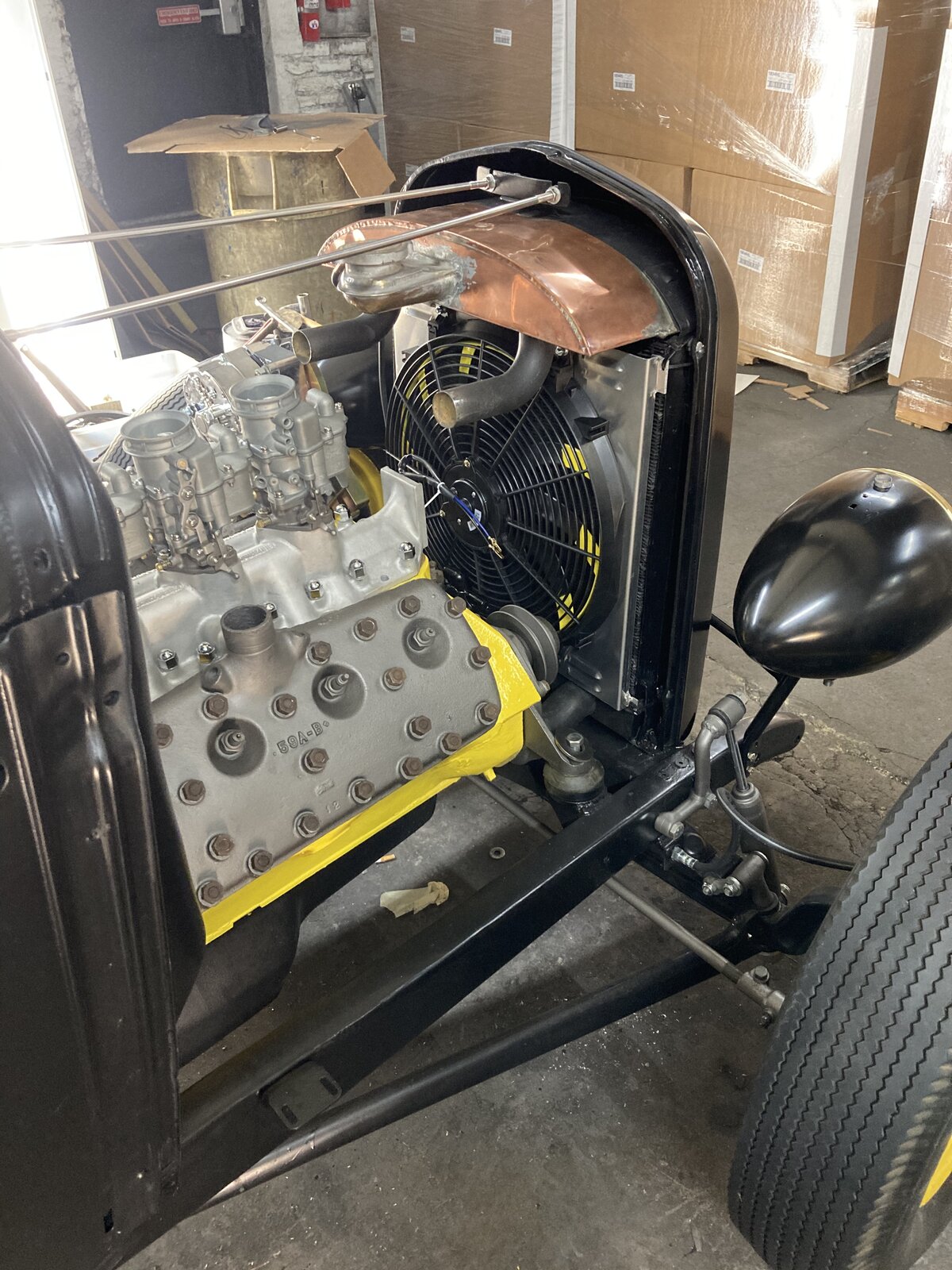

    Unfortunately, I can’t use a mechanical fan....but, this actually doesn’t look too bad. Still have to take it back out to install the belt and install my spark plug wires.....I’m gettin’ there!

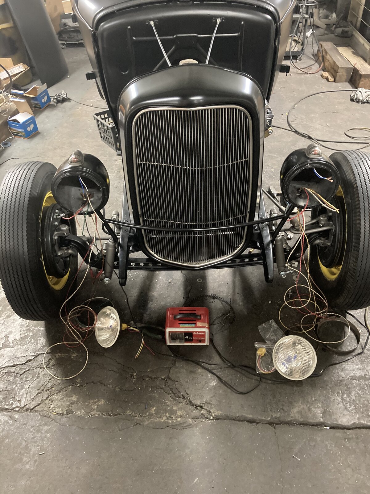

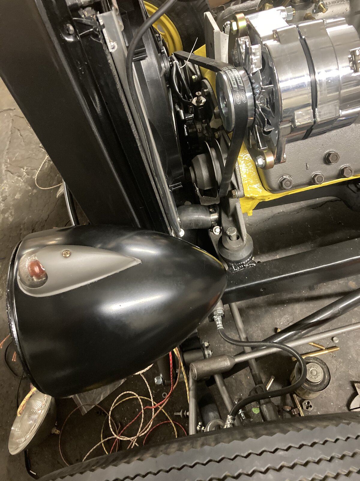

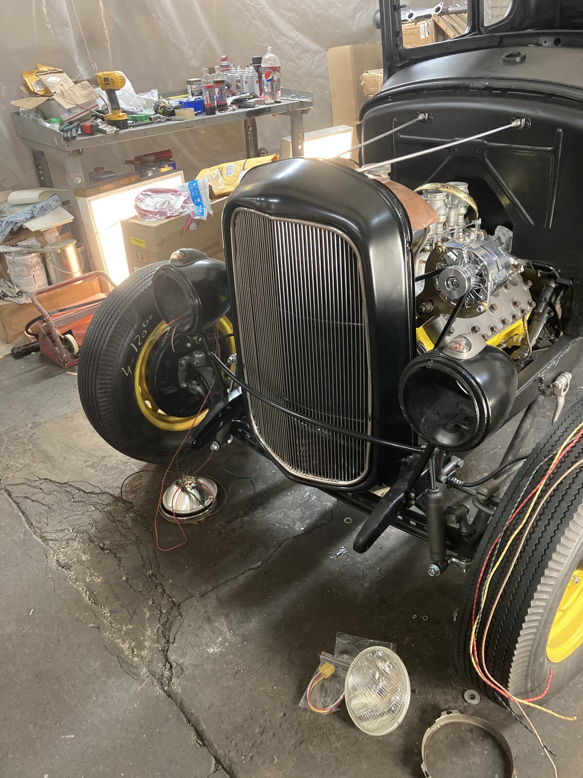

    Gates B56 59” belt worked a treat! Started the wiring.....

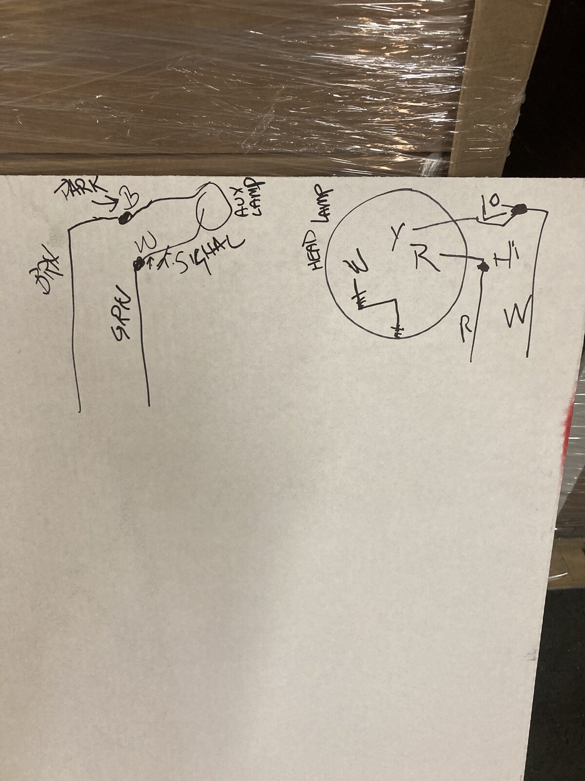

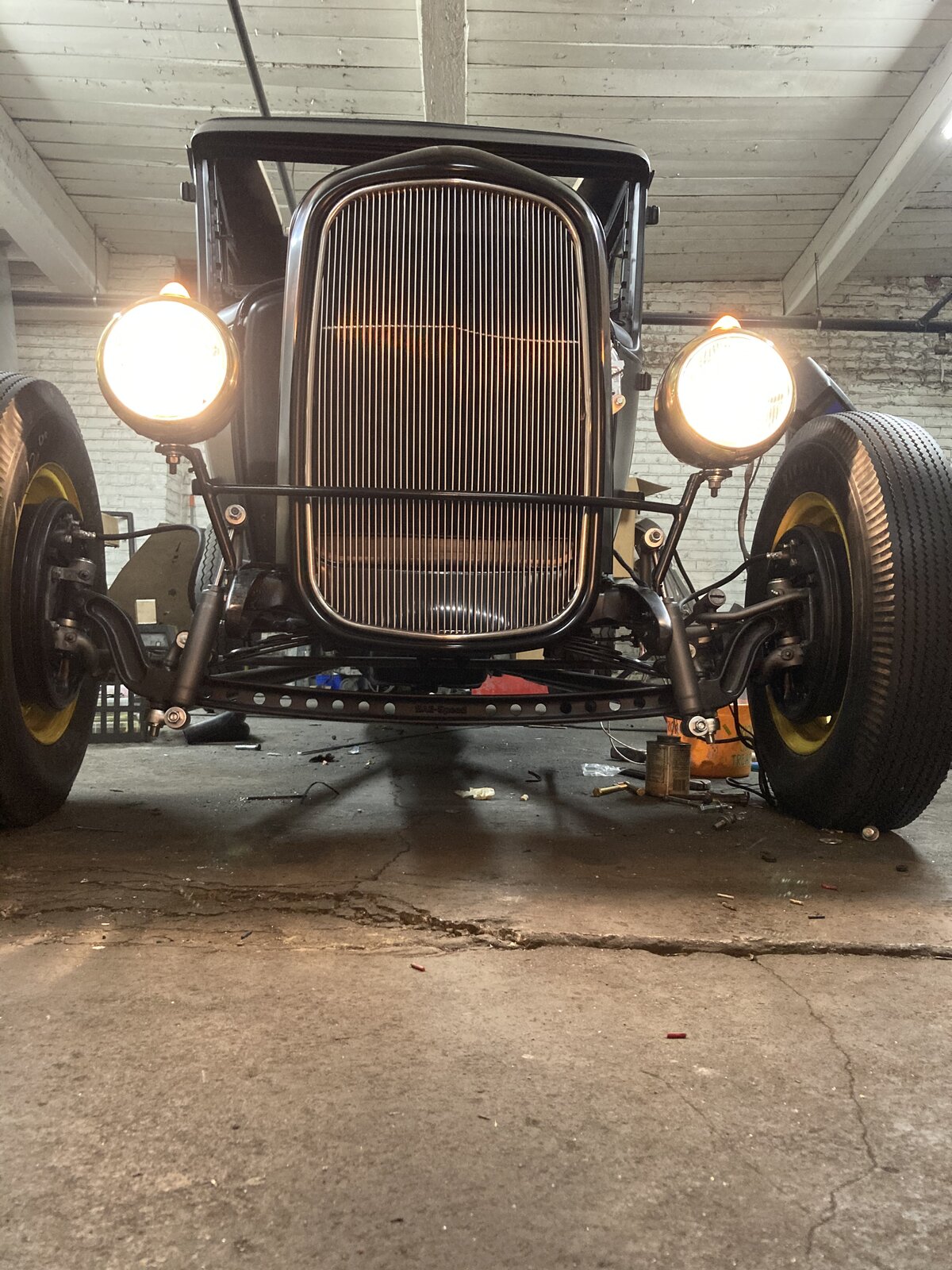

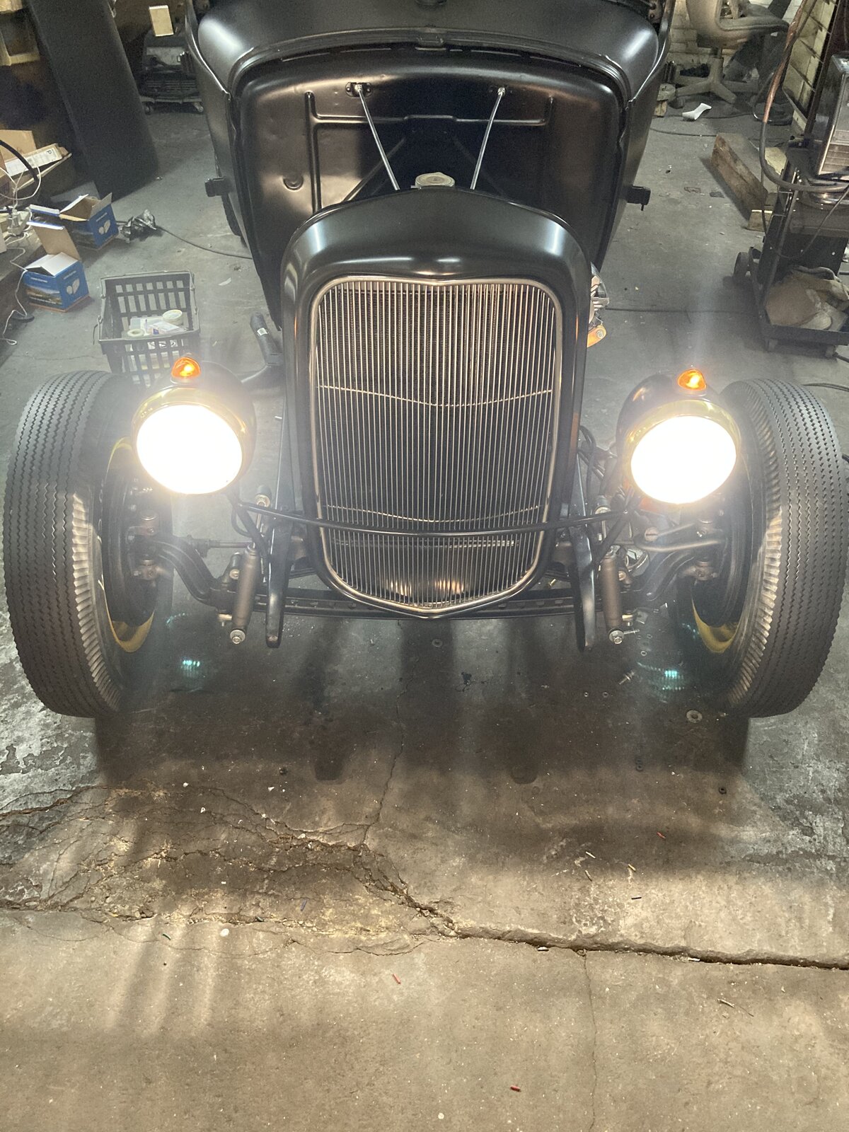

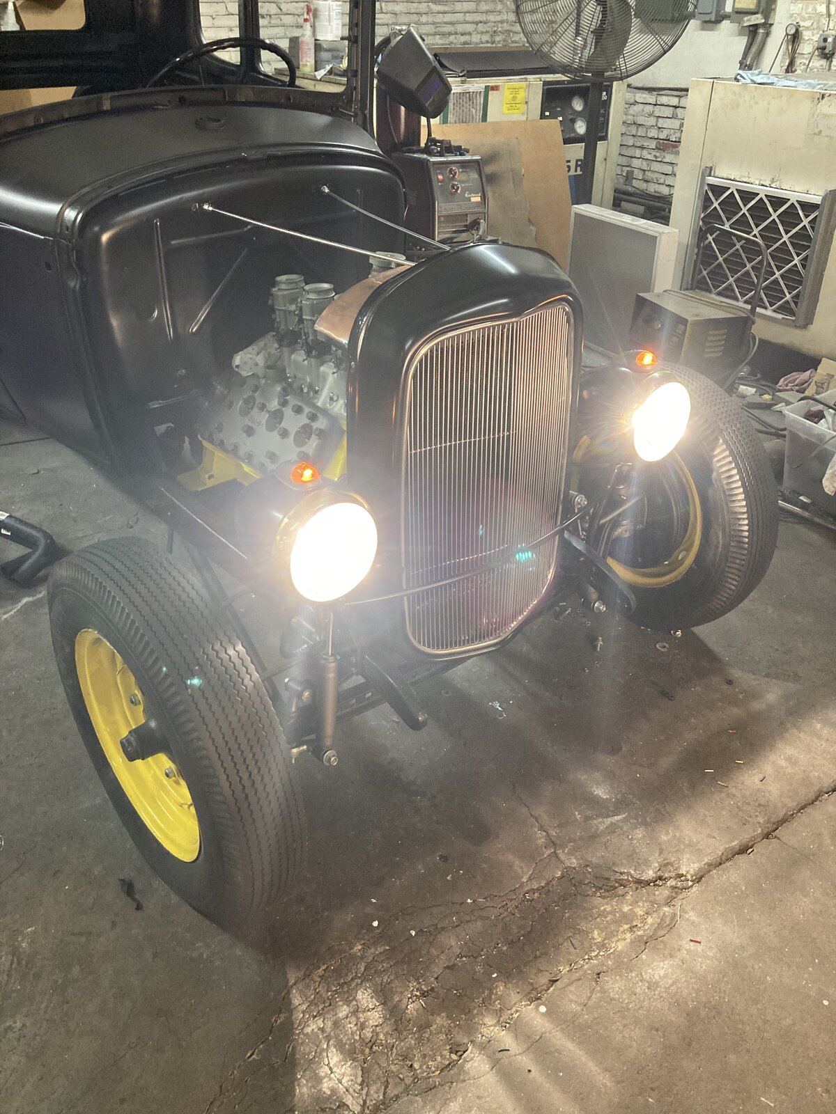

    Piewagn

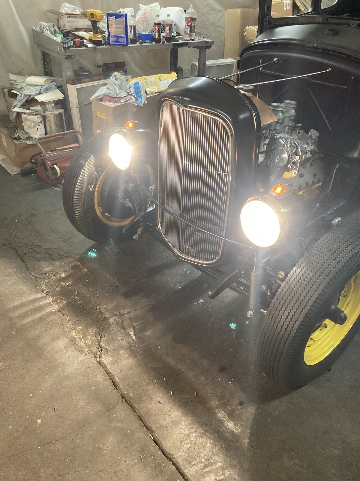

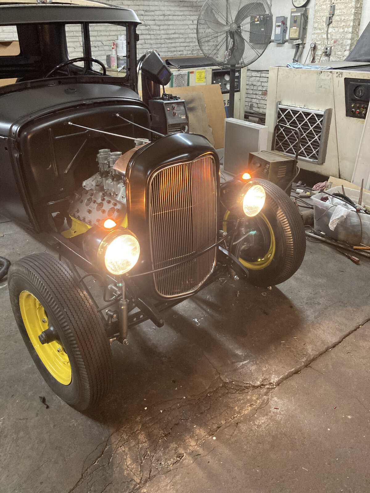

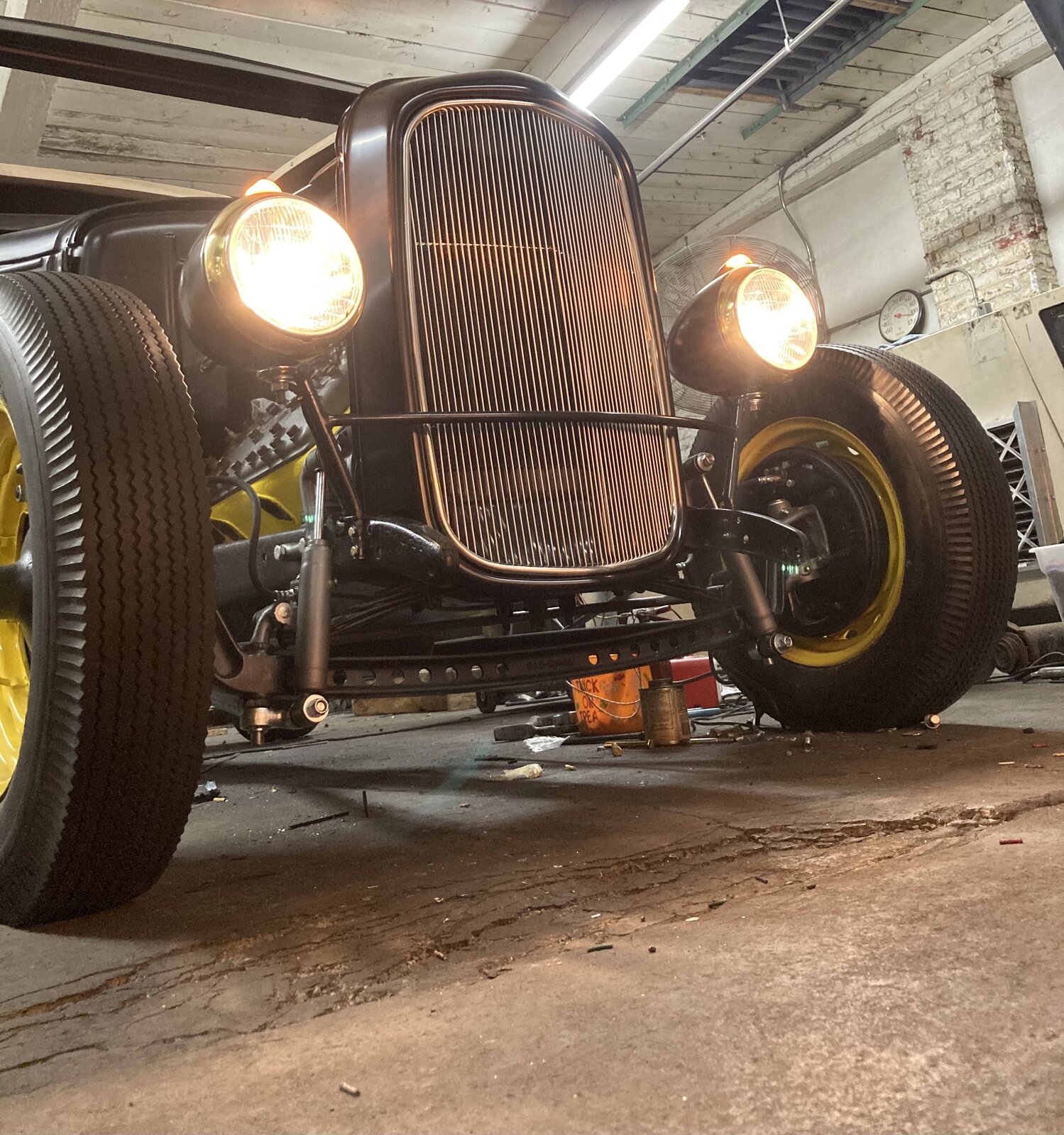

    High beam low beam....with both park and turn circuits working!! I tried to hide the harness the best I could. More progress! Stay cool fellas!!

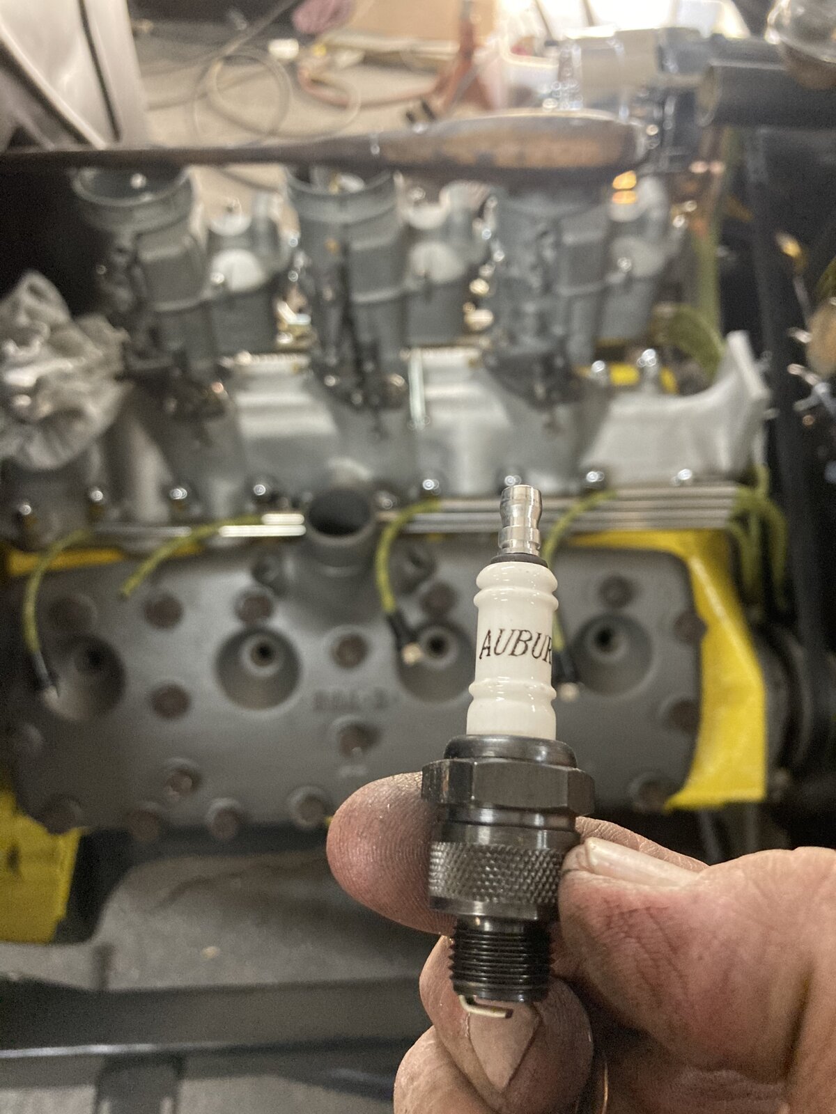

    Piewagn

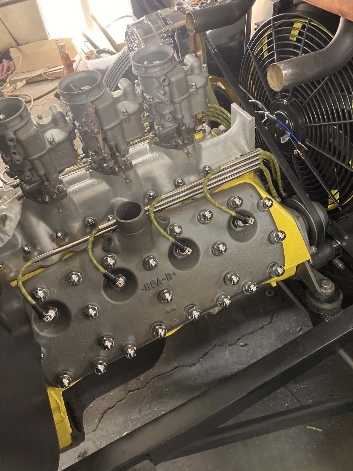

    Got my looms, plugs and wires done! I bumbled across a vintage set of Auburn plugs and immediately thought of my Pop....so I snapped them up! He loved those plugs and would piss and moan because they stopped making them. Working front to rear, taking some bites outta this thing....stay cool fellas!

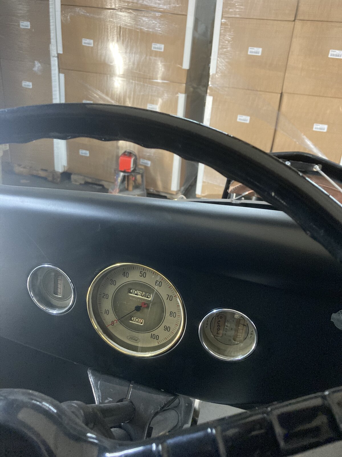

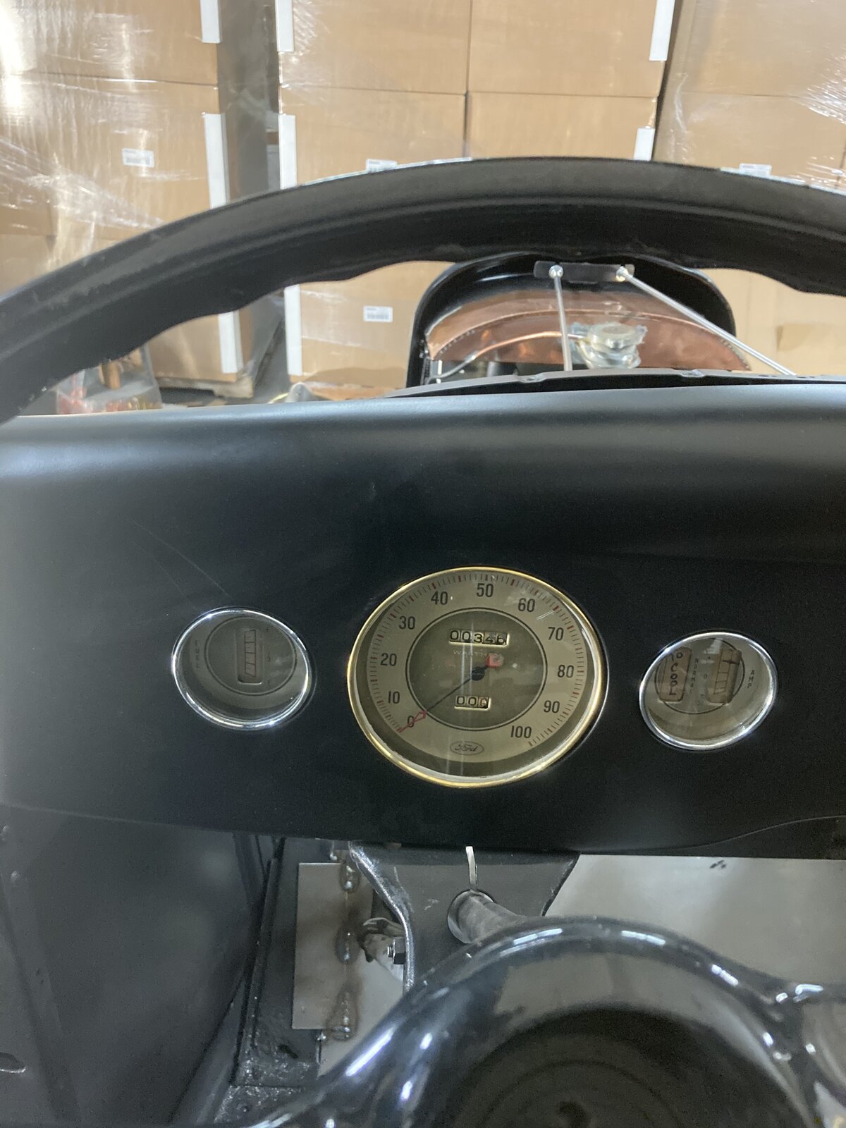

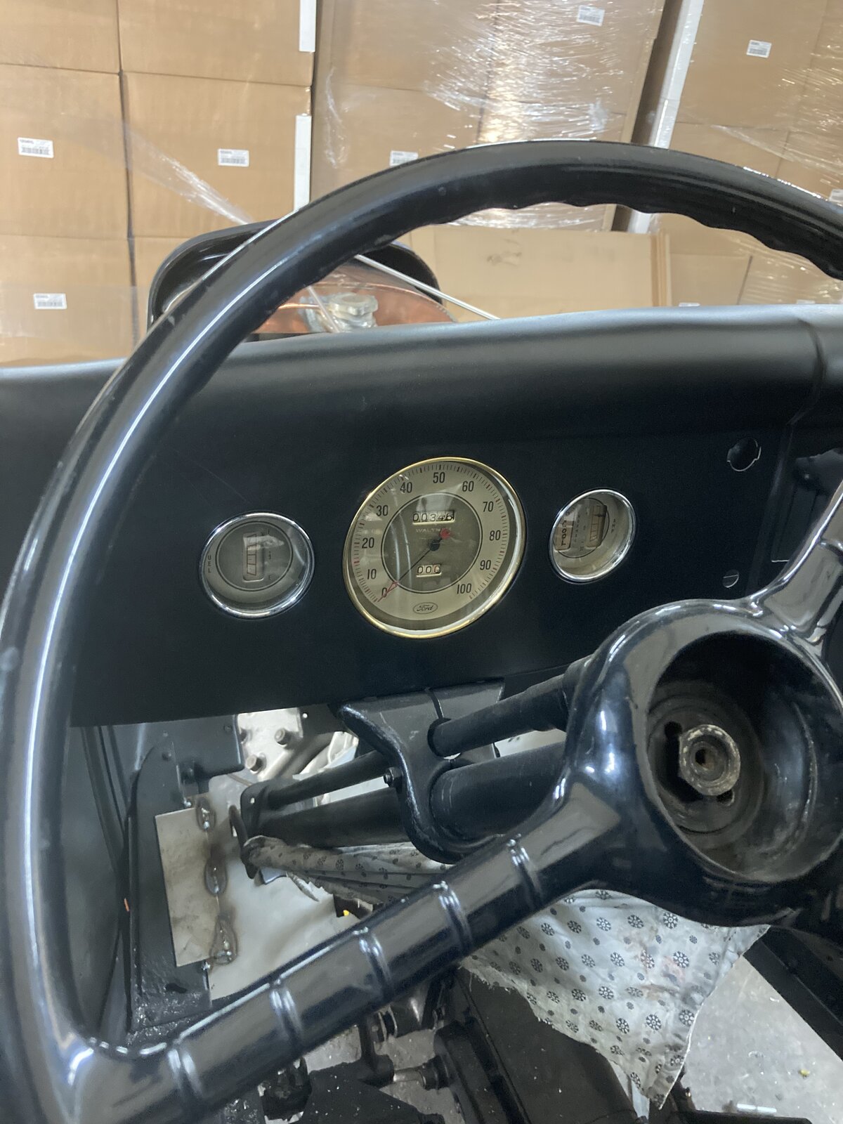

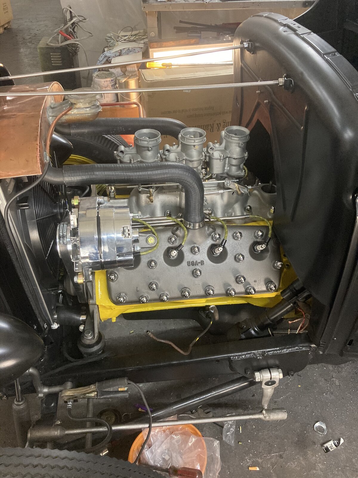

    Gauges installed, found a location for my coil and got my hoses cut to fit....the clamps I had were too big for the radiator side, need to find clamps that look decent. Still enjoy my therapy! I know I know.....it's supposed to be "too"....not enough room......:D

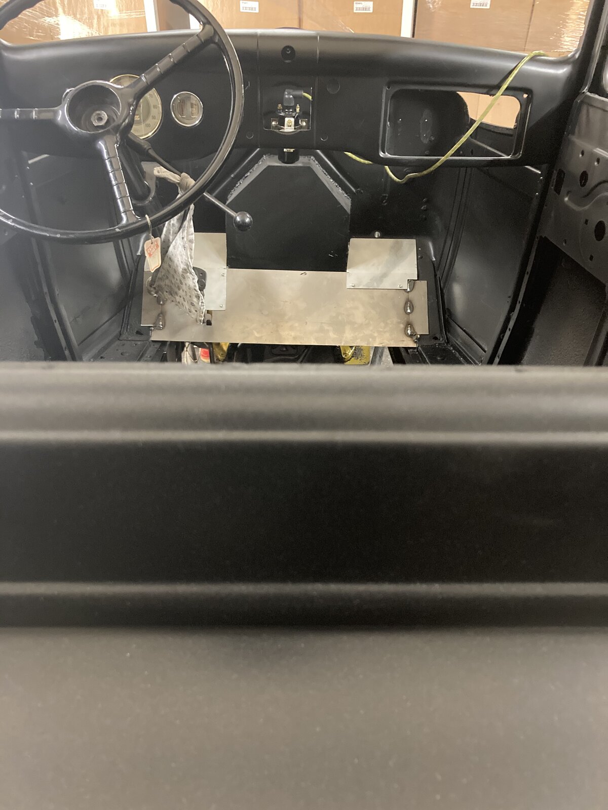

    Have to go with electric fuel pump....mechanical one won’t fit. I cut a half inch off the bottom of the pump rod, left the umbrella in place and welded a tab to hold the top in place when I made the blockoff. I ordered the Holley 1.5-4psi pump. Also finished up the toe board....completely removable and easily dis***embled.....happy Independence weekend fellas!!!

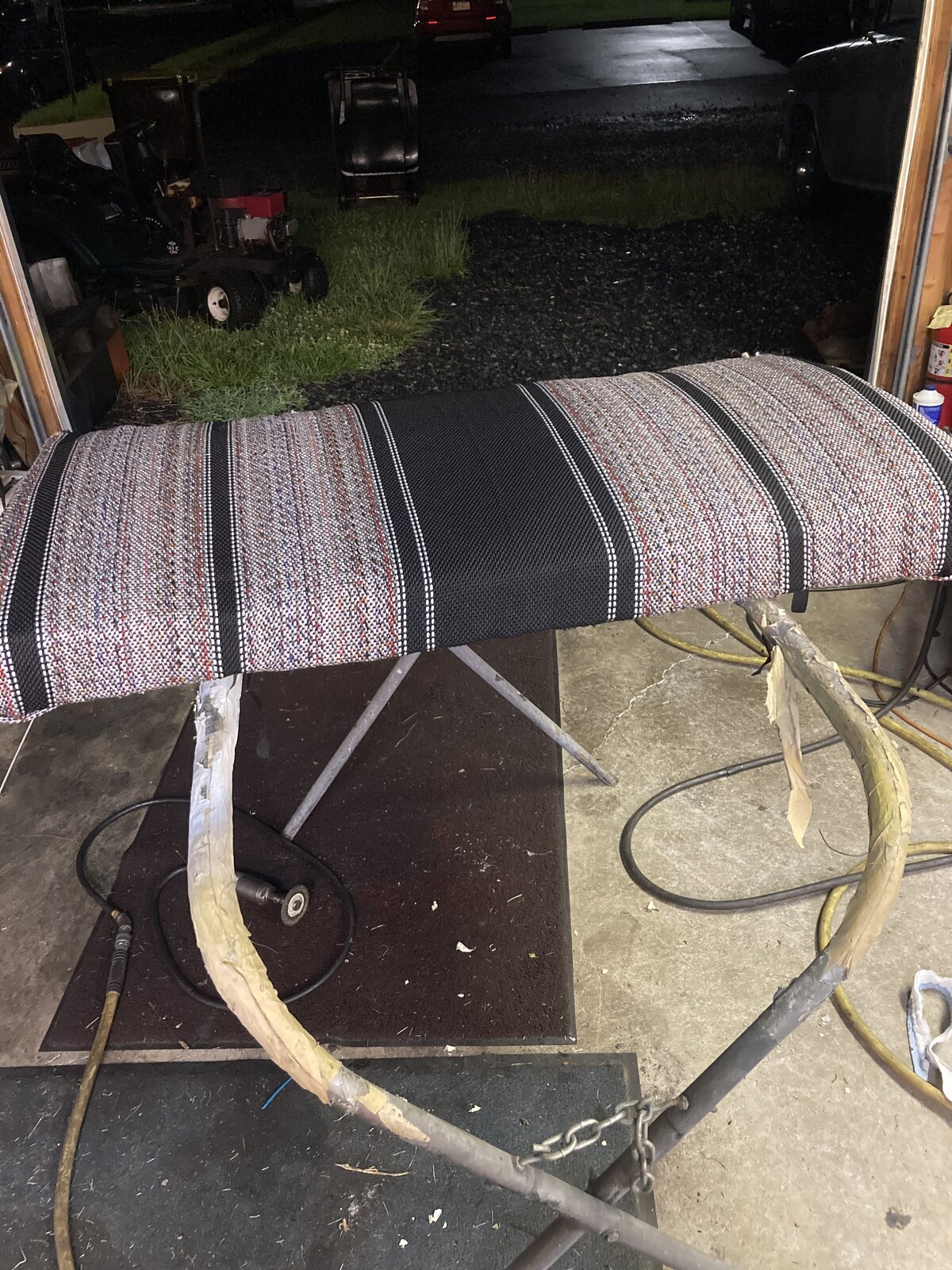

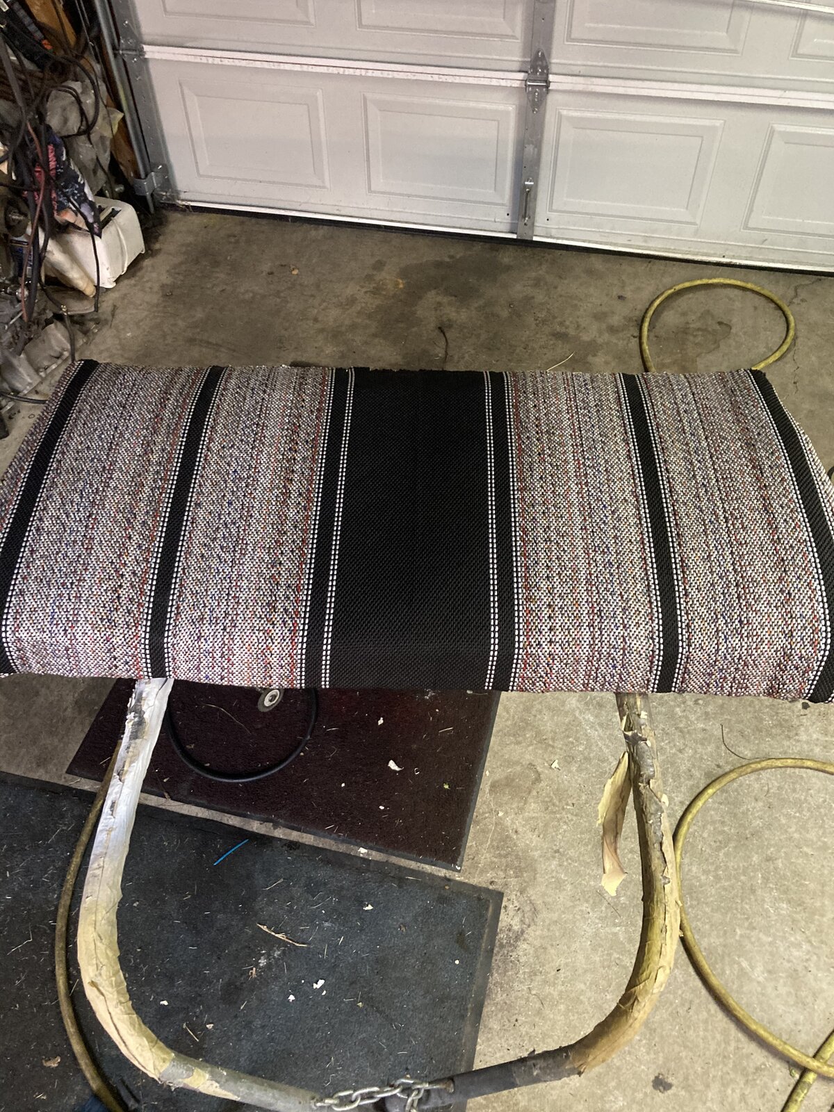

    As my Father used to say.....”not bad for a hairlip”......
    I figured I’ve done everything else on my own, why not try the seats?

  21. Excellent
  22. loudbang
    Posts: 40,349
    And even the seams are straight. :)
    Nicholas Coe likes this.
  23. Piewagn
    Joined: Mar 25, 2009
    Posts: 1,542
    Piewagn
    Thanks fellas! I'm hoping the bottom comes out as well!

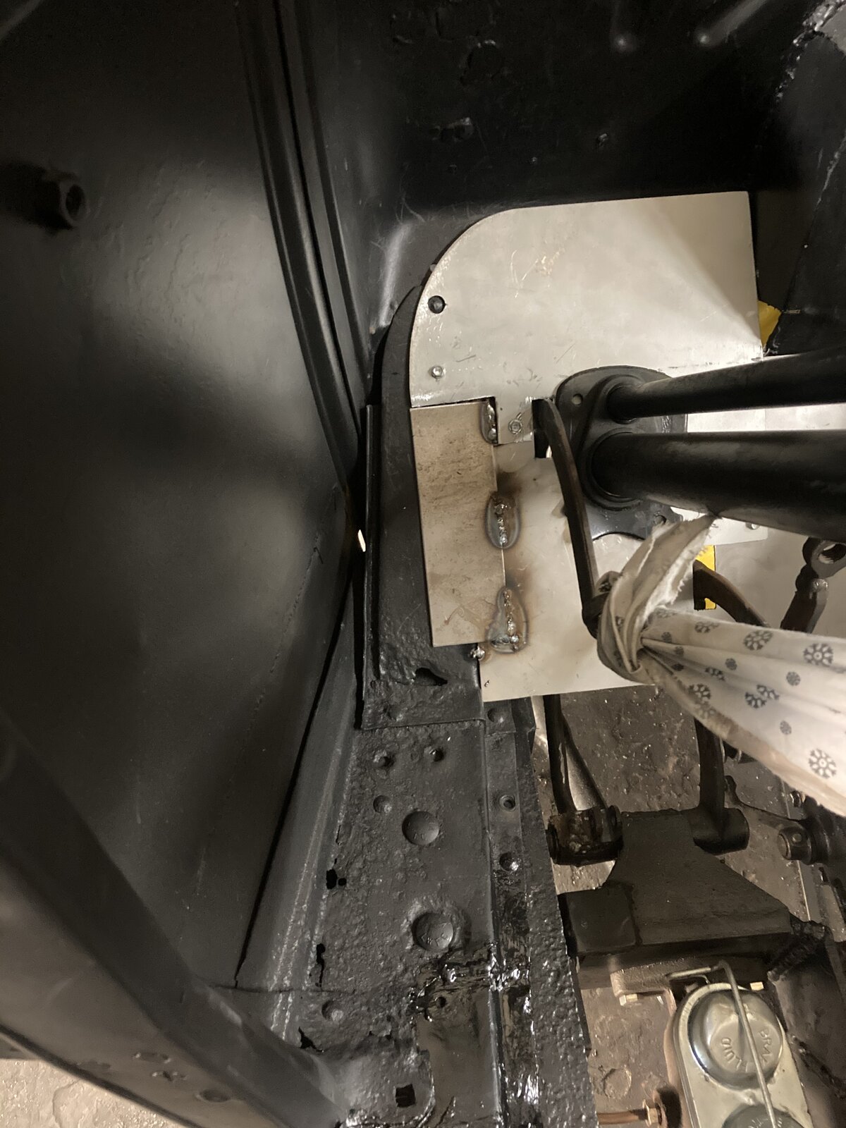

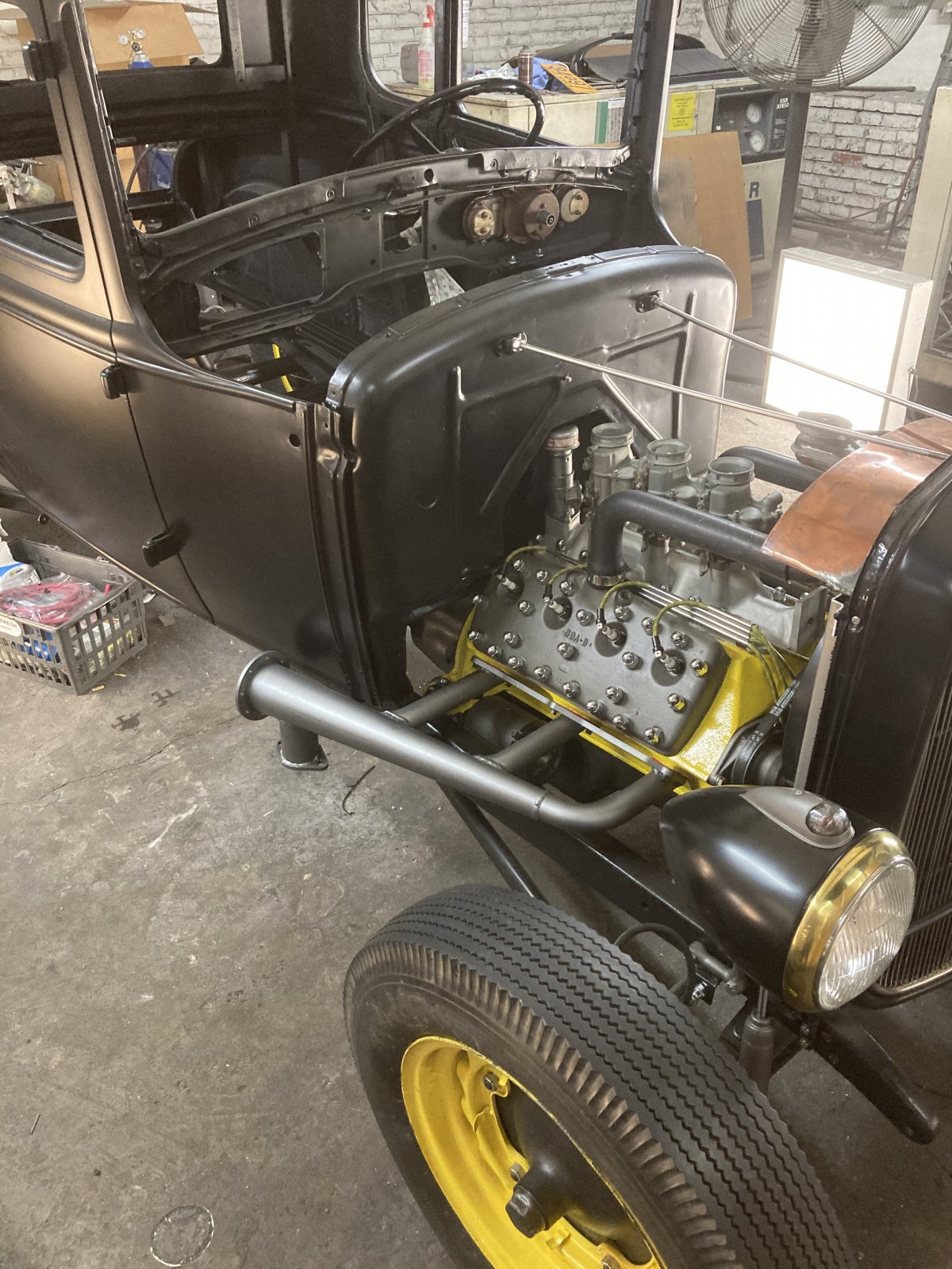

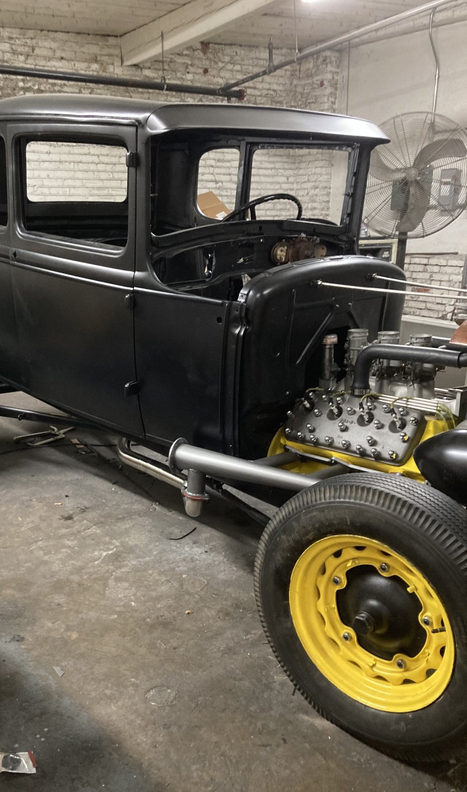

    Piewagn

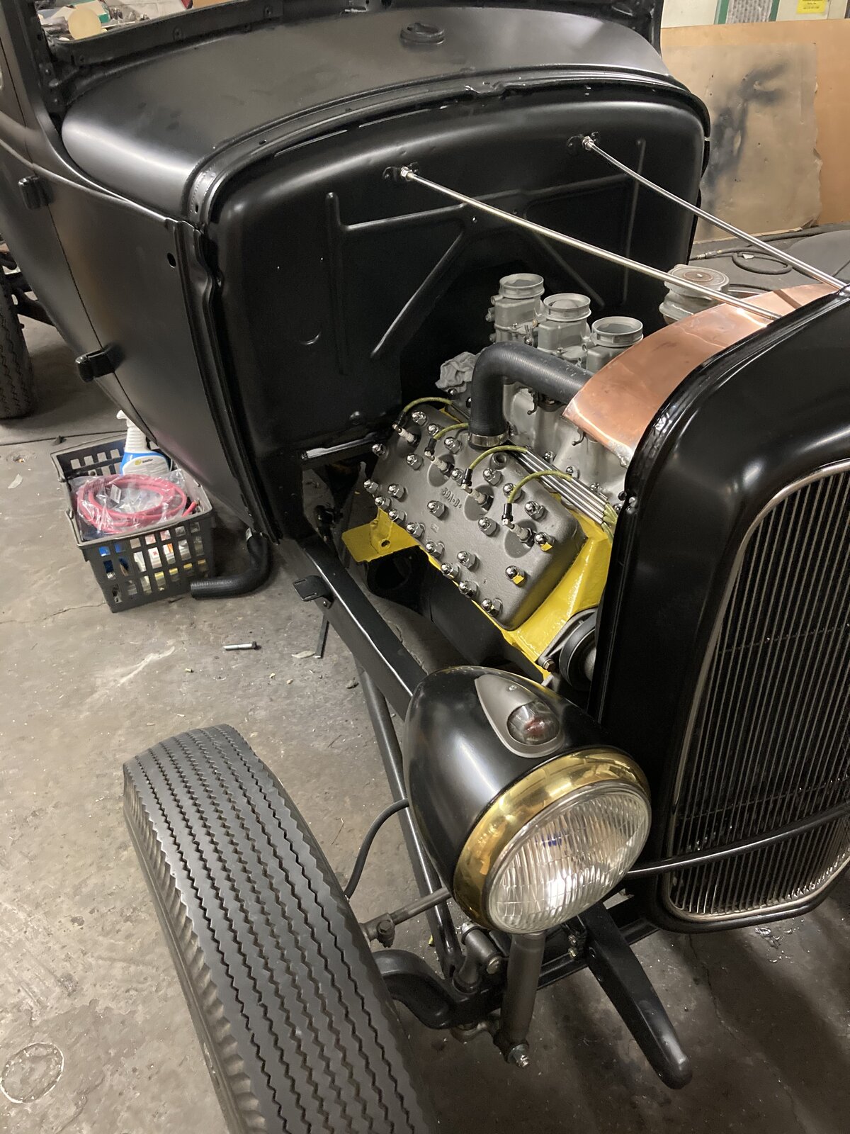

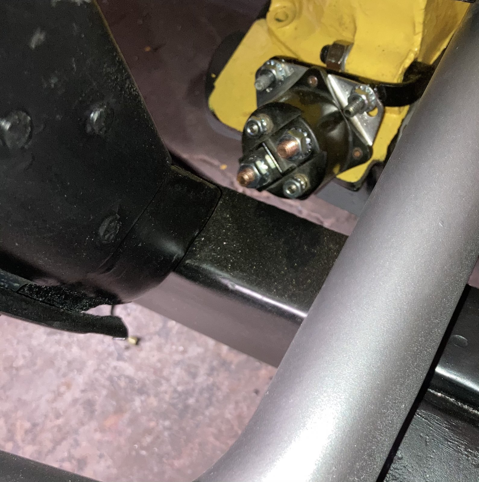

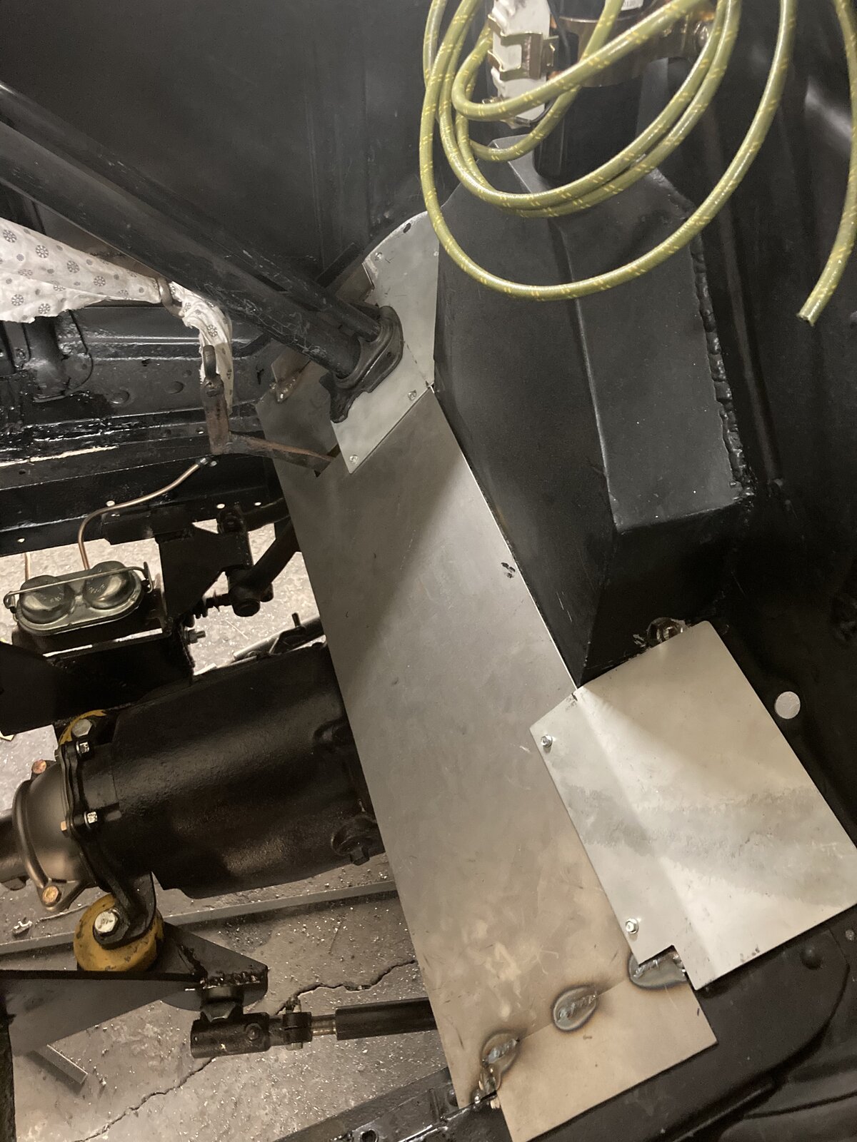

    Headers installed in their permanent home and I found a nice cozy spot for my starter solenoid..... I made a bracket attached to a bolt and utilized an existing hole....
    Exhaust, floors, wiring and windows and I’m there! Aside from fluids and some other extraneous things....I’m so close I can taste it!!! Thanks for hangin’ with me everyone!

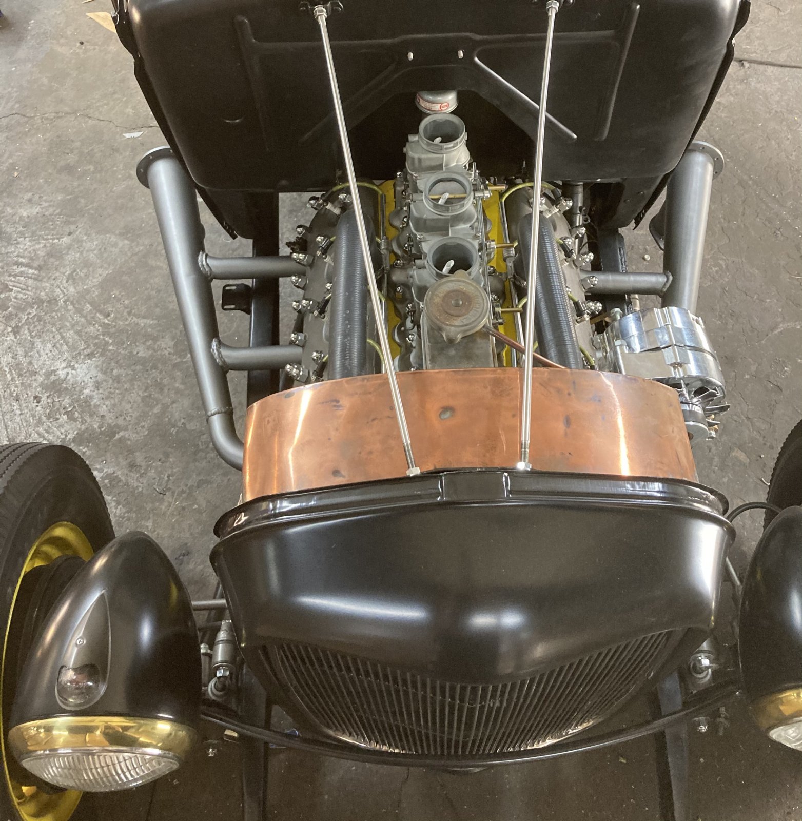

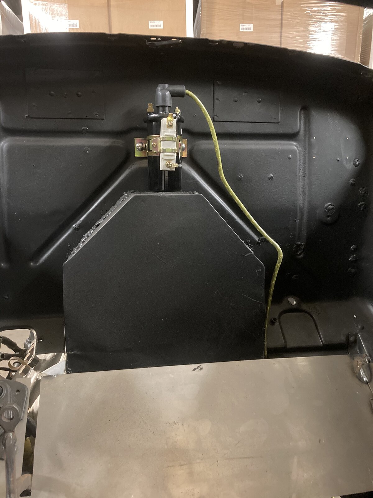

    Just mentioning this so that if it comes up later, I can say "told ya".
    The resistor mounted right next to the coil is going to get HOT, and under dash won't get as much airflow as under hood. Hope it's fine, but if it has ignition issues when hot, watch out for this.
    Also, you may want to start it up on just the center carb to begin, unless the trio has been set up on a running engine. One less adjustment to deal with during initial fire up.

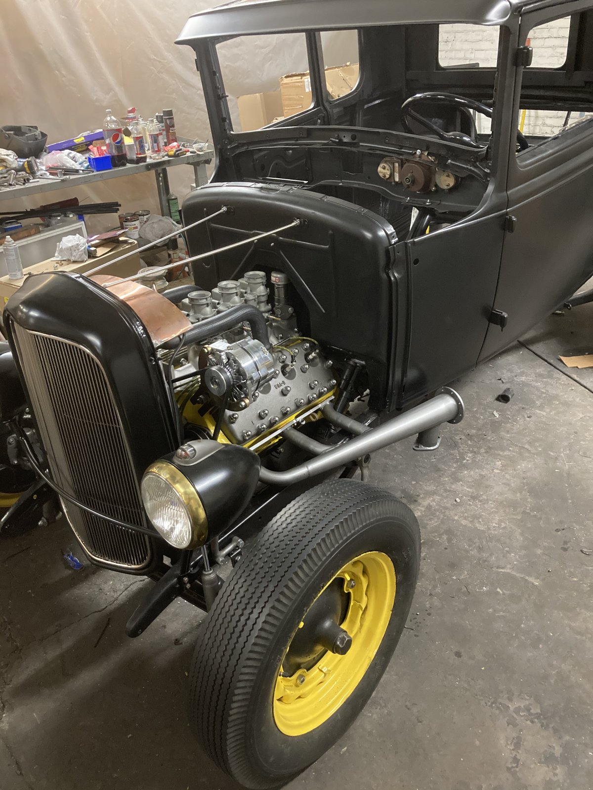

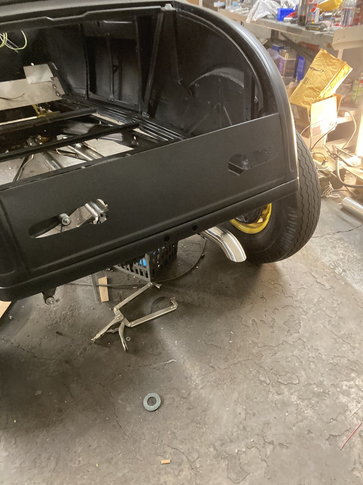

    R/S basically done!
    I need to get some exhaust hangers and weld the straight pipe up....I’m sure I can have the L/S done tomorrow evening....
    Then on to the floor!
