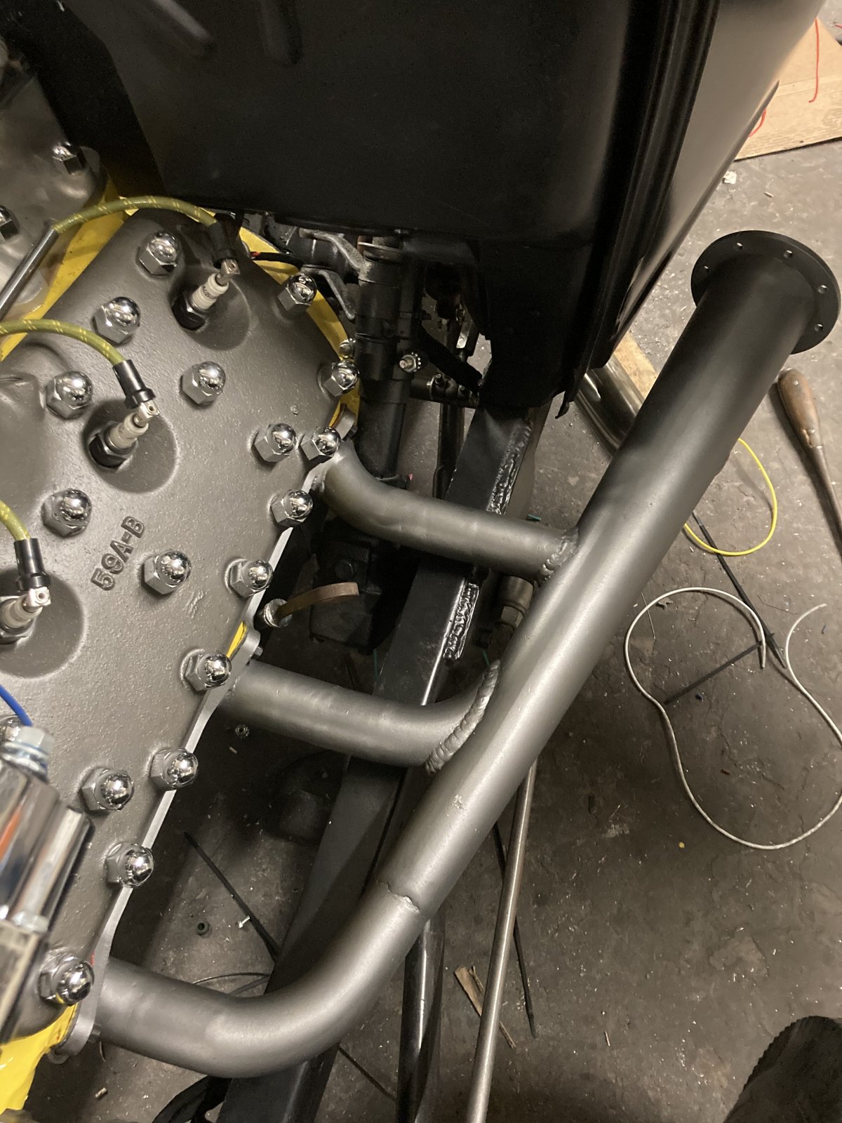

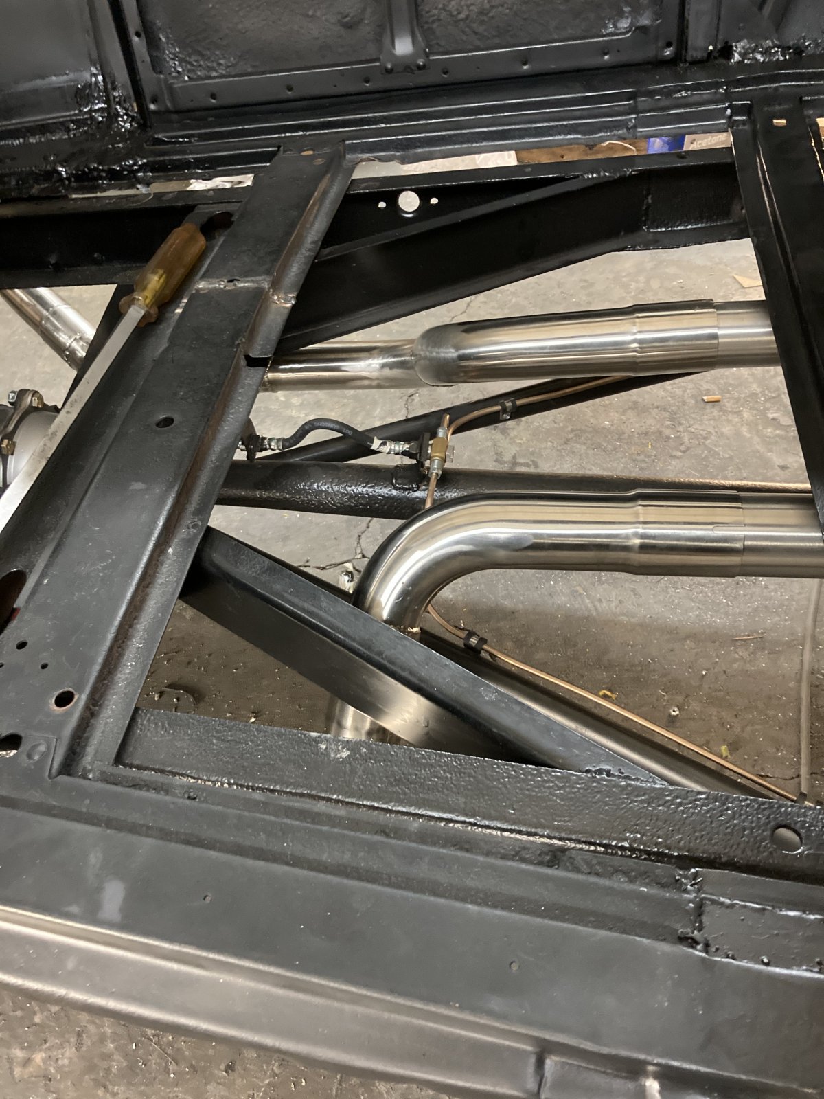

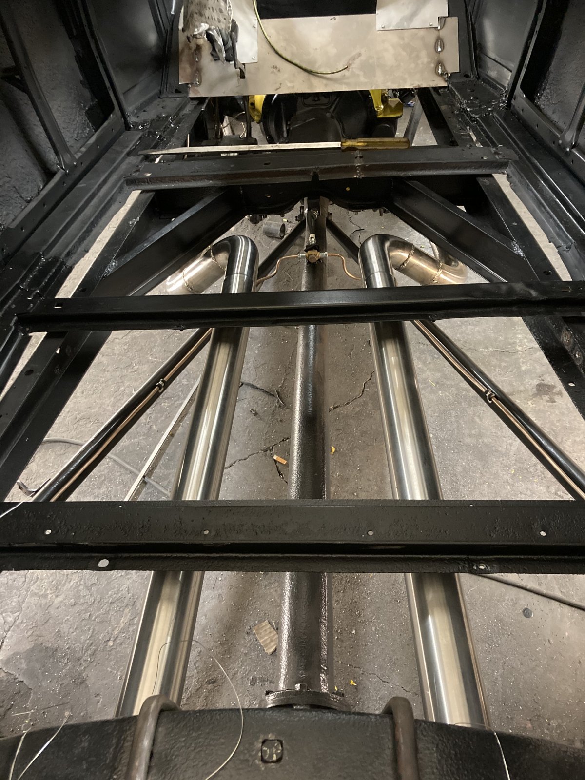

    Driver side done!! Well, except for the hangers which are on the way....
    Now I can make templates for the floors and cut them this weekend.... I start finishing up the wiring once the floors are secured.... Then it’s on to all the odds and ends....it’s been a long road to hoe fellas and it’s all starting to pay off!

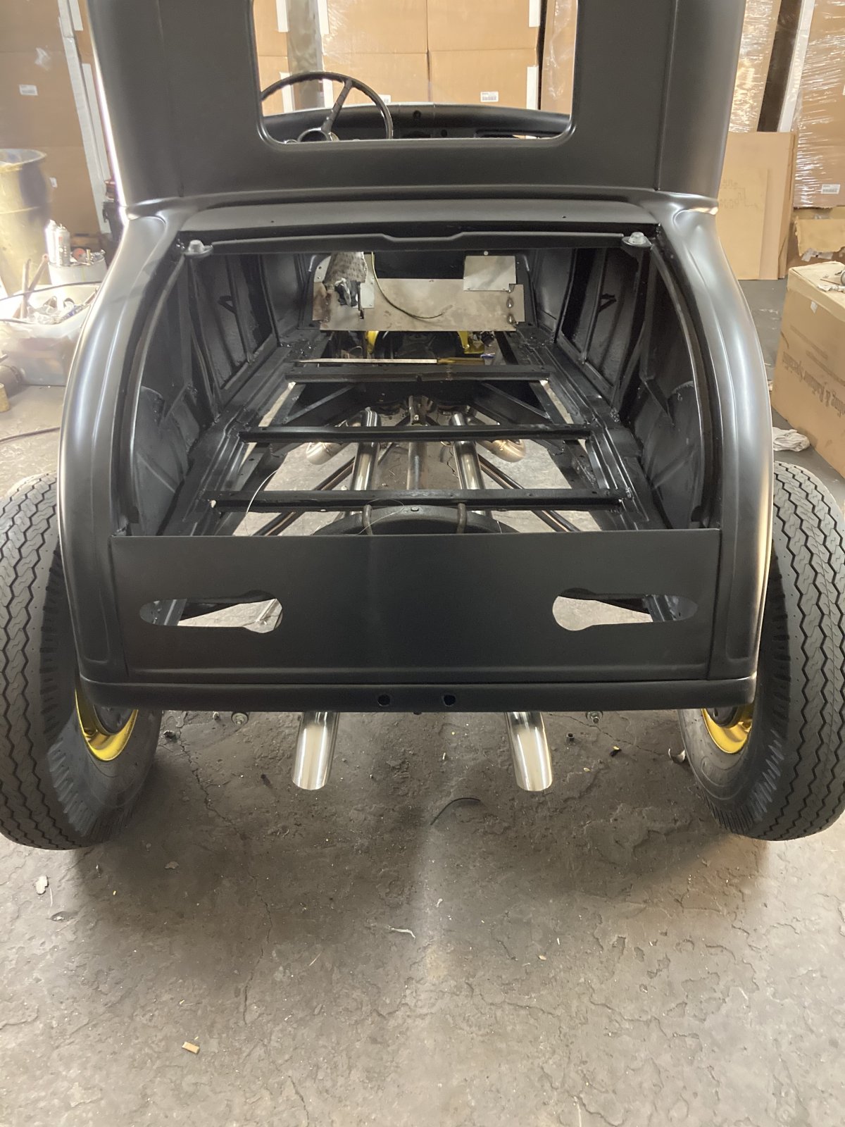

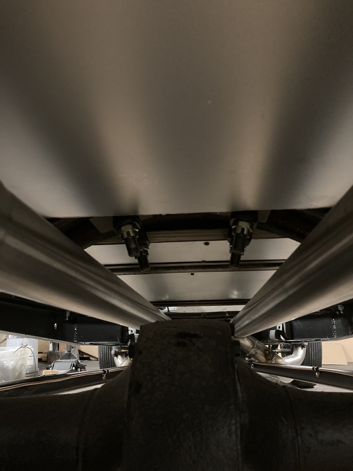

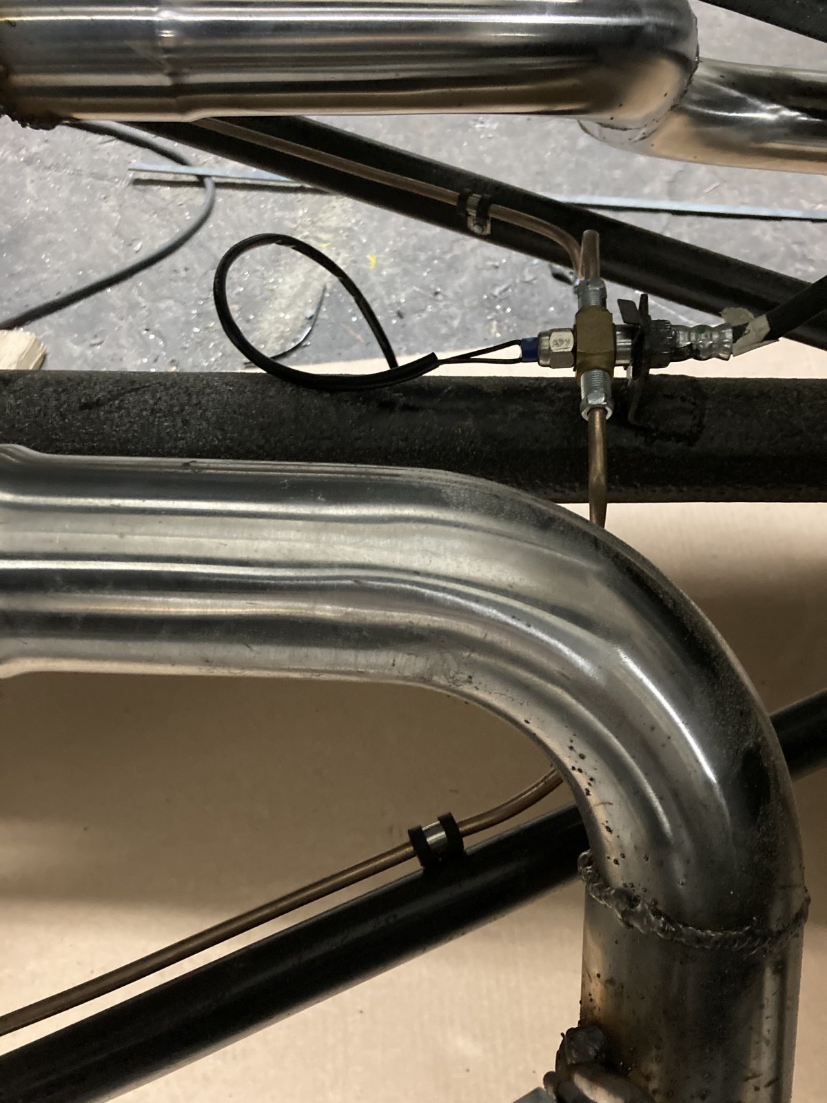

    Just a wild thought, since you are doing such a nice job with the build.
    Exhaust even without modern stuff gets hot over time. Since you built the whole system without a floor and it's still open, have you thought about hanging shielding too?
    It would help any sound/heat insulation you plan to lay down later.
    Around town is fine, but if this is going on all day jaunts, it could make it more comfortable.
    The main point I see are those first bends to horizontal right under the floor, which are going to get warm on the outside of the bends, pointing right under your backside, and whatever might be stored under there, if anything.

    Oh yes....heat shielding going in place....we’ve got a ton of aluminum and stainless sheets around here. Your input is greatly appreciated....thanks Rod!

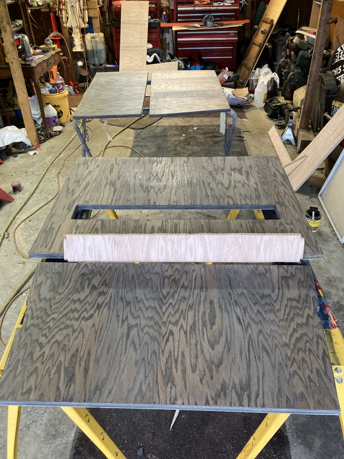

    Got new bulb sockets and bulbs installed in my tail lamps, made a bracket for my continuous duty main power switches and made templates for my floor panels. I brought them home with me so I can cut them this weekend. Enjoy your weekend everyone!

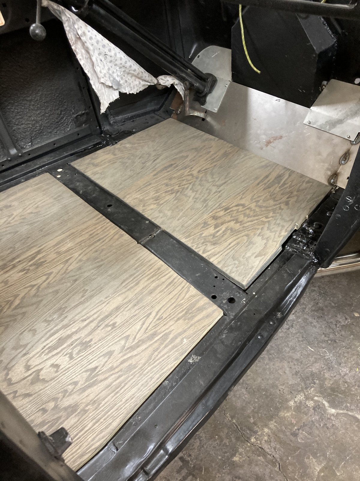

    Piewagn

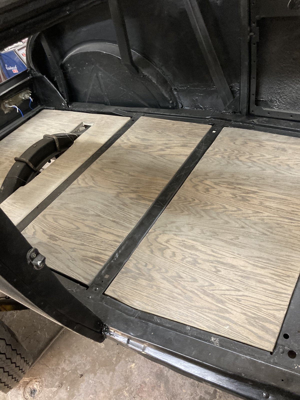

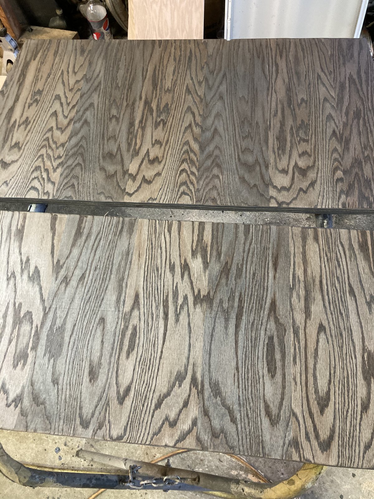

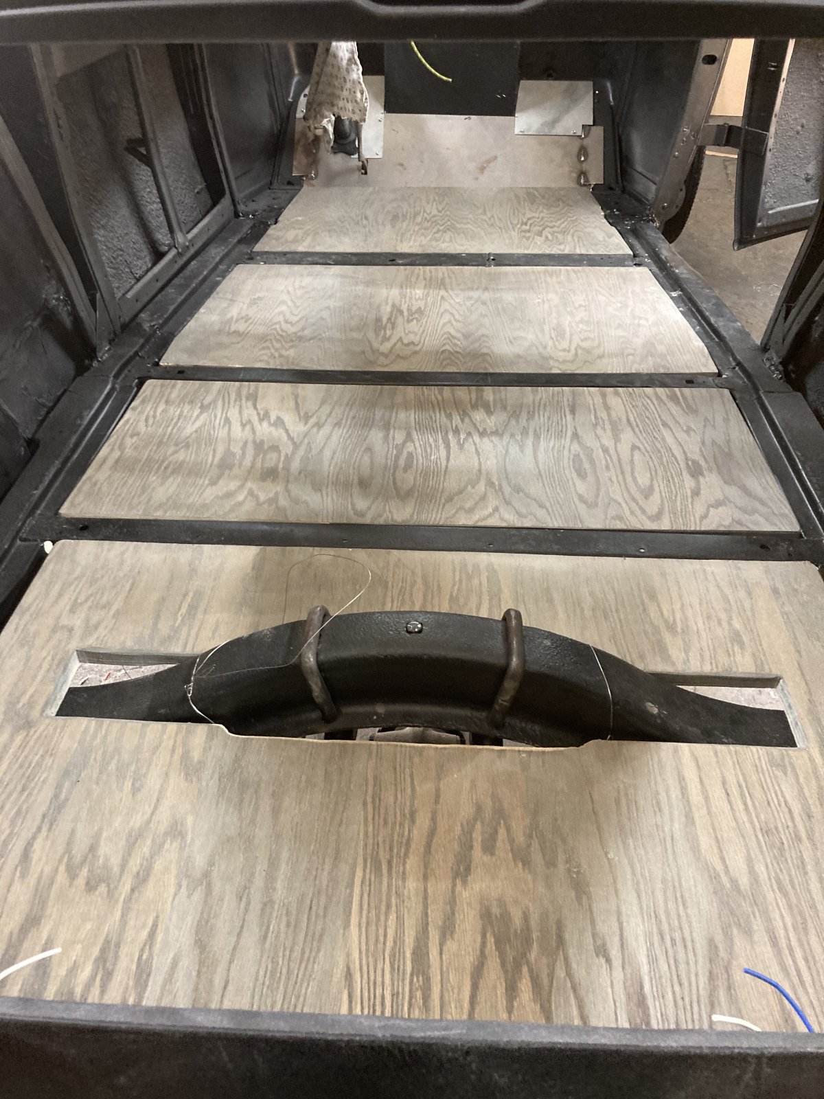

    Floors cut, sanded and stained.....
    ”slate” it’s called. Another big step done! No remarks about the garage! I know! It’s been neglected since I started building the coupe. Have a great weekend everyone!

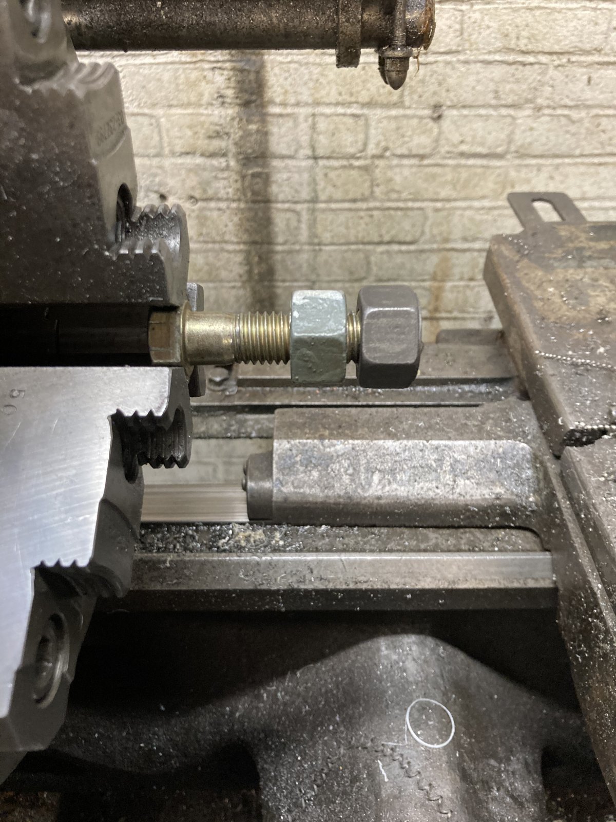

    Piewagn

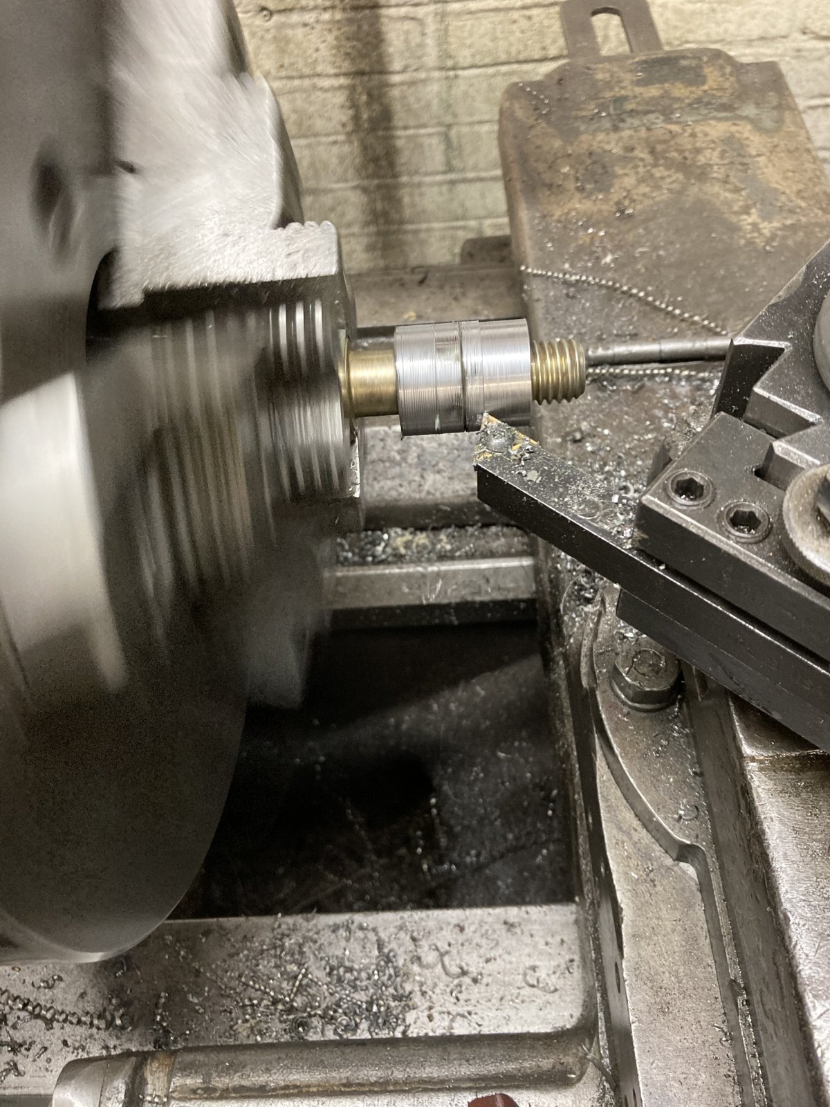

    Had to make female hoops for the transmission ends of the shift linkage....I’ll be welding them to turnbuckles so I can make my linkage adjustable. I’ll post pics when linkages are complete.....try and stay cool fellas!
    027B537B-F14B-435E-9579-E97E072ED028.jpeg 5E2EA72D-C818-4C01-96A6-97B4238D2890.jpeg 21A049D6-091C-4ED6-8A8B-655F6D1B9EA5.jpeg

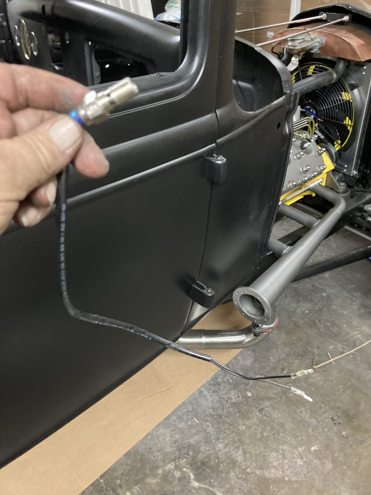

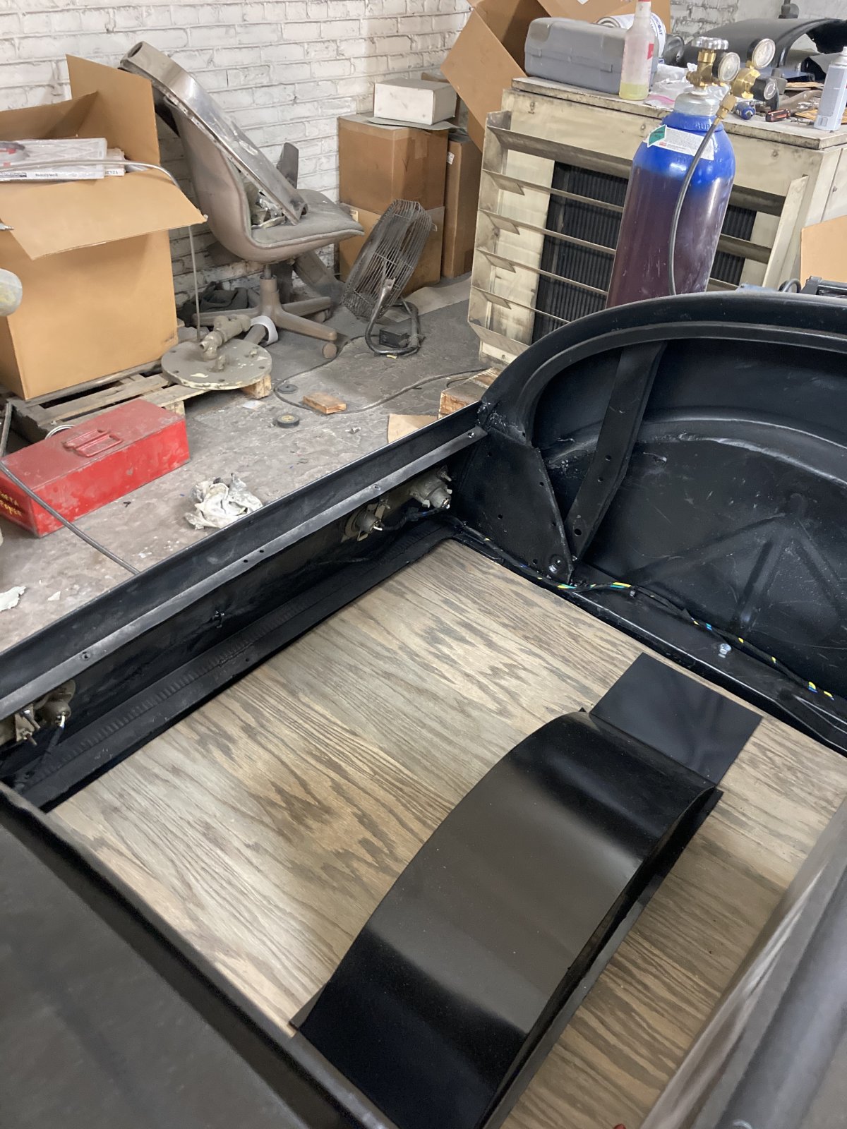

    Piewagn

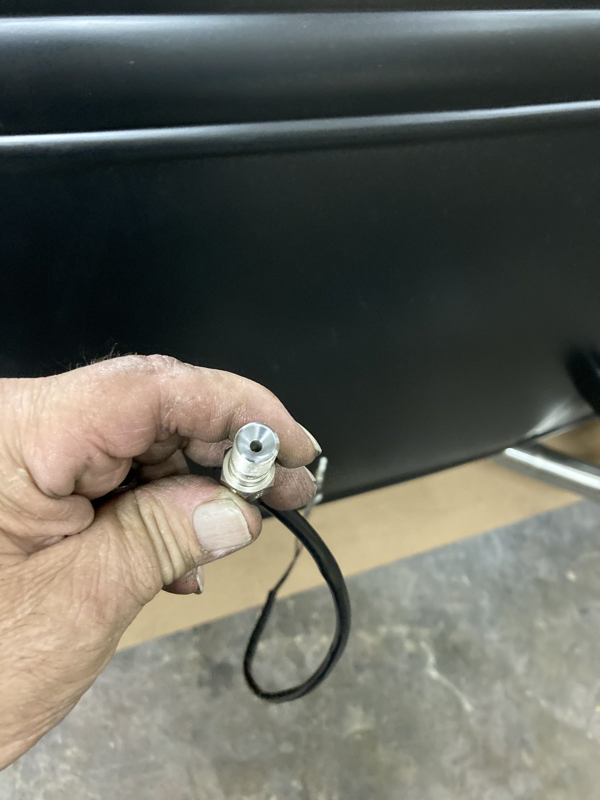

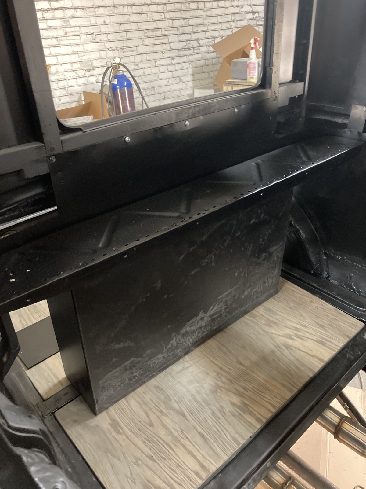

    Harley Davidson brake light switch! I did have to shorten it and put the inverted flare in it....should work great! Body mounts in and tight....now I’m mocking up gas tank location and frame cover panel. I’ll take care of the trunk firewall once I get the tank secured in it’s permanent home. Thanks for stoppin’ by fellas!
    F09A6D6A-C863-40C8-9C16-2704DF2EF4B3.jpeg 1793B198-66D4-44A6-AF0E-6D35FC32C258.jpeg 2685FE33-662E-480B-9D41-CAB754C7AB46.jpeg CAFE3E91-1ED0-4026-8598-BE2D176CA7A9.jpeg

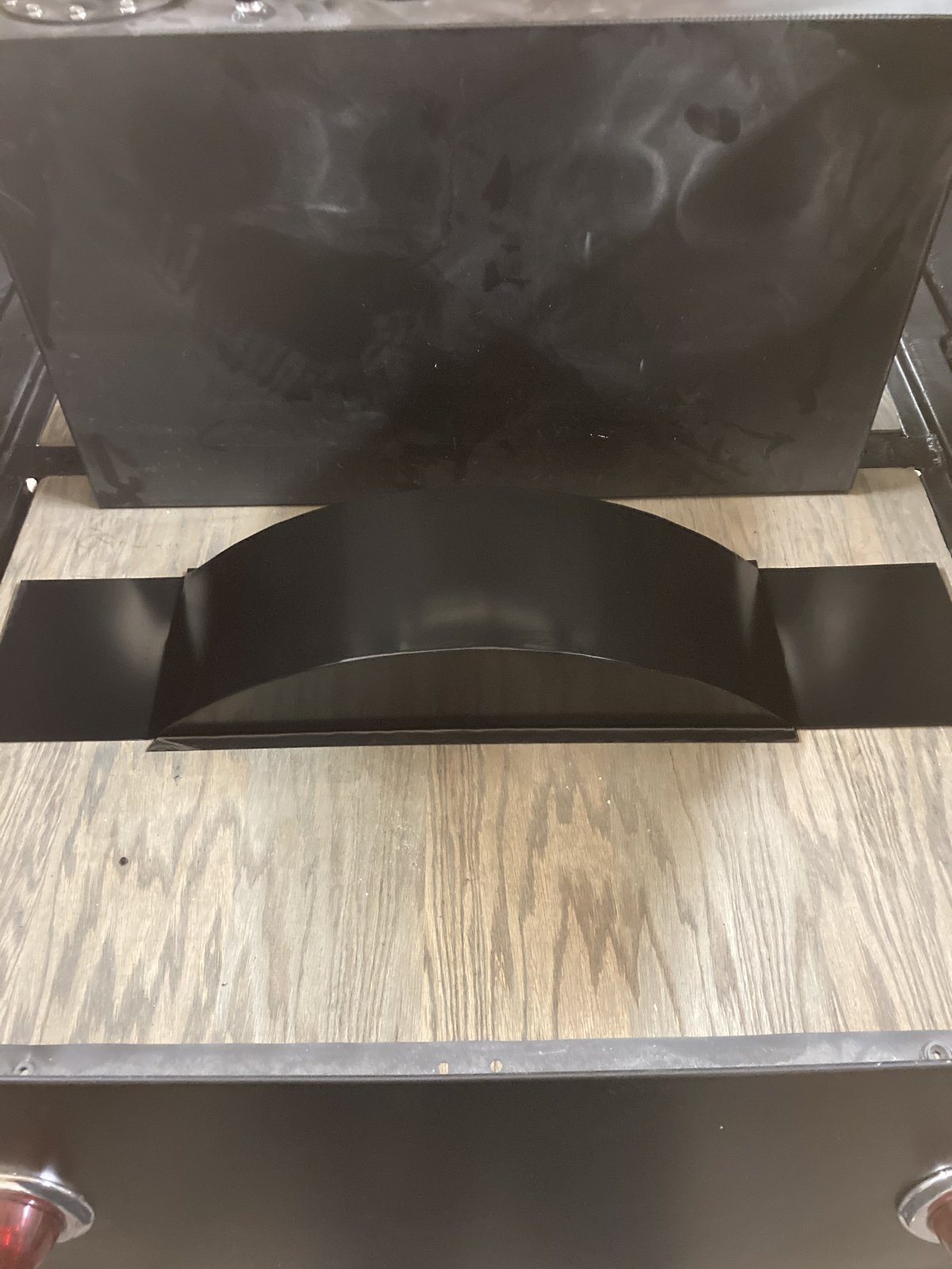

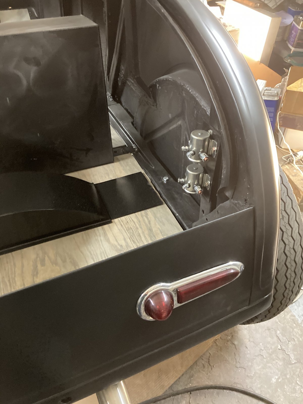

    Piewagn
    Heat shielding in place, finished the crossmember cover and mounted my main power switches.....rollin’ right along!

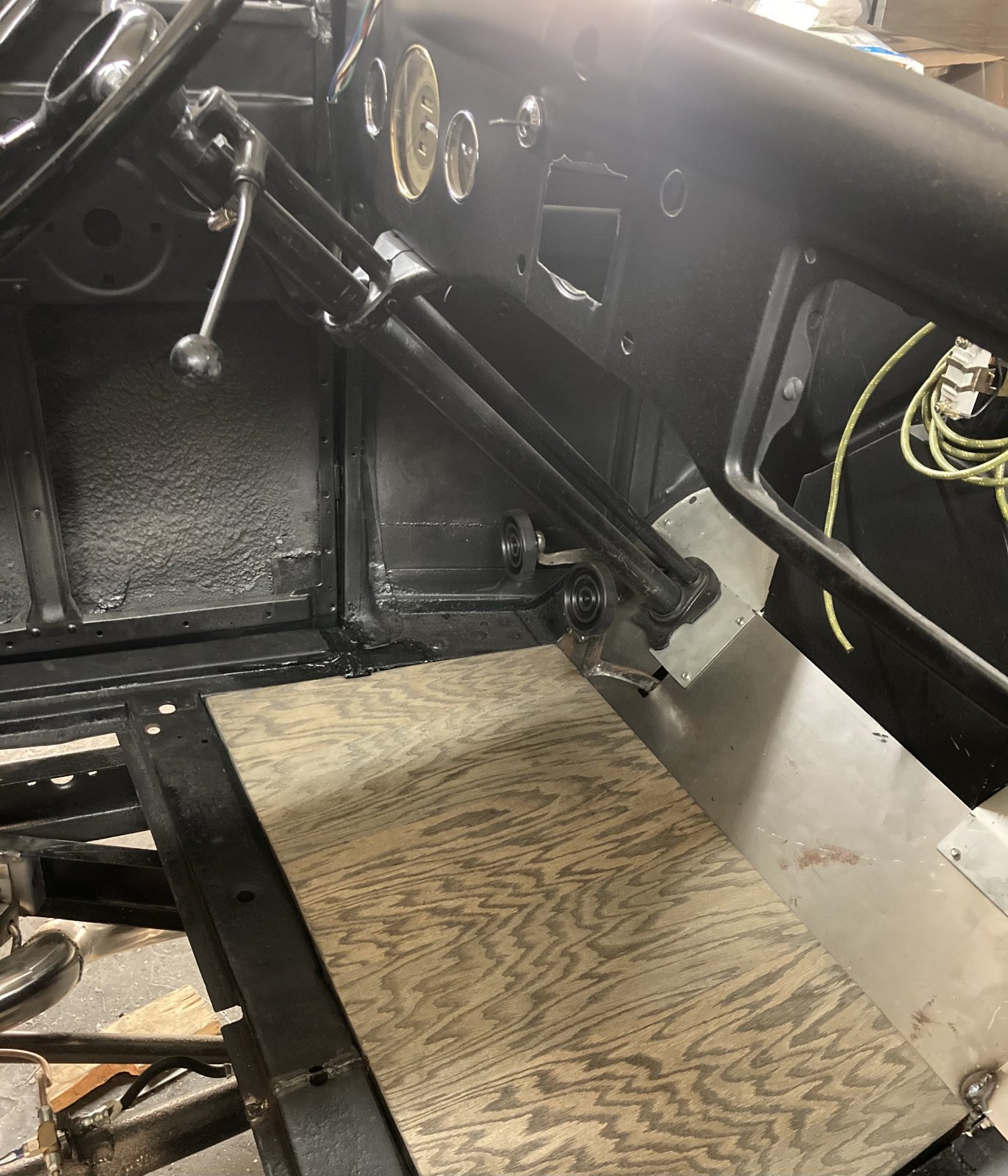

    Got my package tray blasted, painted and installed....also got my brake and clutch linkages hooked up and pedals sorted. They were hitting the column so they were in need of some attention....I’m just checkin’ sh*t right off my list! Stay cool everyone!

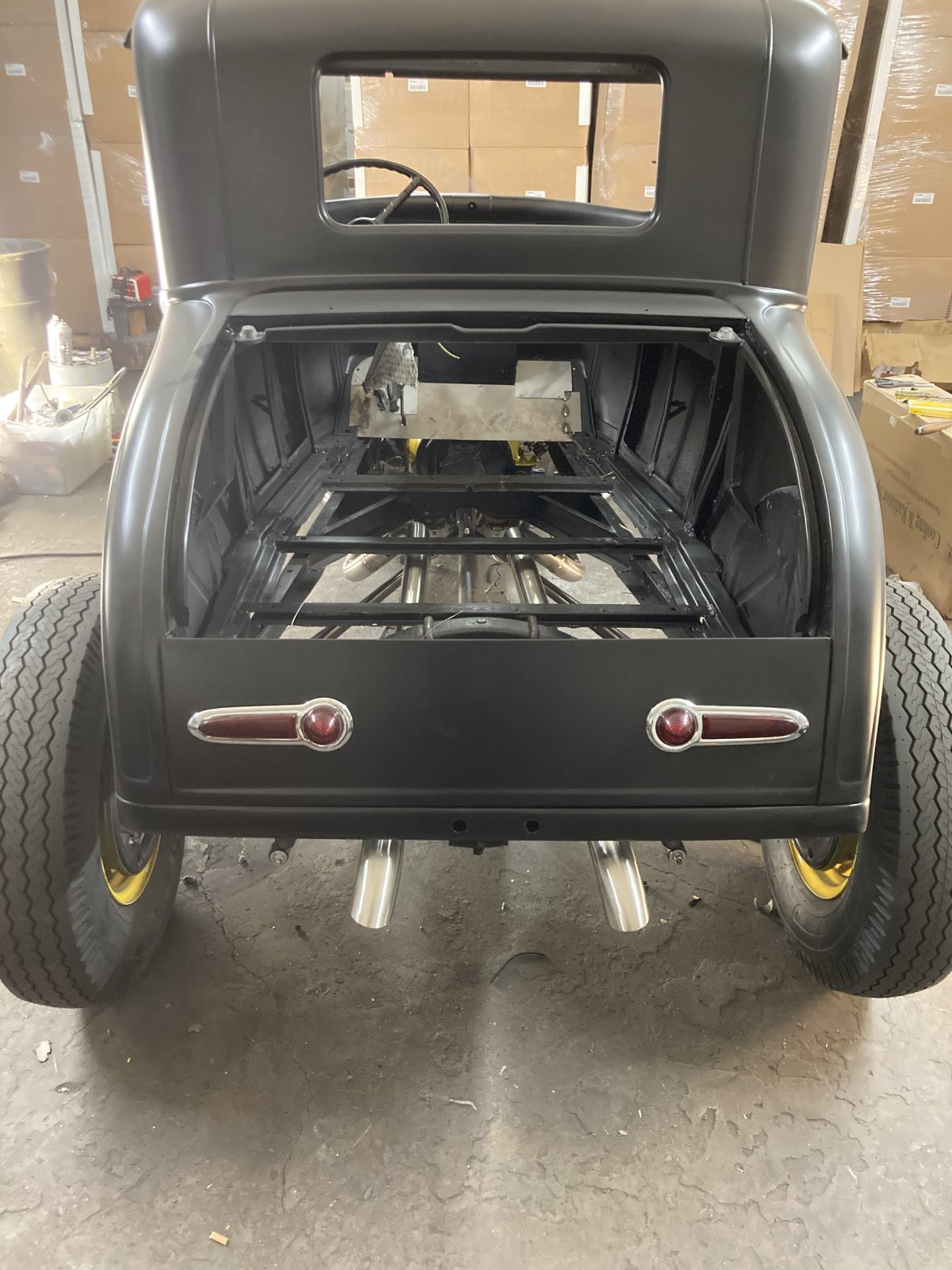

    Rear lamps secured and wired! I’ll run the fuel sender and pump forward in separate harness, I’d rather keep the lighting harness isolated. It’ll be all neat and tidy....have a great weekend everyone!

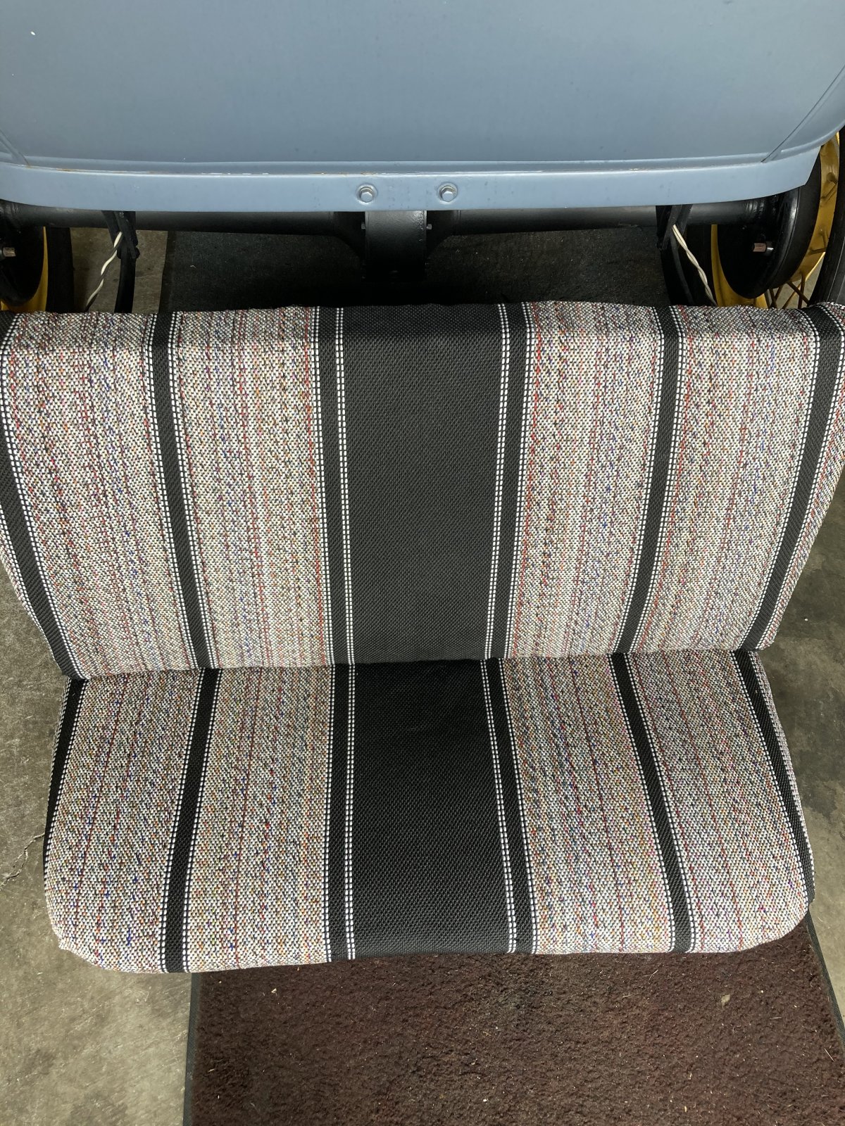

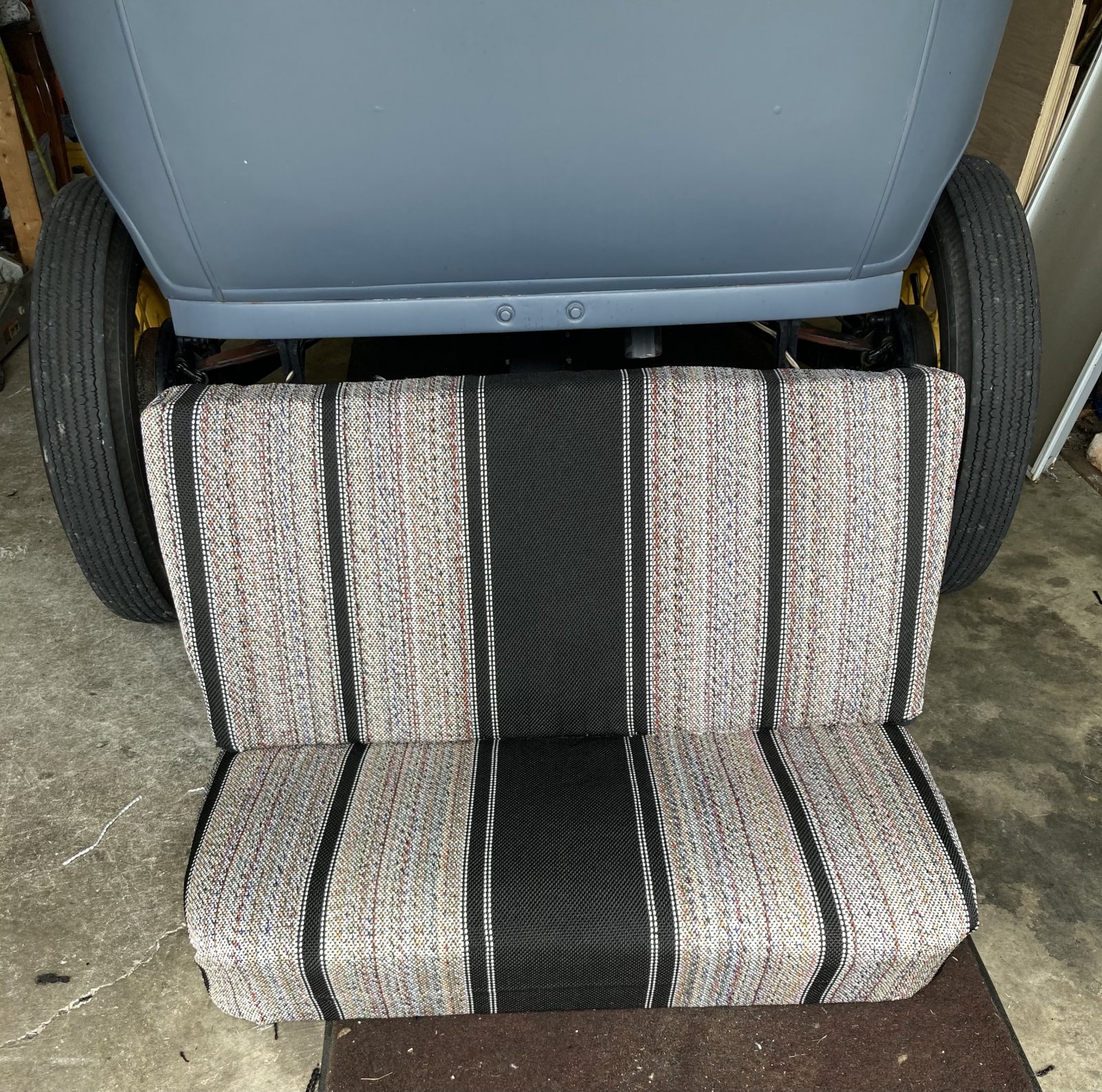

    Seat finished! This’ll do just fine...Just have to tidy up the frame and make some type of riser.
    7D9BDAF1-490F-4F01-BCEB-4C876505109A.jpeg 8D9010F1-4A47-45EA-AE91-5B07560456B6.jpeg

    Seat came out great. :)

    Thanks LB! I’ve sublet NOTHING on this build and have done everything myself, so I figured why not do the seats to....so I gave it a go....

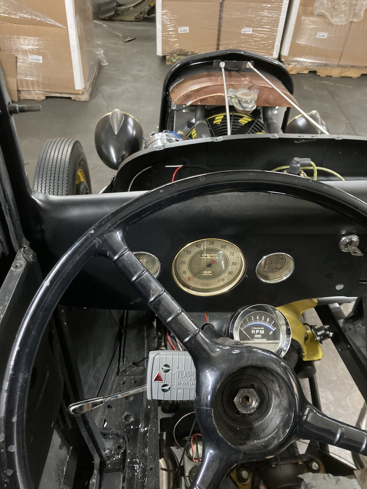

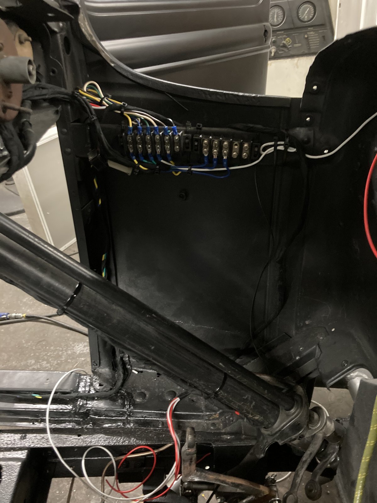

    Headlamps, brake lights and turn signals wired! The red and white wires will be going to my hi/low switch. Now as soon as my fuse block comes, I can wire my main power and B+ for everything! That little bit of harness between the frame and column is all you can see from the outside.....the inside will be just as invisible when I’m done..... have a happy!!
    2024084F-6F1C-42BB-981C-7473AC148B09.jpeg 57A04F96-B25B-4250-9E51-A914DFC4ED9D.jpeg

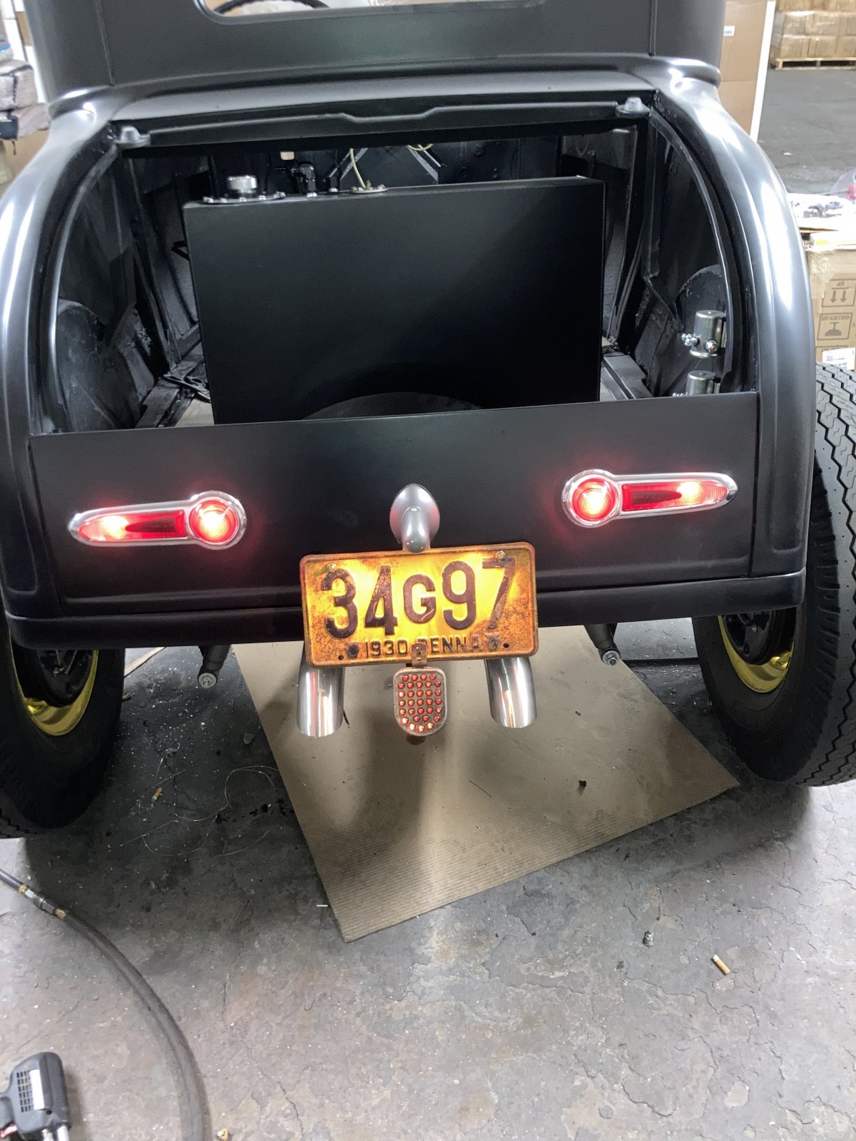

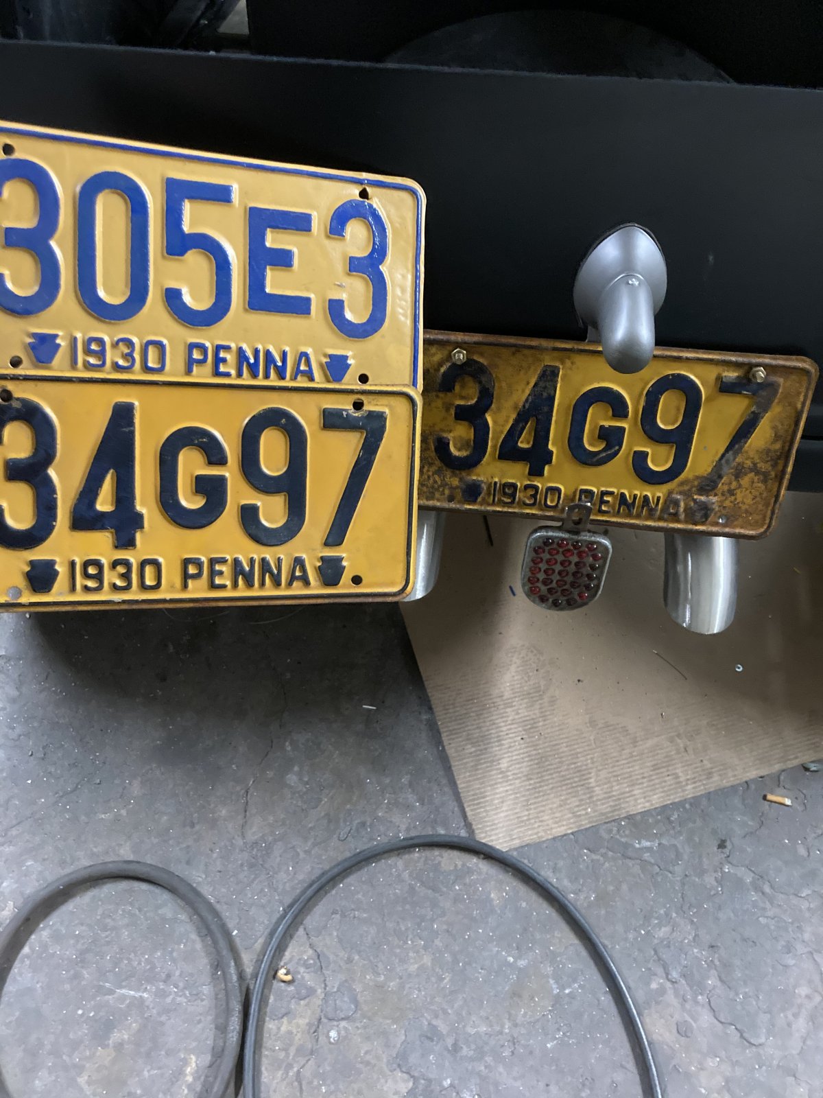

    Made my own lic plate bracket, it also accommodates the Chevy tag lamp ***embly! Made a gasket for it and tapped into the park lamp circuit. I’ve knocked a huge chunk off my check list.....the remaining list is getting smaller .....that much closer yo driving!
    Ok....want a couple opinions from you guys. Leave the vintage reflector? Also, which tag do you guys prefer? I’m kinda partial to the crusty one. Whaddya you all think? Thanks fellas!!

    Crusty. Definitely the crusty one.

  22. I vote crispy plate. I've been patiently waiting to see your tail lights lit up. Brilliant on the ****m, I may poach that idea. So close, keep thrashing
    Piewagn, Nicholas Coe and loudbang like this.
  23. I vote crusty plate, no reflector.

    I’m thinking crusty too! Poach away bro! That’s why I shared the idea!!!

    Yep....crusty plate is popular....everyone split on the reflector....maybe I’ll hang it every other cruise....

    Crusty and reflector :)

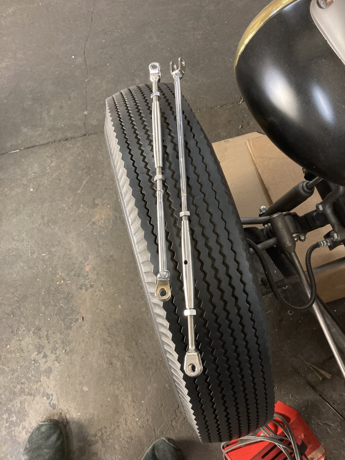

  30. Piewagn
    Joined: Mar 25, 2009
    Posts: 1,542
    Piewagn
    Here is my custom shift linkage I was telling you about....adjustable and all!!
