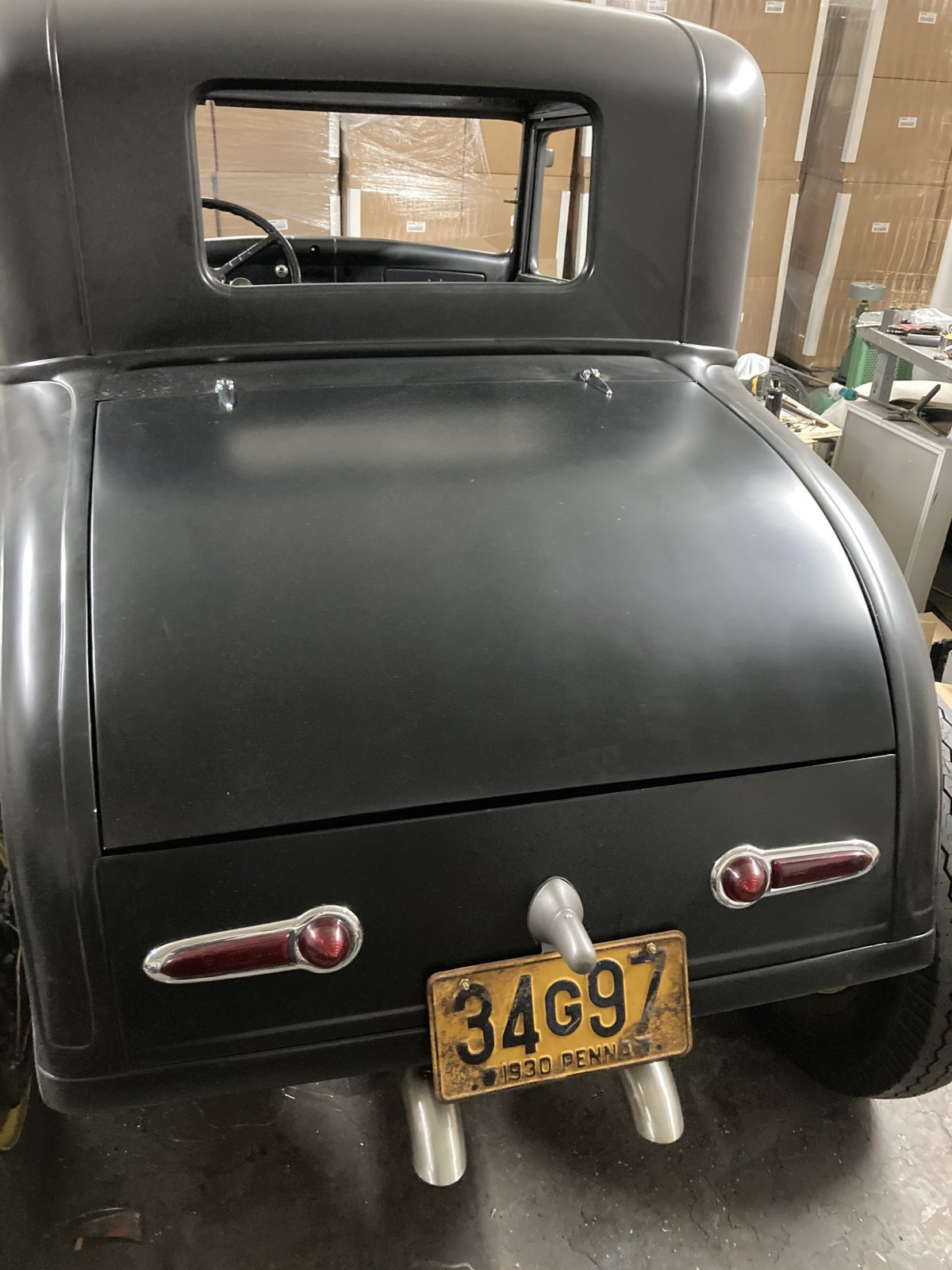

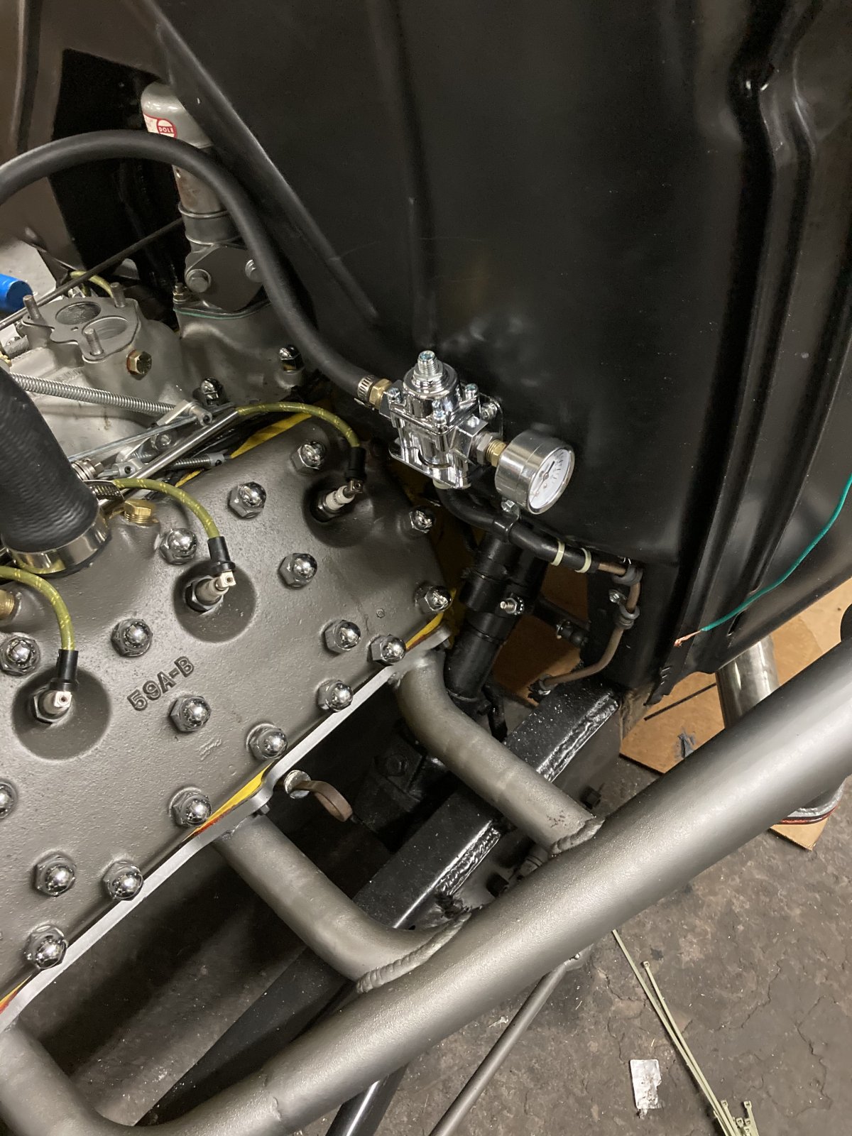

    Installed a different fuel pressure regulator, the last one just was just dumping fuel...hope this one cures it. I put one of these in my truck and it worked well.
    Finally hung the deck lid. I’m surprised it wasn’t a casualty of just sitting around and working around it, I thought for sure I’d be reworking it!

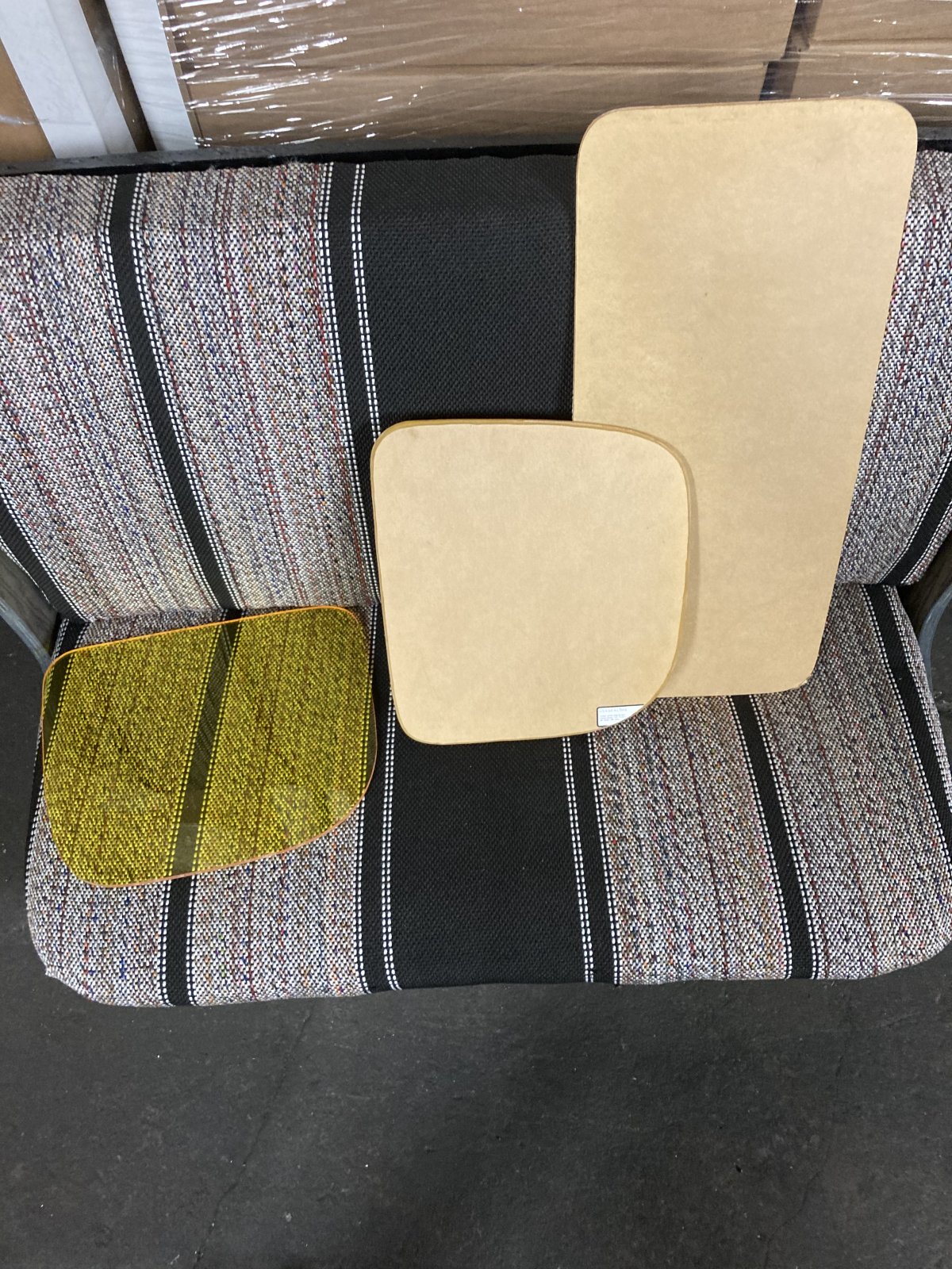

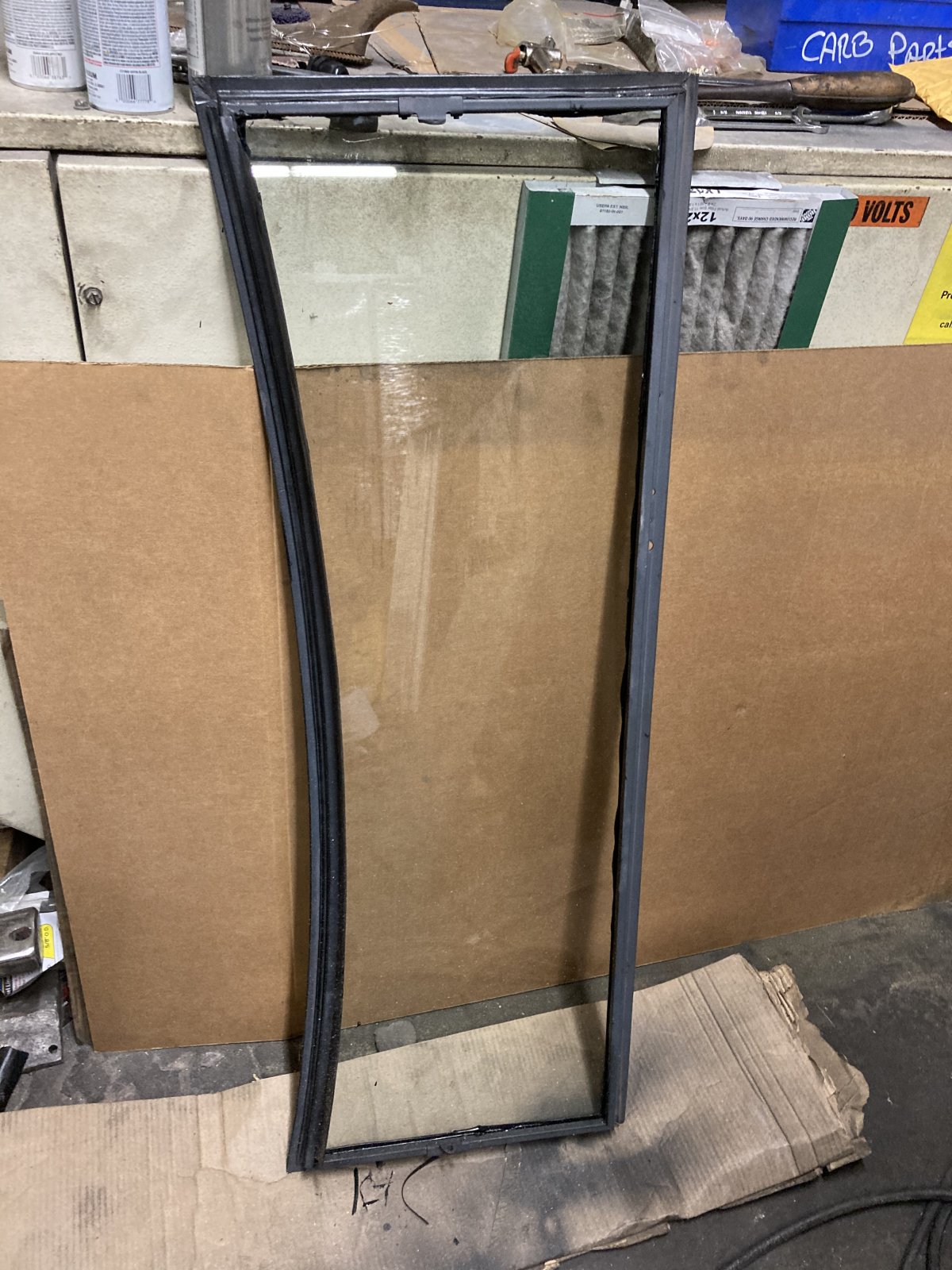

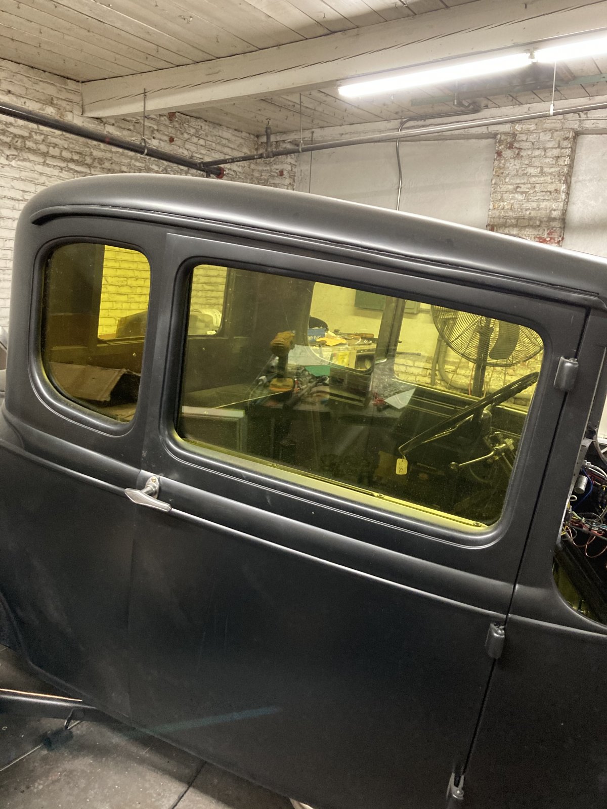

    It’s time for windows!! Got everything cut and door gl*** tinted....windshield installed in frame....I’ll be driving soon I hope! Hope everyone is having a great night!

    ******** mud dauber had one of my bowl vents plugged up....I saw gas coming out of the accelerator pump nozzles, I new it was "pressurizing" the bowl....with a clogged vent, the air had nowhere to go! led me right to it!....she's running a treat now! Finished the gl*** and changed the oil. Headed to the notary tomorrow...I'm guessing another week! I'll finish the interior once I get it home!

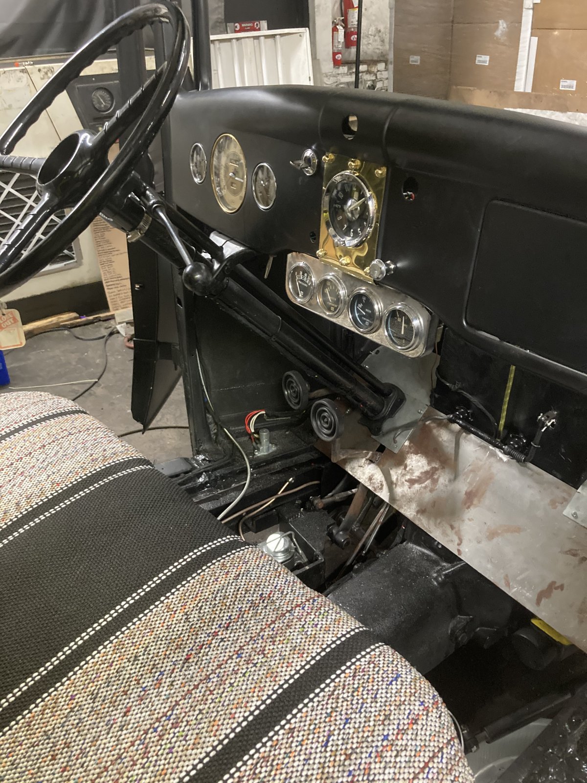

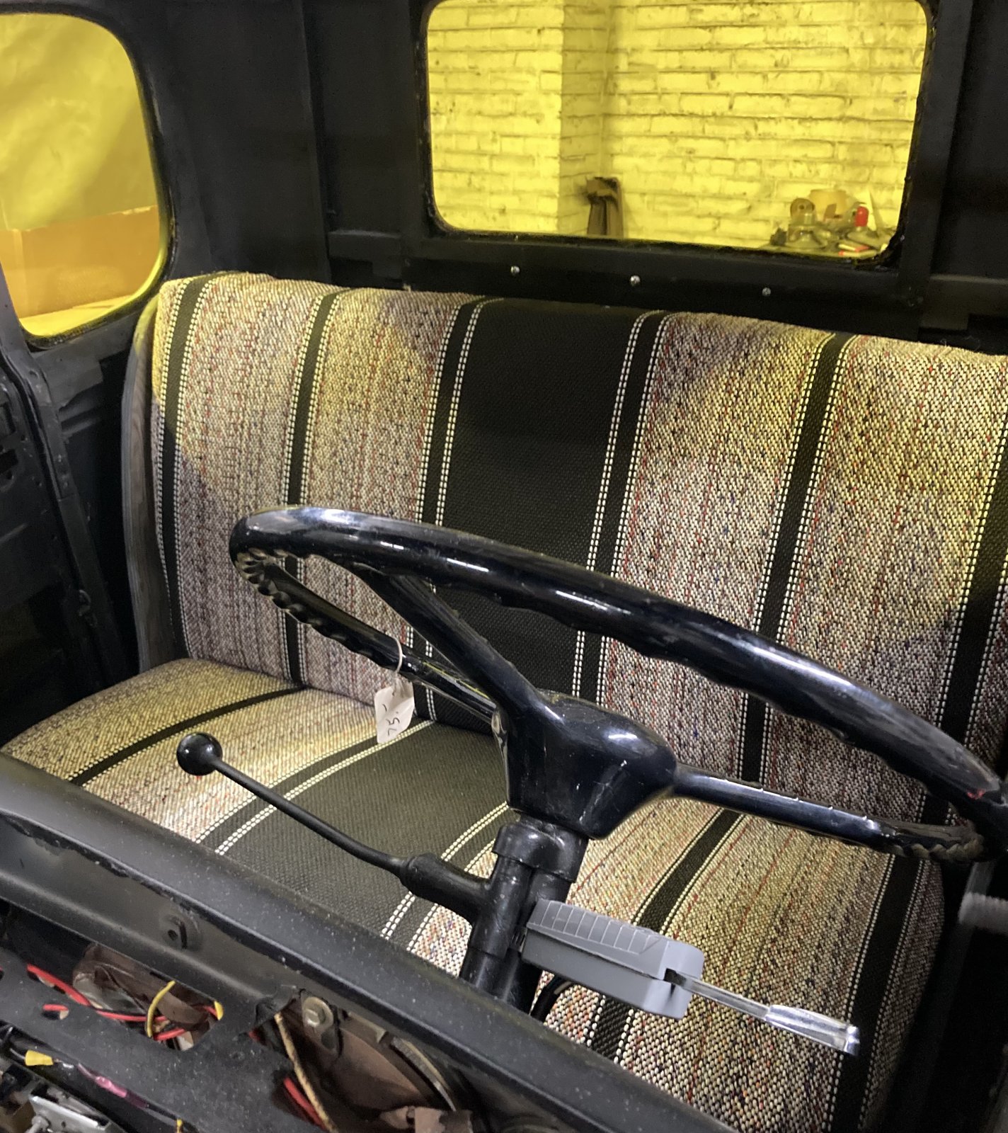

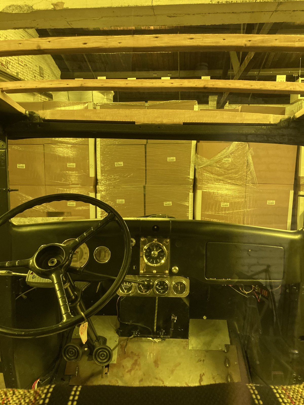

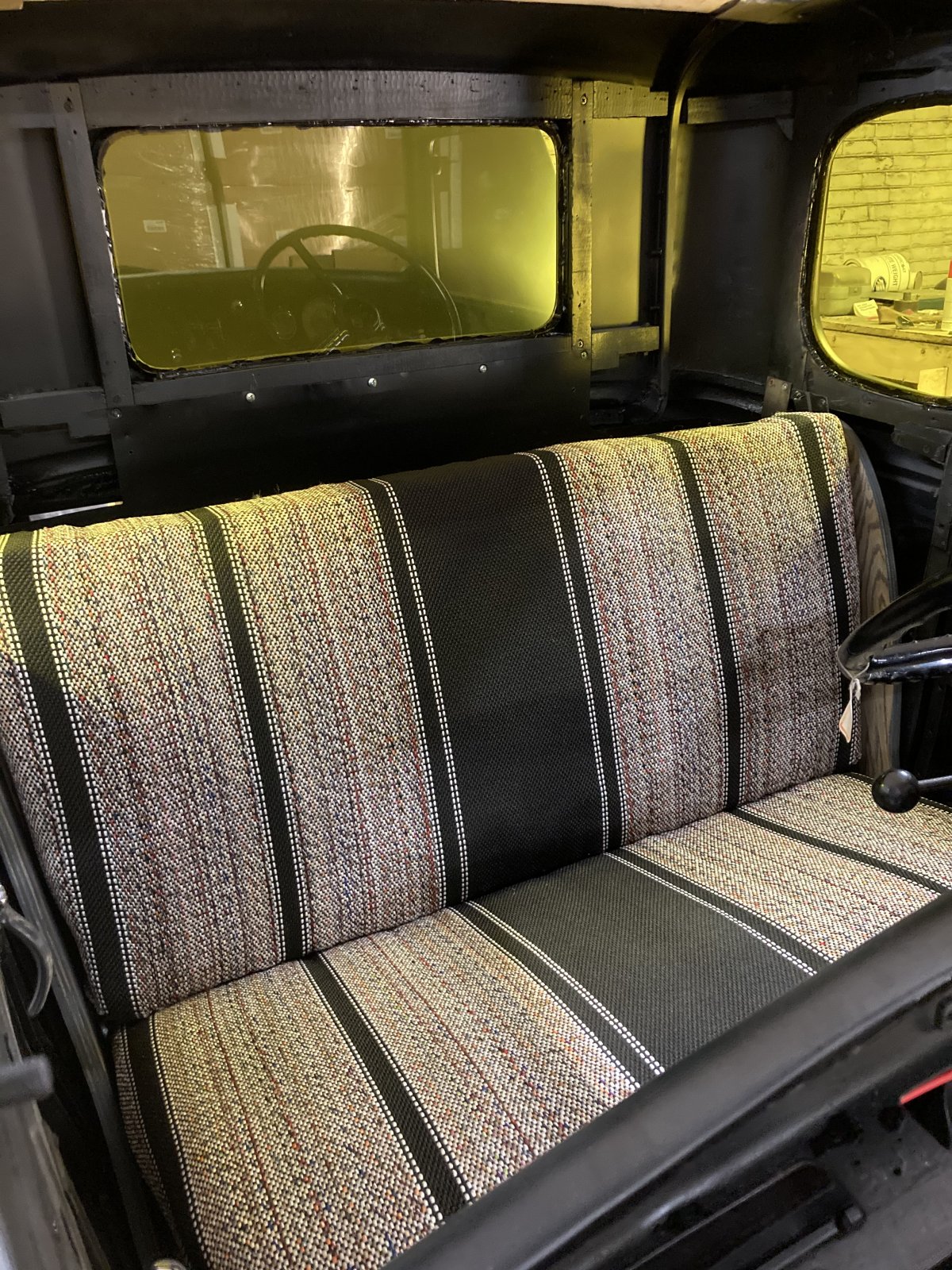

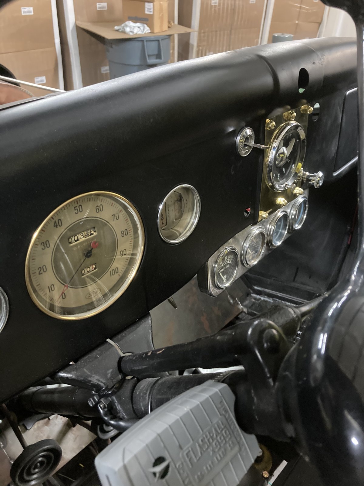

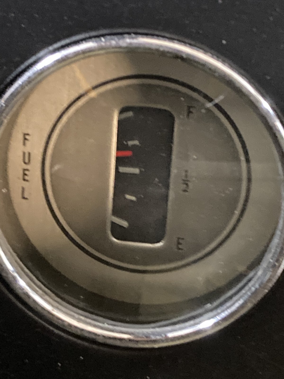

    Seat is in! I just have to secure it.... I modified a ‘63 Fairlane fuel gauge to fit into the ‘36 housing....and it works!! I’m so close I can taste AND smell it!! Thanks everyone for hangin the past 2 years! I’m still having fun....that’s what it’s about....it’s a roller coaster ride!

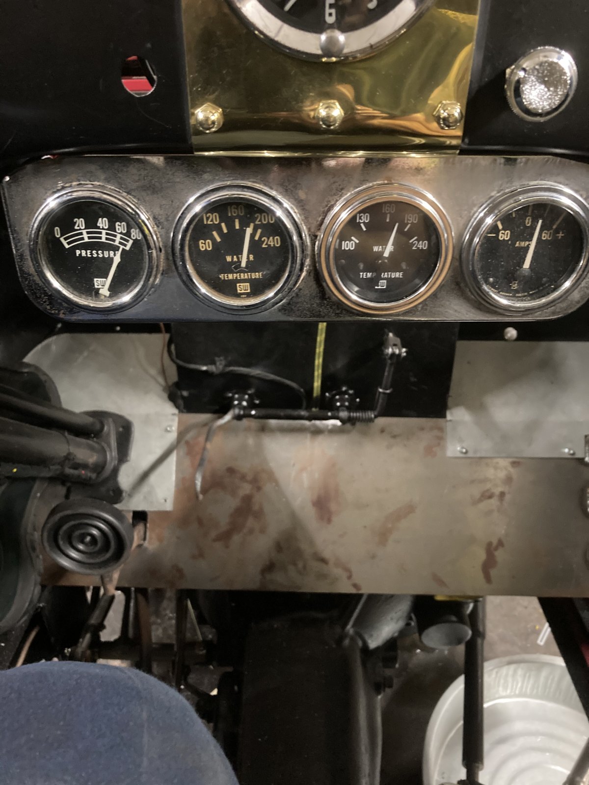

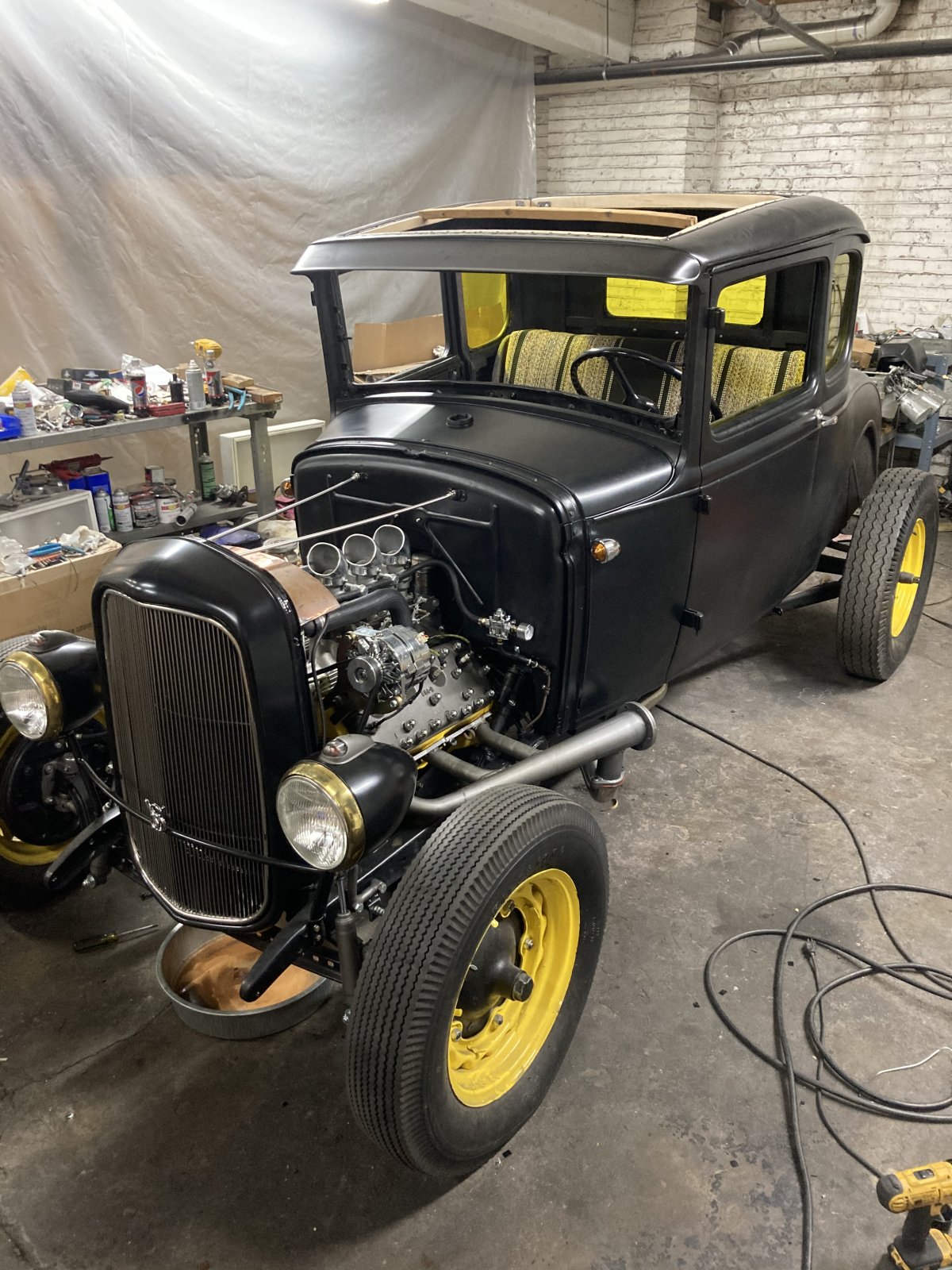

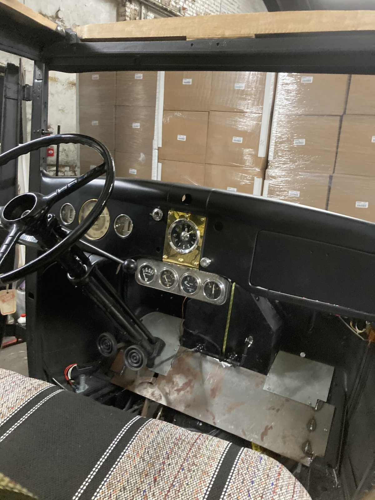

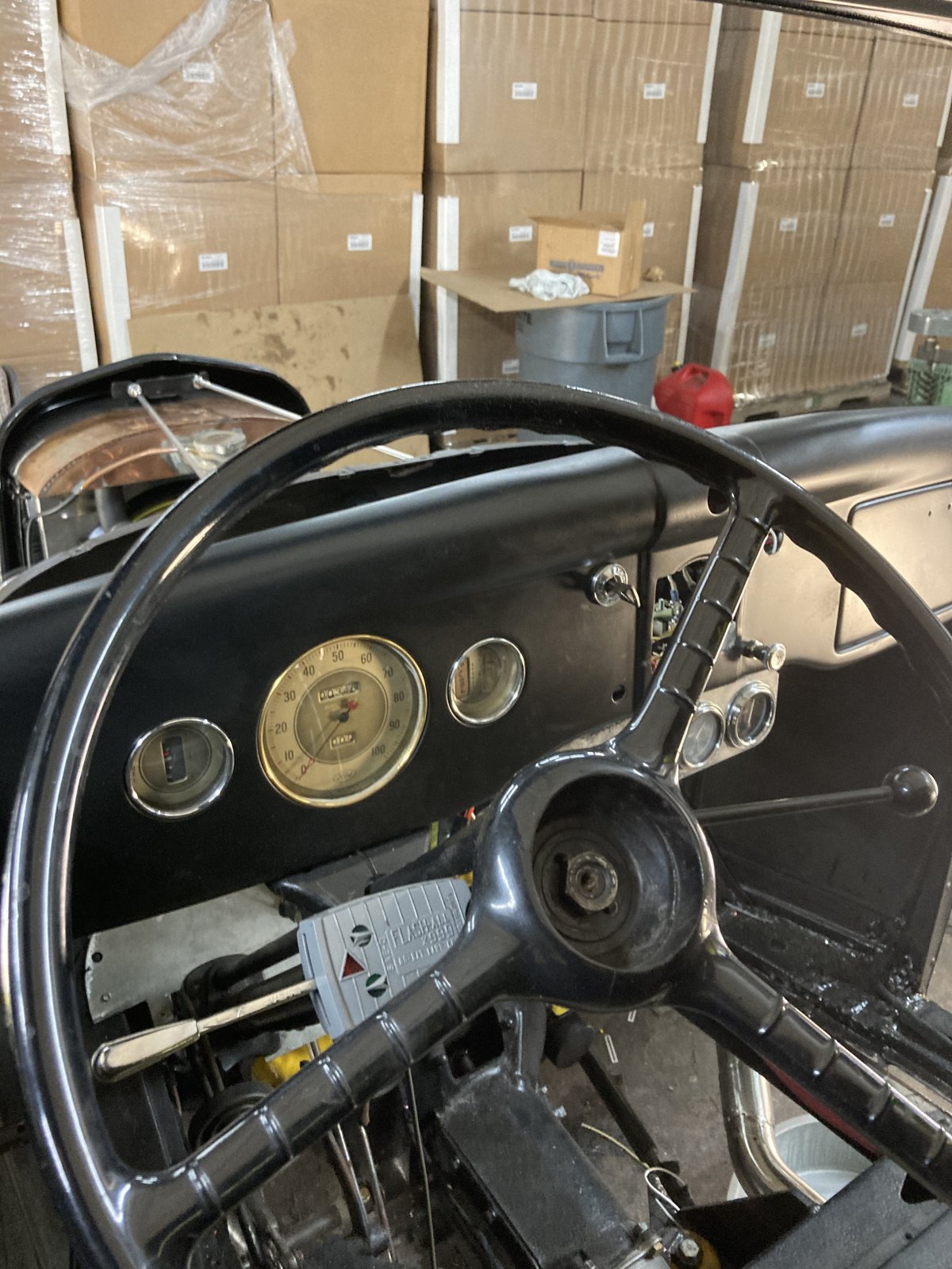

    No more gaping hole in my dashboard!! Finally installed the clock I picked up at Carlisle....I’m fairly certain I’ve got the temp gauge situation settled....R/S runs hotter than the left....they both match my laser thermometer .....high idle about 20 minutes..... I did install thermostats and it drastically improved the puke issue. Still need to make a puke tank though. Other than that, I think I’m good! Thanks for hangin’ everyone!!

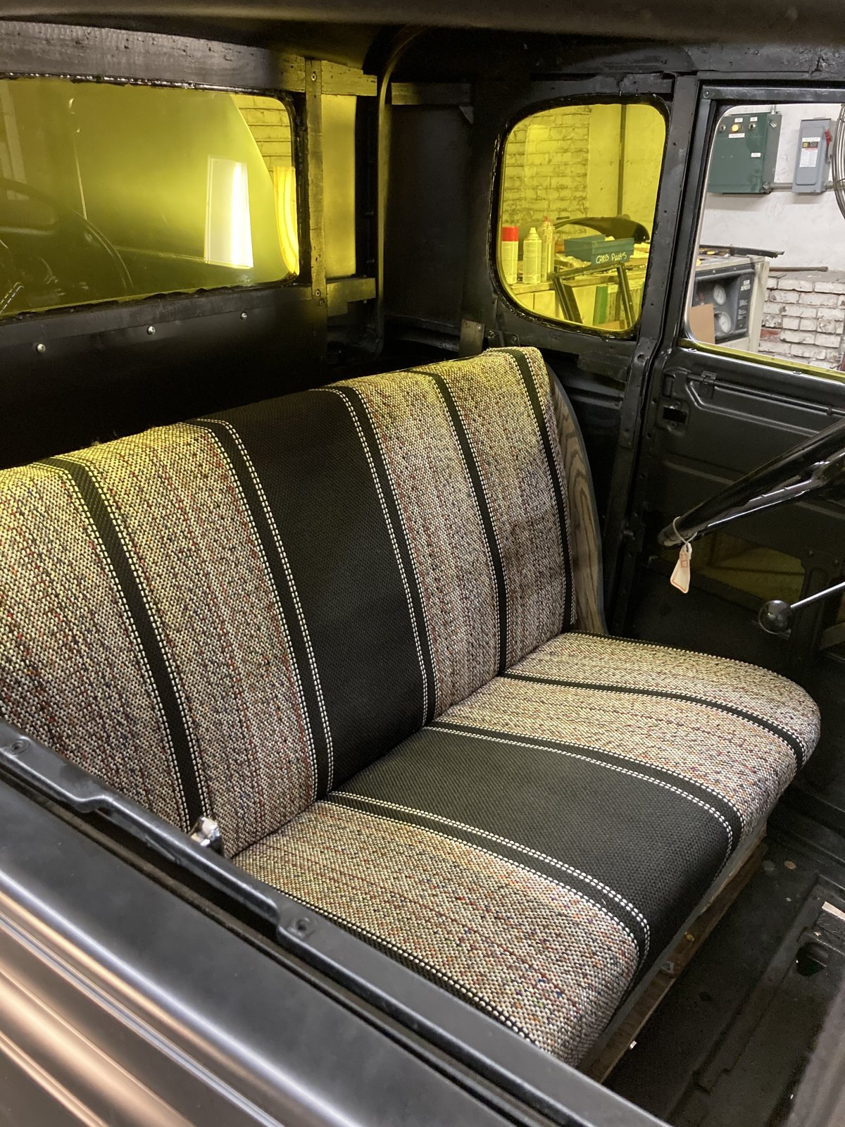

    Seat finally mounted!! Got it in a good comfortable position and I can even hang my arm out the door!!
