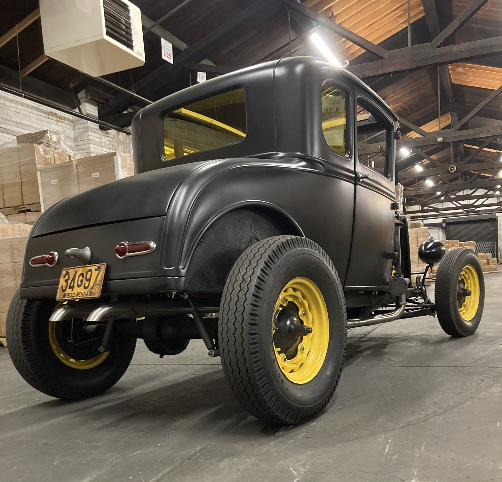

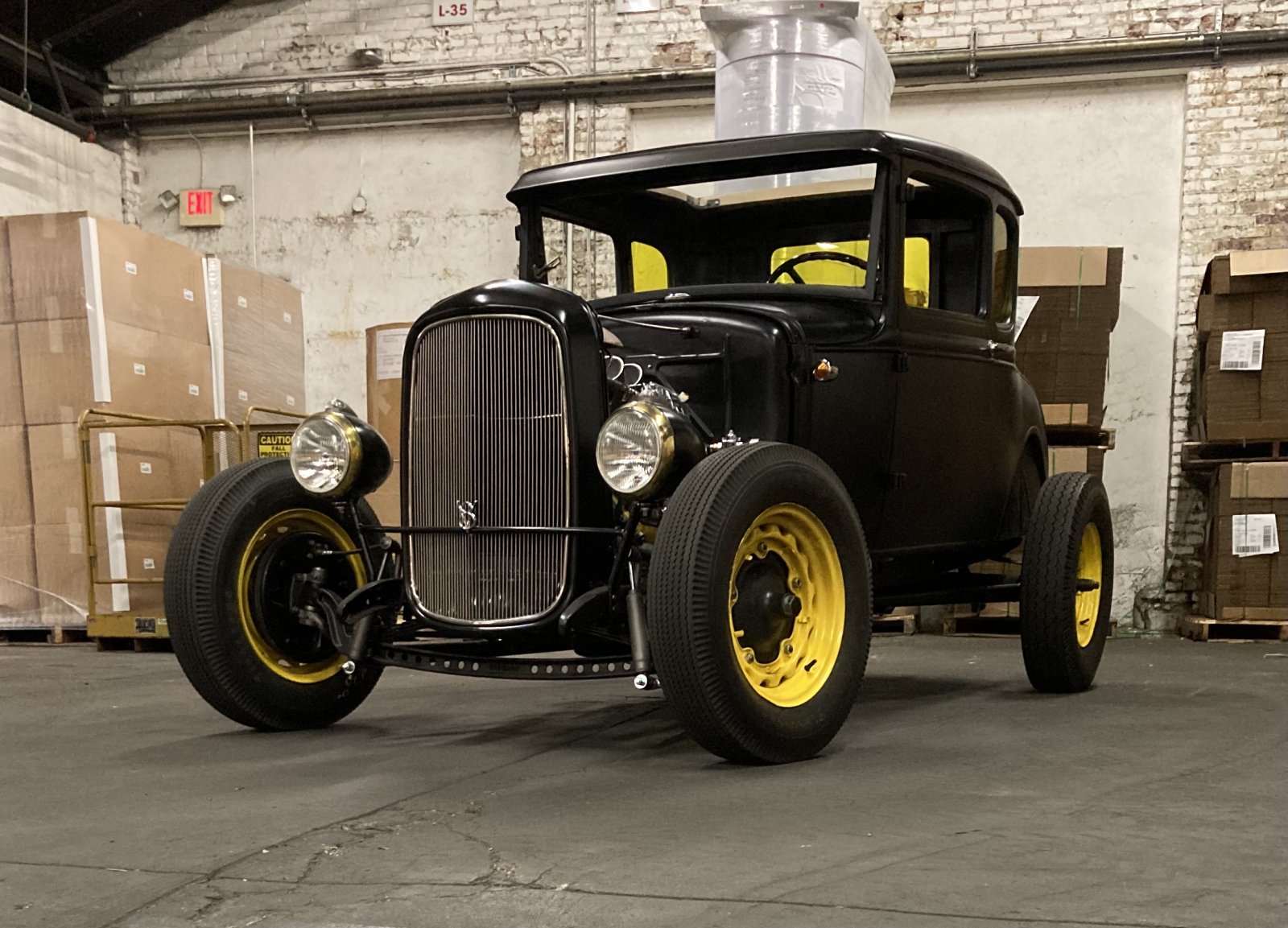

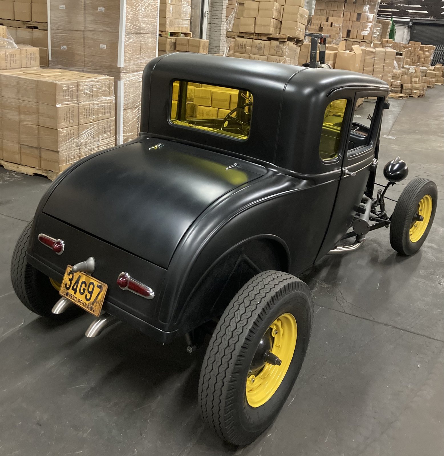

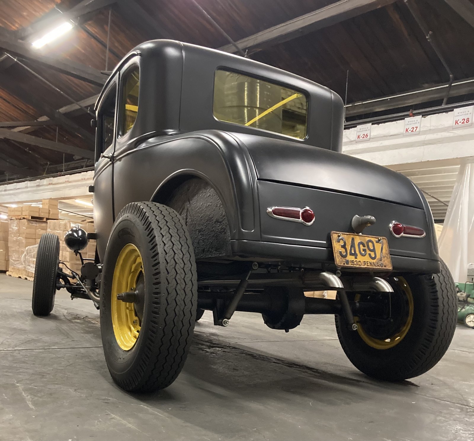

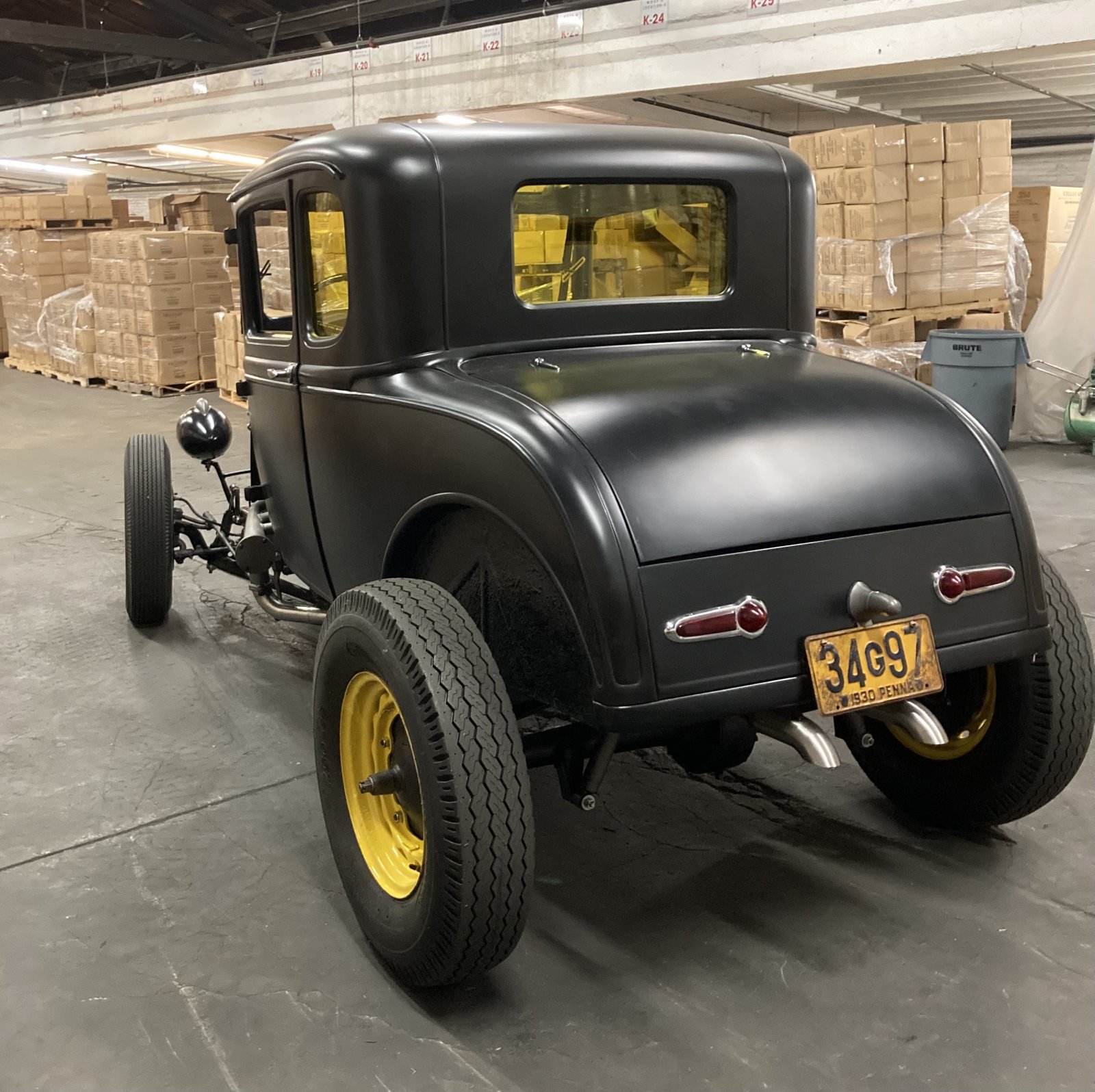

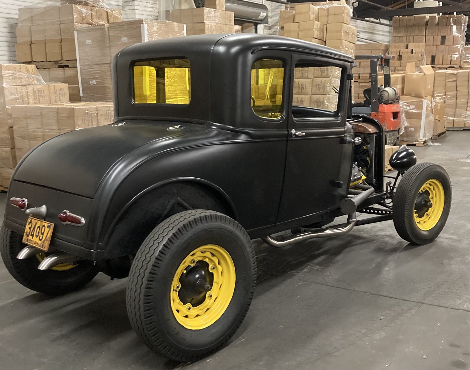

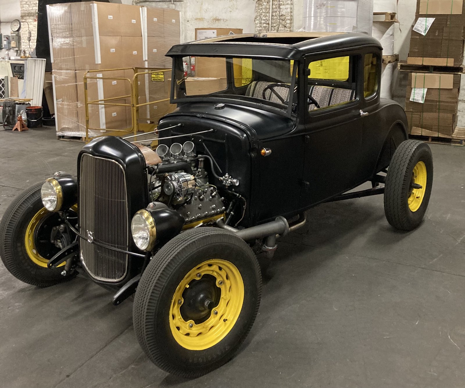

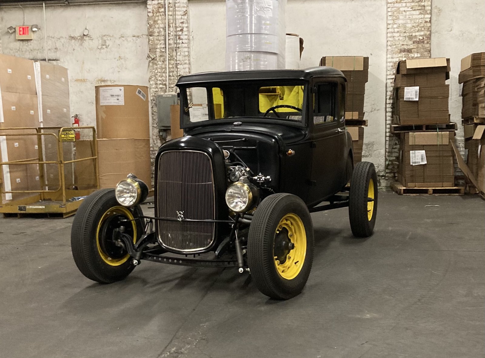

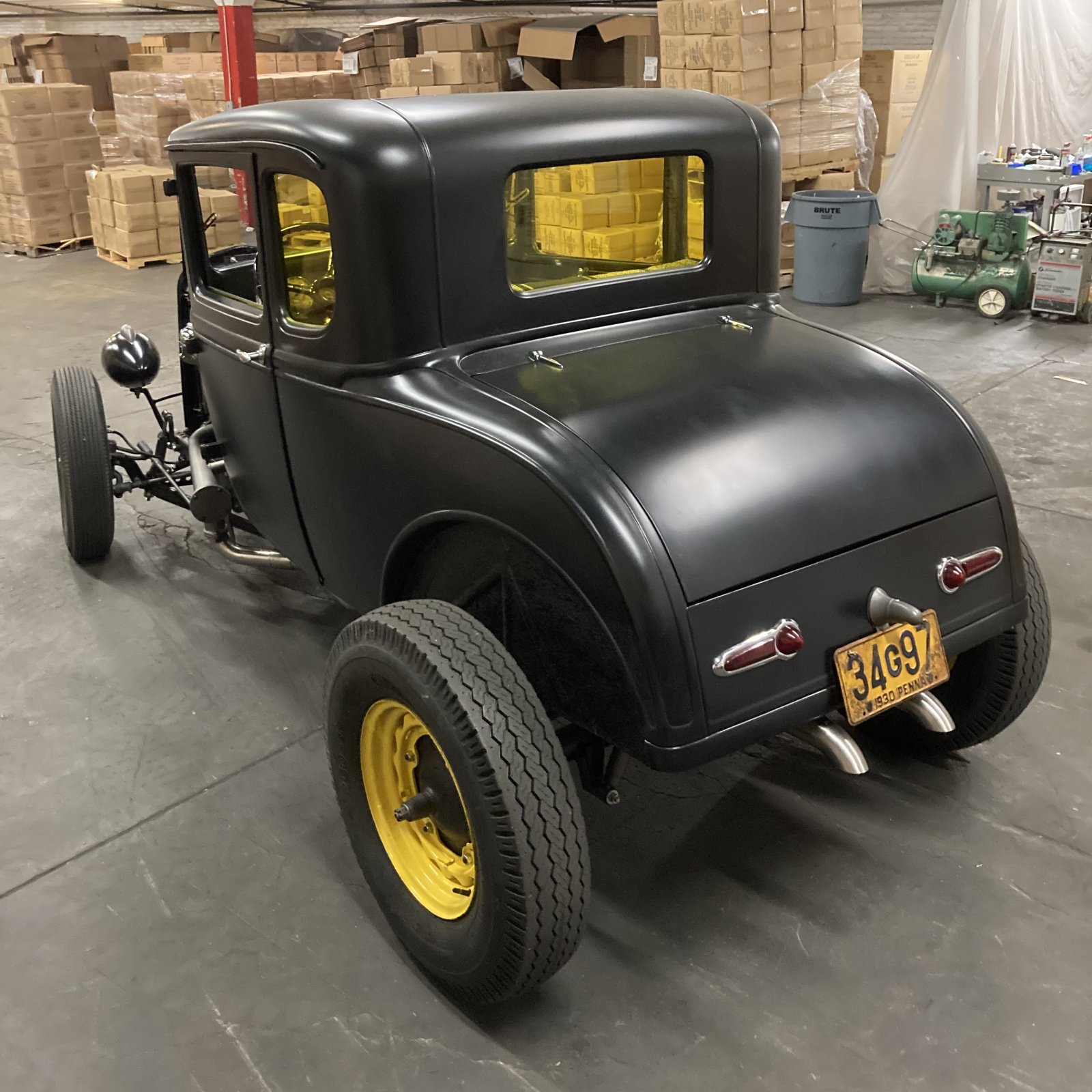

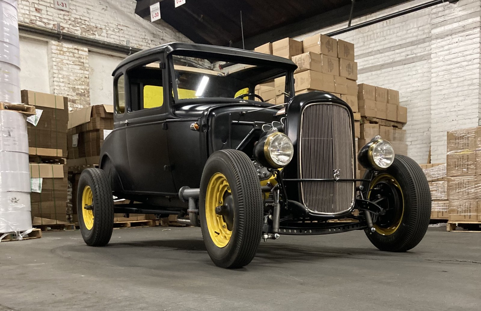

    Windshield in! Need to find all the interior garnish moldings and make some nifty wingnuts for the windshield locks....REALLY ****ty brake pedal....must still have some air, real gushy. Still not ready for the ride home, but I’m hovering over the landing pad! Thanks for all the encouragement fellas!

    I had to order residual valves for the brakes, totally ****py pedal....I’ve bled and re-bled....and from my deduction, with the master lower than the wheel cyls, there’s nothing keeping the fluid in the cylinders.....I’ll get there Mart and take everyone along for the ride!

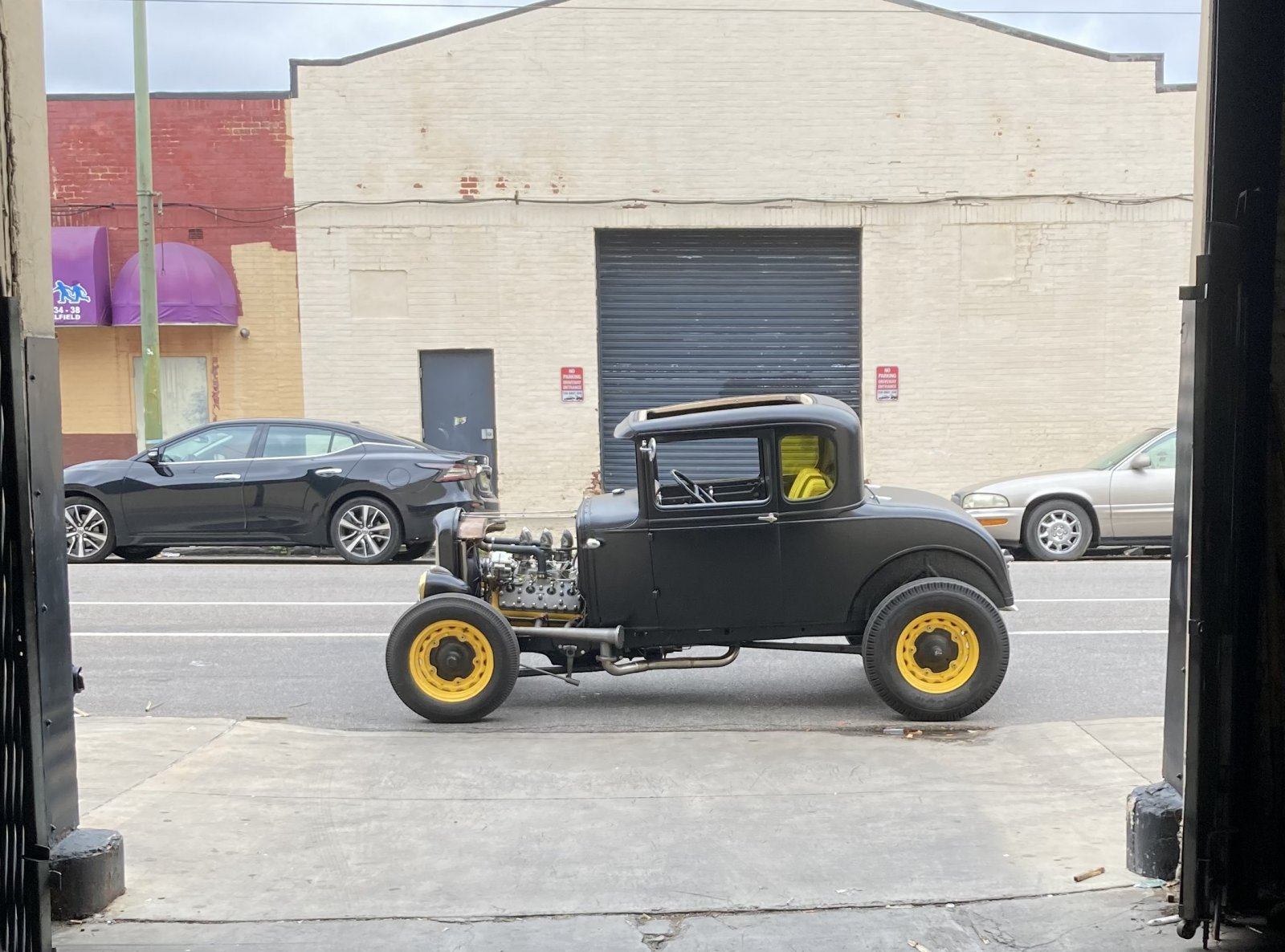

    Well Os.... I got ‘er home on a flatbed.... I just can’t do the tinkering I need to do when I’m constantly watching the clock.... Overheating and some driveability issues that need to be sorted. Unfortunately, I have to remove the that kick *** radiator....started leaking like a sieve as soon as I added a 4psi pressure cap. I wanted to wait until I had everything sorted before I do nice cruise video....I’ve had it around the block and she goes straight and true with zero bump steer....I’ve ordered a radiator and a new set of front tires.....you guys will be the first to get the video when everything is sorted. I absolutely appreciate the interest and added motivation.....hopefully by next weekend it’ll be good to go....will keep you all posted!

    ****py video.....but I'm posting it anyway! She drives wonderful! 3 on the tree works flawlessly....as I said above, straight and true down the road with zero bump steer! I couldn't be happier with how it rides..... Still have some driveability issues to sort, I think my fuel line is too small not allowing proper fuel volume. I addressed the leaky power valve, carbs stay nice and dry when shutting down with no bleed out. I installed a 1-4psi Holley fuel pump and had someone convince me to install a pressure regulator too. With the combination of the 1/4" line and the regulator, gauge is reading no more than 1.5psi..... It's got a lean "pop" until you get into the secondaries and it clears up. I have some 3/8" line I'm installing and removing the regulator and we'll see how it goes.....thanks for letting me ramble fellas, I'm slightly jazzed!
