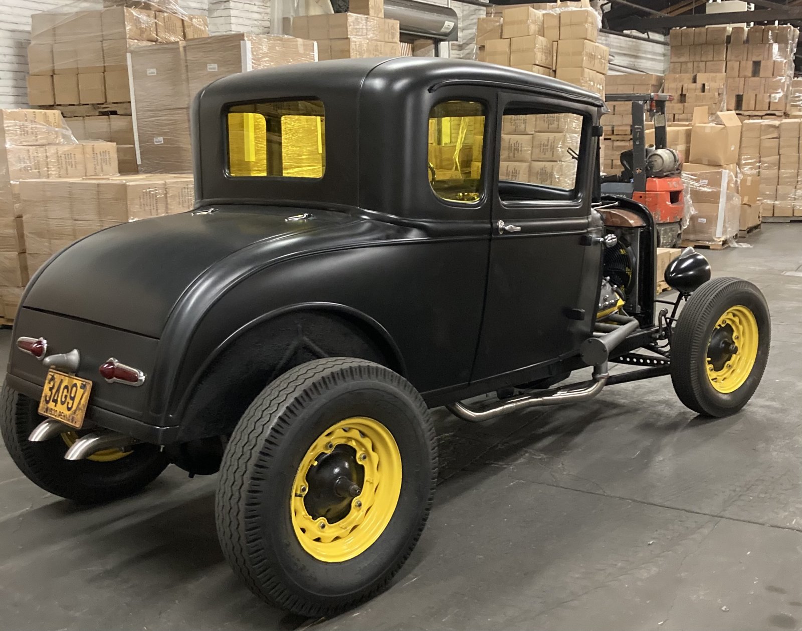

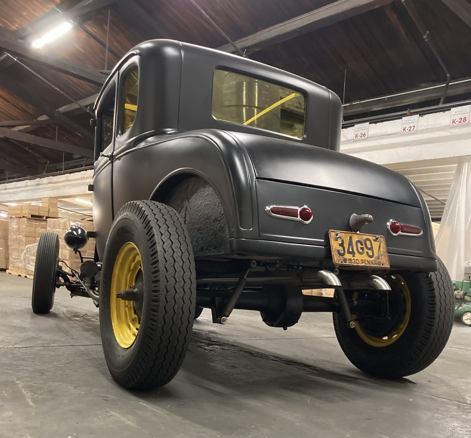

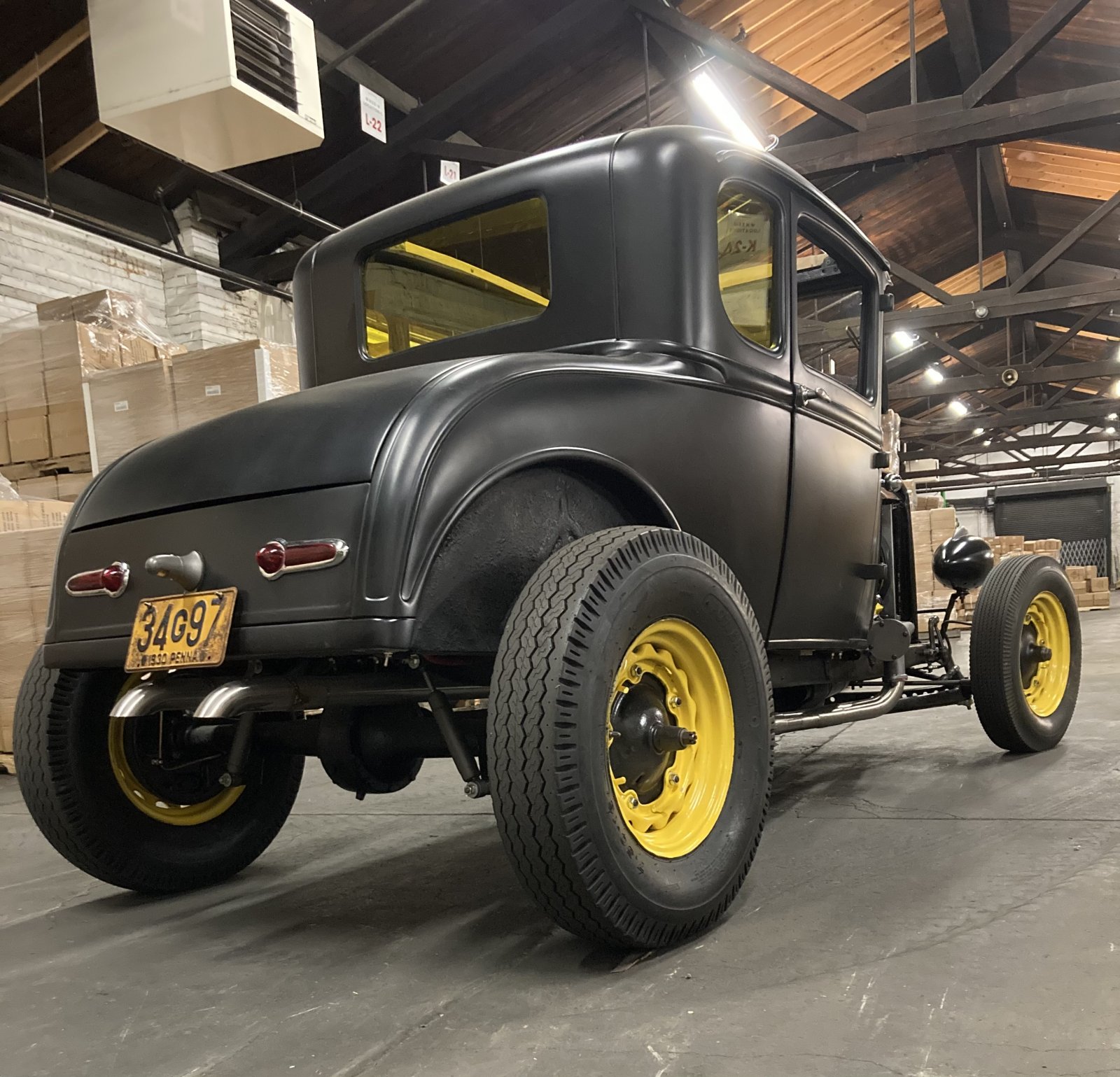

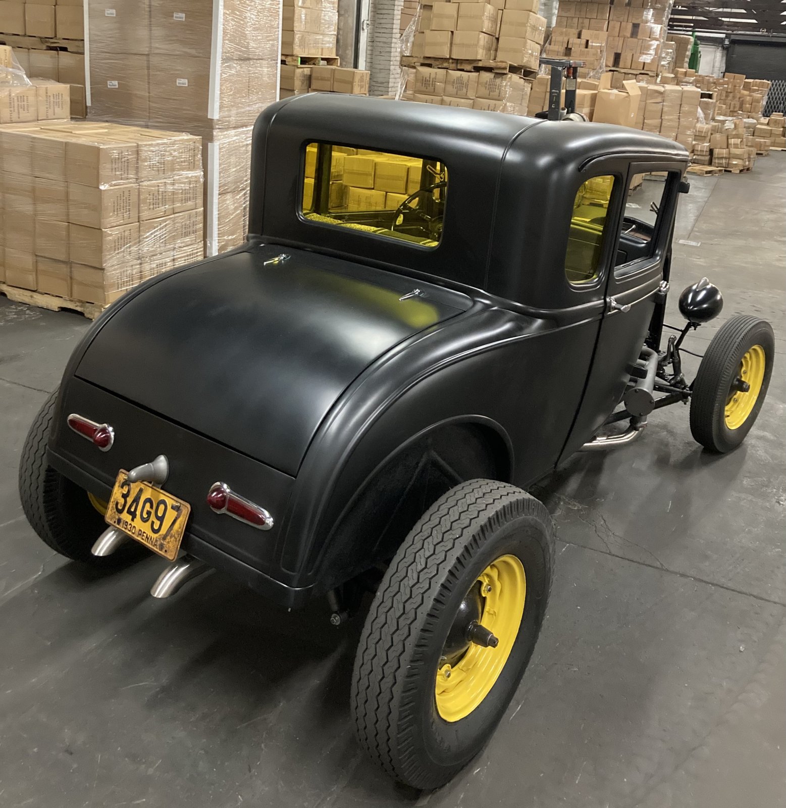

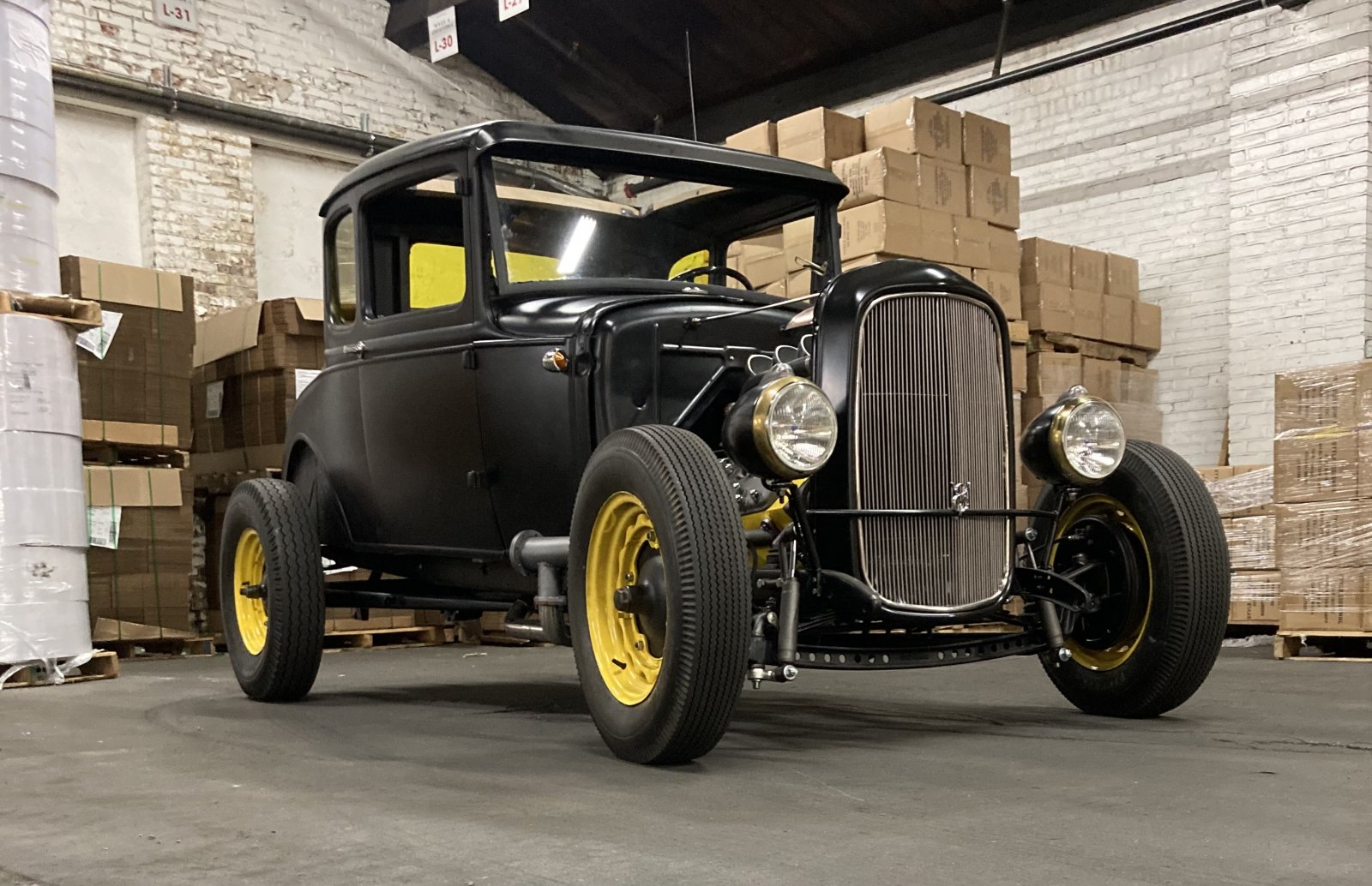

    Have been following but first time for a post, didn’t really like the tinted windows but in these pictures with the lighting they really look great
    I’ve learned a lot from your build thanks for bringing us along for the ride

    The window tint was in my head from the very beginning....in my "vision". Glad you followed along and that you enjoyed the build...I sure did!
    Thanks Brother....you've made my night!

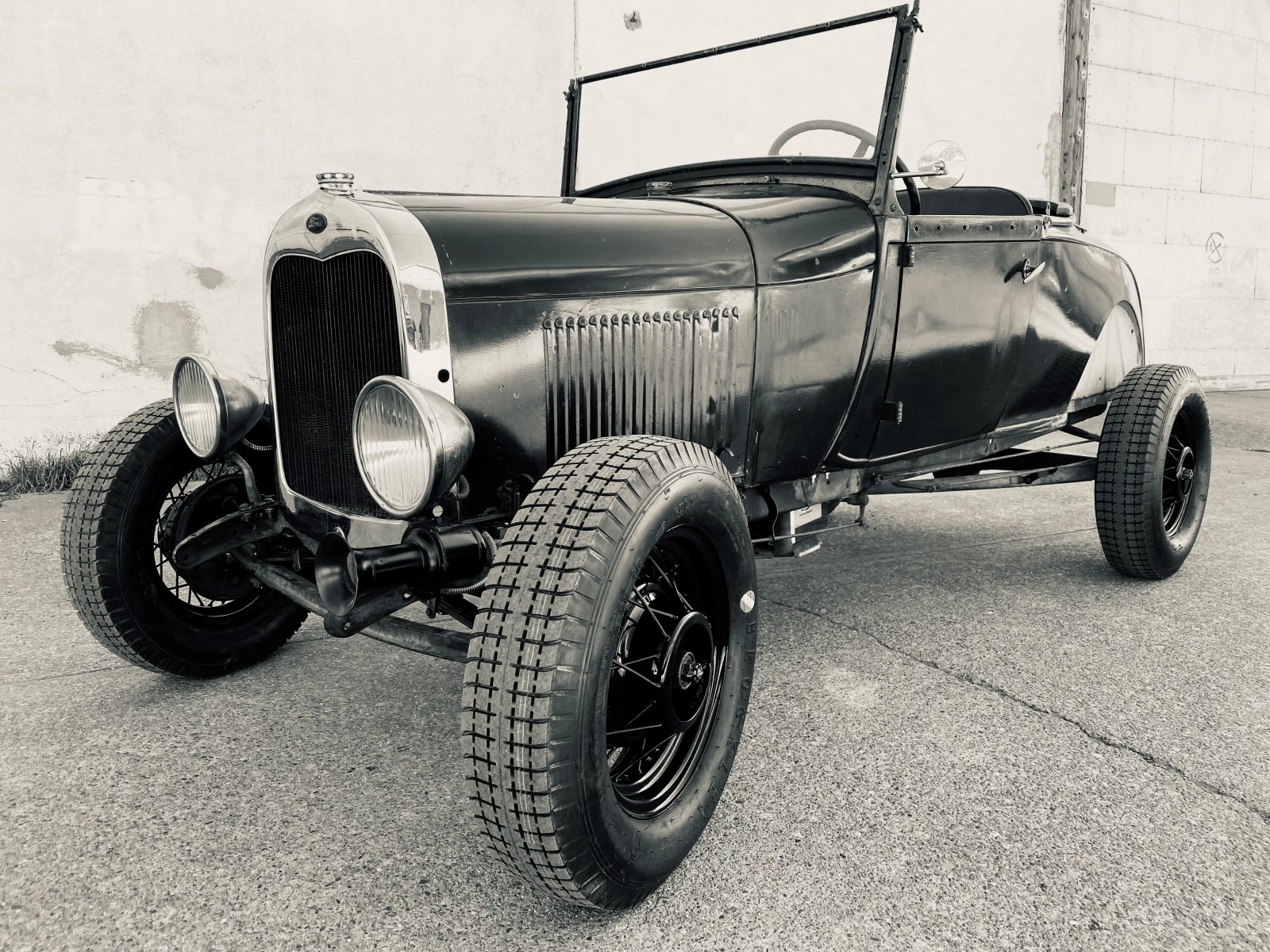

  7. Jeff34
    Joined: Jun 2, 2015
    Posts: 1,330
    Jeff34

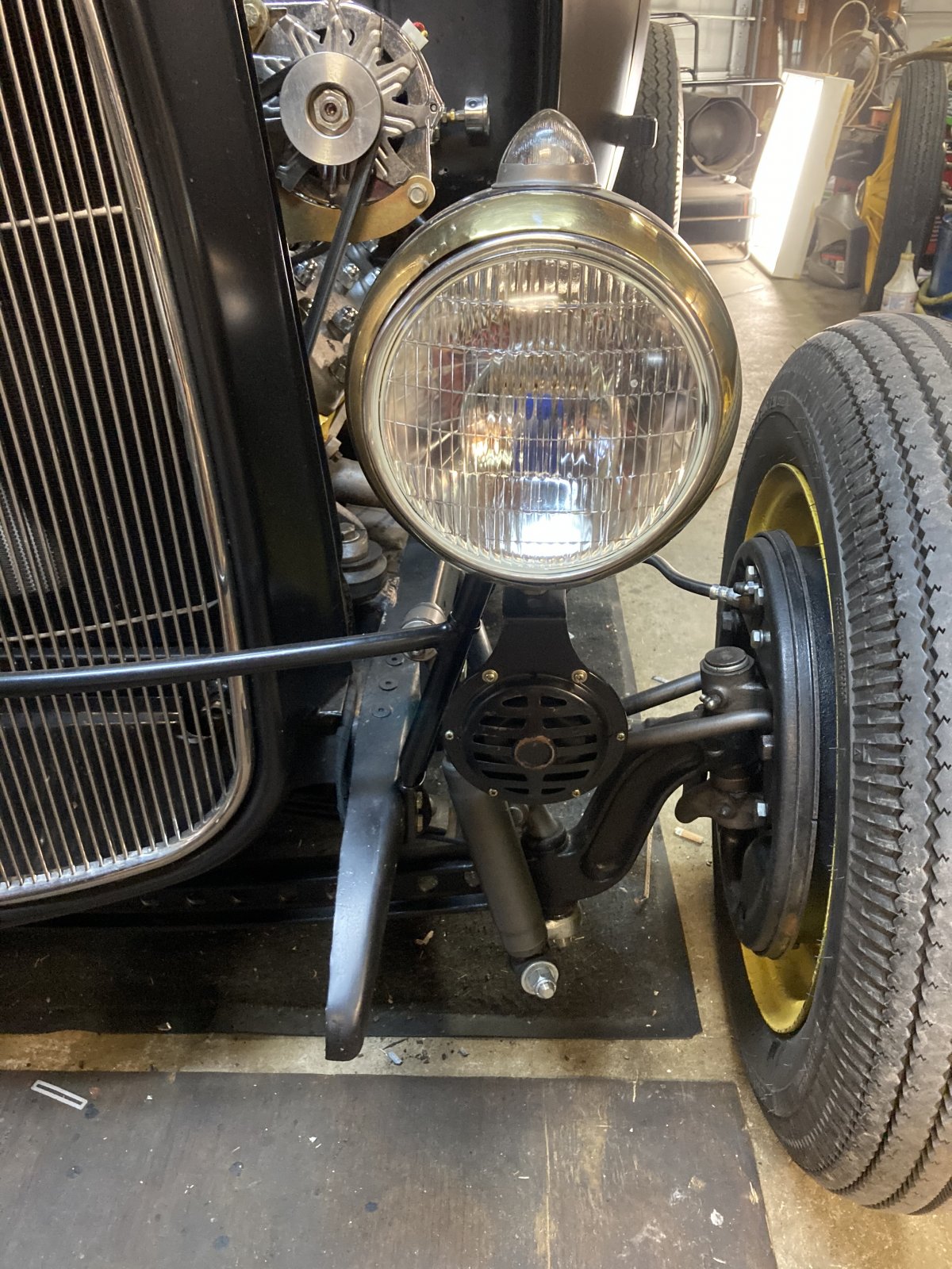

    I put my stock horn there, but maybe that one just looks too new...?? Sunday 1.jpg

  10. Piewagn
    Joined: Mar 25, 2009
    Posts: 1,542
    Piewagn
    Hey Jeff...roadster looks good! Horns are just one of those necessary evils... I'll figure something out. Thanks for stoppin" in!

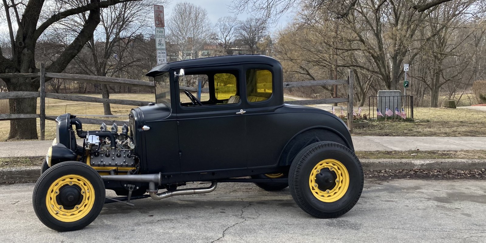

    Hello Fellas!
    I know it’s been a while, but things happen.
    The latest is getting the tri power dialed in.... I bumbled upon a couple of those Henkyo replica 94s and decided to make a video of some tweaks to this carburetor. All in all, good results and the elimination of several of my driveability issues. Caution: driving portion very shakey...:D I WILL be getting to my interior and do***enting here some other upgrades needed since I’ve put some miles on her. Thanks for stopping by!

    I completed the latest step in my changeover to the Henkyo 94 replicas. I did install the ECG clusters/nozzles or whichever term you prefer to:
    #1) Out of curiosity, to see how it performed with them installed.
    #2) After some research, I've read that installing these can somewhat remedy percolation, or vapor lock.
    I also installed a return line to the tank. It was equipped with the fittings to do so. Took her for a blast and it ran great! Here's my latest video. I'm reaching retirement in a few years and would like to monetize my channel for something to keep me busy and maybe make a few bucks. BUT, I need subscribers....1000 for starters. I Have plenty of projects for content and really enjoy making videos! The ride portion of this video is WAAAAAAY better than my previous, I found a better platform for my camera!...... Enjoy!

    Thank Mike! It really smoothed out! Idle quality and overall around town performance has improved greatly. It was a fun project.

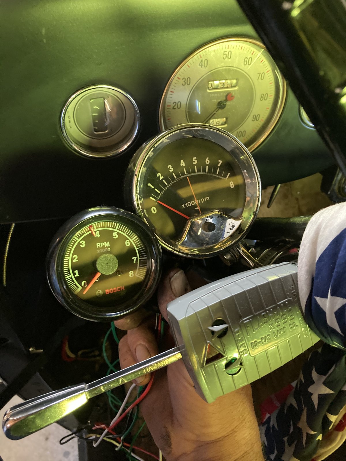

    Yazaki or Bosch?
    The Yazaki gets a little sketchy on occasion.....
    I really respect y’all’s opinions, that’s why I ask for your input frequently! As always, thank you very much!
    oliver westlund and Jeff34 like this.
  28. 4 pedals
    Joined: Oct 8, 2009
    Posts: 987
    4 pedals
    from Nor Cal
    For reliability, I would use the Bosch. For looks, definitely the other.
    Devin
    Piewagn and Outback like this.
  29. Honestly I'm not really feeling either. The Yazaki looks a bit more vintage but you will need to eventually replace it most likely. The Bosch is probably much better quality but it just doesn't have the look that I like. Either way you choose will look fine. Thanks. Nick
    Piewagn likes this.
  30. Piewagn
    Posts: 1,542
    Piewagn
    Yeah....that’s the issue....the Yazaki is 60’s vintage and has a better look, but sometimes it freezes at 2k...thanks for the input Devin!
