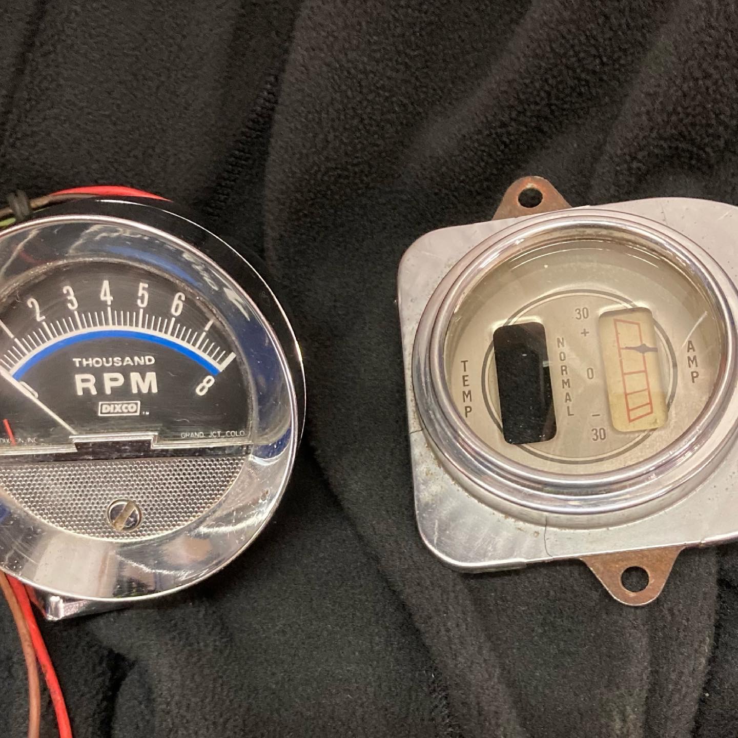

    I know Nick.... I had a *****in’ Dixco that took a **** and had the Yazaki laying around....freezes at 2k sometimes. The Bosch I picked up cheap. Geezus, pricing vintage tachs left some sticker shock....I’ve been looking for another Dixco, but it will have to wait until funds allow...

    I like the look of the Yazaki. If you're really like it and you have some $, you could send it out to a speedometer repair shop and have them upgrade the electronics. I did that with mine. Can't remember the name of the company right now, but they did a nice job

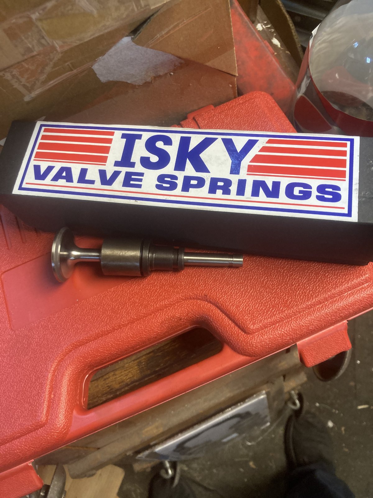

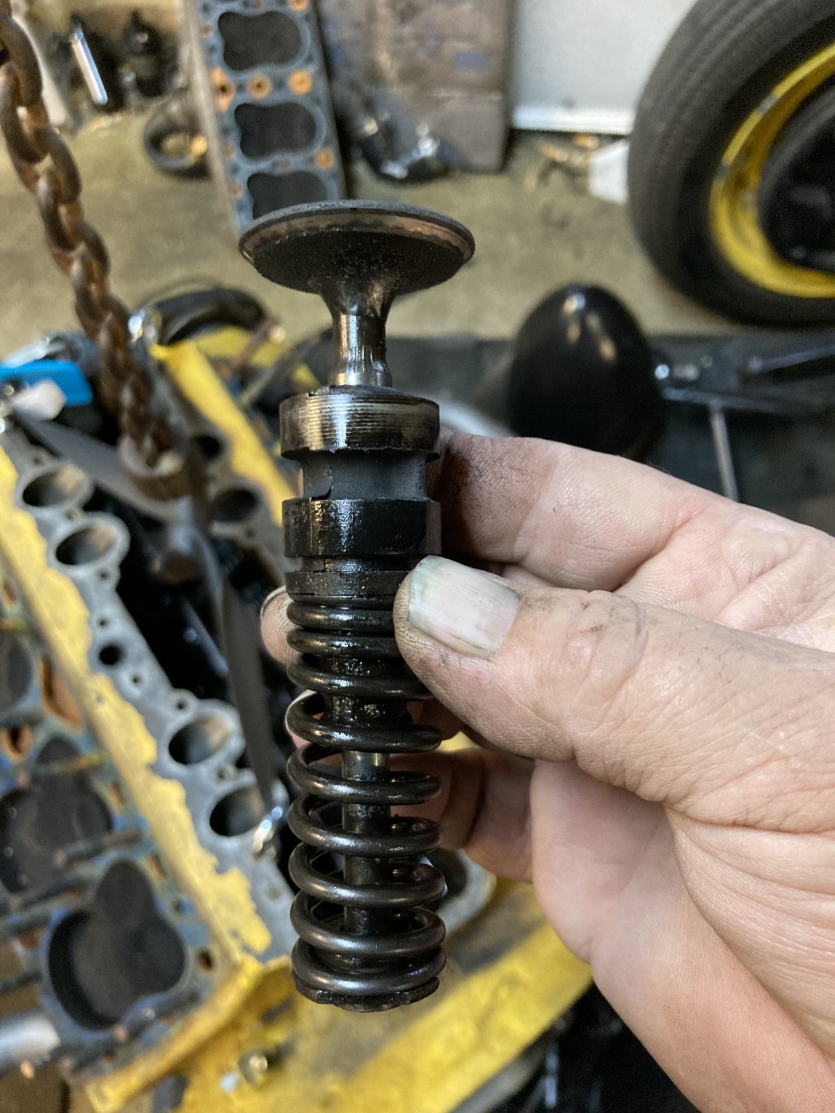

    Well, valve guides worn out…it’s time for the valve train change over to the one piece guides and new springs….

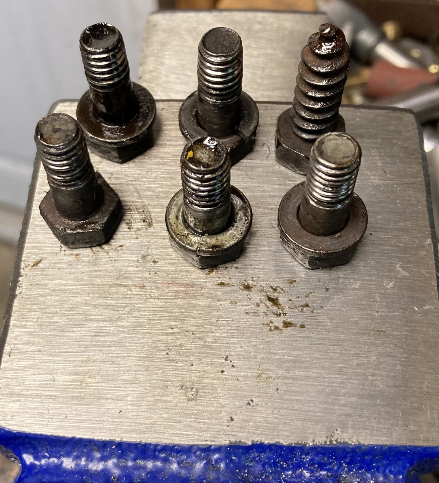

    One of these things is not like the other, one of these things just doesn’t belong….
    Pressure plate bolts….:eek::mad:
    No wonder the pedal was t*******….

    OMG! :eek: Are you going to have to helicoil it?

    Fixed on the farm last time. If it fits it ships.....

    I’m going to insert it. I trust those more than helicoils, especially in this application…

    The thing that gets me Cliff, they had to drill the hole larger to get that screw in there!

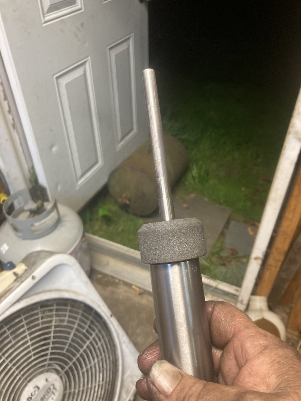

    Thread repaired! Can’t find my aligning tool so I had to order another one… Picking up a seat grinder over the weekend and I can get started on ****oning this thing back up! Hope everyone is having a great night!

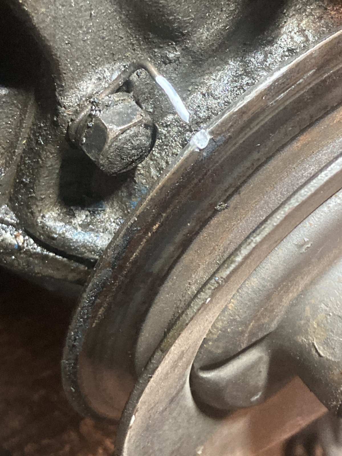

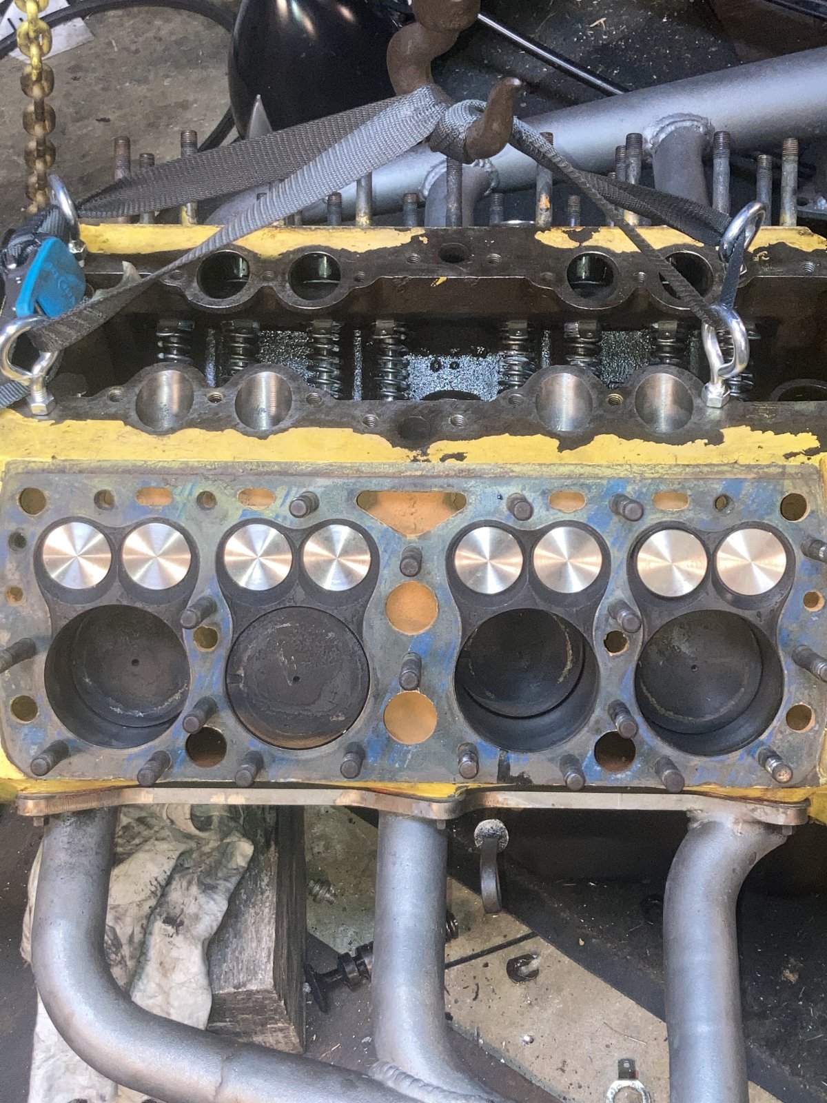

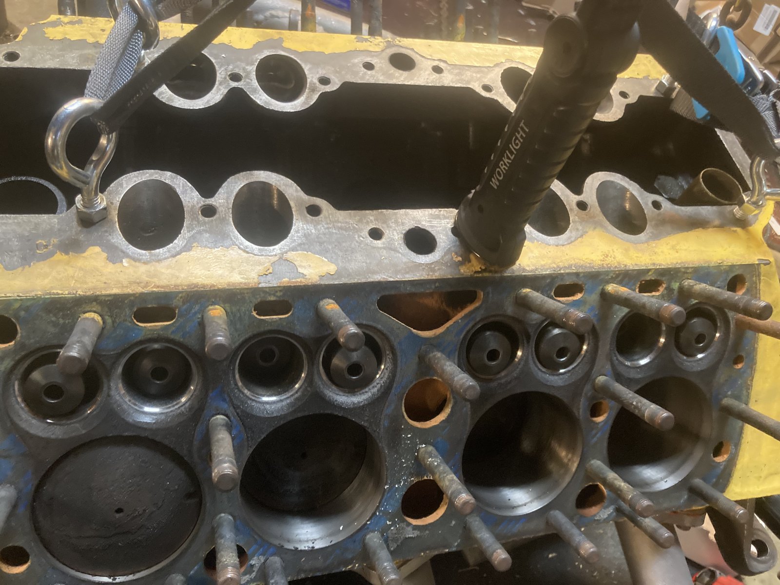

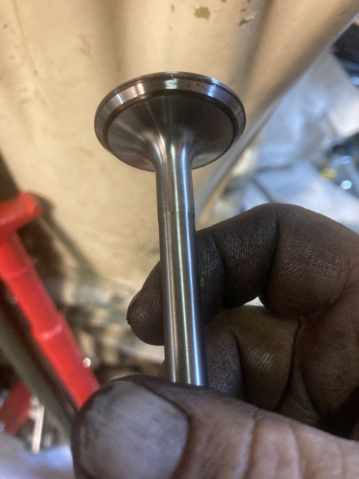

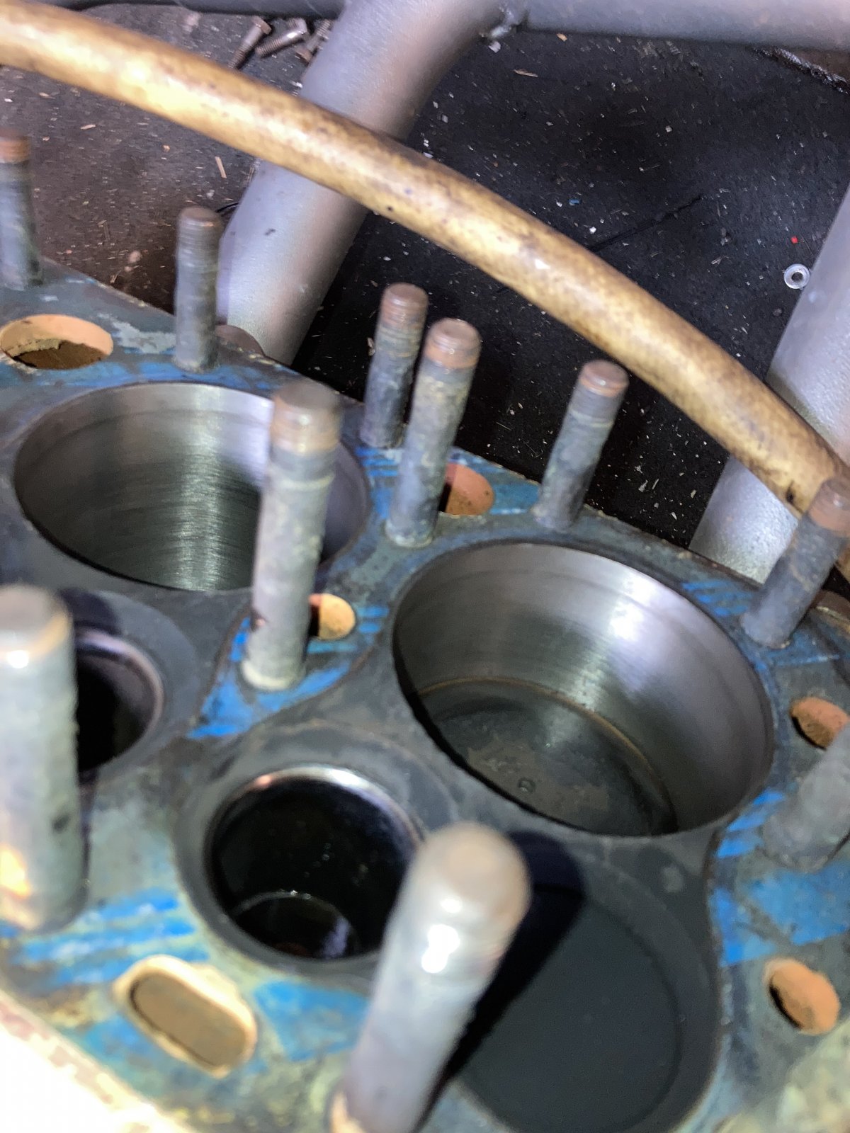

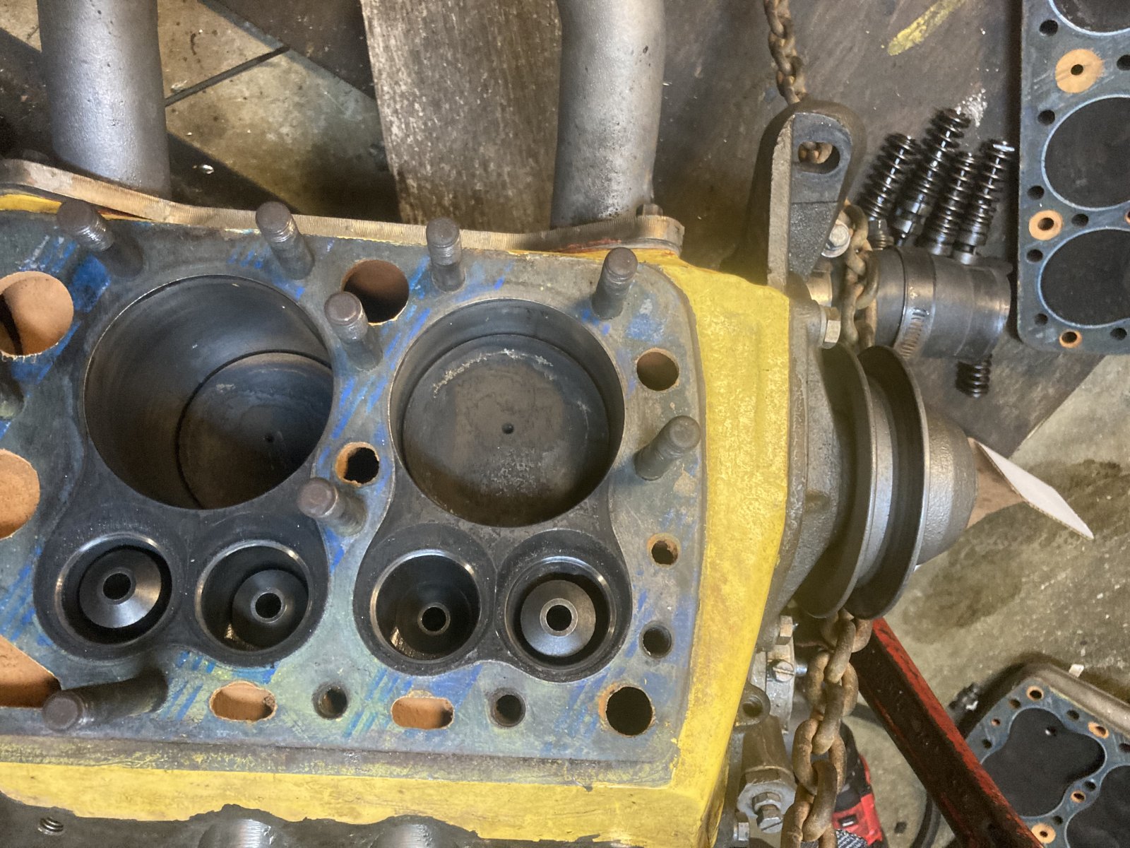

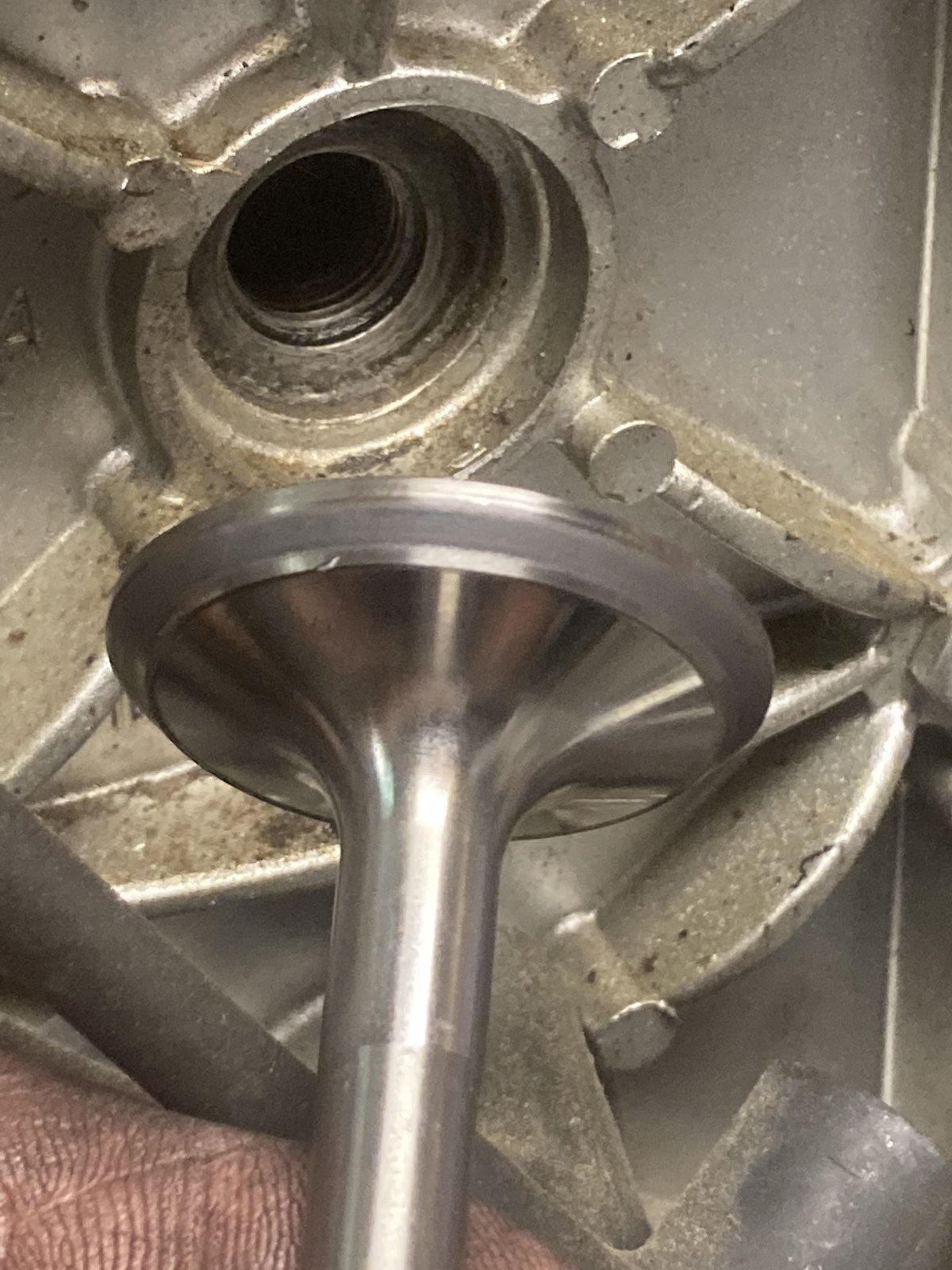

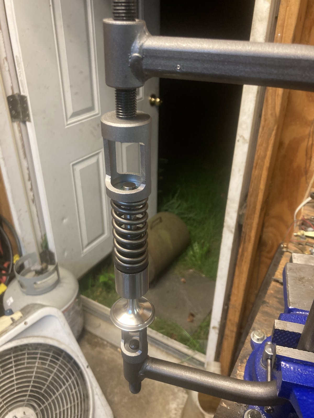

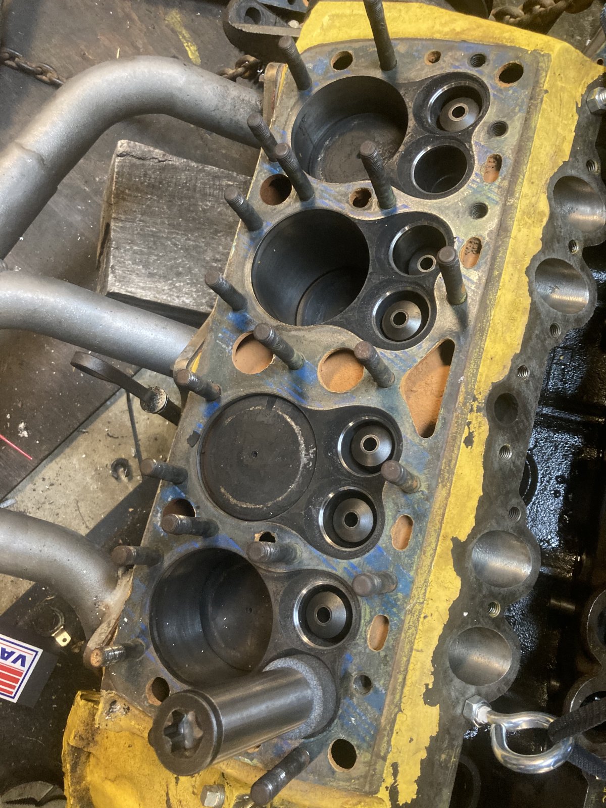

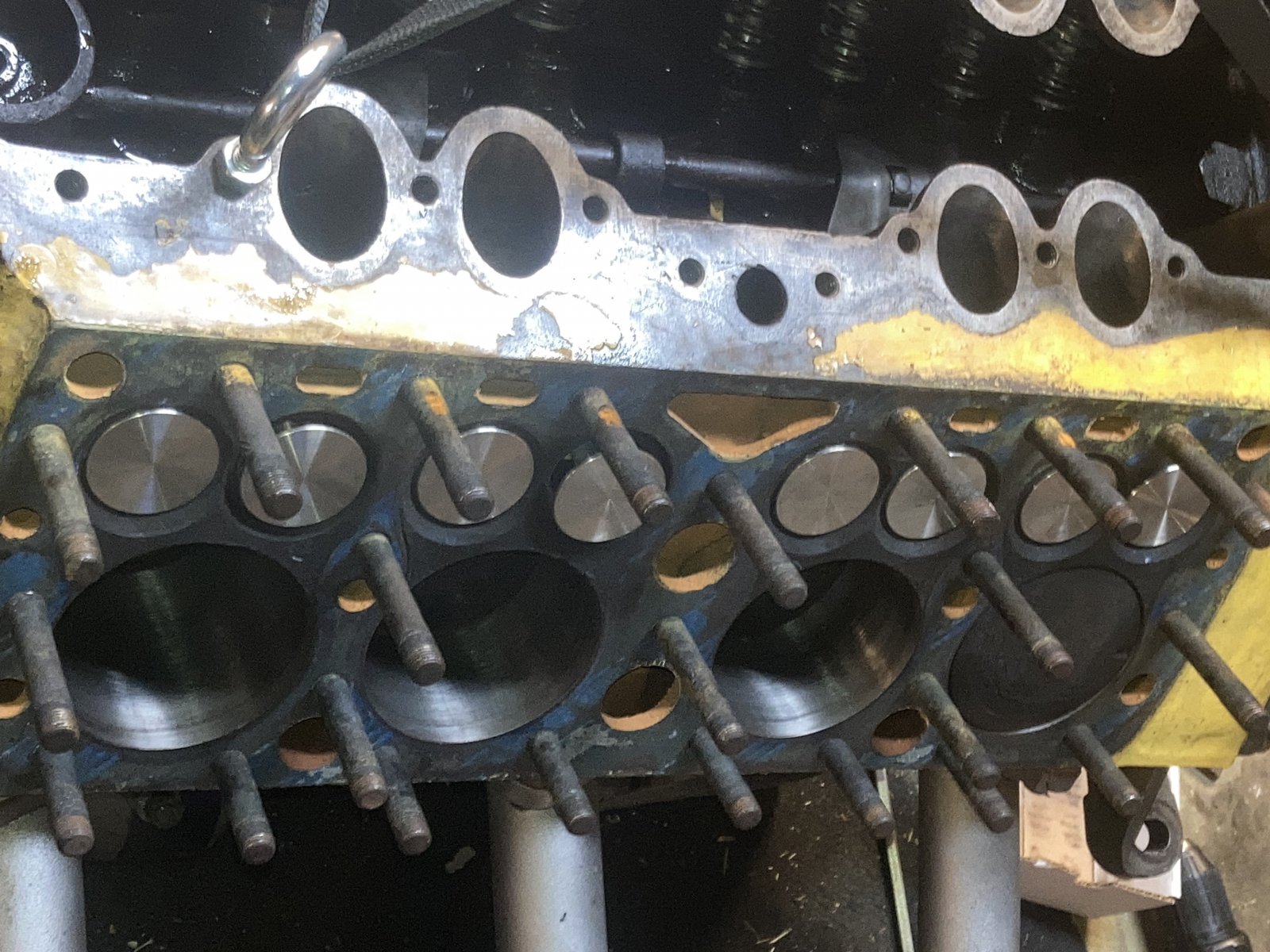

    All seats ground to center valve with guides and seats. Everything installed and lash adjusted. I’ve also made a pointer for my TDC timing mark. Now to clean surfaces and get the heads bolted on so I can get this thing back in! I’m trying to understand why the valve train was all clapped out when the rest of the engine looks so fresh… anyway, back at it tomorrow after some chores and hopefully ready to go back in by the end of the day. Hope everyone is having a great weekend!
    DB32EDA0-A9BB-4580-881C-7B622D27321E.jpeg 90CFAF7E-2229-40D1-920C-69B3890D7913.jpeg 7D91F94F-CAED-49EB-9E5E-CC1E19C71A35.jpeg 991C6F7B-62E5-4F4D-B6C1-212737C56959.jpeg 7B6B5C7B-E20B-4EEC-A940-86972A612782.jpeg 392C79C8-A11C-4387-A226-4E192C9A521F.jpeg DC5D7EB1-CC73-4547-9956-794BF78C2B3D.jpeg 0807FD17-5F6B-4237-A7DA-425EED77B196.jpeg 53849D88-3AC2-4CB8-8D26-F3A861DAAE44.jpeg 14C75119-C591-454B-9775-F6735A62D9F0.jpeg 9884022E-53F0-4A3E-9E97-734FACF9E1C1.jpeg 301EBBE2-7475-4DF2-BA12-115294811150.jpeg 26229923-7760-4BD2-AAEB-7BDD1B2D96E6.jpeg
  19. It looks to me like the carbon on top your pistons is whacking the heads . . . do you see a "witness" marks on the heads? Given your old valve guides, it was probably pumping quite a bit of oil into the combustion chambers - so clean the tops of all your pistons before re***embly.
    caprockfabshop likes this.
  20. Piewagn
    Joined: Mar 25, 2009
    Posts: 1,542
    Piewagn
    Those marks are from the hone I used to deglaze the cylinder walls. There’s some extra carbon from some mix from my outboard I ran through it. I knew I was taking it apart so I ran about six gallons through on my last cruising weekend. Oddly enough, it barely smoked :D Thanks for your concern and input!

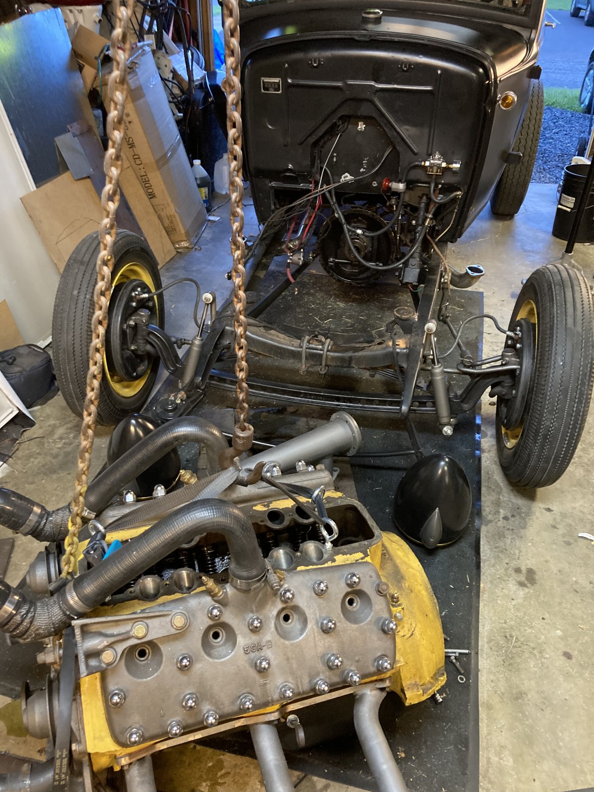

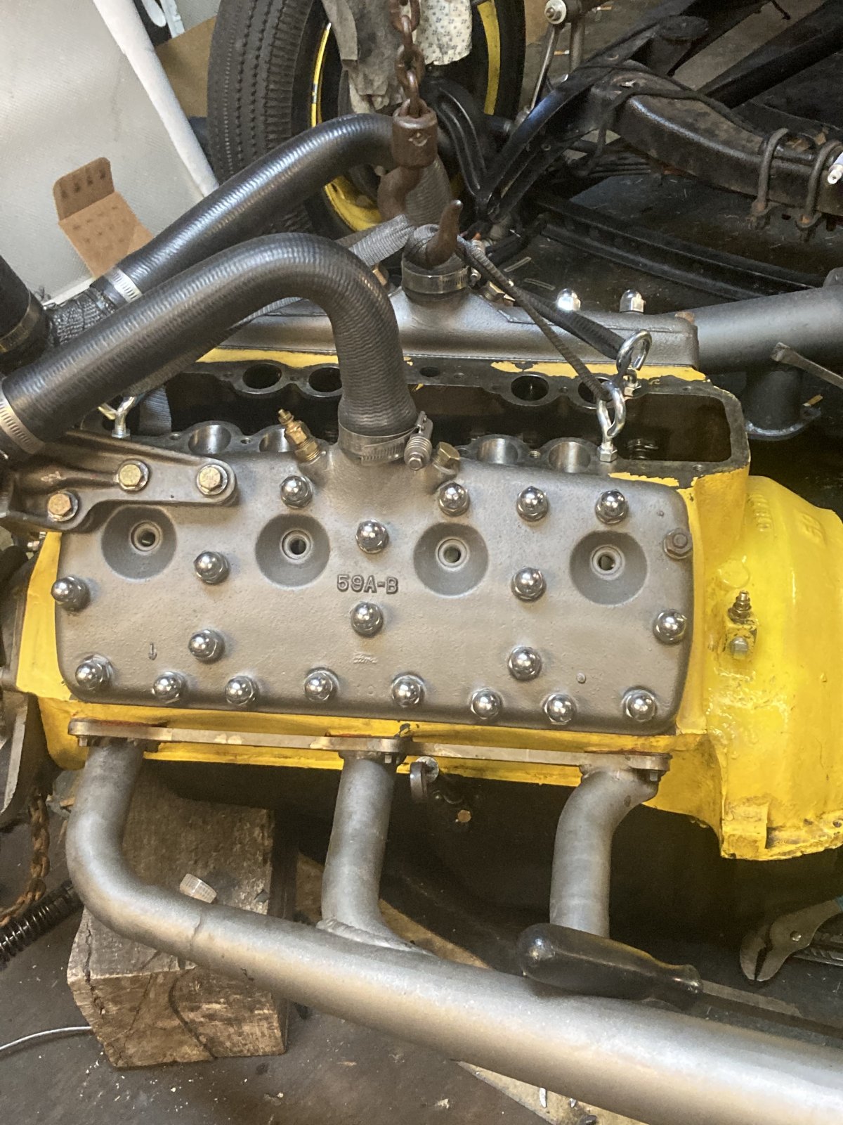

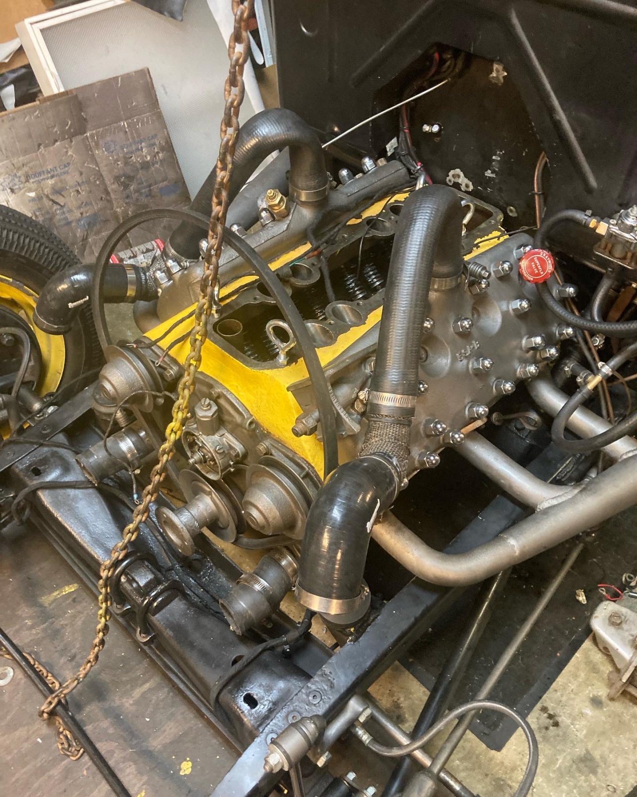

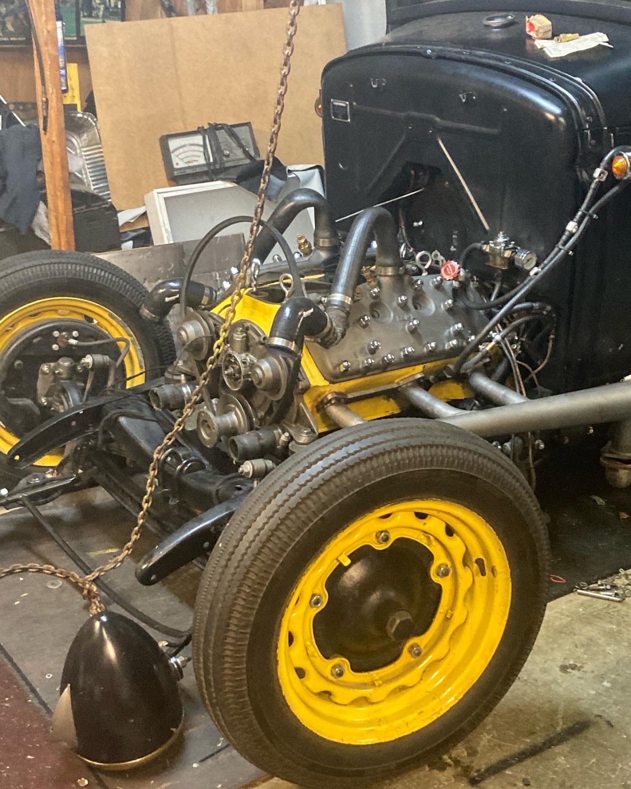

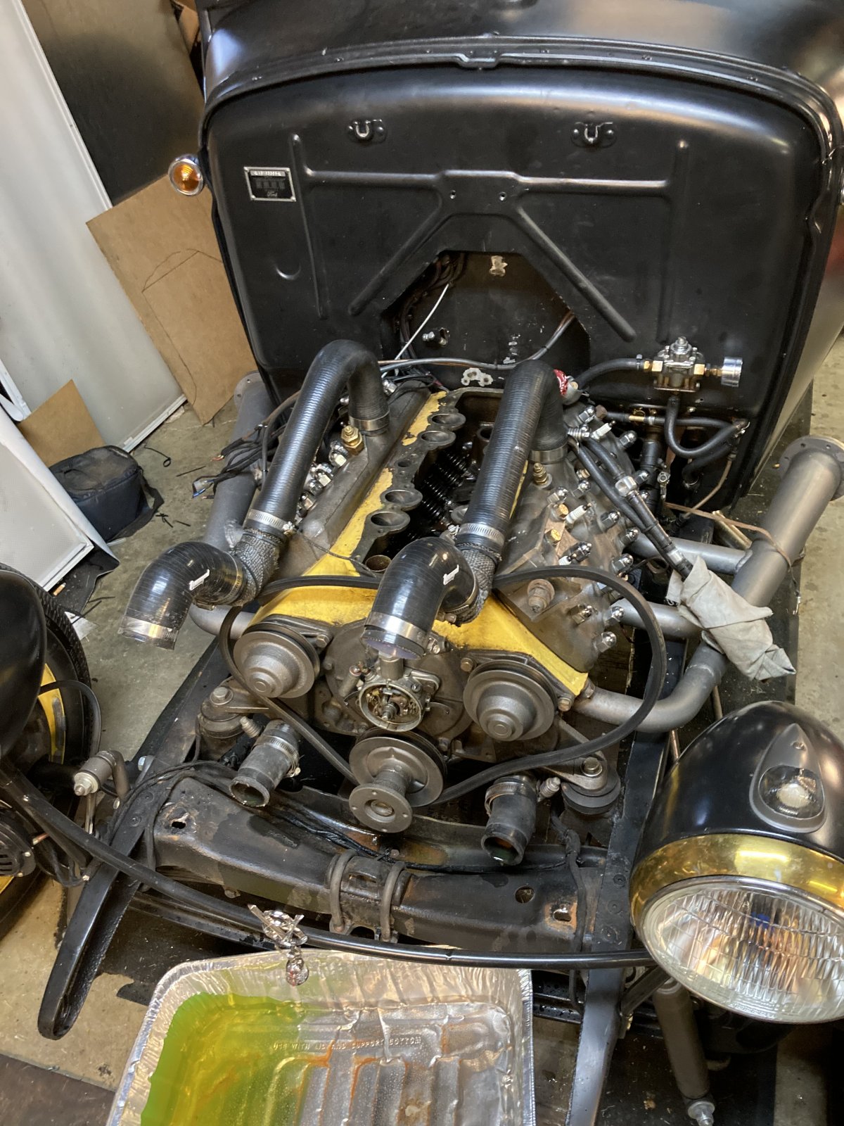

    All tidied up and ready to go back in! New clutch, throwout bearing and return spring. Can’t wait to feel this thing the way it SHOULD run. It displayed flashes of brilliance only to return to it’s sleepy acceleration in high gear and really “grainy” exhaust tone…if you know what I mean… Will have updates. Thanks for stoppin’ by…Hope everyone had a great weekend!
  22. Piewagn
    Posts: 1,542
    Piewagn
    Well…it’s in! Now just bolting up all the extraneous stuff and odd wire or 4 and I’m ready to roll! Thanks for stopping in fellas!!

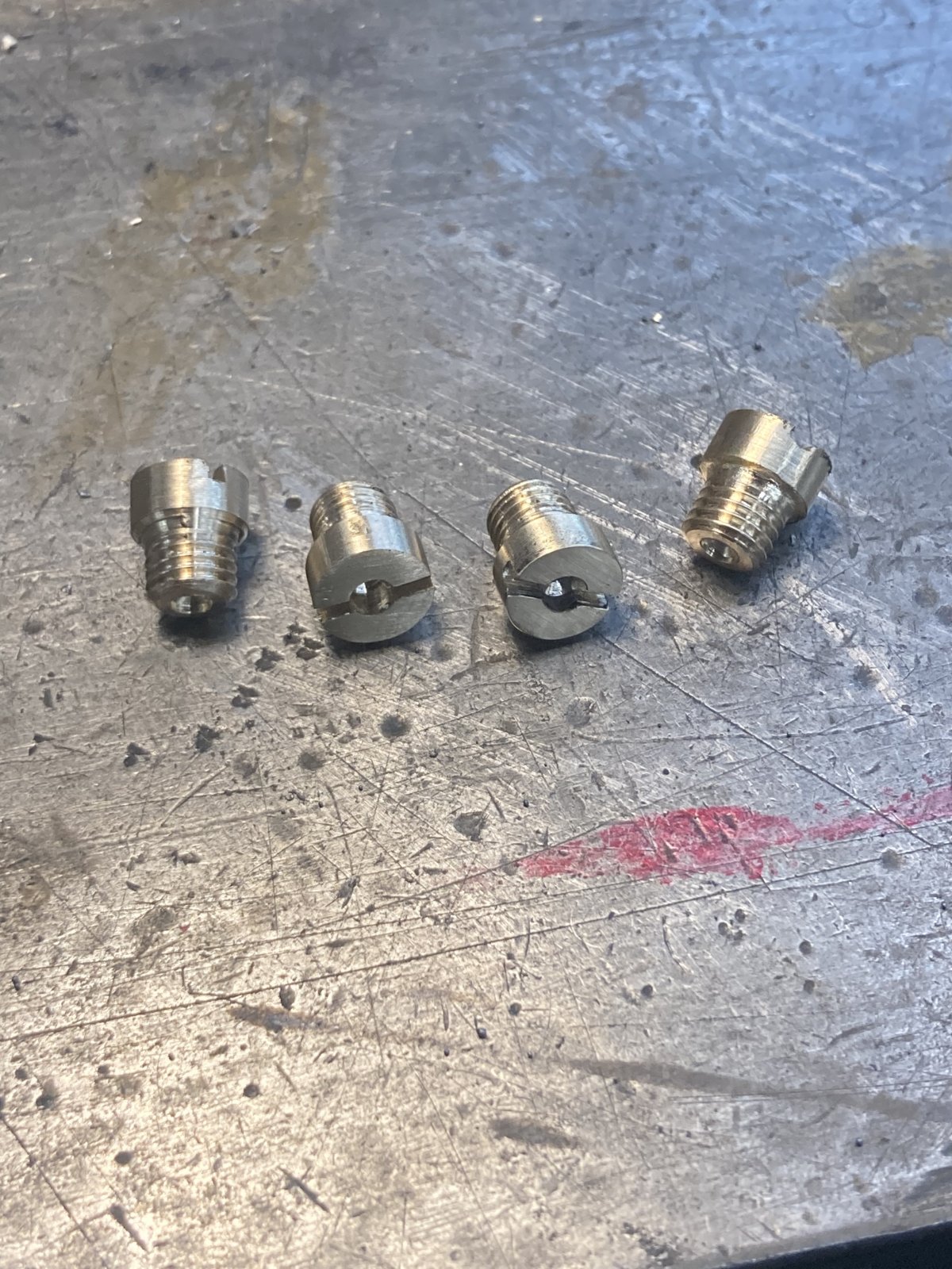

    I’ve made my own main jets for my secondaries for after I swap my primary carb… It figures we’d get an all day rain on the day I’ll be ready to drive it! Don’t care, if it’s only drizzling I’m taking it out! Hope everyone is having a great day!

    Those look like Holley jets...or are they different? I was just curious, but either way, great job on making them!
