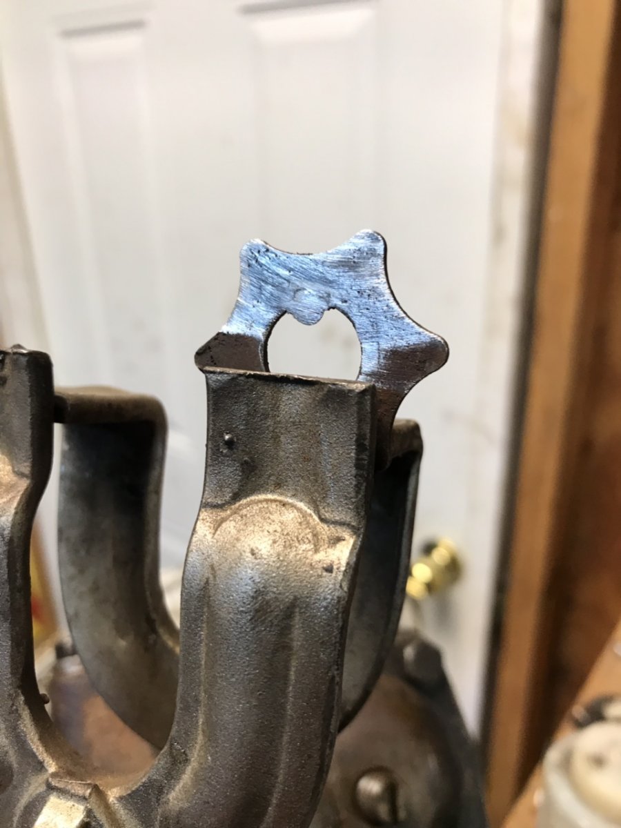

    Well, the tab from the star lock washer was missing so I just gave it a little zingo with the welder. Now I’ll just square it off with a file.... IMG_1380.JPG

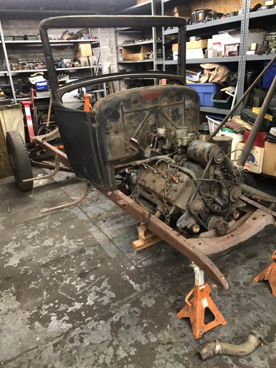

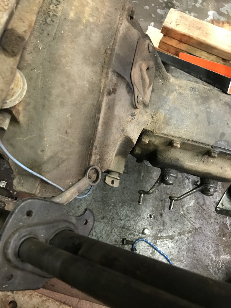

    I actually didn’t think I was gonna have this much space between the engine and firewall! Maybe a change of plans on the X member, l may be able to incorporate the existing crossmember somehow....we shall see! IMG_1386.JPG IMG_1387.JPG IMG_1388.JPG IMG_1389.JPG

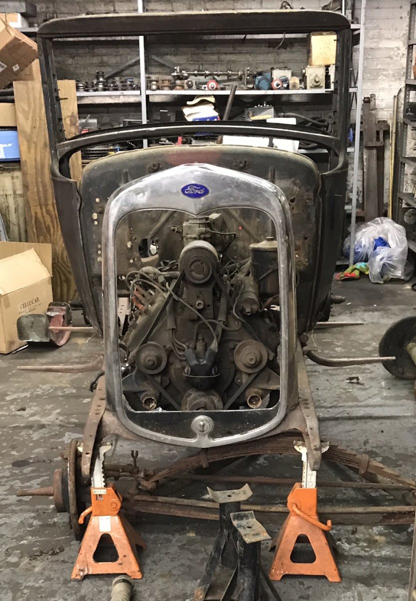

    Put a set of wheels on the back to get close to ride height. I think I’m just about where I want to be! I still can’t believe I have that much space between the engine and firewall.....
    I think it’s time to start to get serious with the trans mount and the X maybe K type member. We’ll see how it goes once I start cutting and placing. I need to take some time and just stare at it, then clarity will set in and I’ll have a concrete plan. Thanks for following along fellas!! IMG_1390.JPG IMG_1392.JPG

    Like what you're doing, looks like the body is sitting back about 2 inches though? Could explain the spare room at the firewall
    greaser and loudbang like this.
  12. Piewagn
    Joined: Mar 25, 2009
    Posts: 1,542
    Piewagn
    Thanks!! It’s lined up with the mount brackets and bolt holes, right where it’s supposed to be....hey, I ain’t complainin’ [emoji16][emoji16]

    It seems you are correct Sir! Now I need to move the brackets forward.......this explains a lot!

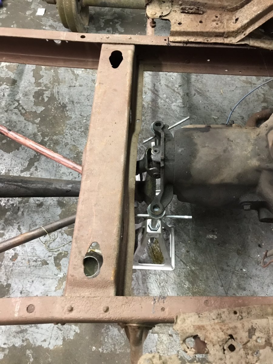

    Been majorly sick! Blam! Hit like a ton of bricks! Finally feeling better...
    I started making mounts for the trans....I’ve changed my plans, you’ll see how it comes out when I get it tacked in place.... IMG_1442.JPG

    Ok, I’ve settled on this set up! Obviously it’s not secured yet, or diagonal braces in their final location. I still have to tweek it and finish up the other side, but I’m happy with this. After I secure the trans, I can locate the steering box and make the front mounts..... IMG_1462.JPG IMG_1464.JPG

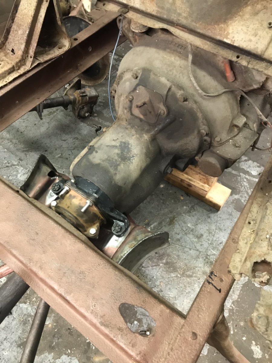

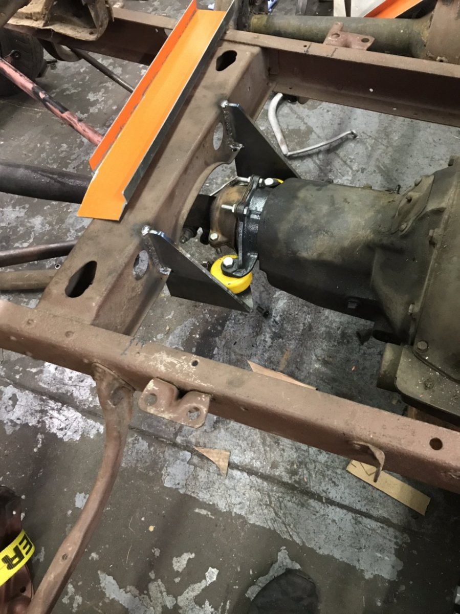

    Finished fabricating the trans mounts, got them in there loosely. I need to measure and set up final location and trim the ends of the diagonal braces, figure their final angle and location so I can hang my pedal ***embly from them.... Some progress, slow but sure! Thanks fellas!! IMG_1472.JPG IMG_1474.JPG IMG_1473.JPG

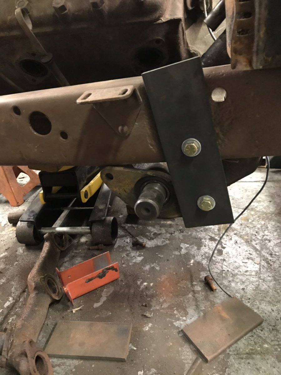

    Got the main brackets welded in place! Now I can set my steering box location. I have a whole lotta figurin’ to do. I have some ideas for the mounting that I need to explore along with pedal ***embly location. The column shift is going to be a challenge with the clearance available to the cylinder head. It’ll come together, just need to try some different options and see what works..... IMG_1489.JPG

    Well, steering box quasi location. I will probably be able to get the column shift to work from this location, I’ll have to angle it in some for steering wheel to door clearance. It’s coming together slowly, but I’ll get there! If any of you guy have suggestions, please don’t hesitate!! Thanks fellas!!!

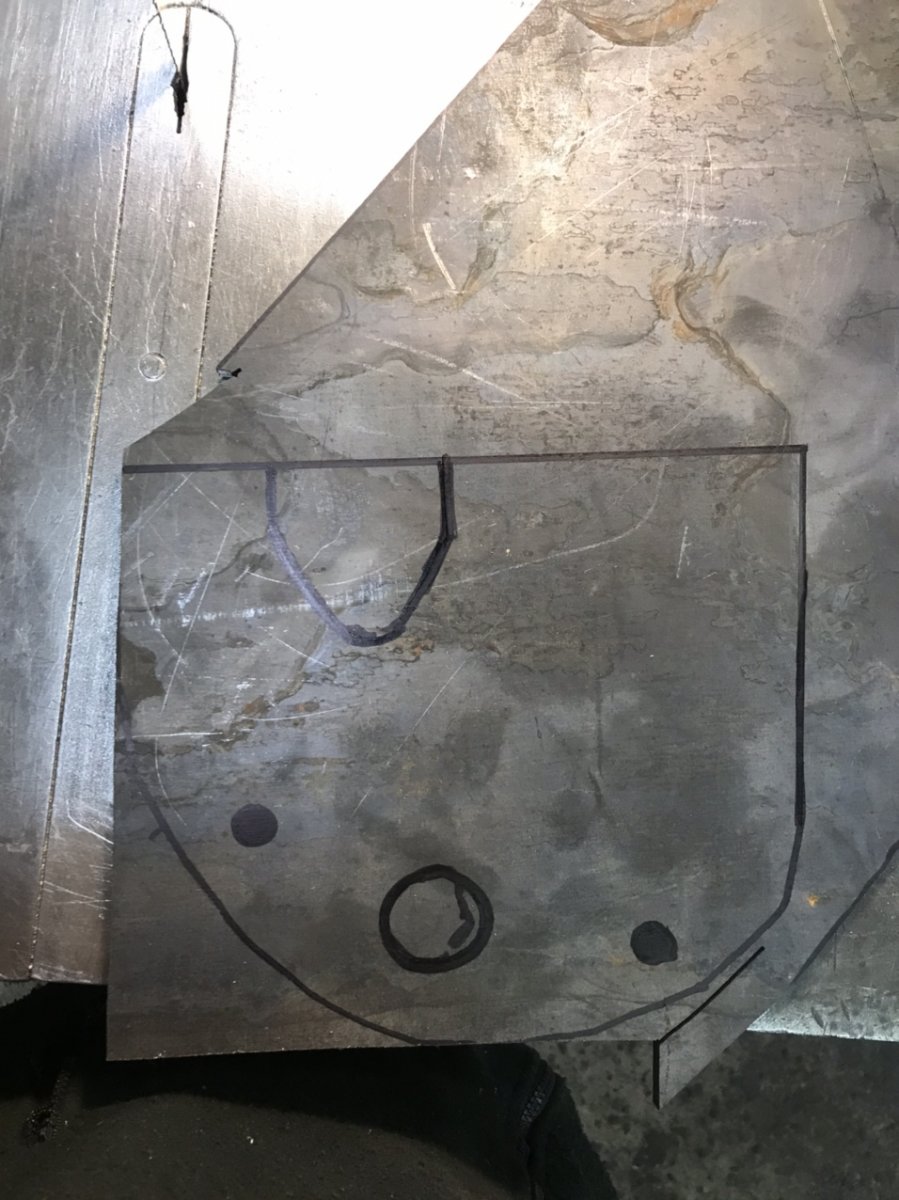

    Well....the column shifter will work out fine! I have all the clearance I need and with the box in this location it give me the perfect angle depth and clearance of column and wheel! I’m psyched!
    I made a temp bracket so I could remove the C clamps and make a template.....thanks for following fellas!! IMG_1527.JPG IMG_1529.JPG IMG_1533.JPG IMG_1535.JPG IMG_1536.JPG
