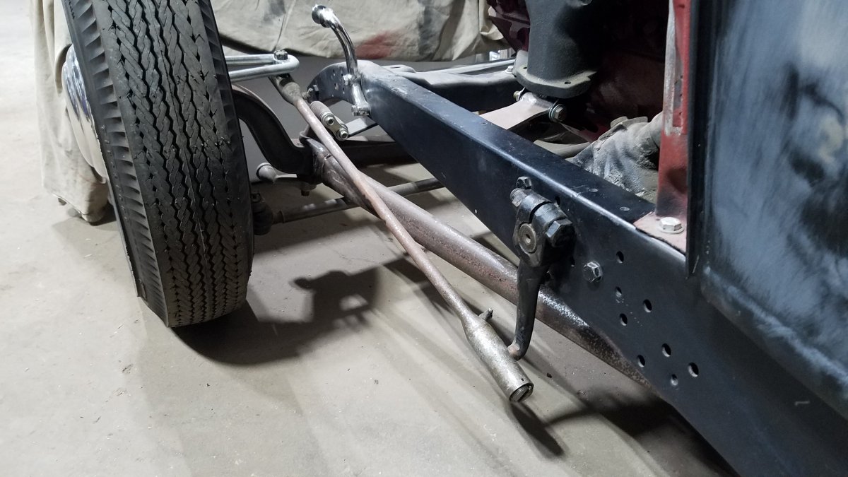

    Column shift Mart. Stock location with the F100 steering box, creates a conflict with the linkage, exhaust and bell housing. F100 box has the shaft exiting from the top of the box causing conflict as well. This location gives me the perfect angle and clearance for shift linkage and clearance for steering wheel from windshield and the door. Believe me, I've tried it in several different locations, including the stock location, before I settled on this one. It puts the sector/pitman shaft not much lower from the original location. Hey.....if it doesn't work, ya cut it off and try something else. I'm workin' with what I have and what I've gathered over the years..... Thanks for the input.....we'll see how it goes.:D:D
    Baron and loudbang like this.
  2. Mart
    Posts: 5,045
    Mart
    Ok, but bear in mind that if there is a trade off in conflicts, the steering has to come out on top. What would be the use of a car with a sweet column shift if it is not pleasant to drive because of bad bump steer? There are those who would argue that floor shift is preferable anyway.
    But like you say, if it doesn't turn out how you would like it, cut it off and try something else. that's the essence of a home built rod.
    Mart.

  4. Piewagn
    Joined: Mar 25, 2009
    Posts: 1,542
    Piewagn
    Yep....we'll see how it goes with the geometry. I did take it into consideration. I can make a shorter pitman arm in the machine shop if I need to. As long as I can keep the drag link as level as possible, I should be ok, we shall see..... Thanks for the input Mart, it's greatly appreciated!

    i believe mart is on the right track, with the steering box so low, you will have a terrible drag link angle with a dropped axle

    If you bend the steering arm down to follow the drop of the axle; it will end up in almost the same place as a straight arm on a stock axle.
    Really should have an exhaust manifold in place when fitting the steering box.

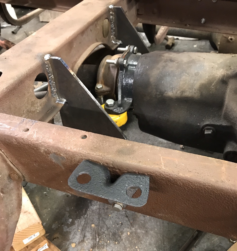

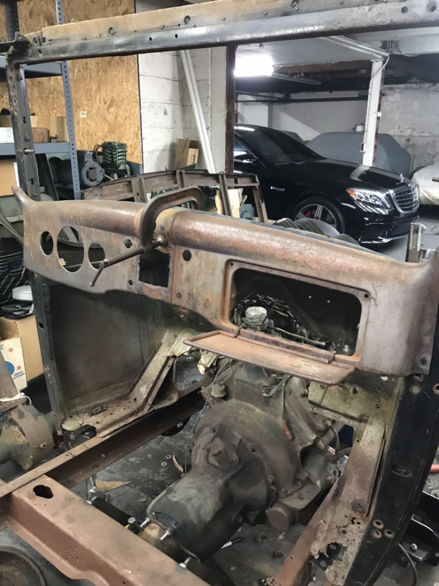

    I got a bunch of measurements done today roughly fitted the dash and set my column drop.....

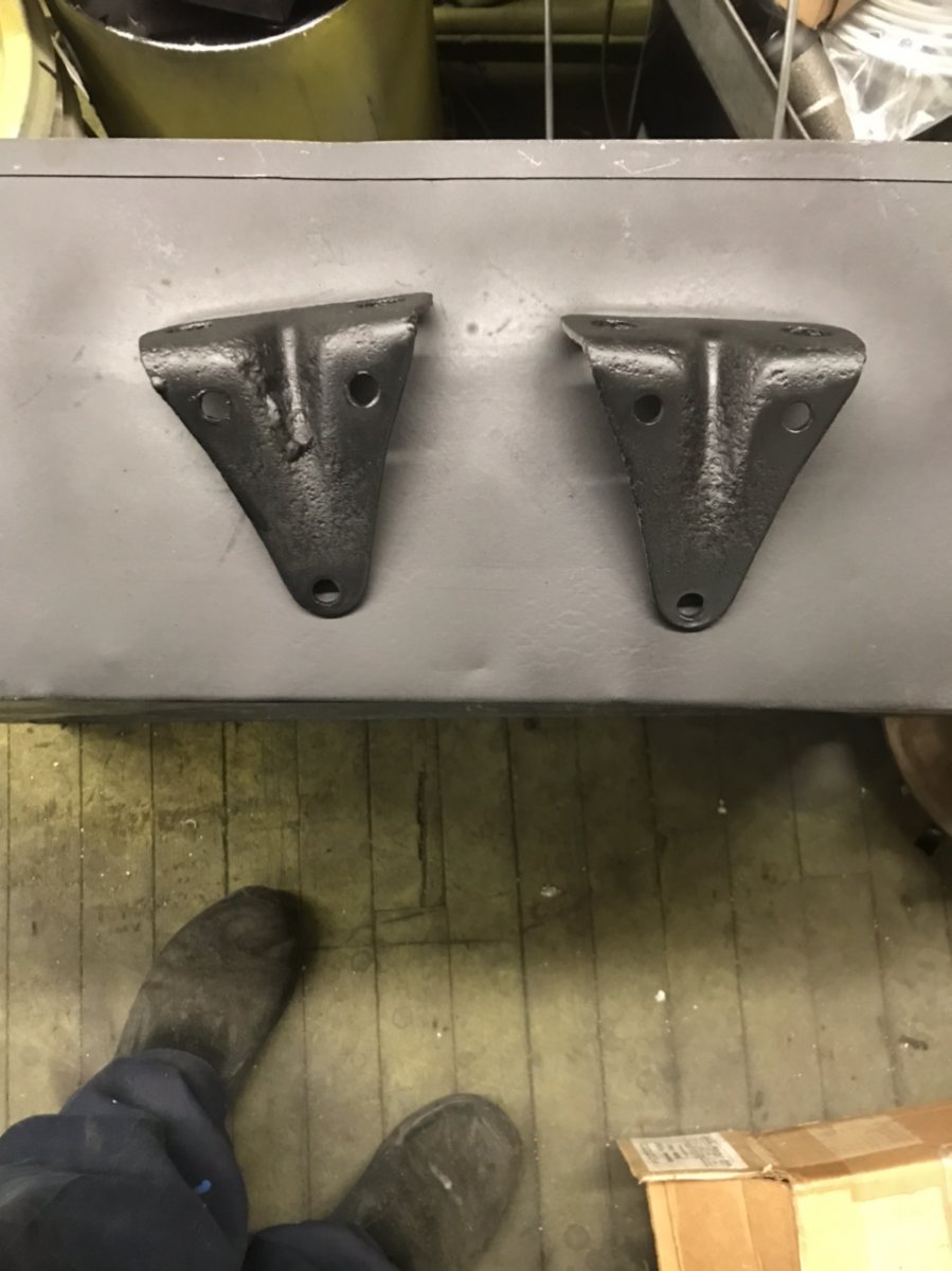

    I clearanced the firewall so I can get going on THOSE repairs, got a **** ton of holes to fill in that and I got my engine mounts fabricated. They just need some tidying up....
    Slow but sure, I’m gettin’ there!

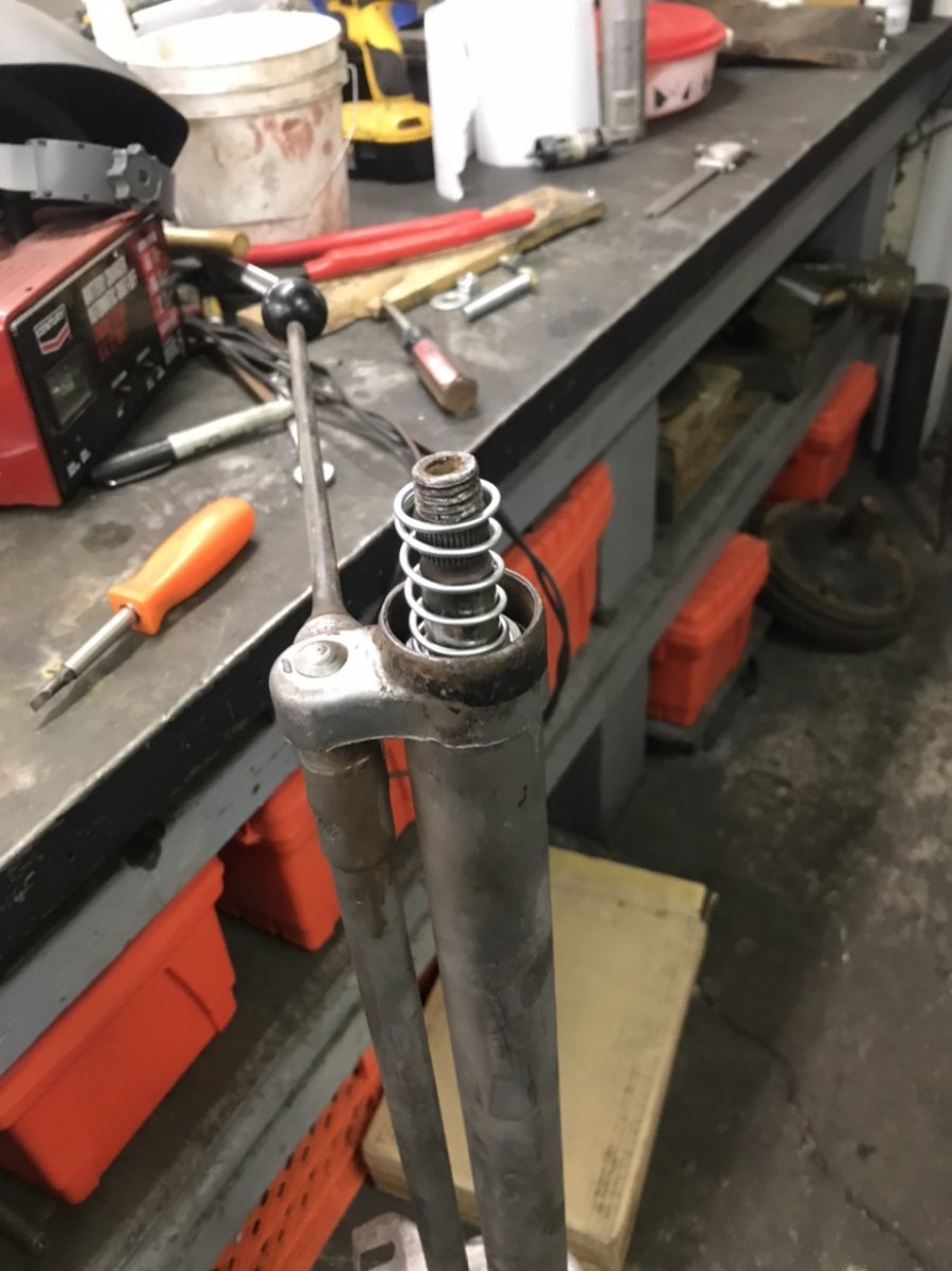

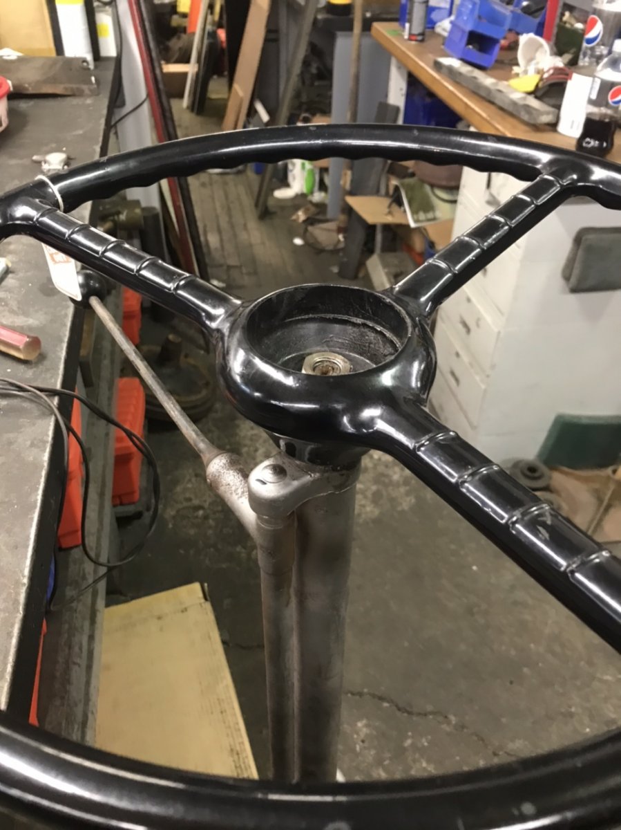

  13. Piewagn
    Posts: 1,542
    Piewagn

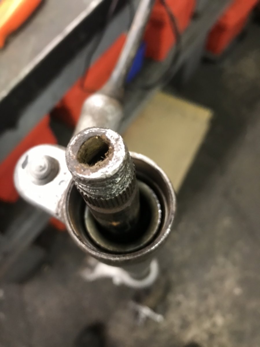

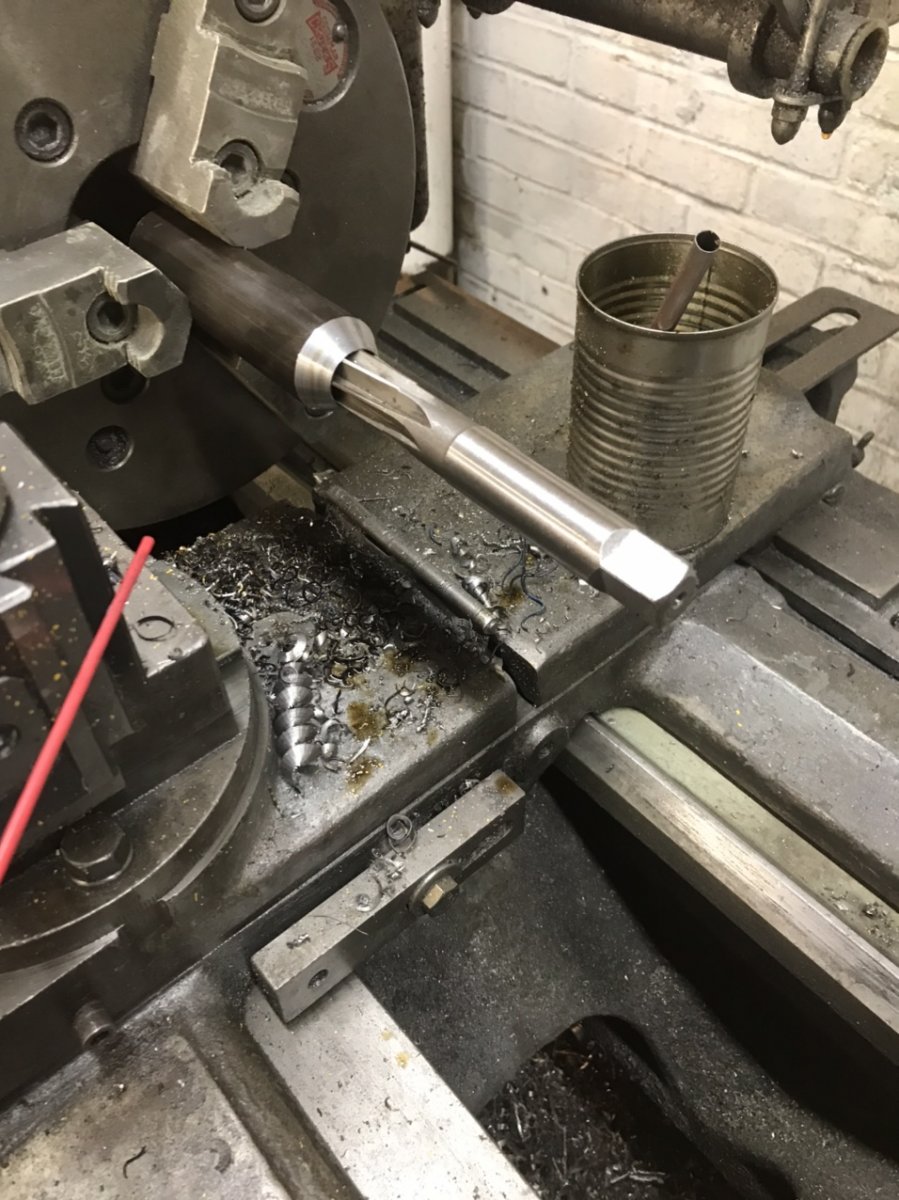

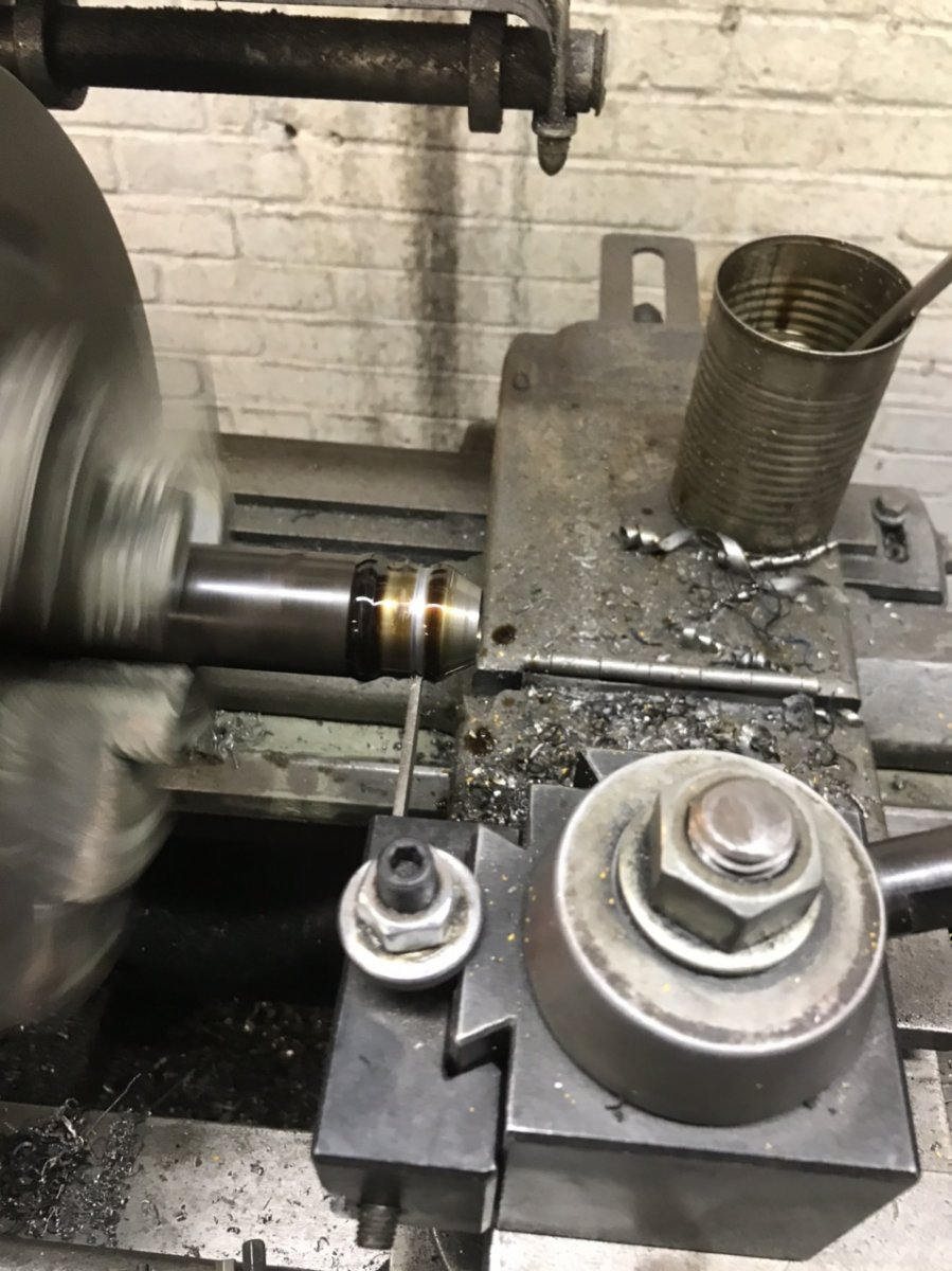

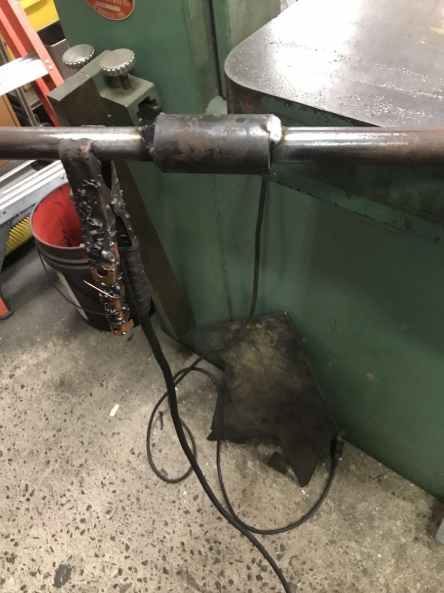

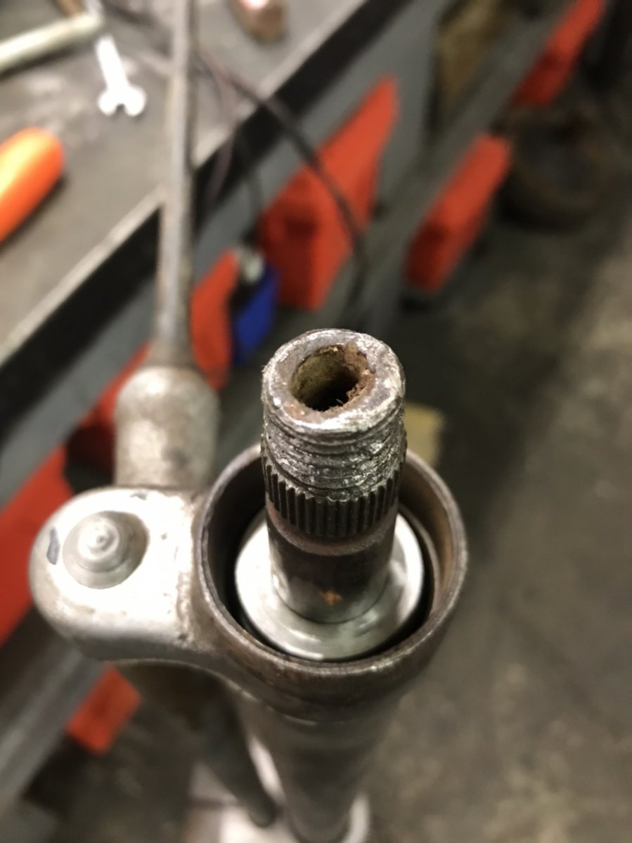

    Got my column and steering shaft sorted out today, had to extend the shaft and fabricate a wedge for the bearing...came out nice! I did manage to move those pesky body mounts forward too. Just hung my ‘36 dash so I can measure and mark where I need to trim it....I s****ped those engine mounts and I’m going a different route with those...I want to get the front suspension torn down for cleaning and painting soon too.....movin’ along! IMG_1565.JPG IMG_1567.JPG IMG_1569.JPG IMG_1570.JPG IMG_1571.JPG IMG_1572.JPG IMG_1574.JPG IMG_1575.JPG IMG_1576.JPG IMG_1577.JPG Adjustments.JPG IMG_1579.JPG

    The angle isn't a problem. I have a 56 box in my Deuce (and ran the same set up in a couple of past 32's). My only concern is having the steering box mounted as low as you have yours, you will need a shorter pitman arm, depending on the drop ( or lack of) of your front axle. Keep up the good work. Deuce drag link interferance b.jpg
    Nailhead A-V8, loudbang and Piewagn like this.

    Thanks Baron! I'm trying to keep my angle and clearance for the column shift, I did manage to move it up some. At this point, the pitman arm ball is only 1.75" lower than the stock location. I haven't made it permanent yet......We'll see how it goes, I may be ok. Thanks for your input!

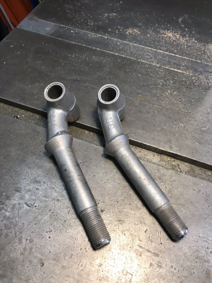

  25. Piewagn
    Posts: 1,542
    Piewagn
    Finally getting this front axle dismantled.....surprisingly little wear considering how crusty it is! Either great maintenance, or recently serviced before taken out of service... I’ll be reusing the spring perches which I’ve modified. Geezus they were a bear to get out! Some heat, juice, persuasion and persistence and they came out. Had to dress them up a bit though.....good save! Thanks fellas! IMG_1598.JPG IMG_1600.JPG IMG_1601.JPG IMG_1604.JPG

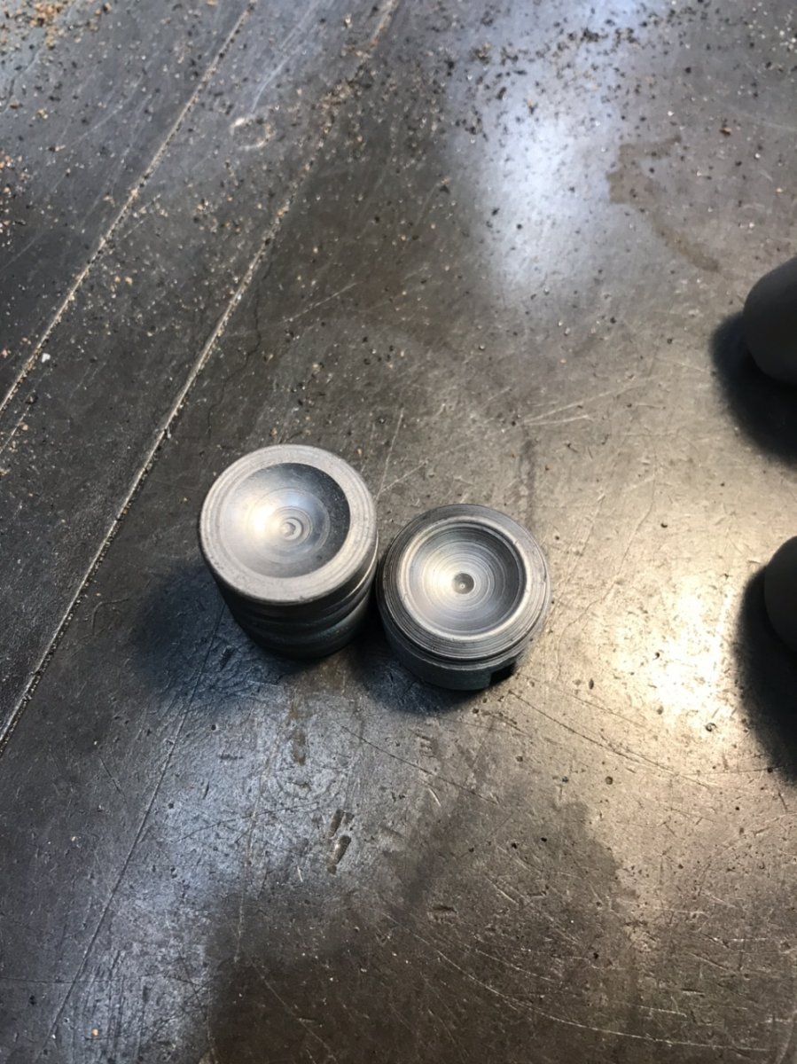

  26. Piewagn
    Posts: 1,542
    Piewagn
    oliver westlund, Baron and loudbang like this.
  27. Aaron D.
    Joined: Oct 27, 2015
    Posts: 1,038
    Aaron D.
    Those look to be in great shape.
  28. Piewagn
    Posts: 1,542
    Piewagn
    Yes they are Aaron! I was pleasantly surprised at the lack of significant wear! A new set of shackles and I'm there!!
