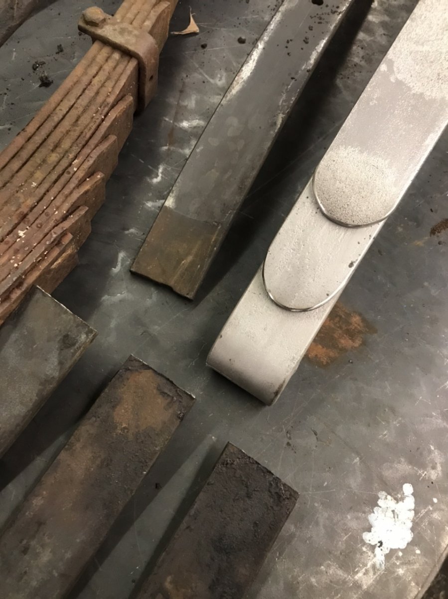

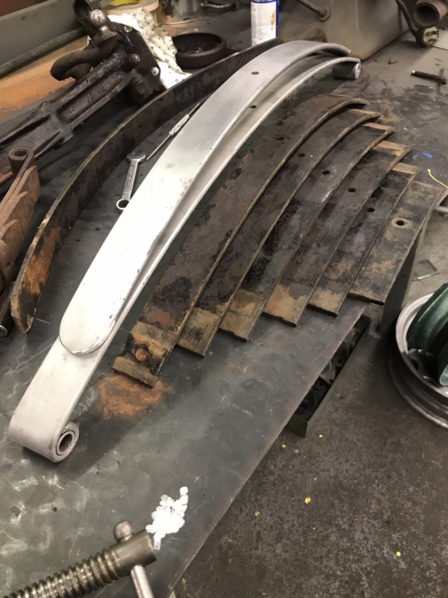

    Someone gave me this aftermarket spring, it only has 9 leaves while the stock spring has 10. Got it apart and it just looks heavier duty than the stock one. I want to remove a couple leaves because it’s even arched more and I want a softer ride. It looks like it’s been barely used and ends are all ragged looking. I broke it down and started the clean up/blasting process. I’m rounding off and dressing up the ends.....the bushings have barely ANY wear at all! Still pluggin’ away....any input on leaf removal ( how many, or none at all ) would be greatly appreciated.....thanks fellas! IMG_1620.JPG

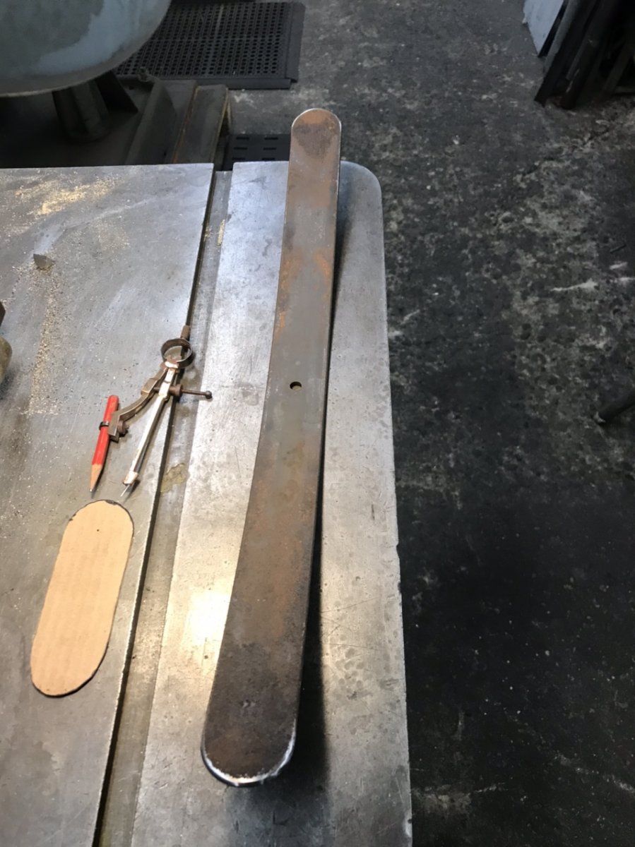

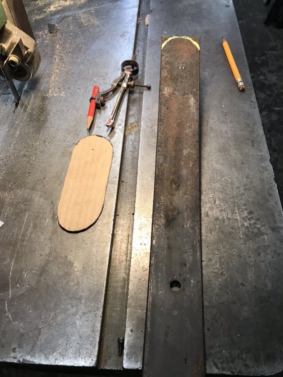

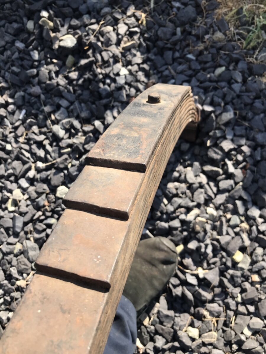

    Used a comp*** and made a template to trim the leaves...
    There are no witness marks on this spring, I don’t think it’s ever been installed on anything! The ends are just too ragged to not clean these up..... IMG_1622.JPG IMG_1623.JPG IMG_1624.JPG

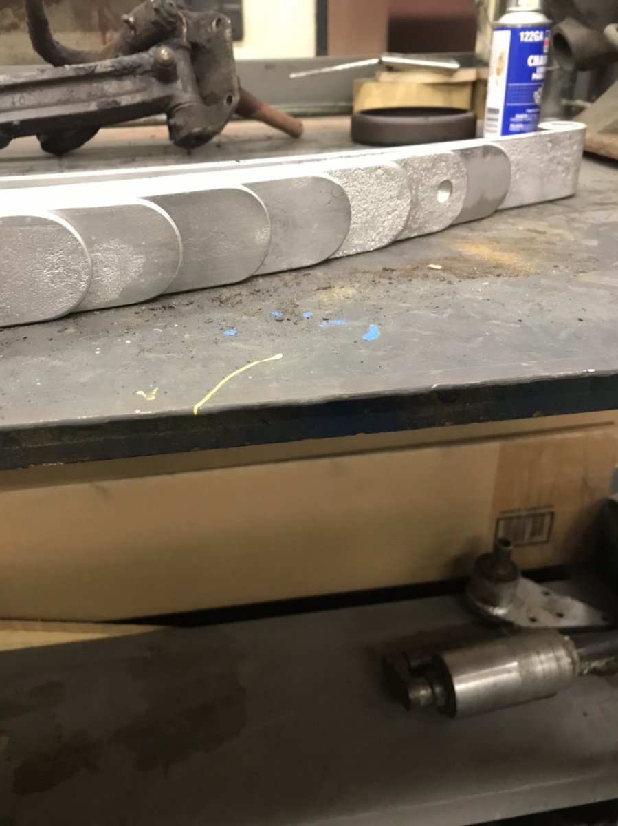

    Came out nice! Still have to paint and ***emble it....but I’m happy with it! IMG_1627.JPG IMG_1626.JPG

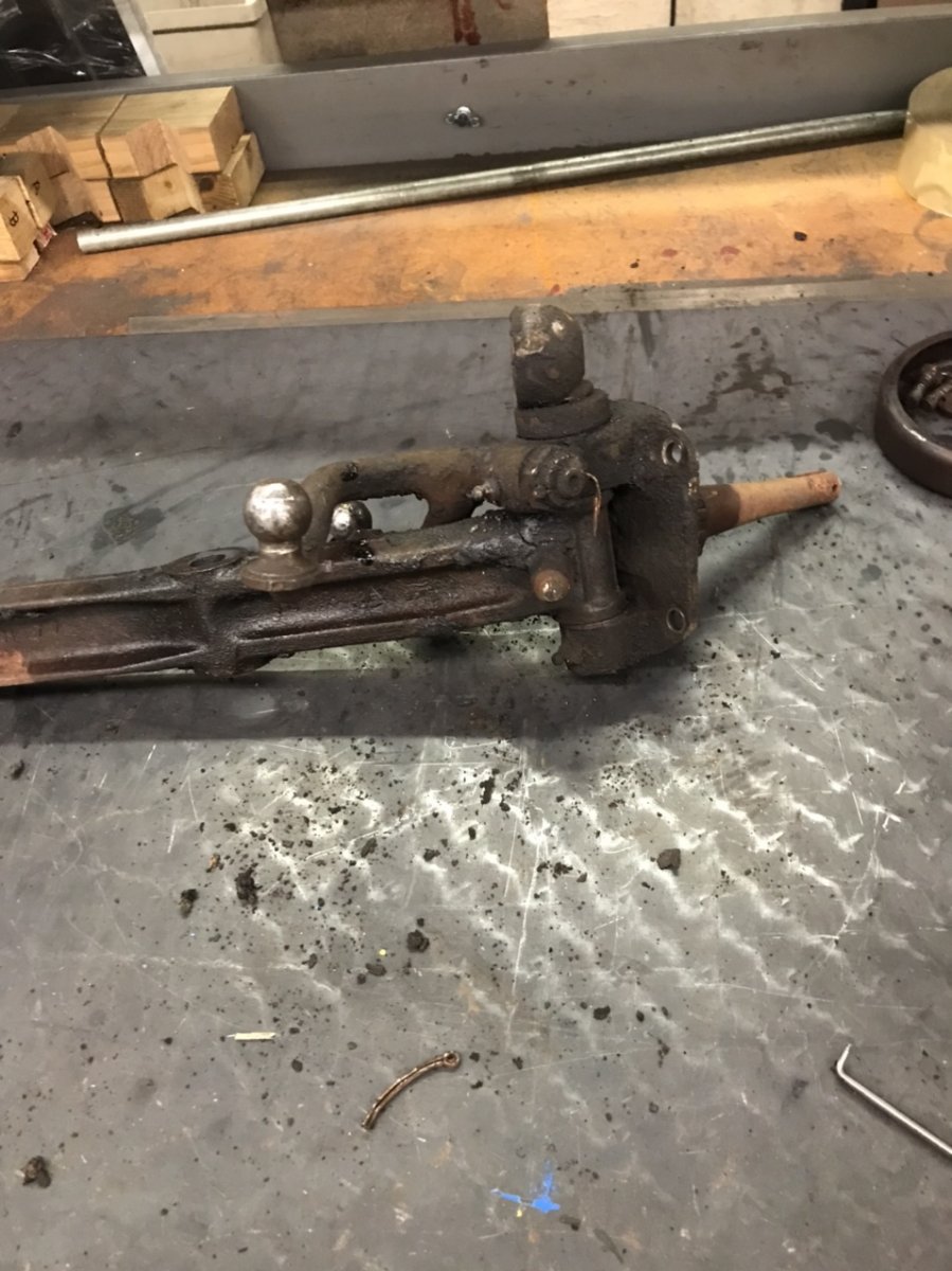

    Getting ready for re***embly of the front suspension! I’m trying to pick up a later model longer wishbone ***embly, don’t want to split the bones. Things cleaned up nicely and I’ll be picking up the paint this weekend. Thanks for following along fellas!! IMG_1638.JPG IMG_1642.JPG

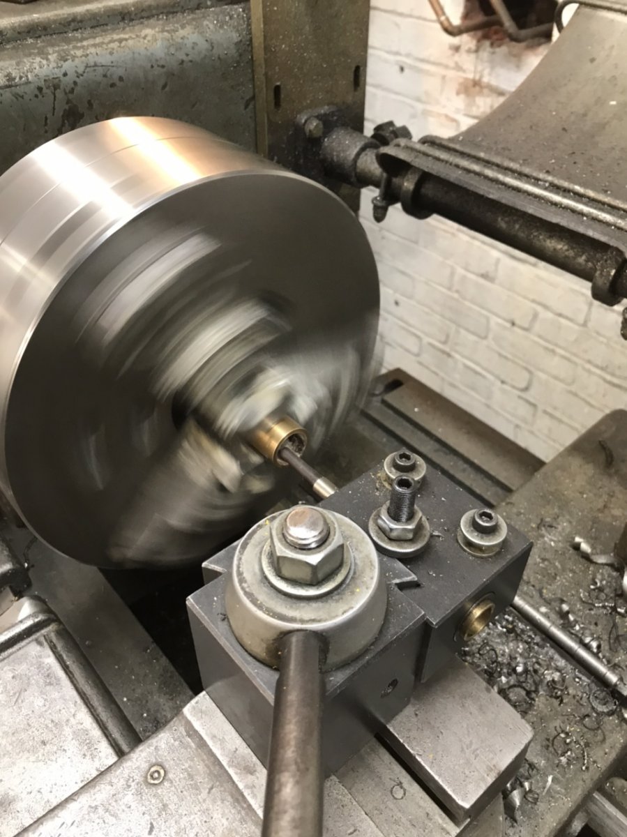

    I’m done ordering kingpin bushings and having them come in too short! I’m going with my ‘39 spindles and 3 different sets ordered for them were wrong! So a made my ******** own! I made a spiral grease groove in them with the boring bar....nice smooth fit!

    Those are '42-'48 spindles in your pictures; probably why the '39 bushings were short. Kingpins for the late spindles are longer, too
  15. Piewagn
    Joined: Mar 25, 2009
    Posts: 1,542
    Piewagn
    I ordered bushings for '42-'48 thinking I had the wrong year......they were wrong too! That's why I gave up..... I ordered 3 different year ranges and they all came too short. I already had the long kingpins and just got fed up with incompetence, wrong listings or what ever the case was. All I know is, I now have a set that work! Thanks for the input!

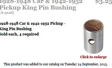

  17. Piewagn
    Posts: 1,542
    Piewagn

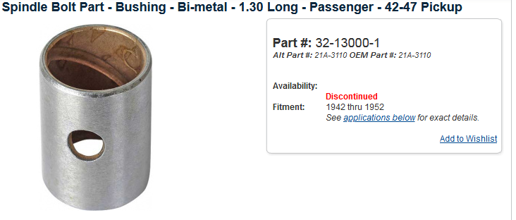

    Unfortunately these are discontinued......which is the correct 1.3" measurement and the only other thing I had to go by was model year...which I tried. I wasn't chasing another set.....:D upload_2020-1-24_22-6-42.png

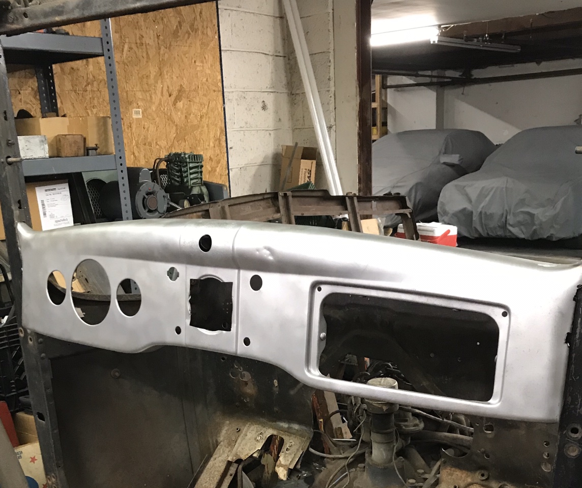

    Dash blasted, trimmed and fitted...still needs some tweeking....I know it seems like I’m all over the place, but I have to pick the job for the day depending on what my tasks are at work. We’ve recently had an operator retire, so I’m running the machines....after they’re set up, they’ll run all day and I get to piddle around! [emoji16][emoji16] Adjustments.JPG
