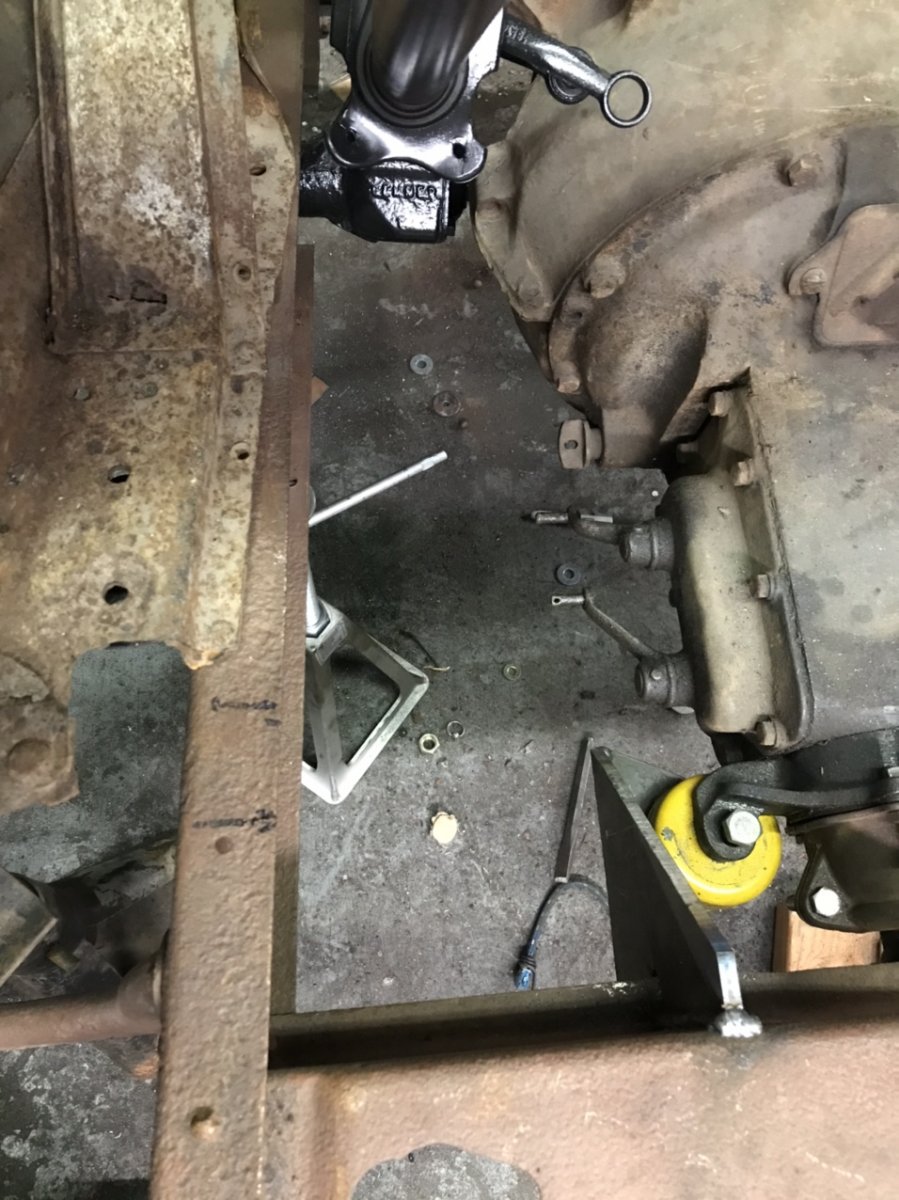

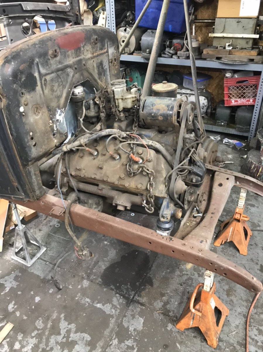

    Laid the cowl in position today to check clearances, nothing too bad that can’t be remedied. I will be eliminating the angled bracket from my pedal ***embly and making my own shaft and mounting box that will allow me to mount a more modern master cylinder and eliminate conflict with the shift linkage.....I took a couple pics to stare at, but I already have a basic idea in my head allowing me to proceed. The column drop did line right up! We shall see....input appreciated.....thanks fellas!! IMG_1775.JPG IMG_1781.JPG IMG_1778.JPG IMG_1777.JPG IMG_1780.JPG IMG_1782.JPG

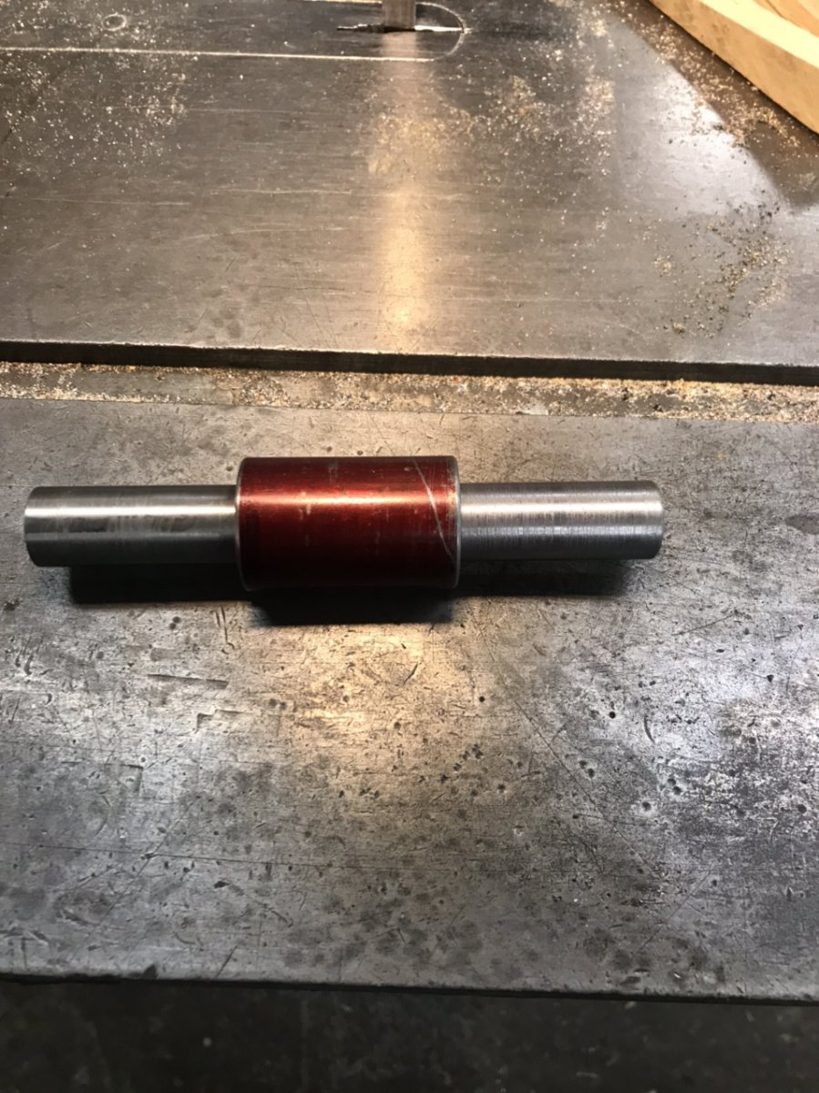

    Made the shaft for brake and clutch pedals. I’m gonna make a bracket and weld it cantilevered between the pivot shaft and a mount for the master cylinder, if that makes sense. Then secure it to the ch***is and cross member and trans mounts. You’ll get the picture when it’s done....I can see it in my head! Too bad you can’t take a snapshot of those images in your head....[emoji16] Thanks for checkin’ in fellas! IMG_1784.JPG IMG_1786.JPG IMG_1787.JPG IMG_1788.JPG IMG_1789.JPG

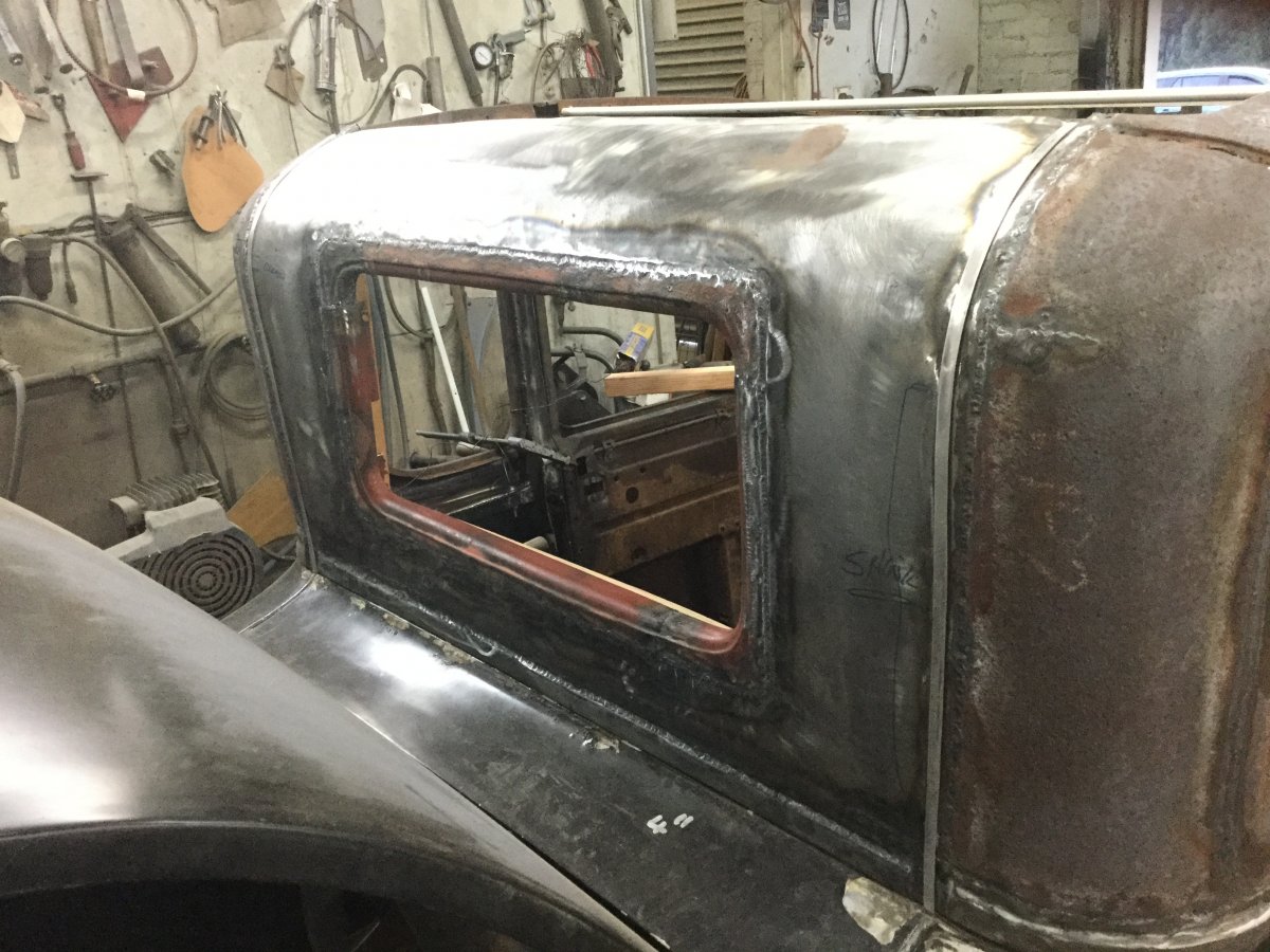

    You can pick these up through your local hardware store as aluminium T strips. They will need dressing on the edges to remove the sharp edges and notching to the right diameter. This is what they looked like on the coupe of a local rodder last year.

    Aluminum strips between steel panels does not seem like a good plan to me. Believe combination causes galvanic corrosion. Would expect it to mess up paint job. Not sure how long that would take.

  17. Piewagn
    Joined: Mar 25, 2009
    Posts: 1,542
    Piewagn
    I does seem like dissimilar metals could be an issue, especially with a bad body-ch***is ground. Snyders does sell the aluminum "T bars", but they're quite pricey...Thanks for the input!!

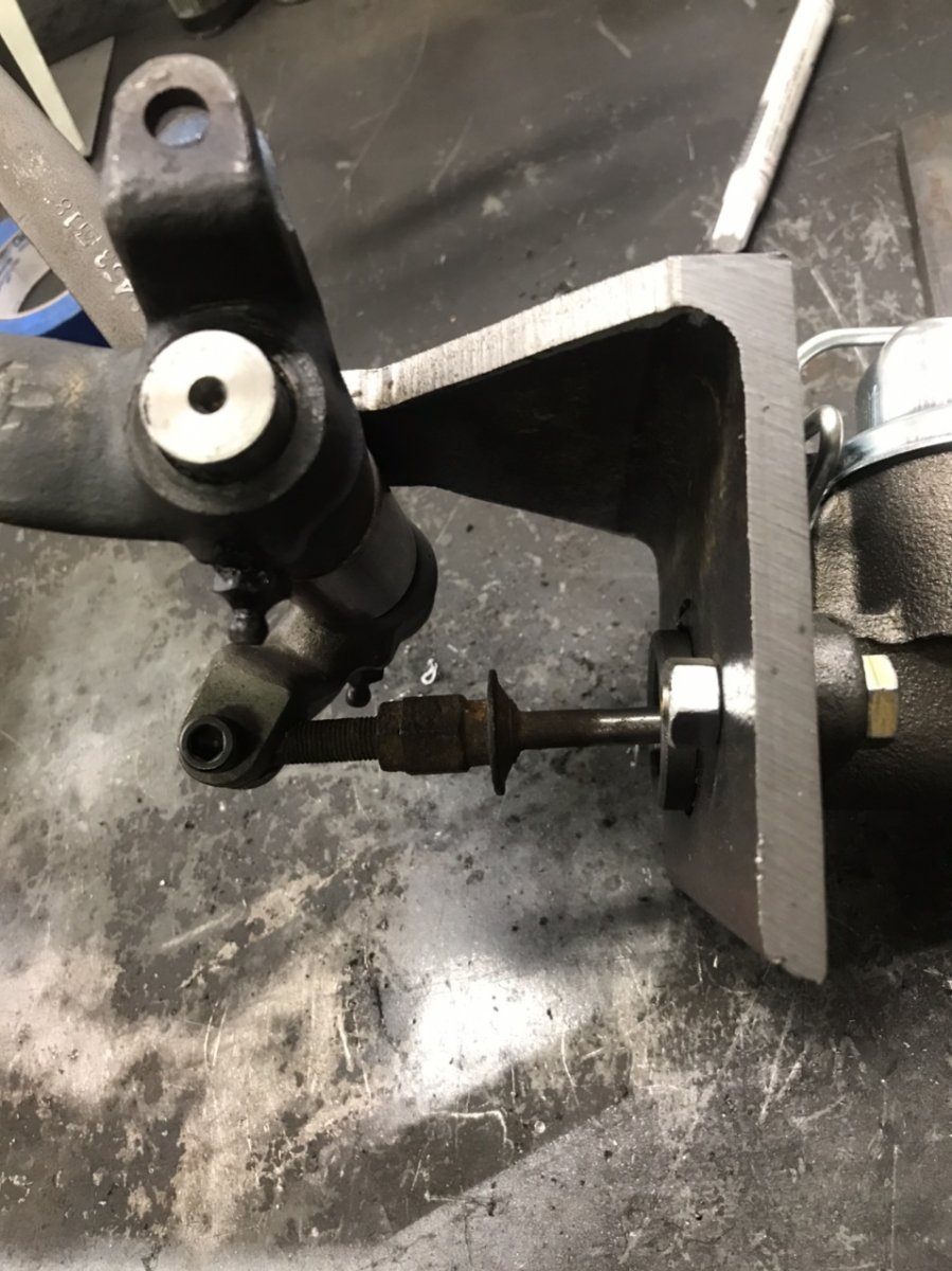

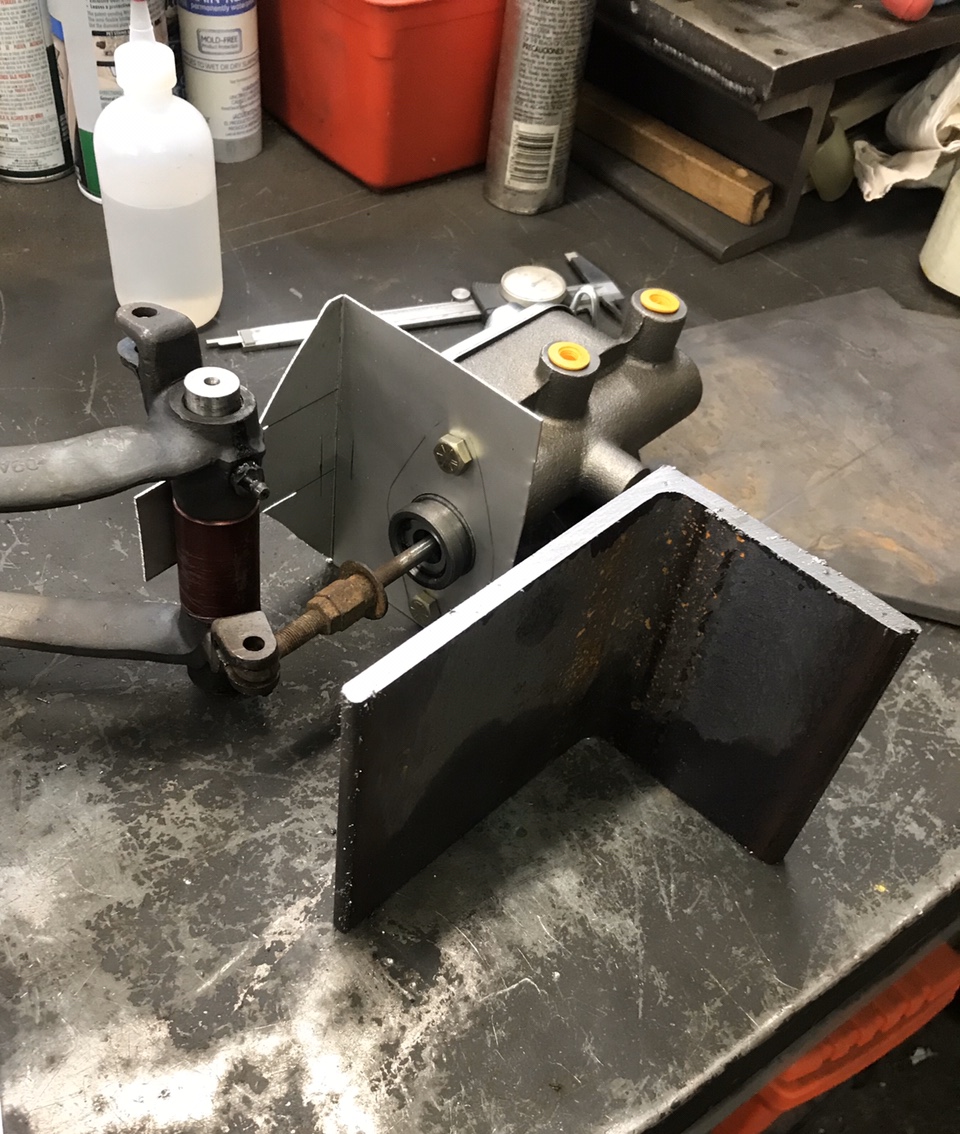

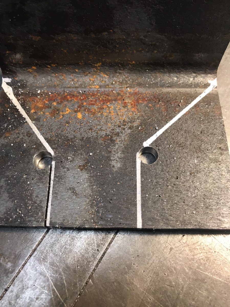

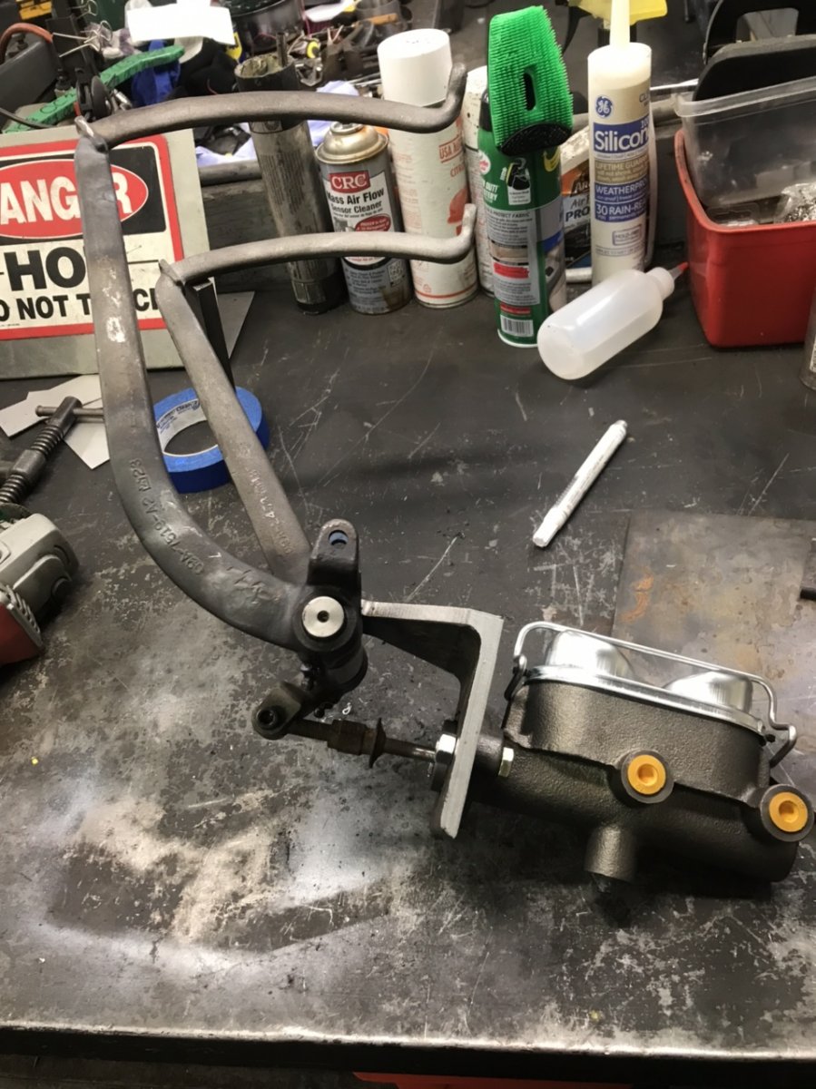

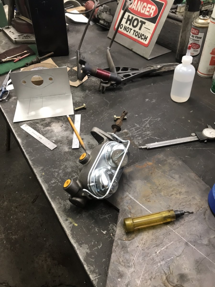

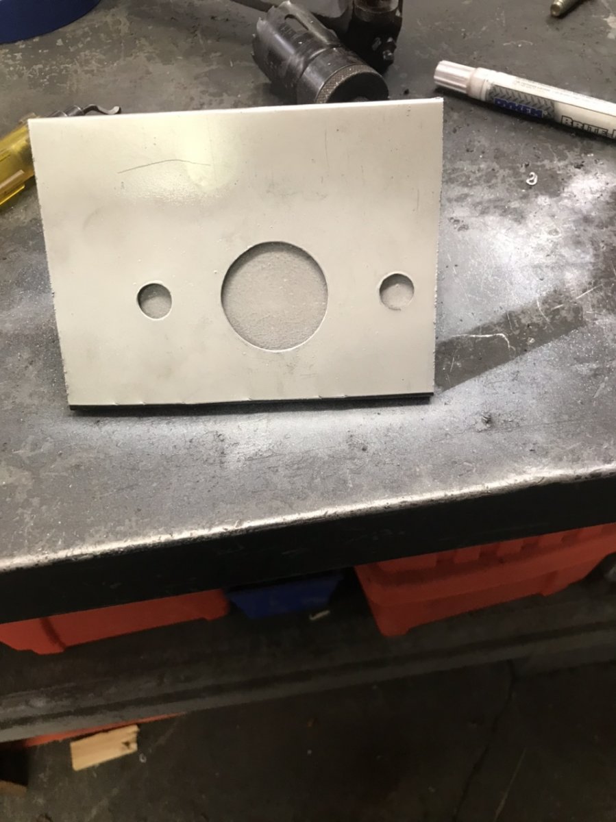

    Made my master cylinder bracket today! It’s just tacked for now. I need to figure how I’m gonna mount it and keep it serviceable. Should be no biggie taking some measurements and making another bracket. After I figure that out, I’ll finish welding, break the edges and tidy everything up.....happy weekend fellas!!!! IMG_1792.JPG IMG_1793.JPG Adjustments.JPG IMG_1795.JPG IMG_1796.JPG IMG_1797.JPG IMG_1798.JPG IMG_1799.JPG IMG_1800.JPG IMG_1801.JPG

    Took some time today to dismantle brake ***embly and cut the snap ring grooves....came out nice....movin’ on! Thanks for poppin’ in fellas! IMG_1803.JPG

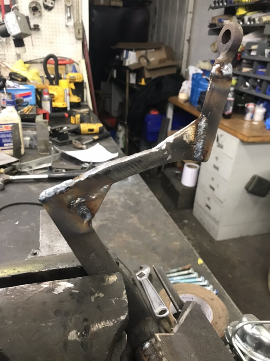

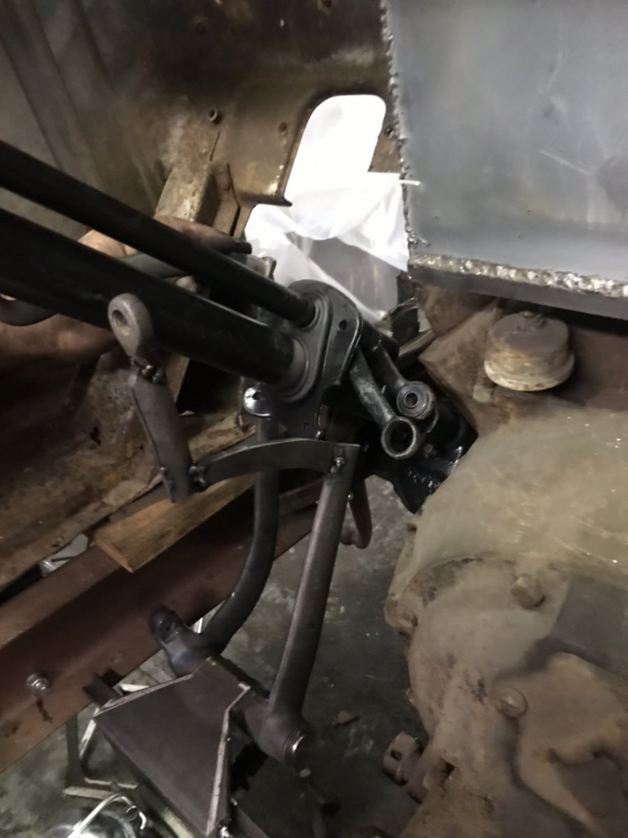

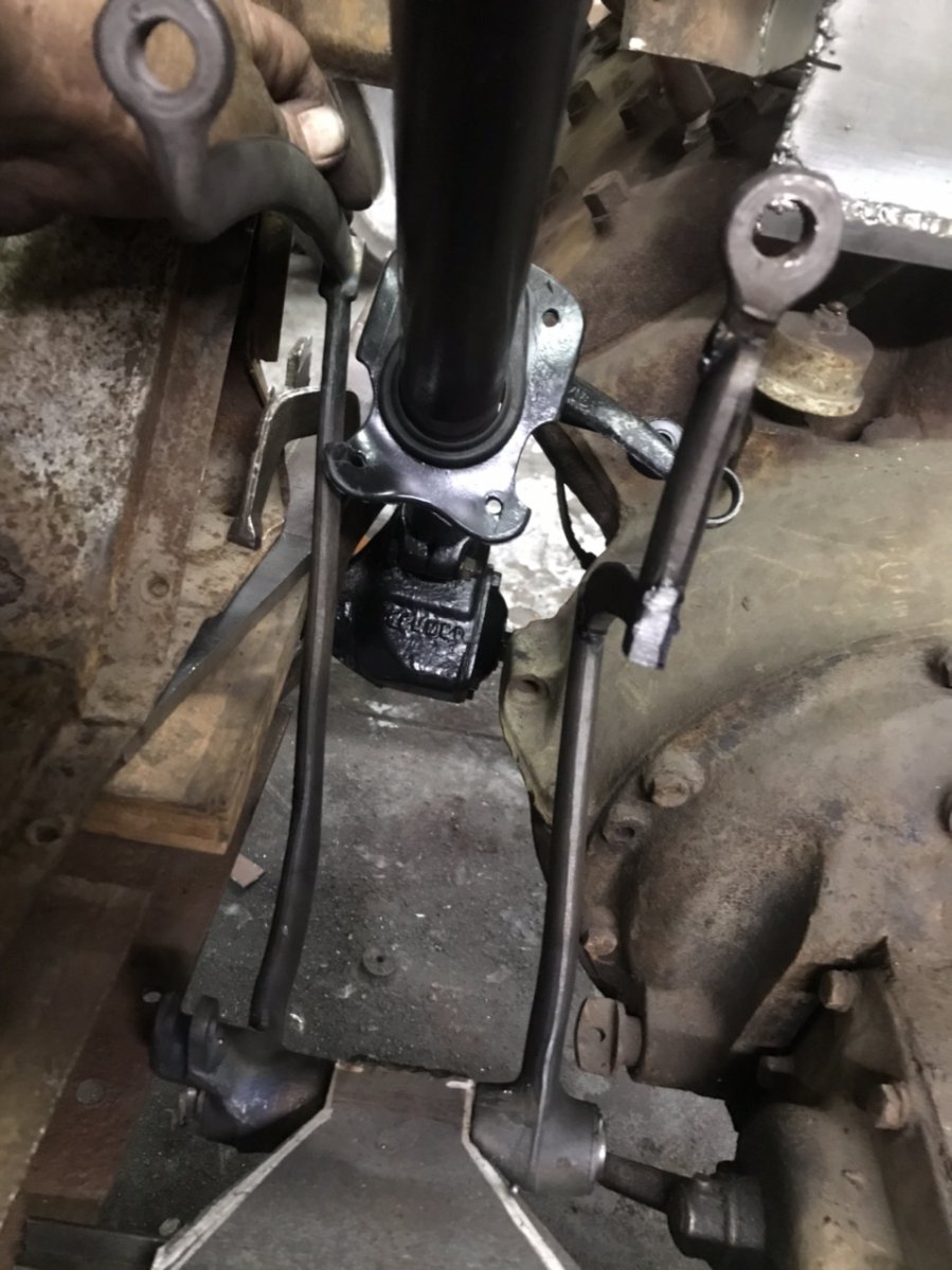

    Huge hurdle tonight! This area had me highly discouraged and quite frankly close to bagging it.....at least until I saved funds to buy a different trans and steering column, or buy the Kingshifter and clear my head. I’ve remedied my issues with clearance for shift linkage, brake pedal and even got my steering box in a location where the pitman arm is close to factory location. I modified the brake pedal, moved steering box up and forward and now have my location for master cylinder. Clutch linkage is a breeze at this point. I need to tidy up the brake pedal arm, it looked way better before I hit it with grinder to knock down some welds. I’m there fellas! It’s gravy from here.....WOO HOO!!! Thanks for stoppin’ by! IMG_1821.JPG IMG_1819.JPG IMG_1823.JPG IMG_1825.JPG IMG_1838.JPG
