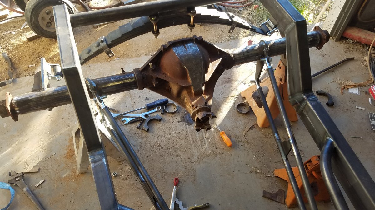

  25. Also was able to get the rear end mocked, Then brackets welded and rear spring hung
    Let me tell you this **** isn't easy. Trying to figure out spacing for brackets and the magical 45 degree.
    After all the BS of measuring several times taking the spring apart and using just the main leaf. I got it tacked.. Then read the Posie site for the spring and it gave the measurement needed for the brackets.. I was spot on :D
    Hooking the spring into place was a chore also not as easy as a regular 2 spring set up.
    Used a HIGH LIFT or Farm Jack what ever one calls it.
    Braced against the spring holder and a tie down up around the frame and down below the lifting point of the jack and cranked it up until things lined up..
    There is NO WAY I can see hooking one of these to the axle out of the car..
