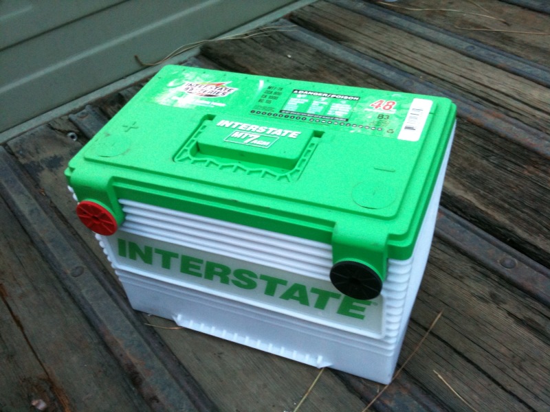

    OK, the Interstate rep warrantied out my Optima RedTop for an Interstate AGM MT7-78...I only had to pay a $22 difference. The Interstate AGM has a 4 year replacement warranty and they are expected to last 8 to 10 years.
    Anyone else use one of these? Here's a pic:
