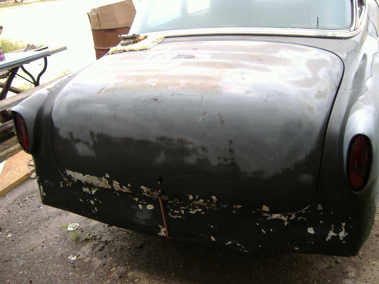

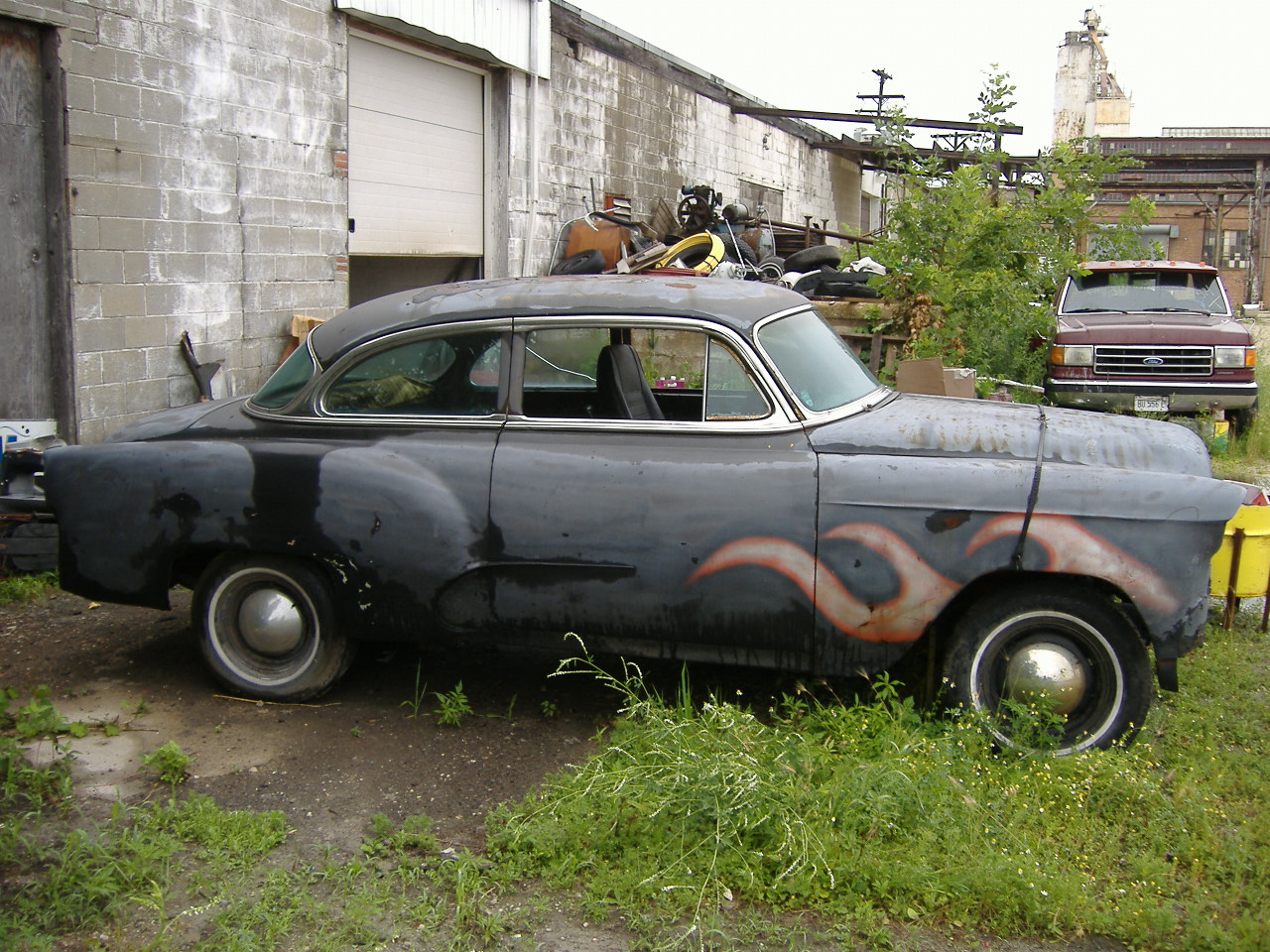

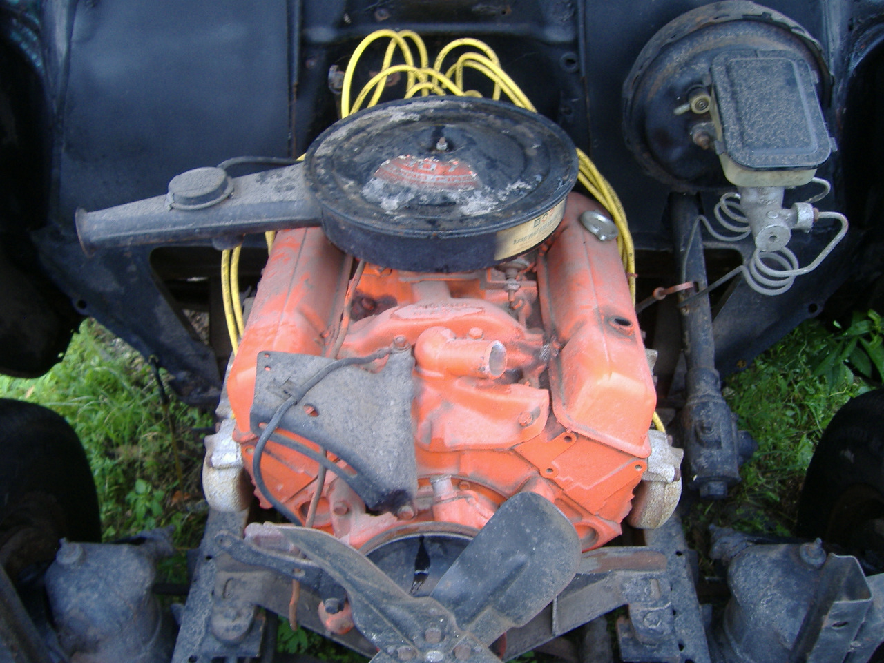

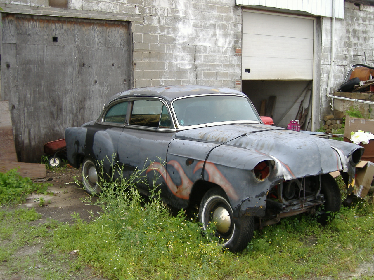

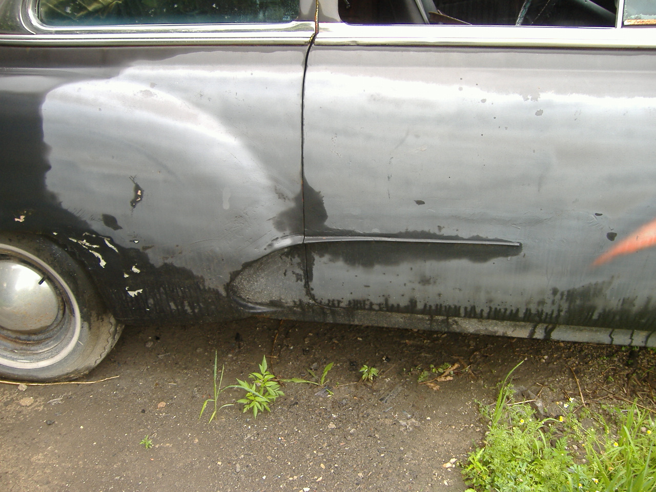

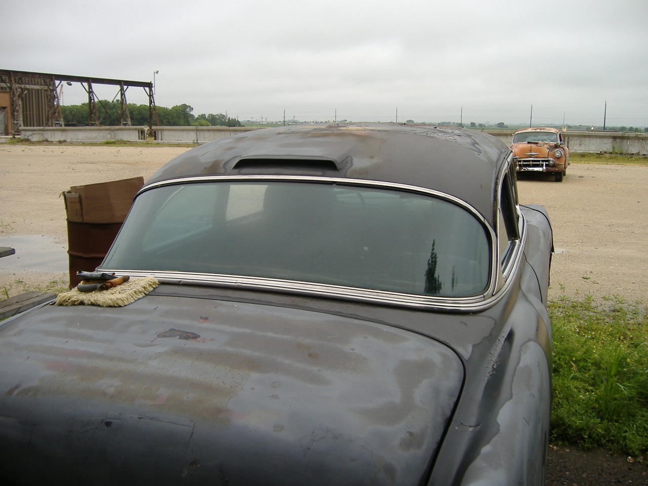

    I bought this car about 2 years ago and have been working on it slowly. Currently getting the finishing touches to the underside of the body and the frame enough to finish weld the frame for paint undercoat the underside of the body. Mods done so far are gambino notch and 4 link, mustang II with air ride, chopped with 51 fleetline rear window, 56 packard tailights, narrowed 56 chevy bumper, louvered hood, 55 chevy headlight bezels. Gonna run a 307 and a 700r4 with a 10 bolt. Here is what i started with.

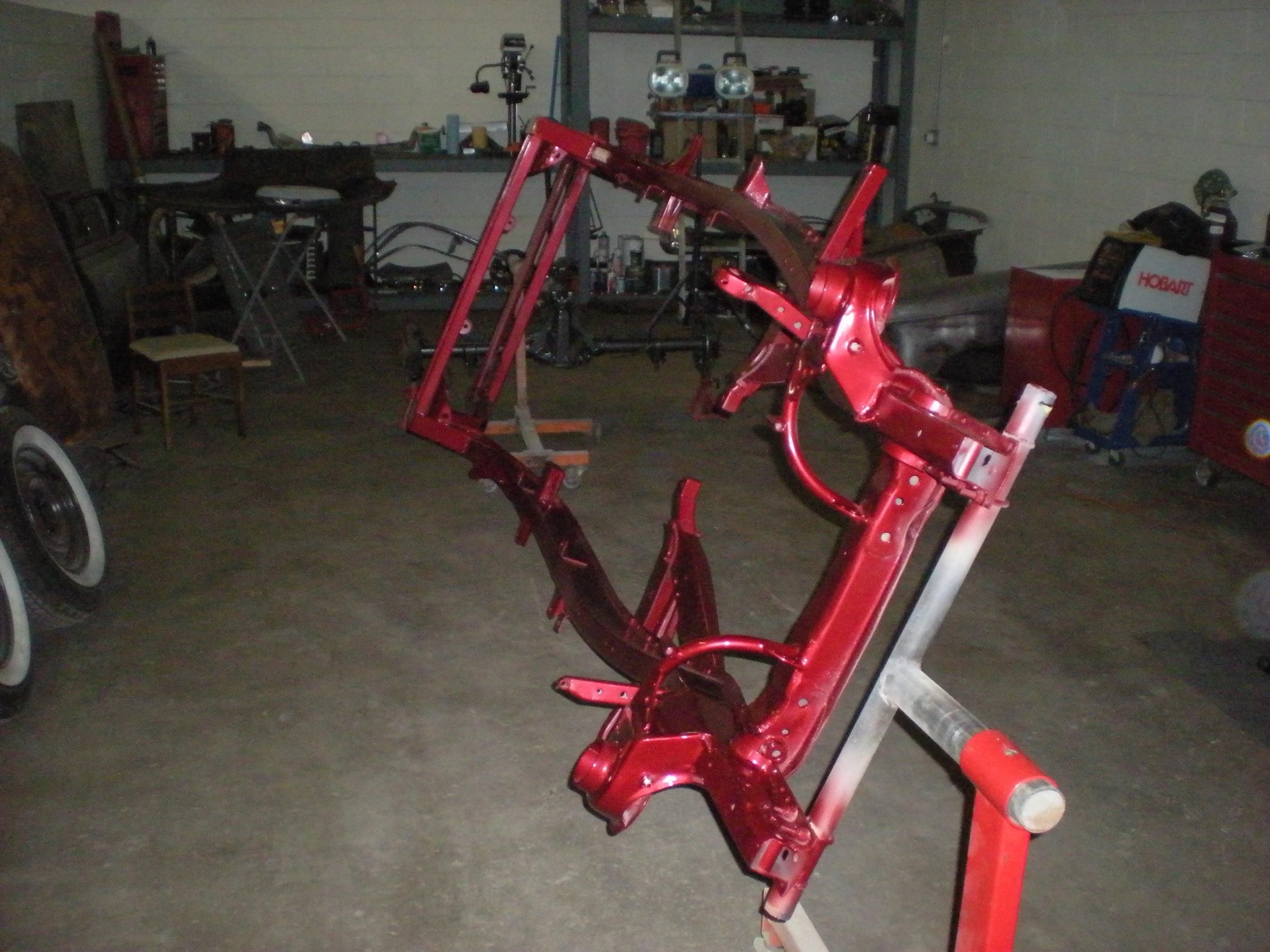

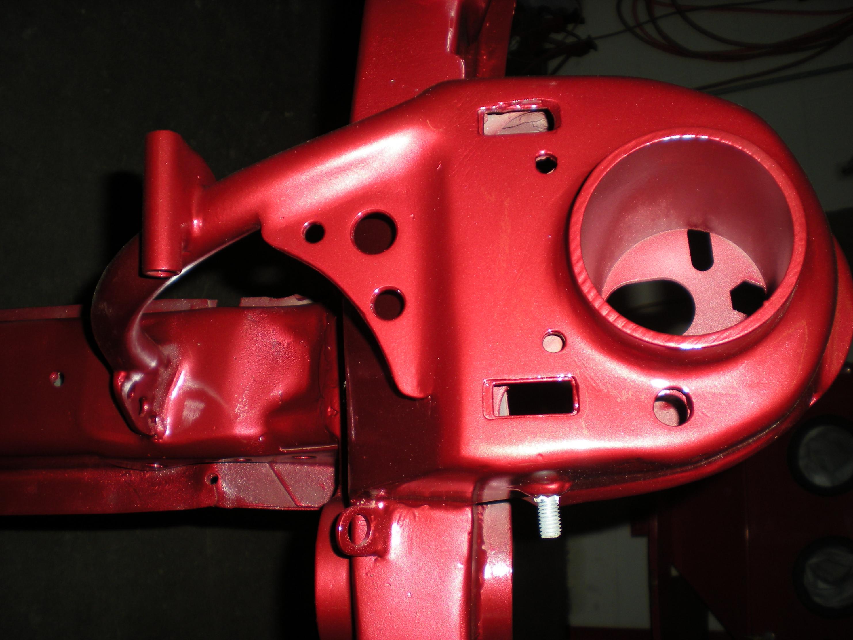

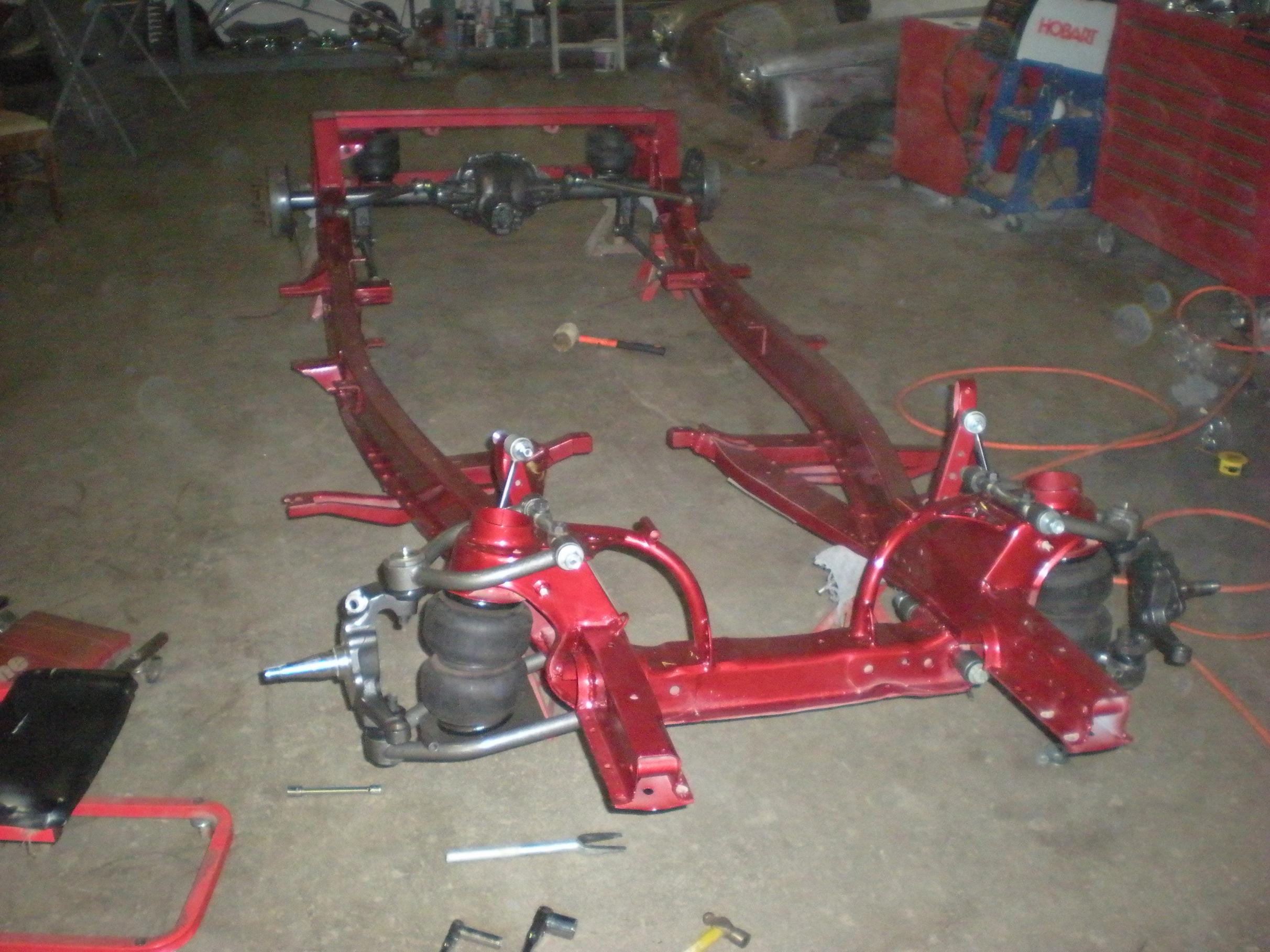

    Got the frame welded up and painted and started re***eble it today

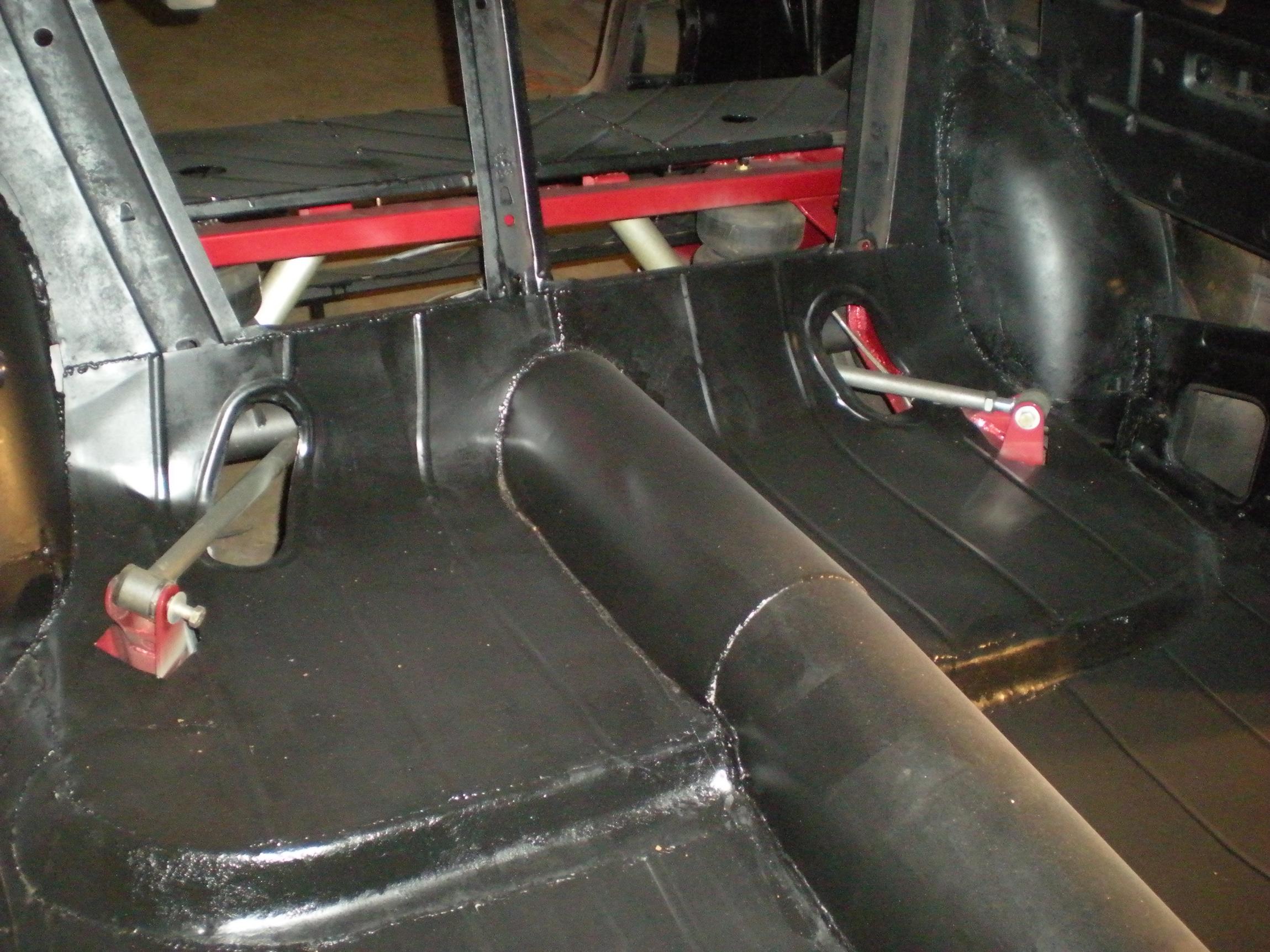

    I have slots cut into the floor behind the rear seat where the upper bars come through. The gambino kit was awsome to install. There were some great tech articles on here of how to do it.

    Got the floor all sealed up and painted along with the rest of the interior. Now on the next step, A crafter air ride kit from Kustombuilder
