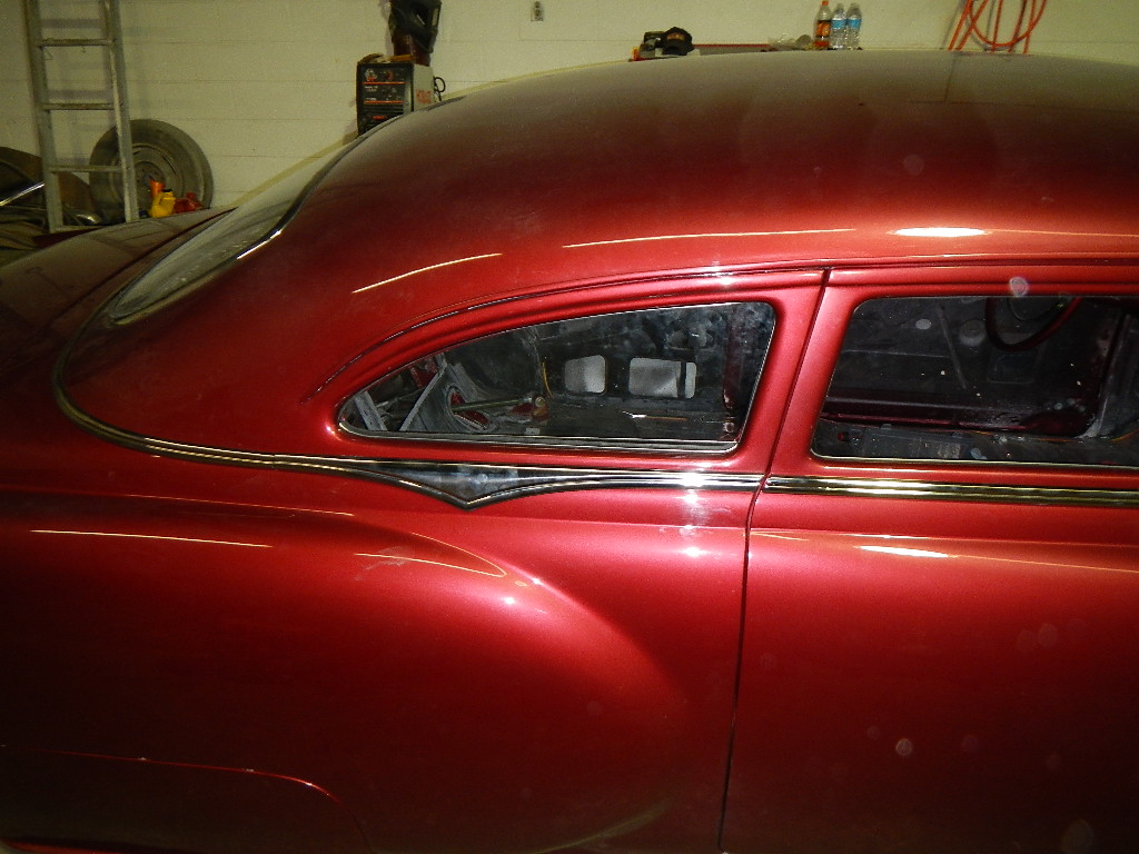

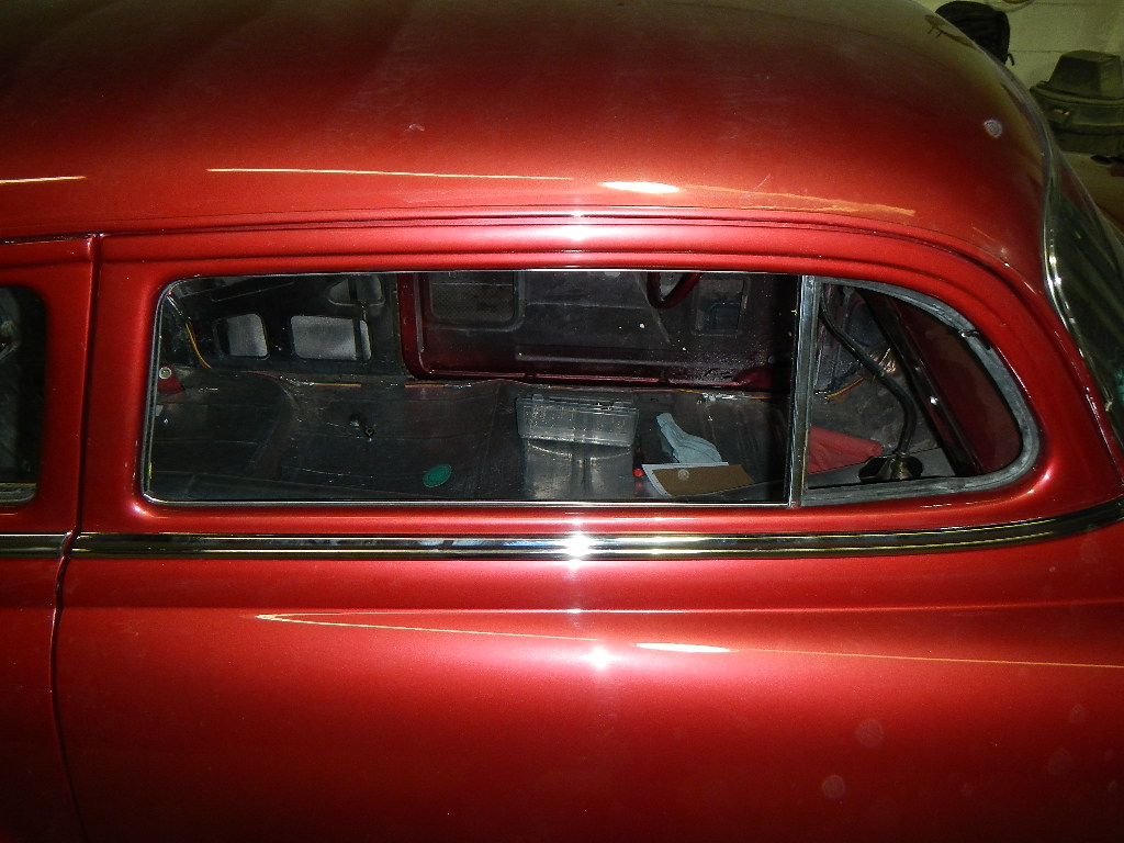

    Thanks for the compliments on the car guys. I got a ton of stuff done to the car this weekend. The rear windows are installed. All of the beltline trim is on except for the caps for the transition for the Pontiac trim to the original beltline.

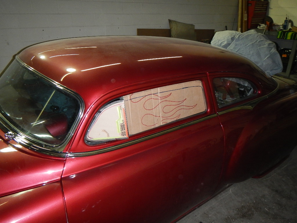

    Also got the wing windows completely modified, all of the fuzzies installed in the doors, and templates made for the door gl***.

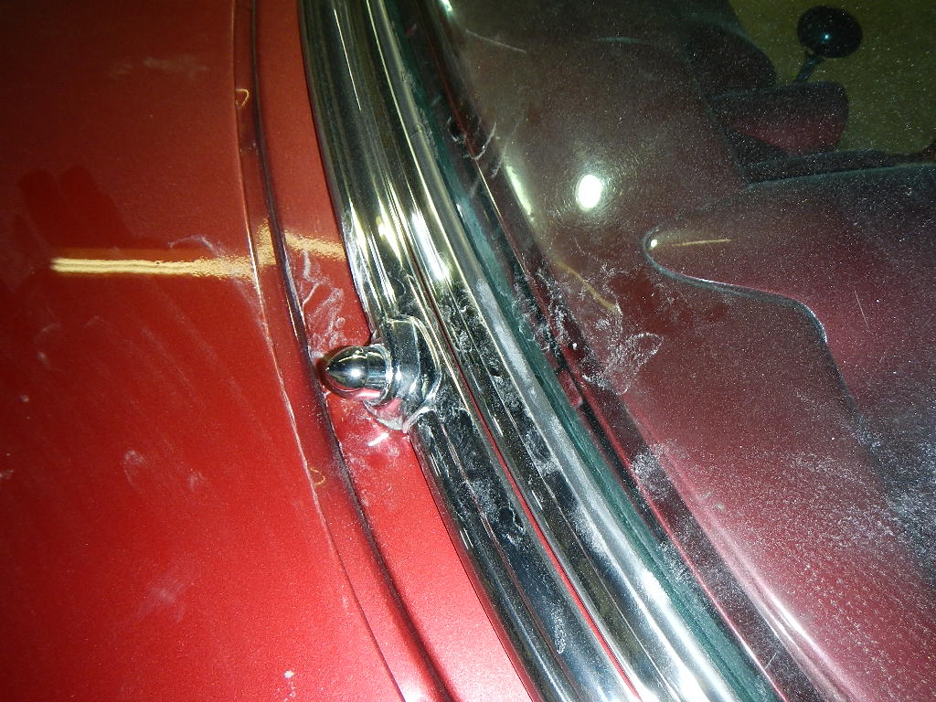

    Also ***embled the wiper shafts into the car and capped them off with a set of bullets from Danchuck.

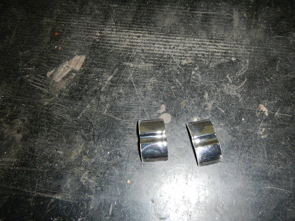

    The cap parts are made to put over the end of the Pontiac trim, just need to clean up the edges a little better and polish them up.
