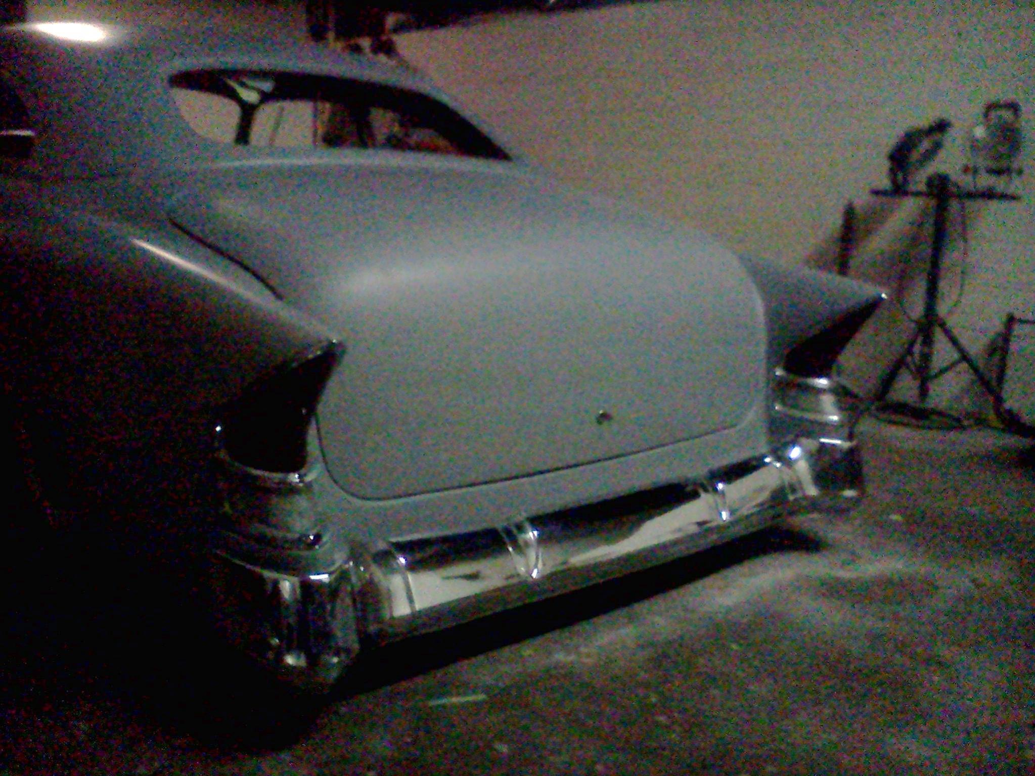

    Started mocking up all the parts last nite. Got the bumper on which needs a little adjustment still, the tailights are in but are needing rechromed before the car is completed and the trunk lock is in. Next for the rear I need to figure out what Im gonna do for rear bumper guards.

    Looks Great! Those are '56 Packard tail lights? Off which model?

    Thanks guys. The tailights are 56 packard clipper lights. I modified them to remove the material from under the reverse lense to make the bezels a little smaller

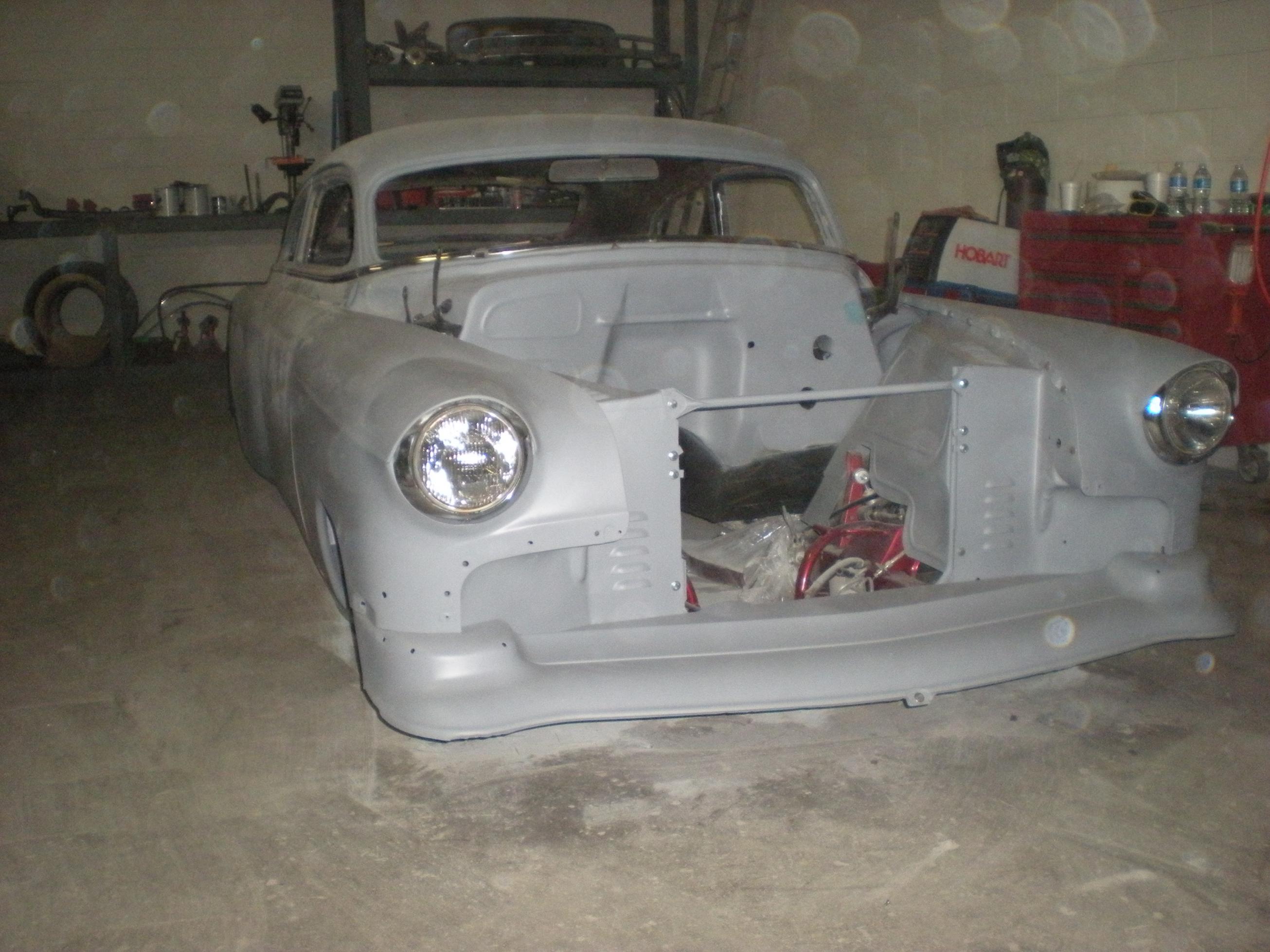

    A little work got done on the car this weekend. Got the nre inner fenders almost completed, and got the loose hood hinges rebuilt. I ground out the rivets, sandblasted them, and used a shoulder bolt that was left over from another car build to hold the hood to the hinge. need to get locknuts for them this week.

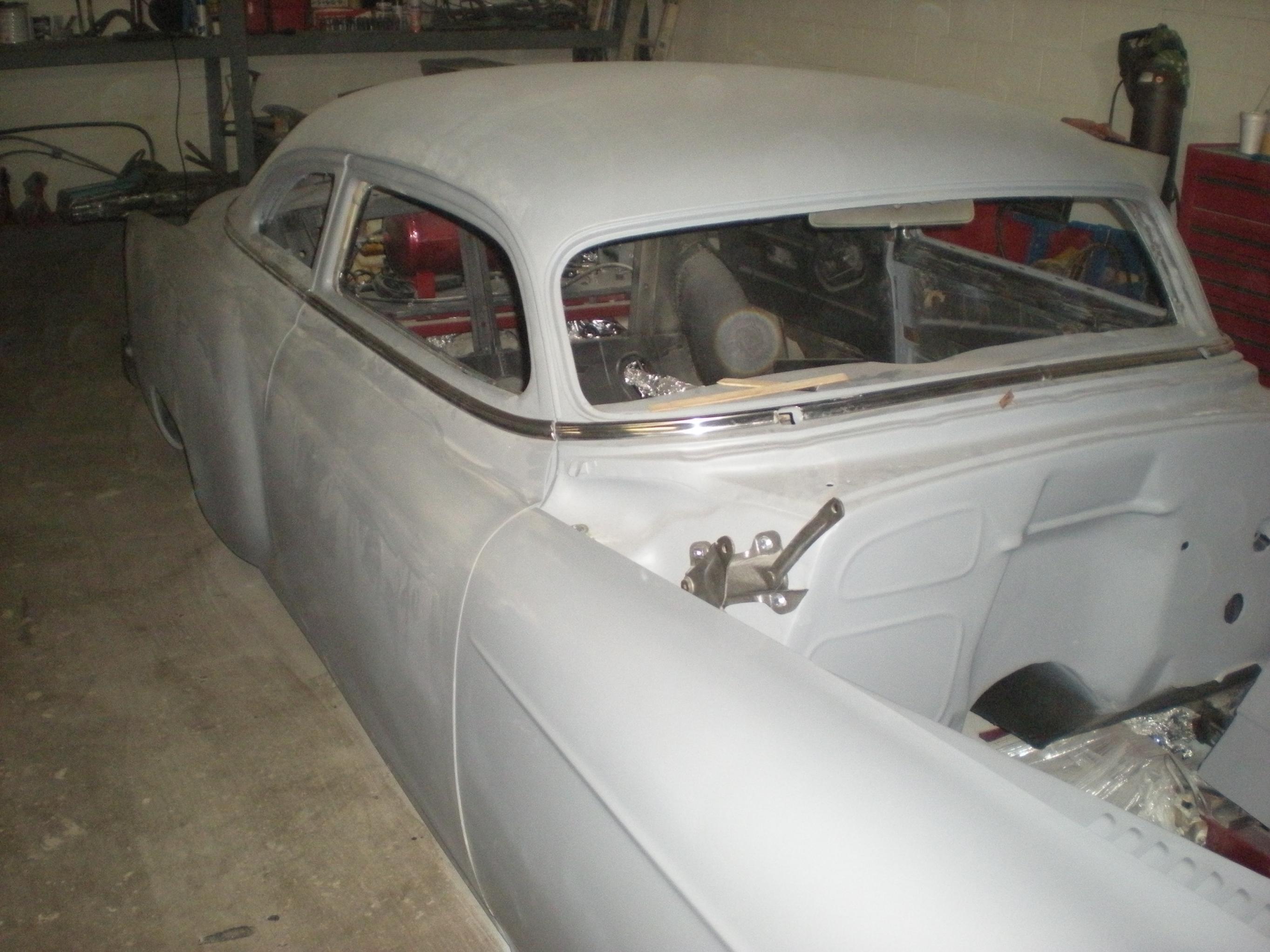

    Everything is looking good so far except the seats. The seat should look the same, the back seat looks right, the front seat top edge is to narrow compared to the rear seat which is wider. Ii would go back and correct the front seat.

    I did notice that on the seats where the top portion of the white is not quite as wide as the sides or the rear seat. I have already had new rear portions made a second time for the fronts and they are still thinner. I think I can live with it for now but we will see once the car is done and the seats are in it. At that time i may go back to the company and see what we can do.

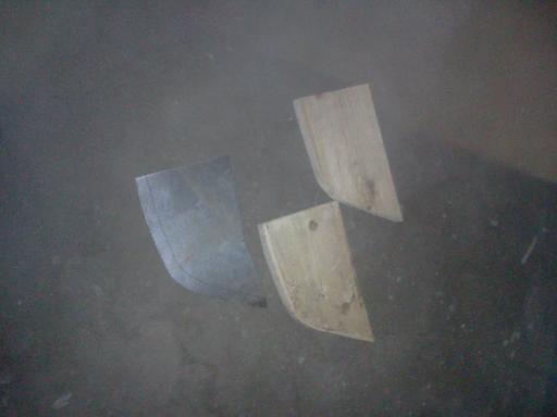

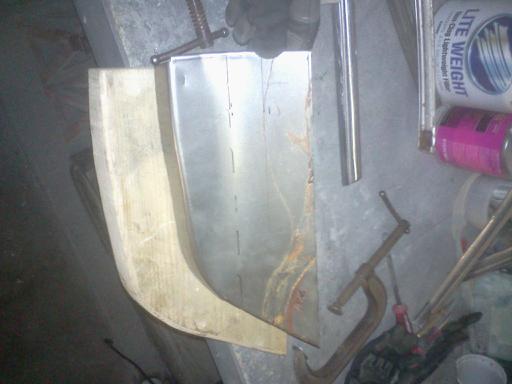

    Not a whole lot of work goin on with the car latelly. Made some patch panels for the front fenders and stated patching them this weekend. Out with the rusty old and in with some new metal.

    Thanks for the compliments guys. No pics of progress right now. Currently doing body work on the front clip and attempting to get the hood straightened out right now. I may look for another hood if I can find one close and affordable

    Got a little done latelly but havent posted anything. Since the last update I have gotten the bodywork pretty much done on the front clip but am needing a hood. Got the front garnish moldings roughed in pretty good and started bolting everything togeather to check the fit.
