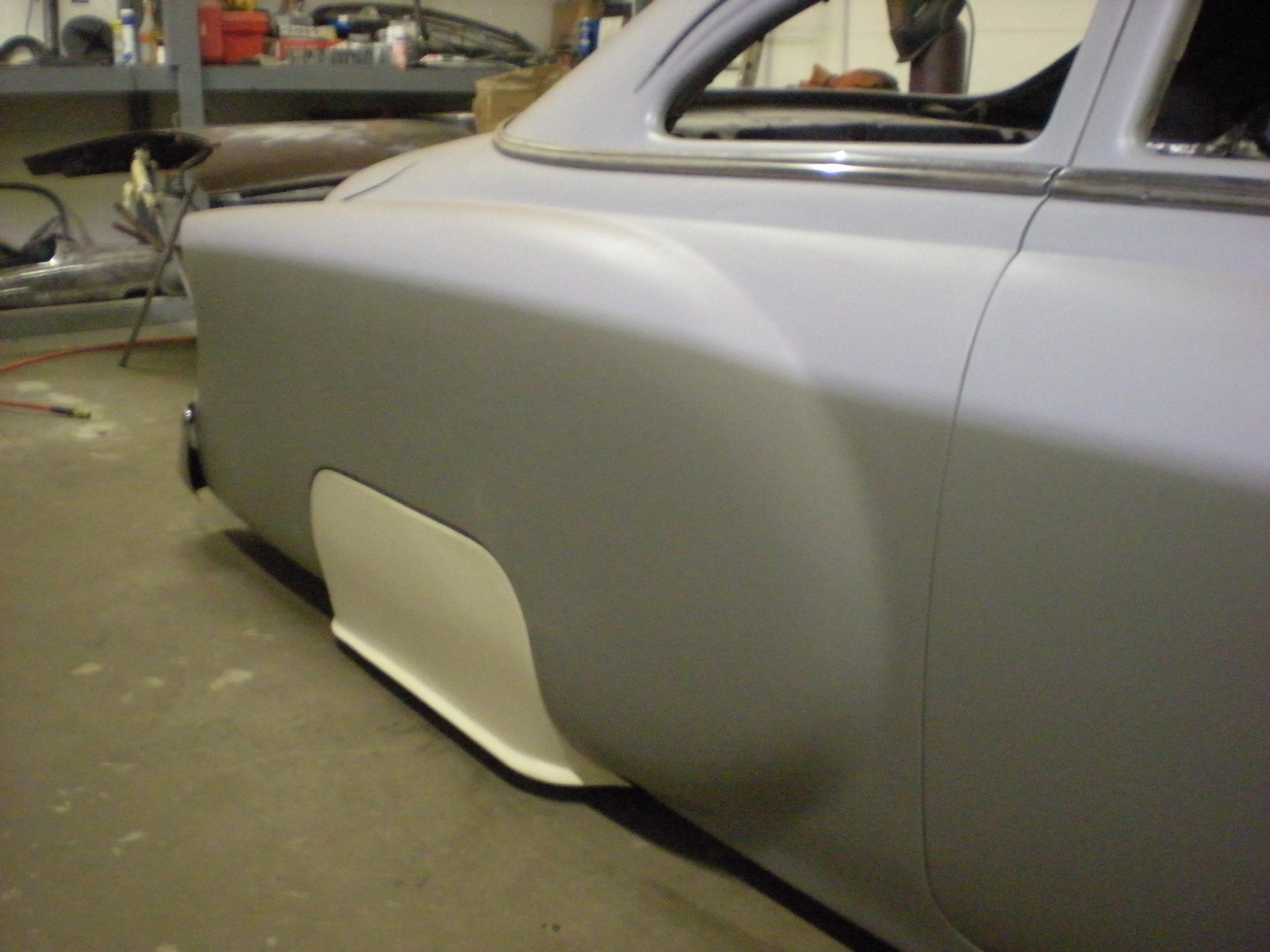

  24. Tin Can
    Joined: Nov 18, 2005
    Posts: 2,096
    Tin Can
    Been busy on the car latelly. Got the entire thing blocked out and ready for what I hope if the last coat of primer before paint. Workin the skirts now to get them mounted and modified to fit the openings the way I want them to. My fingers are hurtin after the weekend of sandin!

    Can you tell me who makes those skirts or where I can get a set... I really like the way they look
  26. fishslayer82
    Joined: Jul 21, 2006
    Posts: 357
    fishslayer82
    Looking Great. Im building a 53 right now and am gettting close to driving it. Cant wait
  27. Tin Can
    Posts: 2,096
    Tin Can
    I picked up the skirts in the for sale section here. The member I bought them from said he bought them from a vendor at viva.
    Fish, I cant wait to get my car to that point of almost driving it! You are waay ahead of me!
