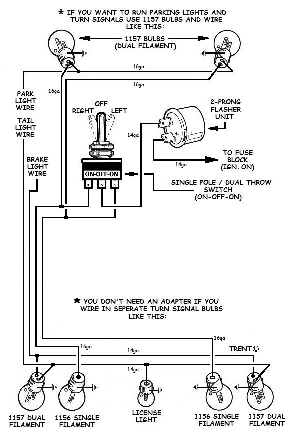

    Wiring, wiring and more wiring. Trying to make this as simple as possible, yet still have turn signals, horn, a few power outlets (aka cig lighters). My wiring diagram for an AMC Metropolitan has been very handy. I am even wiring the tail lights like the Metro's since it has both 1157 and 1156 bulbs in each tail light. Trying to keep everything tucked out of sight, but still easily accessible.

    Wiring is definitely a pain some times!
    I just got done wiring my race car (save for the windshield wiper and license plate light). I bought a Rebel 4 circuit wiring harness, really made things go easy for the most part (the horn was the hardest part!).

    1. Y-blocks
    Awsome build every time I loo0k in on you:D
    Keeping turn sigs out of site was also my son's plan,so we tucked away a EZ to rech toggelswitch with this set up.:cool: But you do need to remember to flip off after turn.
    It was cheep and EZ hidible.
    But best deal I've see lately was on here,if there is room for it @ http://www.jalopyjournal.com/forum/showthread.php?t=617875&highlight=turn
