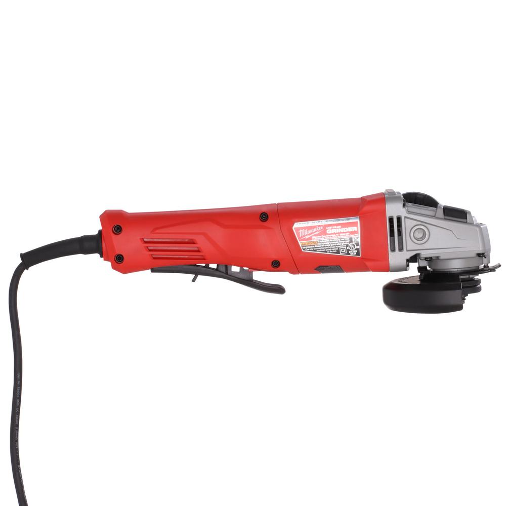

  30. I realize not everyone gets the opportunity to use different types and designs of the same tools. In this case 4” grinders.
    They all have drawbacks but some are worse than others. The main thing is it’s got to be comfortable in your hands and you need a grip on it with control. A good grip like King Kong and control like a surgeon. Without good grip and control you’re gonna loose both. Kinda dangerous when you have a 10,000 rpm tool.
    The short body ones are incredibly hard to do this with, the switch placement matters, the body diameter matters, and amperage matters. For bench work I like a high amperage long body with paddle switch. D38887C0-3542-44C3-B8CB-B78F0B88AC14.jpeg
    The paddle switch can get flaky and become a live switch so it shines everywhere except putting it down.
    For out of position work I like a small body low amp tool. The low amp is easier hang onto with one hand behind your back, upside down, and can’t really see. It’s not as aggressive so it’s easy to control.
    The worst of the bunch is high amp short body. Those things are incredibly hard to hold on to, blade close to body and the fingers, switches in ****py places.
