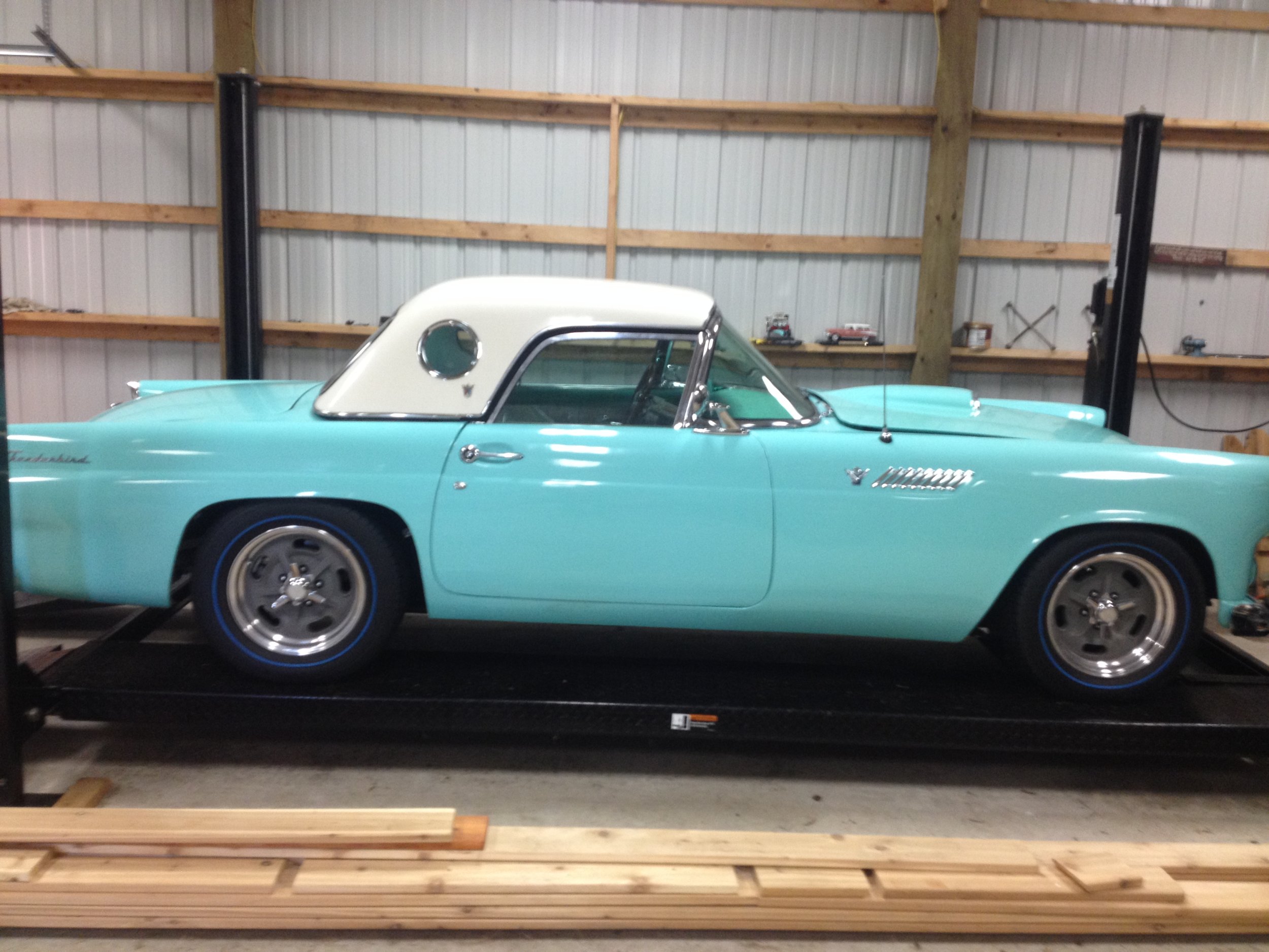

    I lost track of this thread. Speedo- no loop in my cable, or enough length to make one. Makes me wonder if someone subs***uted a cable from something else. Maybe to make it fit the C4?
    The hard tops are the same, as far as I know, but the hold downs are different. A look at the Thunderbird parts catalogue shows it. If the top had portholes (I think they came available mid 56) it didn’t get the emblem behind the side window. My 55 top had no portholes, so I added them with the “factory licensed kit”. So I’ve got both emblem and portholes. Dead giveaway. Amos Minter is the top of the line in restoration work. You’ll find one for less, but it’ll need work. All of which you can do, if you decide you need one.

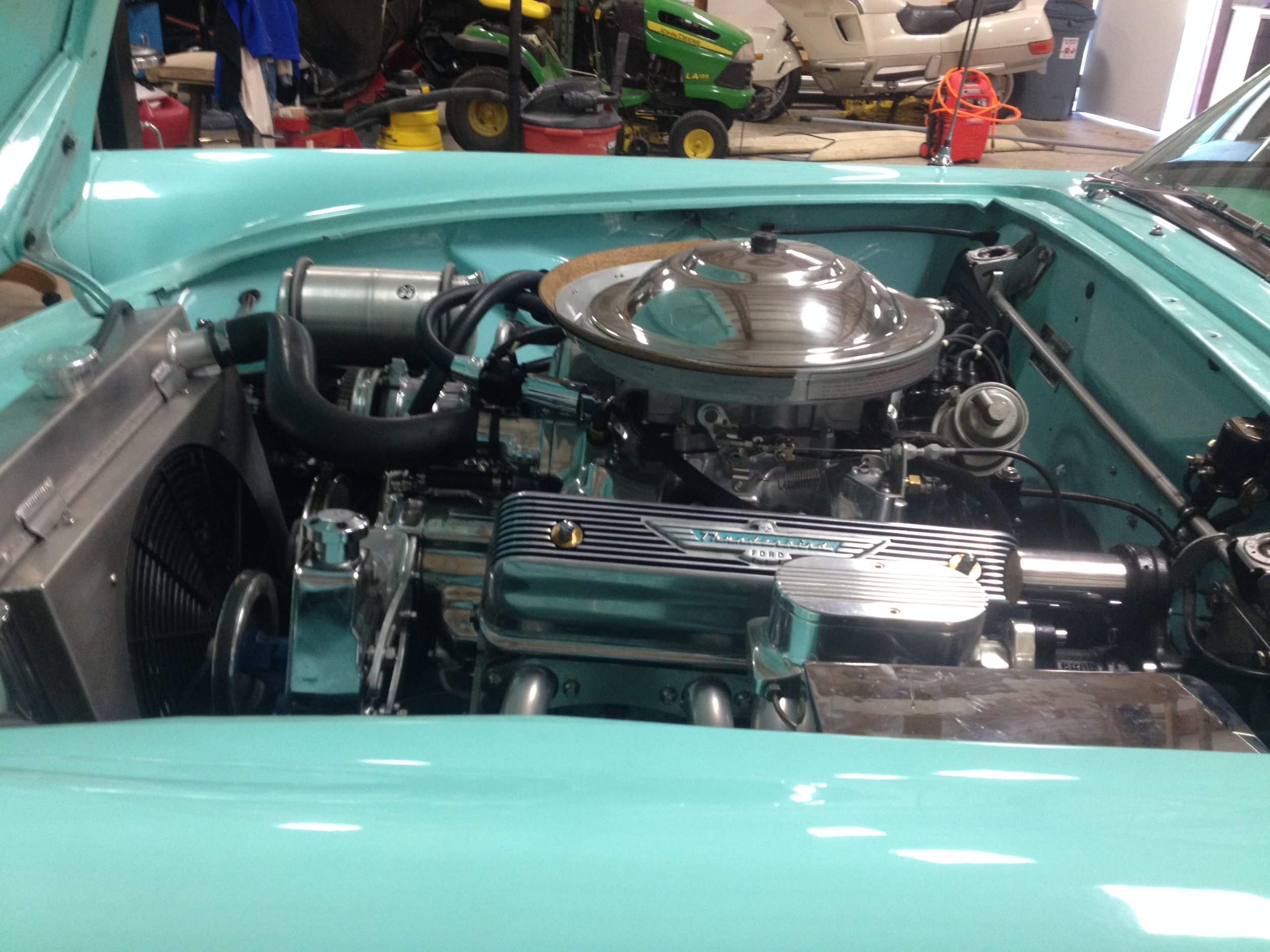

    You’ll need a shroud, upper and lower for the radiator, no matter what fan you use. The “bird guys sell a molded lower shroud that goes out to the corners of the lower half. Better than the stock ring from the factory.
    Mine cools stopped at 90*, with the a/c on.

    the 55 has a 69 mustang rad... 2 core... so I got a 69 mustang 4 core..a new fan, manifold ,dist. and plug wires..

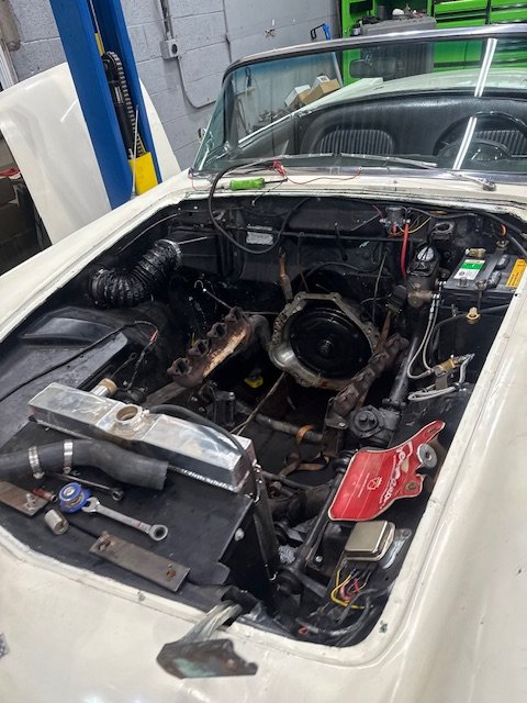

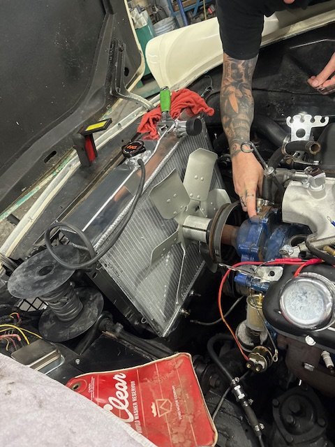

    up date, angry bird getting the aluminum manifold, electronic ignition, 4 core rad. and speedway fan... should be done today... my sons doing the'
    work...
    I think I post already about the disc brakes on front... if not thats done also

    also, the rad. is a 69 mustang, couple incjhes wider that the stock bird... 180 stat to start... needs to run 190 degrees constant...

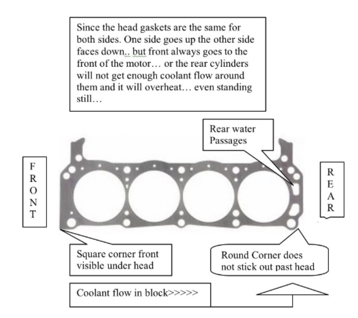

    Dumb*** me once ***embled a SBF without paying attention to the " front" marking on the head gaskets and got one backwards. Instant overheat.

    thanks for the post, checked that on both sides and they were correct..

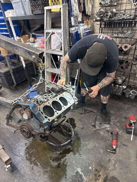

    up date... heads off..... horrible motor...water jackets plugged with gook mud... ( we ran block cleaner so it was probley loosening it up) #3 piston looks like someone dropped a carb nut ... and it probley took out the valves on that hole so they replaced the head... bore is 40 over...only four of the pistons match... the other four have smaller dish and larger valve relief cuts...so wonder what the balance was like...so I got a 302 ADK long block coming.. 4 yr parts and labor warranty...it's susposed to have 30 more hp.... not needed but the price and warranty is great...

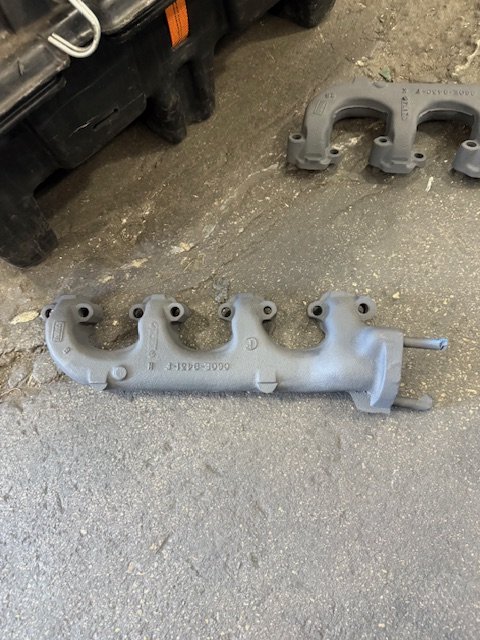

    in this pic you can see the heater delete... the long hose going from the manifold to the water pump... and the short by p*** hose going to the pump...could this be causing a problem??? seems like the cool water is going right to the stat... and maybe causing the stat not to open????

    as you caan see in this pic... they blocked off the heater hose port ,.. in the summer when hot out, there's a valve that blocks tis off, and only open to run the heater...
