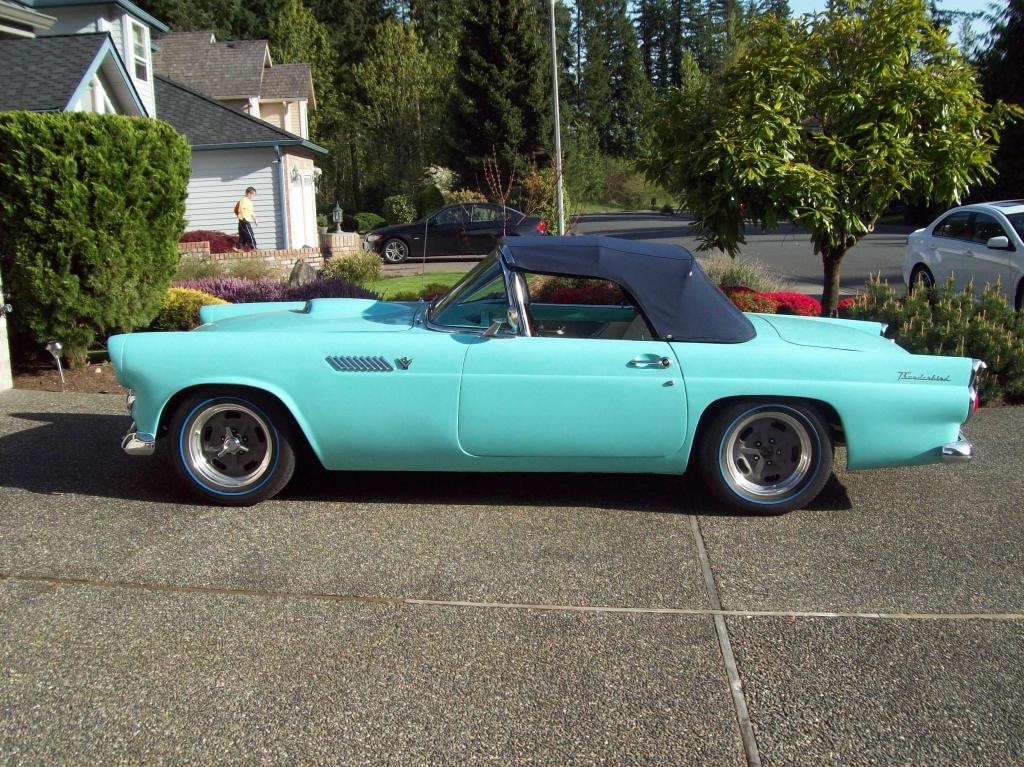

    It's setting in first primer now...gotta get the 58 finish while it shrinks
    also wanna see if I can get salt flat wheels to fit....wheels are staying if I have swap rear ends..
  17. miker98038
    Joined: Jan 24, 2011
    Posts: 1,579
    miker98038
    15x7 front, 3 1/2” backspace 225/60 15. 15x7 rear, 4 1/2” backspace. 235/60 15’zs. Really tight. Measure yours first, carefully. I had to move the rear over 1/4” in back to center it. Tight on upper front ball joint in front. No skirts. American Salt Flats
    ALLDONE likes this.
  18. ALLDONE
    Joined: May 16, 2023
    Posts: 3,809
    ALLDONE
    thanks for the post.... I'm gonna have to take a tire off and see what would fit...I need to move the rear 1/4 also
