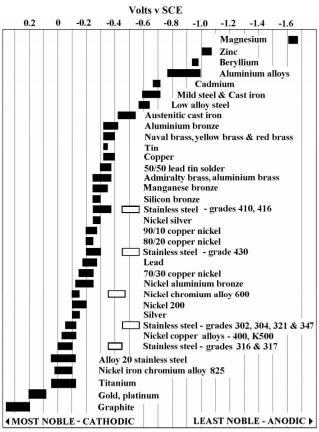

  1. On an engine with a cast iron block and heads with an aluminum intake and br*** radiator should some type of anode be used in the radiator to protect the intake? If so, where do you get them? I guess it would need to be connected to ground and not just hanging around in the top radiator tank. How would that done?

    Magnesium anodes are best. I use chunks of RV water heater anodes from Amazon.com. https://www.amazon.com/dp/B07RCB3M1P/?tag=atomicindus08-20
    You are correct in ***umig that the anode has to be connected to something. I generally solder a short lead to the center rivet in the radiator cap that completes the circuit to the radiator and thence to the rest of the engine
    The galvanic table shows why thiis is.
    For a more detailed explanation, see this : https://www.fordbarn.com/forum/showthread.php?p=2041005&highlight=weak+battery#post2041005

    Just make sure it's Magnesium. Some alloys of zinc have the same galvanic potential as aluminum and will provide little or no protection. No matter what the alloy, Magnesium is better than zinc..
