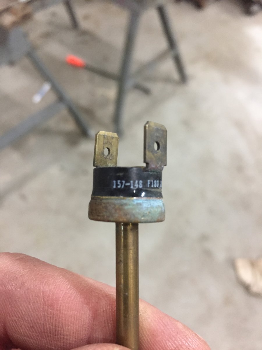

  1. 987B35AD-D6E5-4EE0-8189-BE1ED17DA54C.jpeg 95CA9B4D-C2FC-4351-8F5F-D04EB8F2B756.jpeg 537A25D2-B138-42E3-8721-65E09D9103FA.jpeg Another trinket in my **** pile

  2. Sure looks like a temp probe , or switch. For what?, No idea

  4. sevenhills1952
    Joined: Mar 14, 2018
    Posts: 956
    sevenhills1952
    Does the shaft push, pull, turn?
    Some are scored like that so they can be cut to that length. Check it with an ohm meter, let us know what it measures. It looks like standard 1/4" spade terminals.

    A search on the number doesn't show anything. I'm going to say non automotive an maybe a temp probe.

    My mind is certain it's a thermal switch. It appears to go in a dry well so it can be changed without draining fluid from the system. Grooves are likely to be for some sort of retainer. Probably not automotive, more likely HVAC.

    Temp probe for electric fan control .Goes in radiator fins.

    I bet it is a temperature control. It looks like those are temp ratings on the body. I would put a continuity tester between the connections and see if they open or close at those temp settings.

  26. Thanks for the replies Gents I’m sure it’s from one of the several elect. Fans I’ve removed over the years
