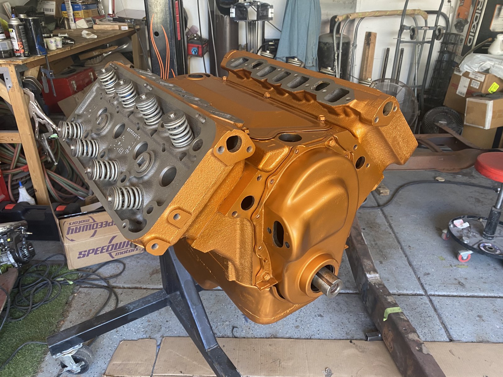

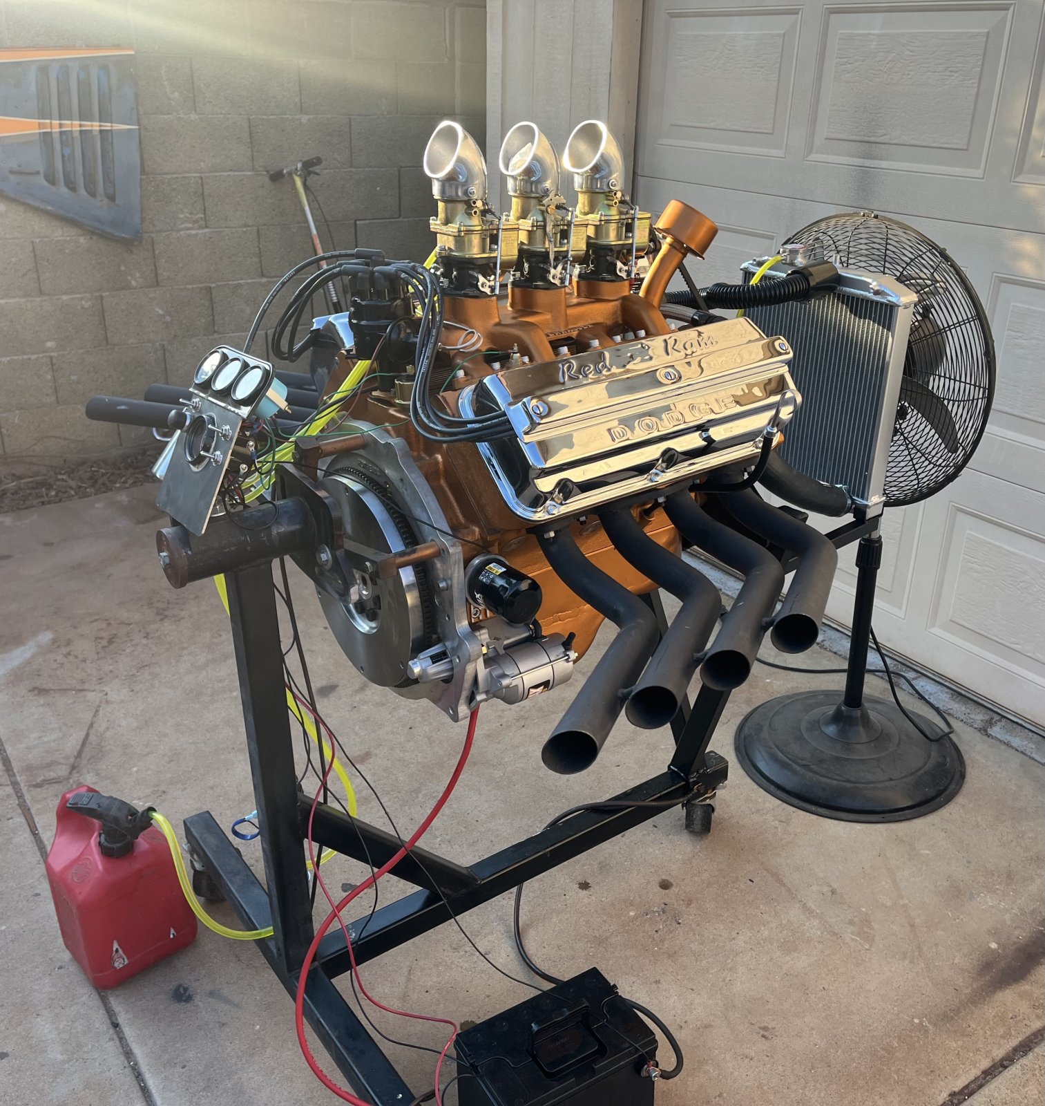

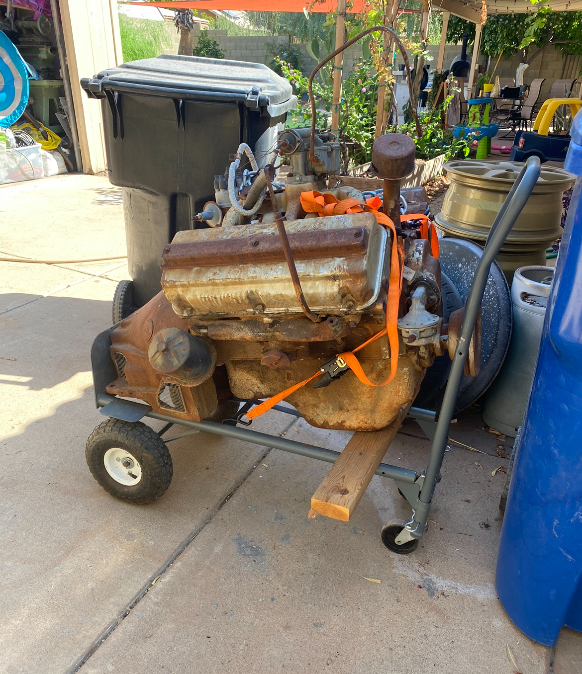

    I can’t really put into words the feeling of building your first hemi (or any motor for that matter) and the stress building up to that initial start up, and the incredible sense of relief when the motor runs for the first time. First run wasn’t too exciting to share the video, timing was off, had to keep the idle up to pump oil everywhere, but Day #2 is when I got that legendary hemi thump. Here’s a couple pics of the process and the payoff, probably the first time this motor has run under its own power in 65+ years.

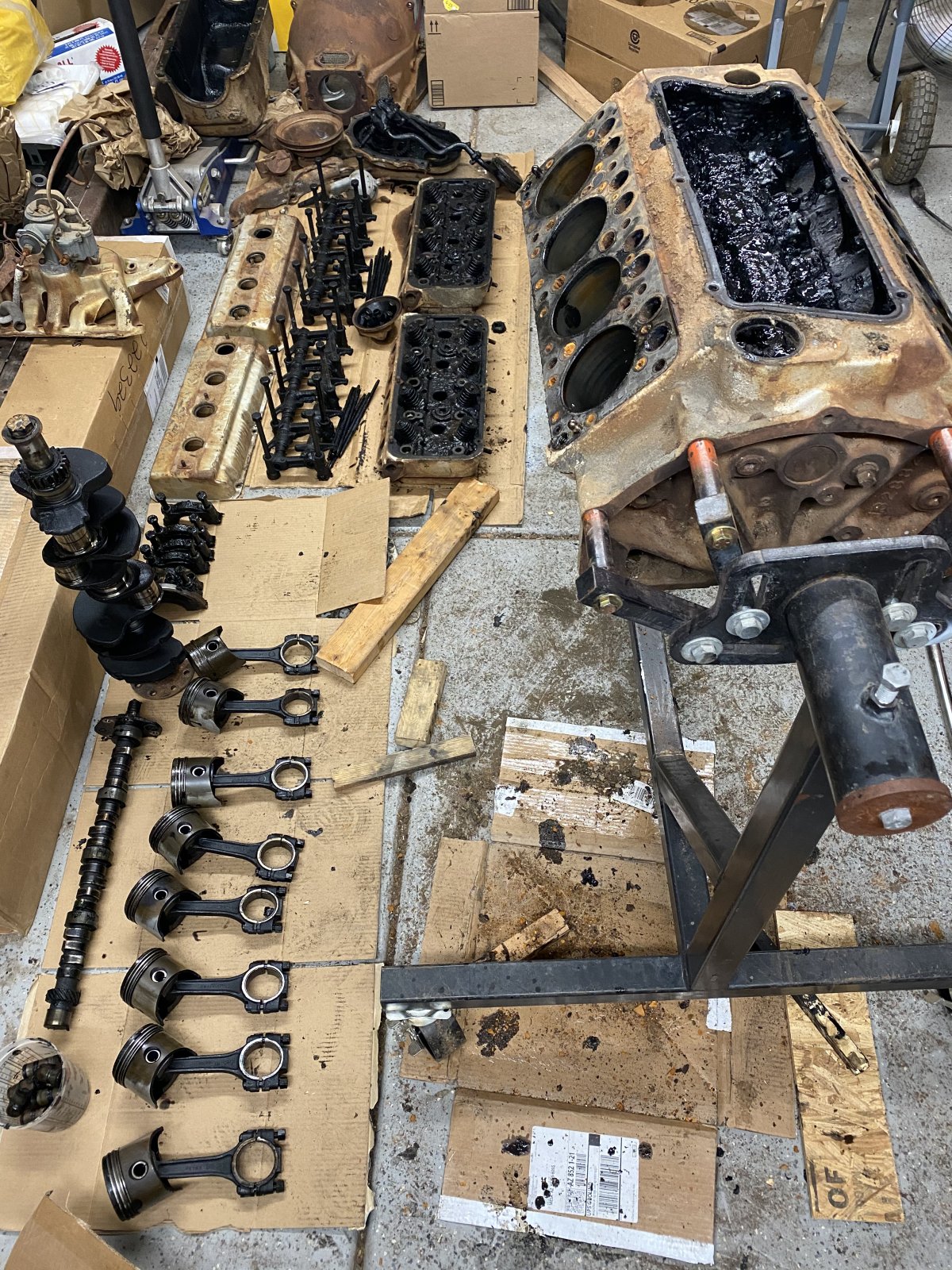

    2 long nights later, some nasty nasty stuff in there.

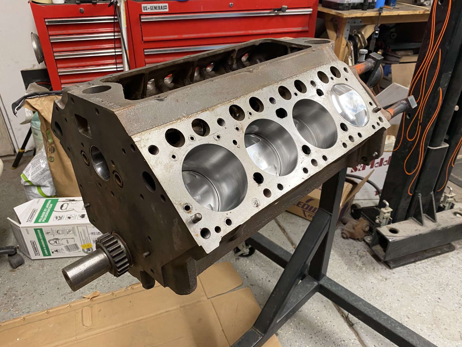

    freshly back from the machine shop with the Racetec pistons installed IMG_4267.jpeg

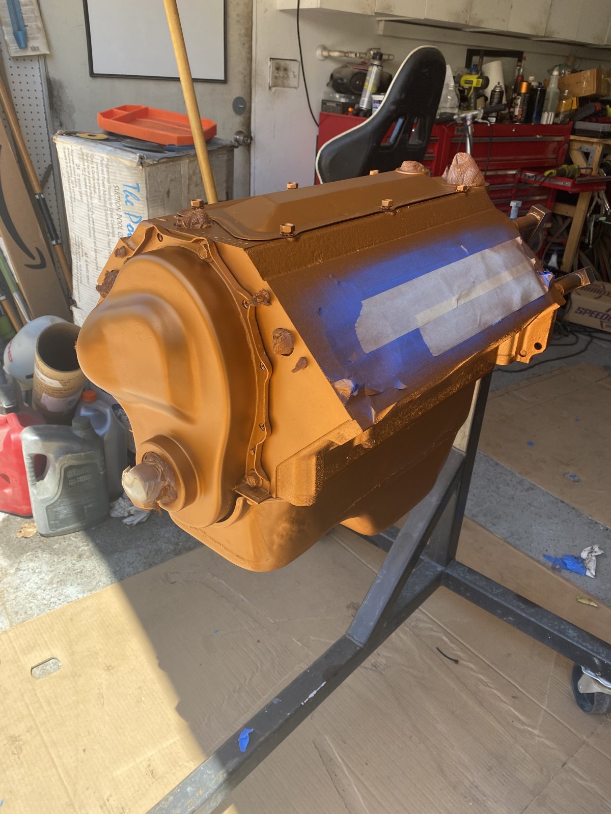

    A little VHT to keep the rust away
    Really love this color, burnt copper!

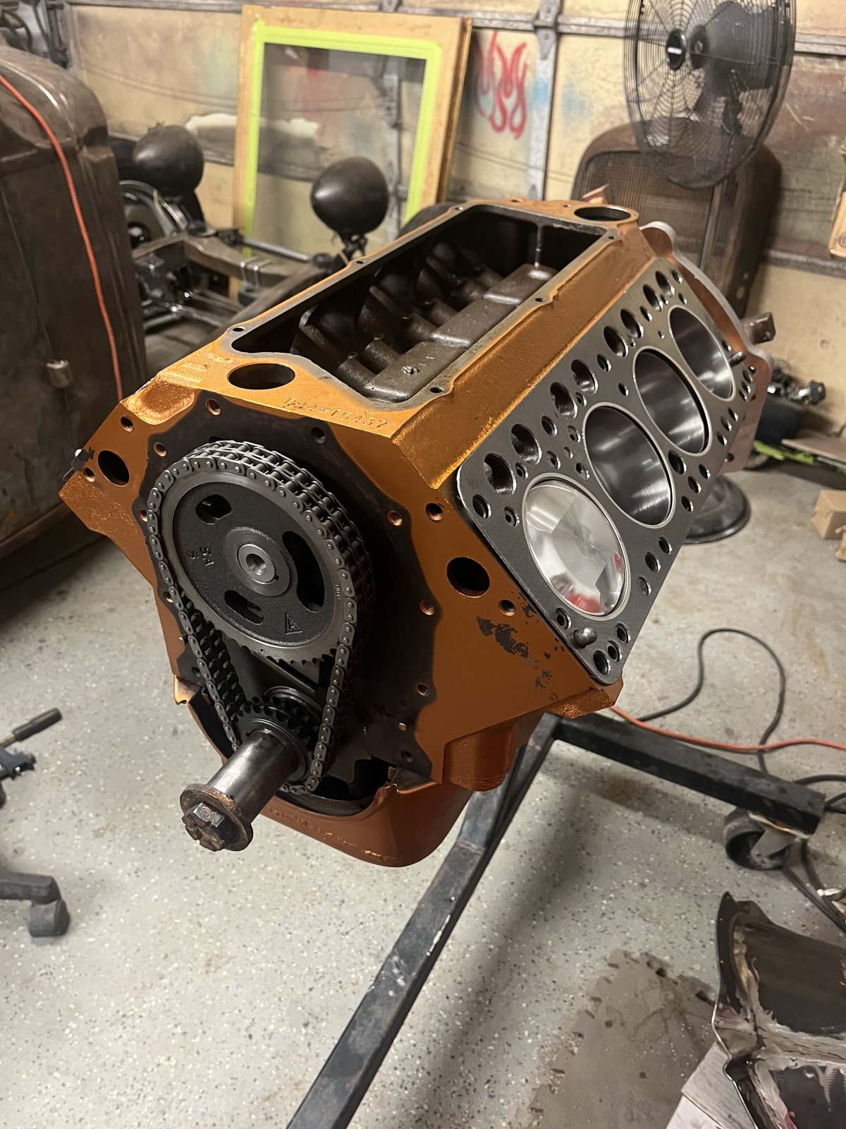

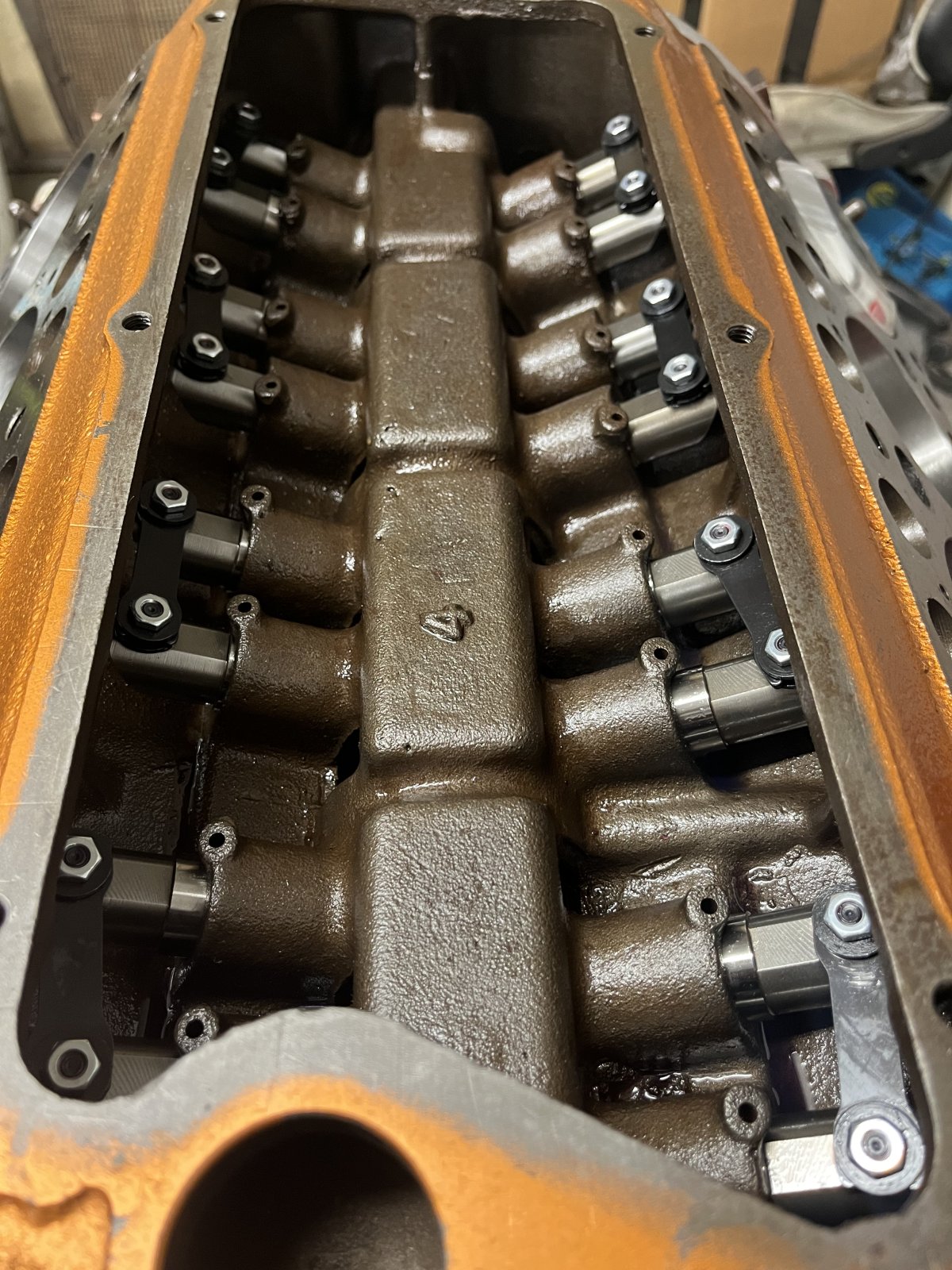

    Cam and timing gear installed, testing head gasket
    Hydraulic roller cam and lifters by Donnie Johansen of Howard Cams

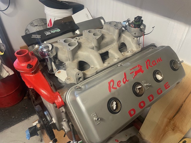

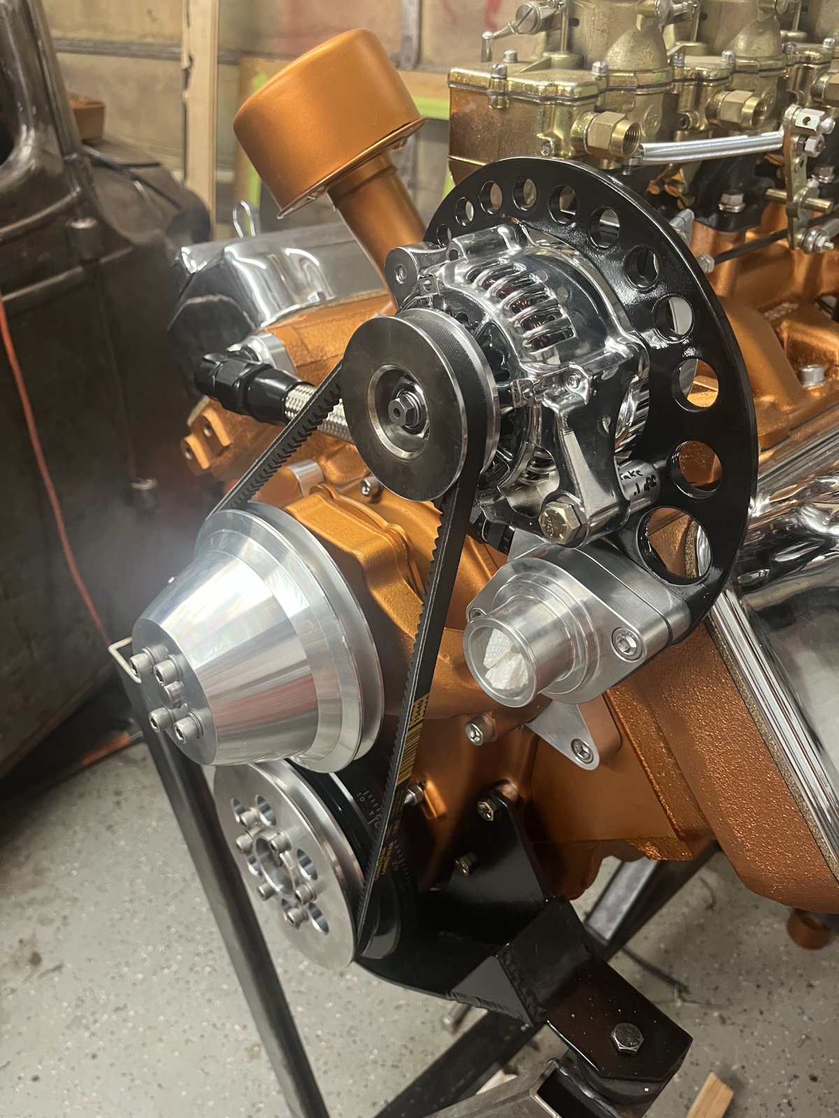

    Made a little alternator bracket to mimic the placement of the original generator
    start up ready Sept 2024
    And the running video! Enjoy
    https://youtube.com/shorts/7uuDz3mrhjw?si=XdBidPMvLtX8Z29Q

    Looks great and sound great as well!
    That alternator mount is a clever set up too.

    Thanks! I got a portion of the parts from an old friend, Ken-Jack from Hemis unlimited, he helped me with my pistons (RaceTec), cam, lifters, timing gear, harmonic balancer, oil pump, and pretty much everything else came from Hot Heads or directly from the manufacturer.

    Congratulations! I've watched that video so many times I've lost count. I love the copper color, hypnotic sound and whole build. I will PM you as I have a few questions as I ready to install my 241 in my '34 Ford roadster. I noticed you installed the SBC waterpump and I'm curious about the overall clearance it provided?

    Are you running a solid cam?
  30. chicken
    Joined: Aug 15, 2004
    Posts: 728
    chicken
    from Kansas
    In an earlier post he said it's a hyd roller from Howard's.
