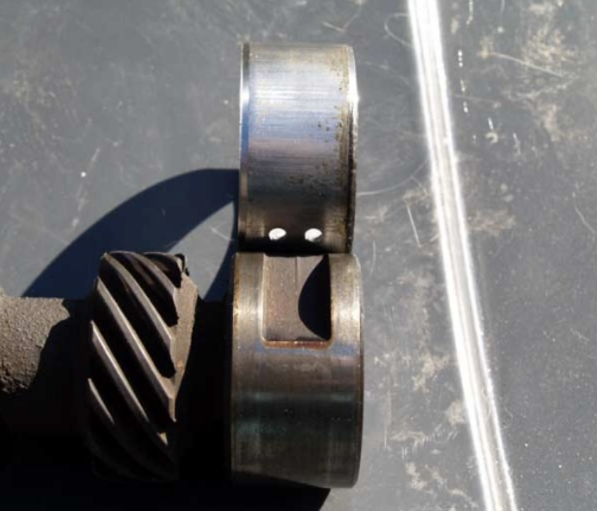

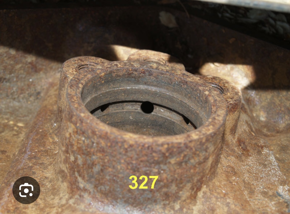

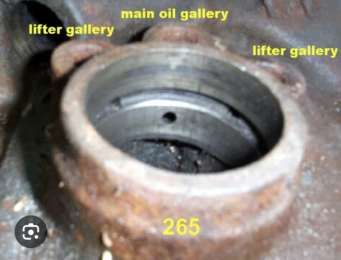

    Your engine could either be a 57 265 or a 57 283 [Chevy used the same casting number on both.]
    But the good news is it has full flow oiling to the lifter galleries.
    pull the distributor and make sure you have a 57 or newer dist.
    If you have a 55-56 dist it could be clocked wrong
    On early distributors the groove at the bottom [red] is not 360° and could partially block the R/H gallery if clocked wrong.
    This photo explains the clocking issue
    Deuces, Deutscher, 61Cruiser and 2 others like this.

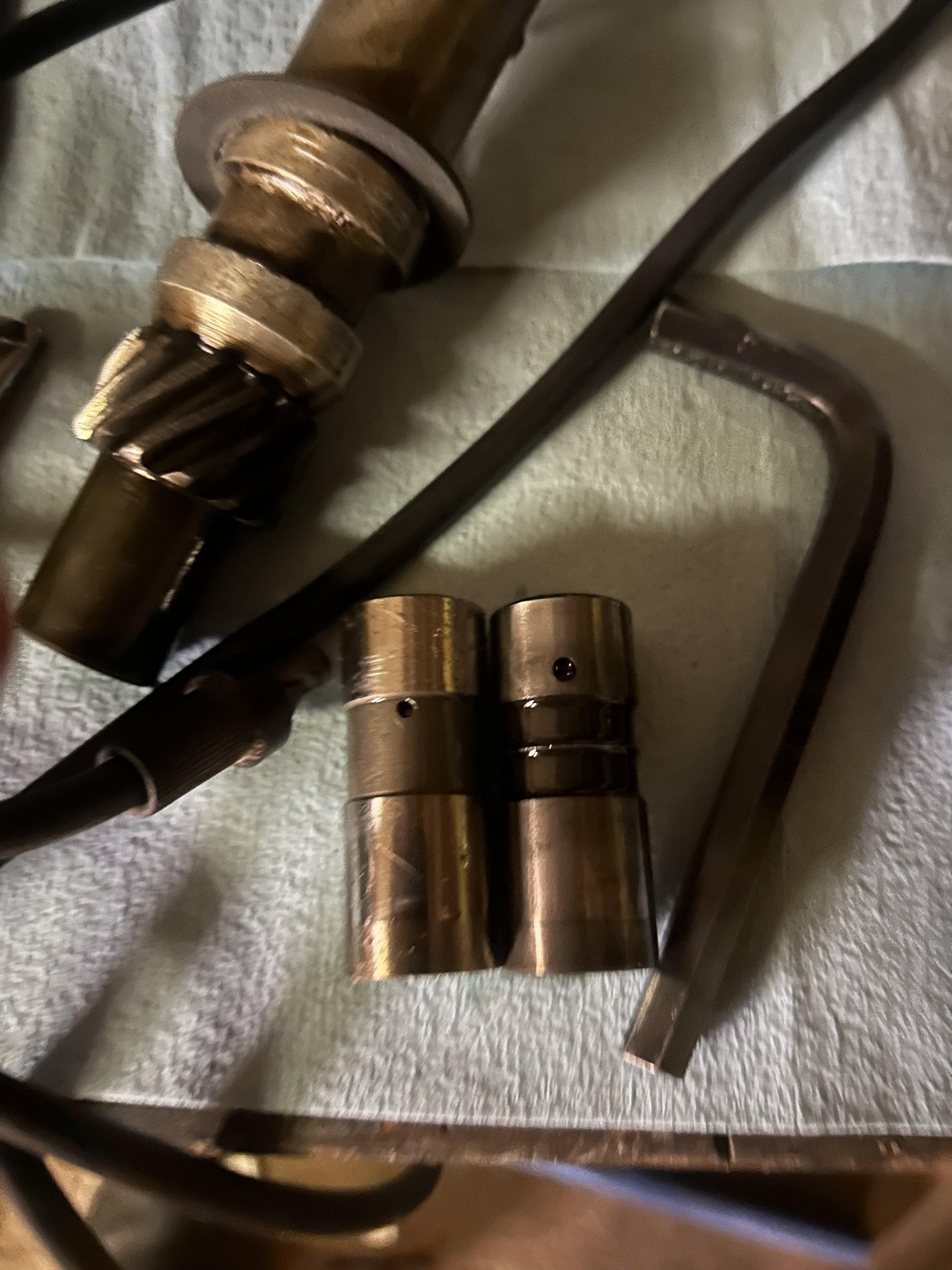

  19. fatty mcguire
    Joined: Dec 5, 2004
    Posts: 1,241
    fatty mcguire
    FFCD69C2-2AF2-4550-AF07-5B8F6360744E.jpeg The one on the right is the one I took out

  21. Kerrynzl
    Joined: Jun 20, 2010
    Posts: 3,602
    Kerrynzl
    You have the correct distributor [it can be clocked 360°]
    Those are edge orifice flat tappet lifters, Change them and your problems will go away.
    Chevy went to constant flow/ pressure ,but metered the flow at the top when the pushrod lined up with the hole in the rocker. [which is why we use restrictors with roller rockers]
