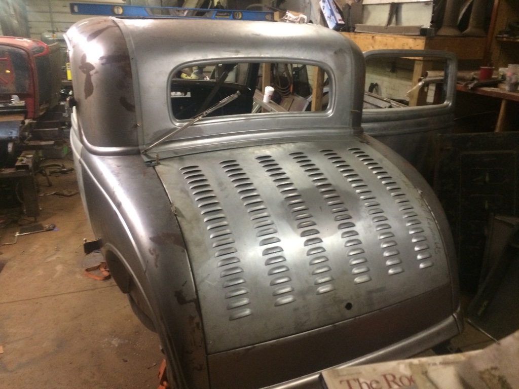

    follow along on ***embling a brookville 32 3 window and then chop it .
    fitting hinges

    First time fitting the trunk lid
    Quarter and panel under decklid both have a break that needs cut off
    After welding comes filing
    And finish

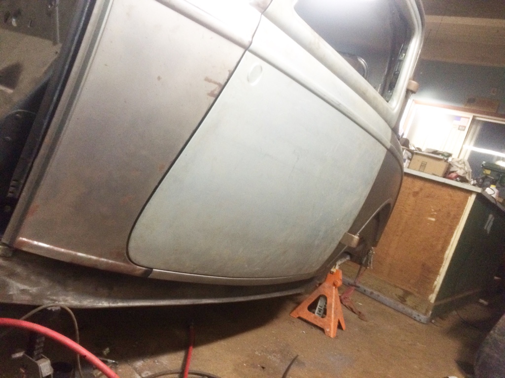

    Trim the center
    Weld time

    All the major welding of the body is done .
    Roof hole
    A pillar bracing and wood in
