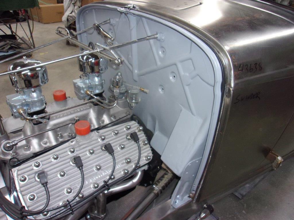

    Can't help myself, should have quit with the last one. My last Cornhusker ch***is, Flathead from Frames, Brookville body. To much of a good thing. I'll have a complete PDF listing everything included with prices soon. Krylon32

    Thats a Unique water pump ,
    That is ,Like 50 Flat Head ,
    Just wondering , Does it feed / balance both sides evenly Temp wise , I guess it would if running thermostats @ top of heads , probably answer my question.
    Just asking , what will make this one more diffrent then your other
    Black Henry roadster for sale ,
    I see more laidback windshield.
    Different Engine ,Trains
  8. Taboo56Chevy
    Joined: May 21, 2018
    Posts: 2,106
    Taboo56Chevy
    That's a 348/409 W Chevy water pump. I would recognize it anywhere from years of playing with those engines.

    Your correct about the 409 pump kit, been making them for about 30 years. Several differences from the black car, 4 most obvious the black car is an original body, Motor is a 300 hp SBC, and the black car features a real Auburn dash, and the windshield is a 3 inch chopped stock style vs a Wanless laid back unit. I have no idea about the glare factor. Eddy, when you have time join my thread with a few pictures of your current build for comparison.

    is that a "Y" where the fuel lines go to the pump,... also will you be putting a panhard bar on the rear???

    ALLDONE: The fuel system is custom made for me by Baxter Ford Parts in Lawrence KS. Everyone he's done for me is a little different and they've all worked great.I've done countless 100's of buggy spring with ladder bar rear suspensions thru my years in the ch***is business and have never needed a rear panard. You simply need to do your math and have the rear shackles end up at a 45 degree angle when loaded. As for the final finish it will not be painted or finish upholstered. I plan to attempt to sell it naked for the buyer to finish. A complete PDF listing base prices with all extras will available when we're done.

    continentaljohn: The water pump is 409 Chevy. The mount shown is a custom mount my machinist made just before he retired. I have been offering the complete 348/409 to Flathead Ford pump kit since the mid 90's. You may be more familiar with the production kit as it uses the stock Ford style biscuit mounts and puts the motor in the stock frame mounts. Complete kit is currently $1095 plus the ride. You furnish the alternator and belt. I have 9 left and that will be the end.
