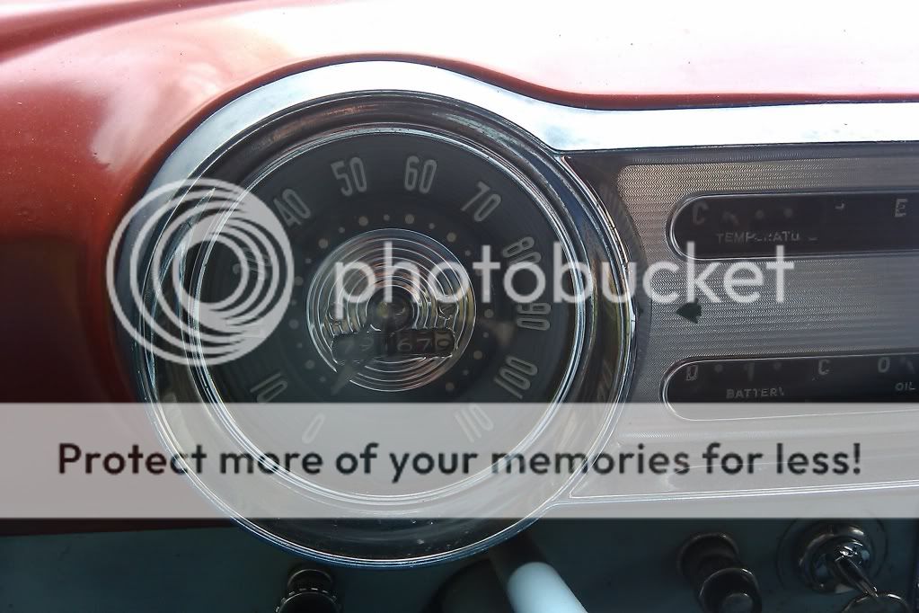

    Did someone do some work on your dash, radio and gauges? Those look awesome. Keep that stuff as original as possible. In the event you don't want any of it, let me know. I may.
    Nice car to start with. Keep us posted.
  11. Nice project. Keep us posted. Todd
  12. TerrorSwain
    Joined: May 1, 2011
    Posts: 217
    TerrorSwain
    Dead End - the guy I bought it from had all intentions of dropping an LT1 in the car. He found another all set up for it, so he just got this one running and sold it to me. He bought it from someone in Oregon. So maybe they cleaned the gauges up. Everything works but the radio. Thanks for the kind words guys. I will get more pics up as I go along!

    I bought a non-working radio. I plan to do something to have it control my ipod volume thru amp and speakers. I want the old look with new sound. There are some radio build threads on here that I plan to put to work. Probably next winter. Big plans in my head. Hopefully actually get them done.

    I agree..clean looking dash! A new horn ring to replace the broken one and your looking perfect!

    Here are some closer pictures of the gauges for you guys.

    Looks like a darn good car! You have a really nice lookin radio an dash! It will look good slammed!
