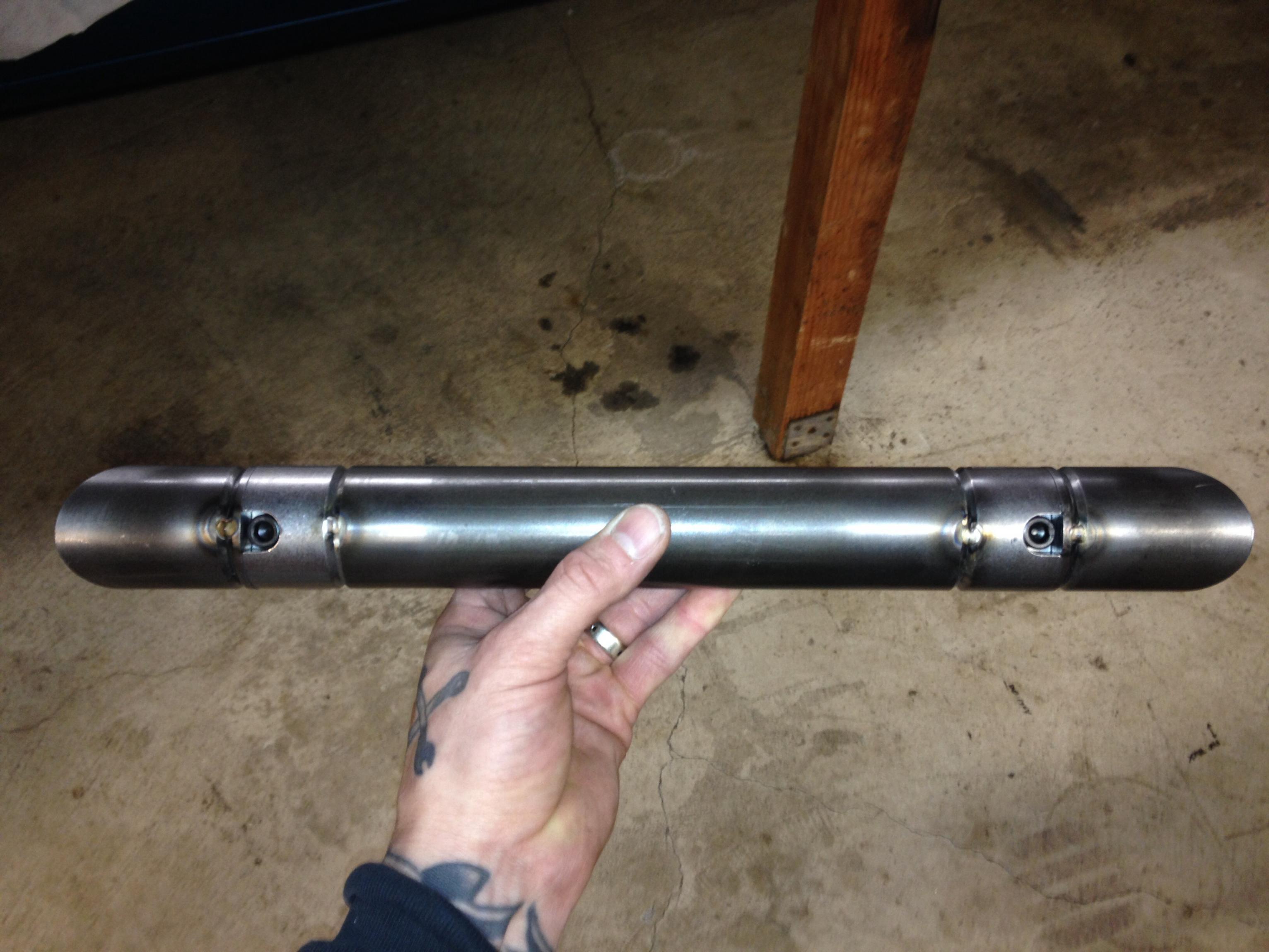

    Transmission mount 2/3 of the way done.
  13. LOW1954
    Joined: Nov 26, 2009
    Posts: 76
    LOW1954
    Still need to add the tab the will be welded to the center of the tube that will mount to the rubber mount of the th400 transmission.
  14. LOW1954
    Posts: 76
    LOW1954
    The middle tube is removable.
