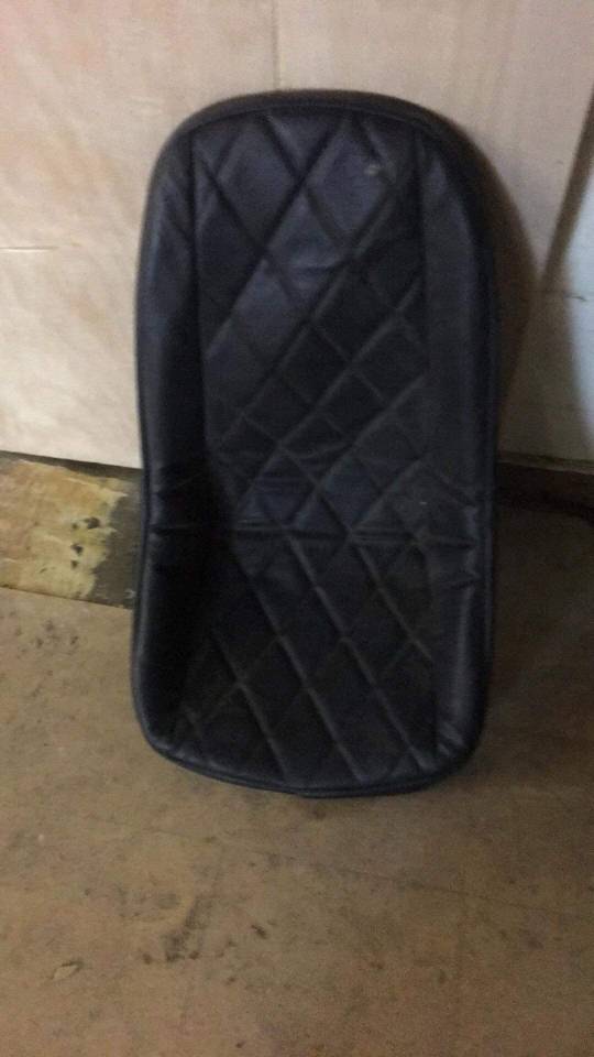

  5. 54hotrodder
    Joined: Nov 20, 2011
    Posts: 669
    54hotrodder

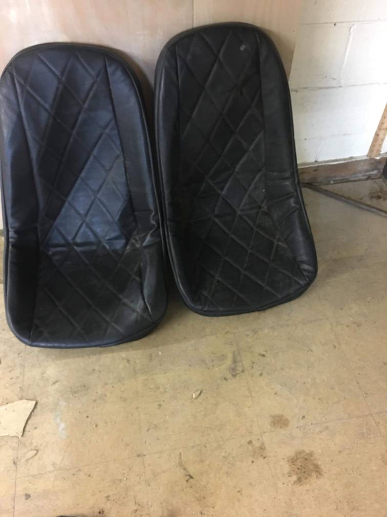

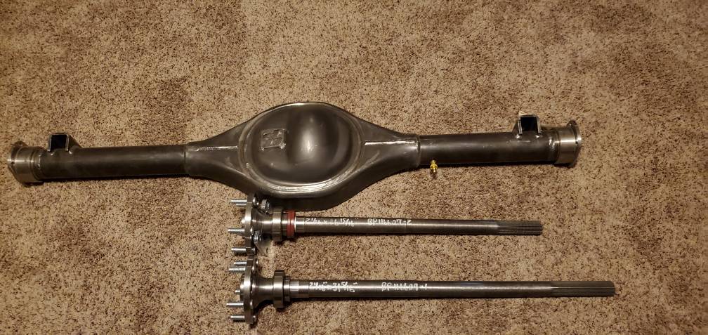

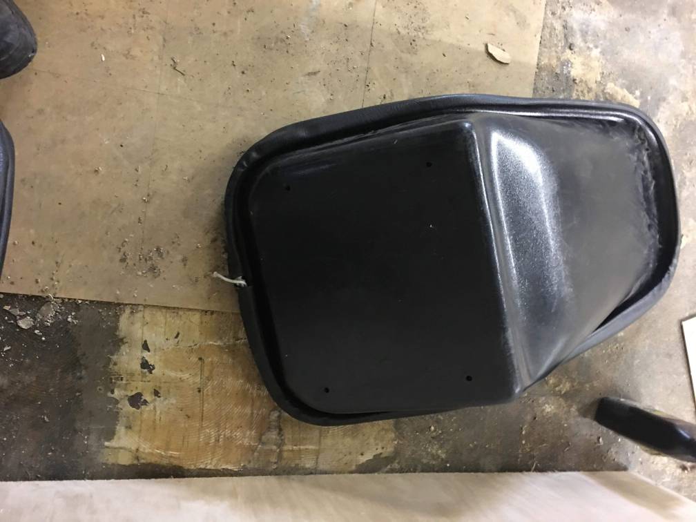

    No straight axels for me I just picked up up a set of buckets for it. And 4 olds 9.3 rear ends

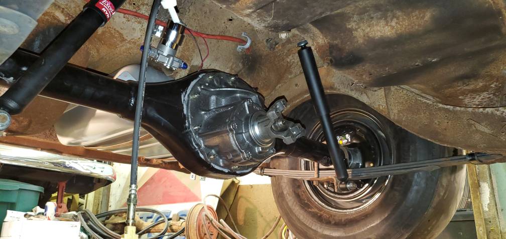

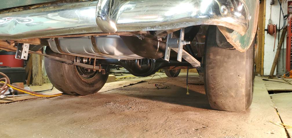

  7. 54hotrodder
    Posts: 669
    54hotrodder

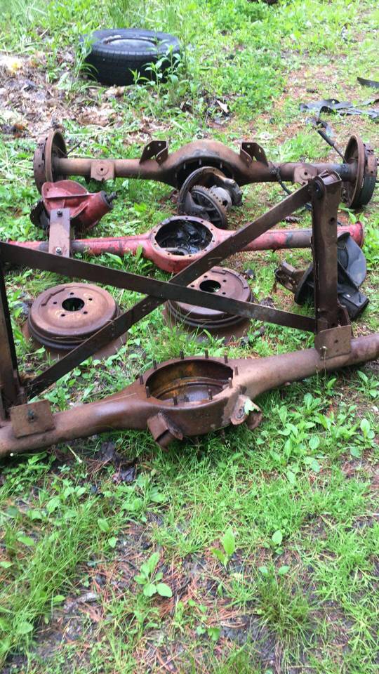

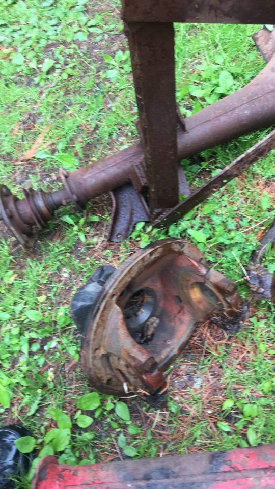

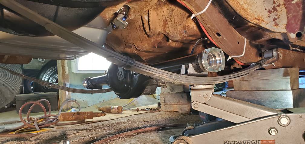

    Well while the 9.3s are on hold for a nice buildup. I dropped this Ford 9" "direct bolt in" in the old car.
    Has speedway leafs in it. It sits like a 4x4.
    And extended shackles the exact kind that was in the car. Same length and everything.
    My old springs pretty much where horizontal but these are like 6" k10 lift springs now. Even though they are "factory replacement"
    I'm gonna drill the shackles out all the way to a stock setting because I cant stand how high the *** of the car sits now... I hope they have settled down by the time I get back in townbur I doubt it. I was up north for memorial day weekend at our cabin... 20190523_162015.jpeg 20190522_233215.jpeg 20190523_170221.jpeg 20190523_181729.jpeg 20190523_190324.jpeg 20190523_190337.jpeg 20190523_231637.jpeg 20190523_231725.jpeg 20190523_231645.jpeg

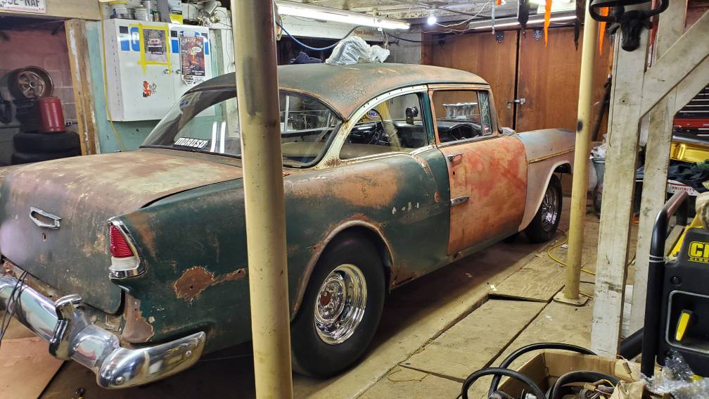

  11. rusty1
    Joined: Nov 25, 2004
    Posts: 13,474
    rusty1

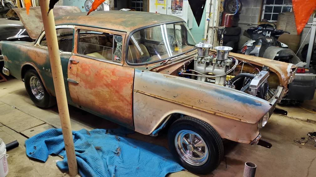

    ...just a thot, in the one pic you have 6x6 wood blocks under the frame,...you mite consider turning one set 90 degrees, or both sets 45 degrees,...I use the same blocks under cars and have had one roll backwards off those blocks if the front wheels are on the floor and not blocked well, ...when workin on the car those blocks can roll back and forth,..specially torquin down rear end u-bolts, etc,...just a safety thot,..I like yer Chevy a bunch...

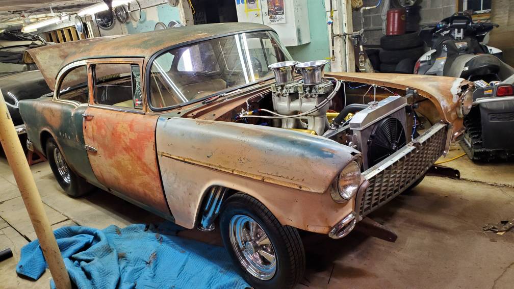

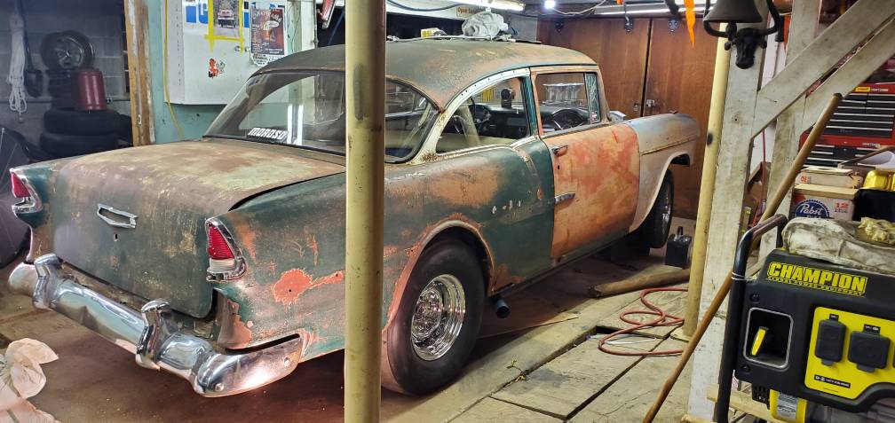

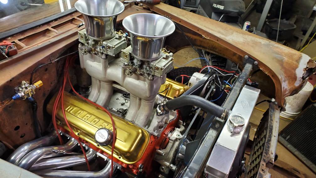

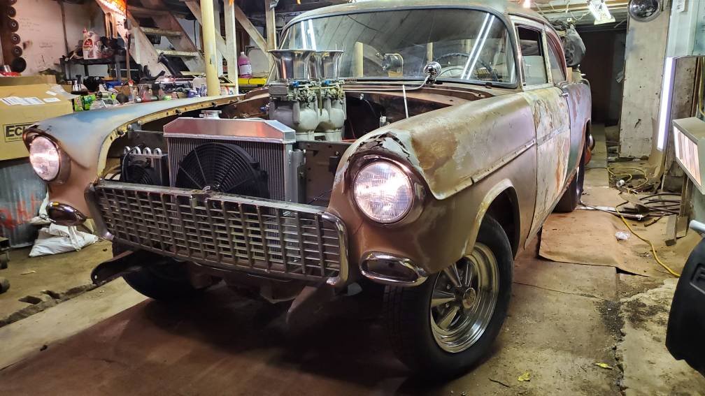

    I'm not very organized right now trying to ge this thing cranked out.... but heres a recent update.
    Lights all function along with signals.
    More wrapping up on the motor, and trans.
    Trans
    Gotta install the shifter cable and brackets.
    Get a driveshaft made up.
    ****** cooler lines.
    Fresh fluid.
    Motor
    Oil pressure line.
    Fuel line plumb
    Wire fans, and magneto to an kill switch.
    Pray for no leaks.
    Brakes need to blead hope to tackle that tomorrow.
    Mount the bucket seats.

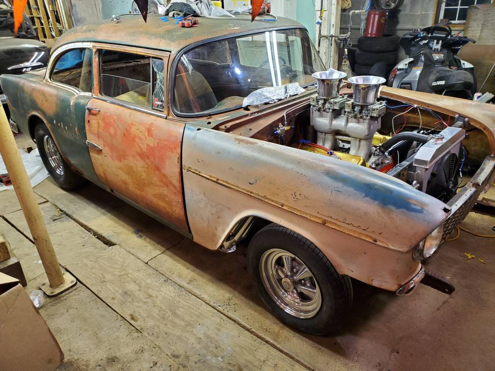

    Just messing around today waiting on some parts from summit and speedway! 20190529_232746.jpeg 20190529_232505.jpeg 20190529_232736.jpeg 20190529_230136.jpeg

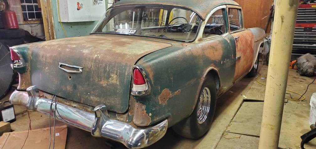

    I remember as a teen an old 55 2 dr post that was in an old garage, I took several parts off...man it was tough...the left front fender had the front foot of the top fender missing and they had tin wrapped around it wired on with coat hanger...last time I looked it was still sitting and rotting in there too.

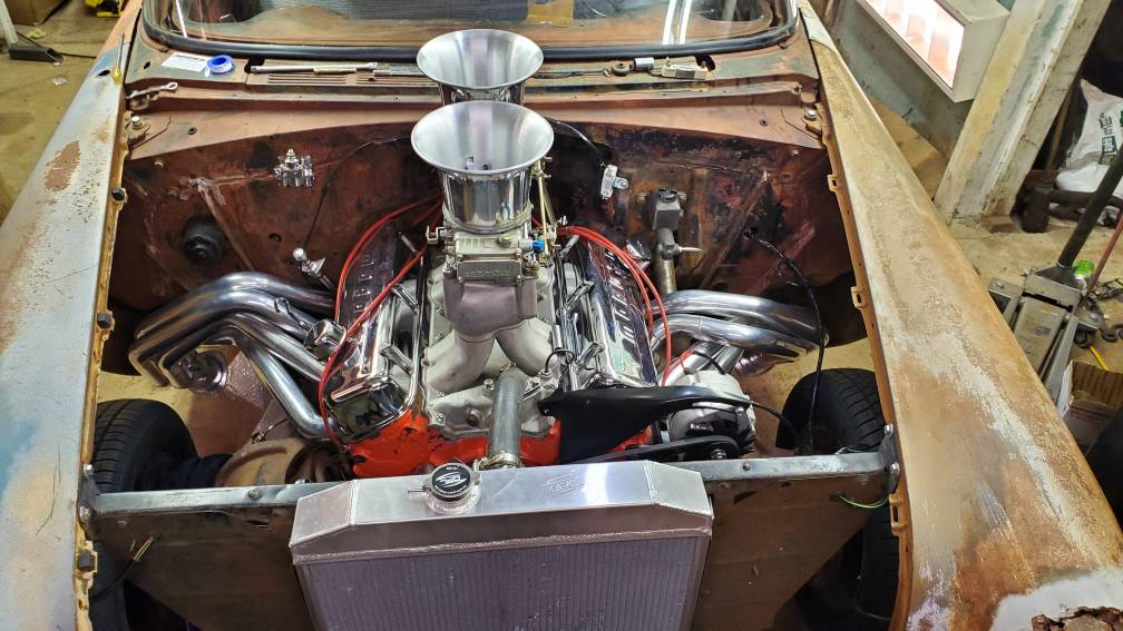

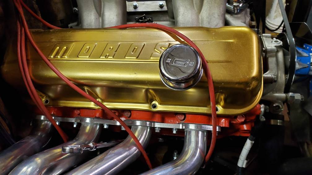

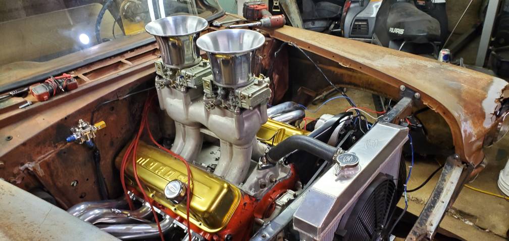

  18. I really like the gold Moroso valve covers! It really gives it a cool vibe.
  19. 41rodderz
    Joined: Sep 27, 2010
    Posts: 6,541
    41rodderz
    from Oregon
    I was never was big on gold valve covers but they really pop against the engine paint and the plug wires. Lighting helps as well. We need to call you Speedy Gonzales:cool:.
    loudbang and 54hotrodder like this.

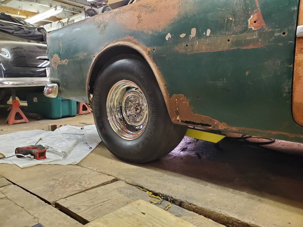

    Nothing like an old ball bean hammer some vise grips and a sawsalll cant cover.
    Was definitely a home grown job back in the day.

    I'm not huge on the gokd covers either but I think it gives it the van Nuys boulevard street sweeper look.

    If you plan on racing the car, the firewall mounted regulator won't p*** tech
