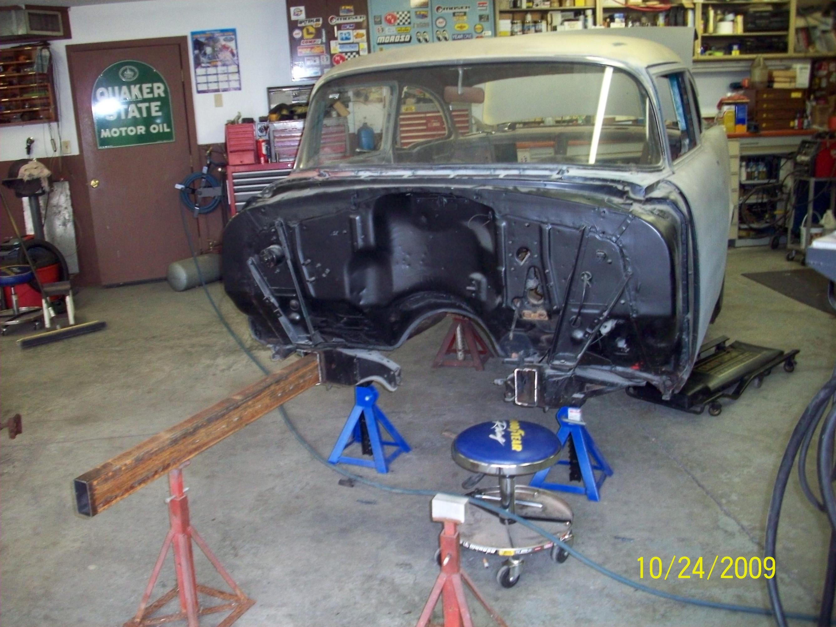

another 56 chevy build Iam thinking a gasser

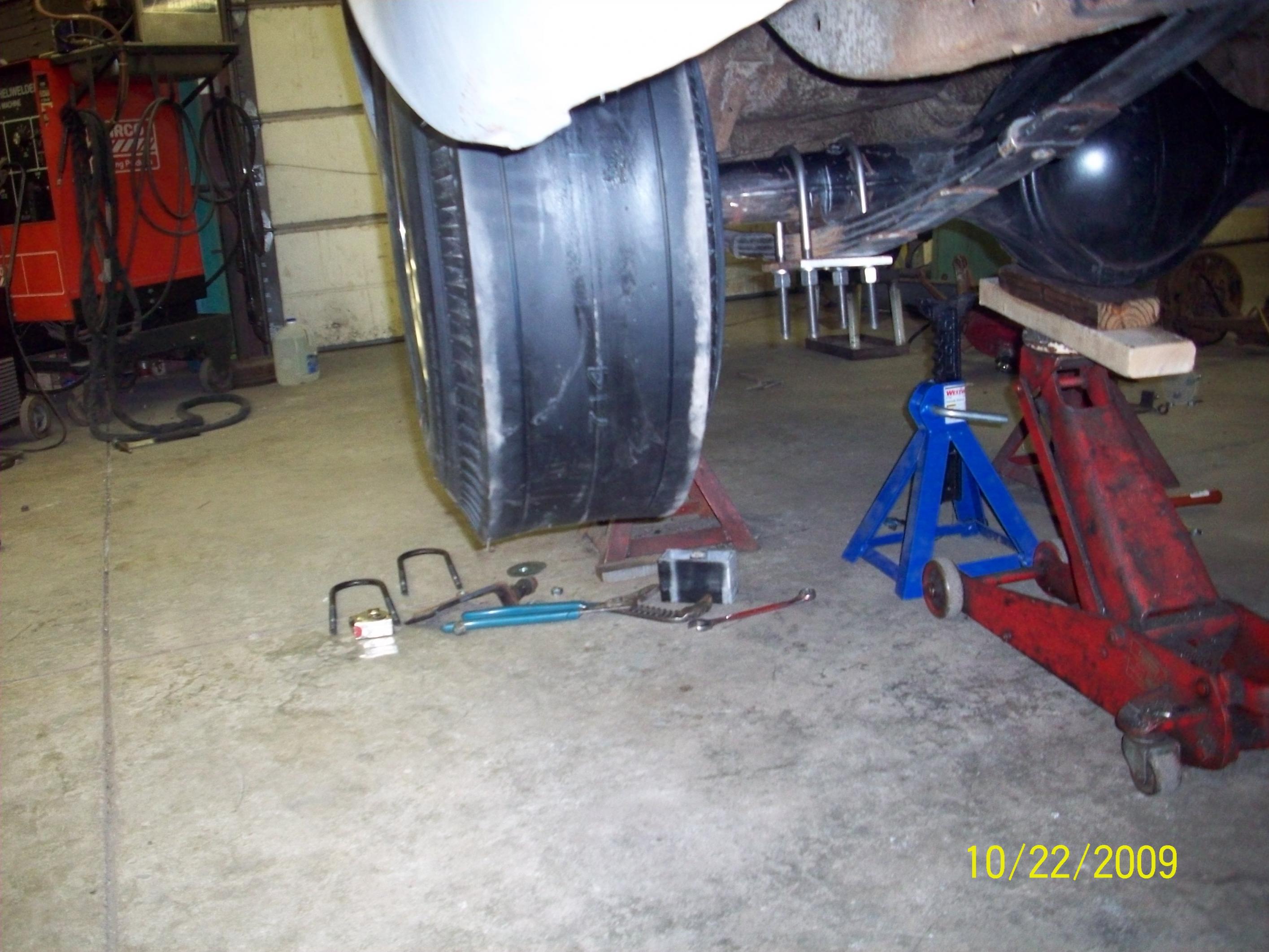

    got my slicks today should I mount whitewall in or out?
  8. 6t5frlane
    Joined: Dec 8, 2004
    Posts: 2,403
    6t5frlane
    from New York
  9. spinn427
    Joined: Jul 5, 2007
    Posts: 77
    spinn427
    from indiana
    I vote in! Are those 10" inch americans on the back? I had a set of 10"s With 3" And 3/4" back space on my old 55 I has in the mid 90's, I put the springs inboard, centered the gas tank and put 2 inch blocks on the back. Has 275/60 tire. I put a 57 ford nine inch rear in it. It was real low for then. I sold it A long time ago. Have a 56 2-door post project waiting for some metal work and straight axle.
  10. J&JHotrods
    Joined: Oct 22, 2008
    Posts: 549
    J&JHotrods
    X2. black wall out. JM.02. Looks like a real clean car. What's the history on it?

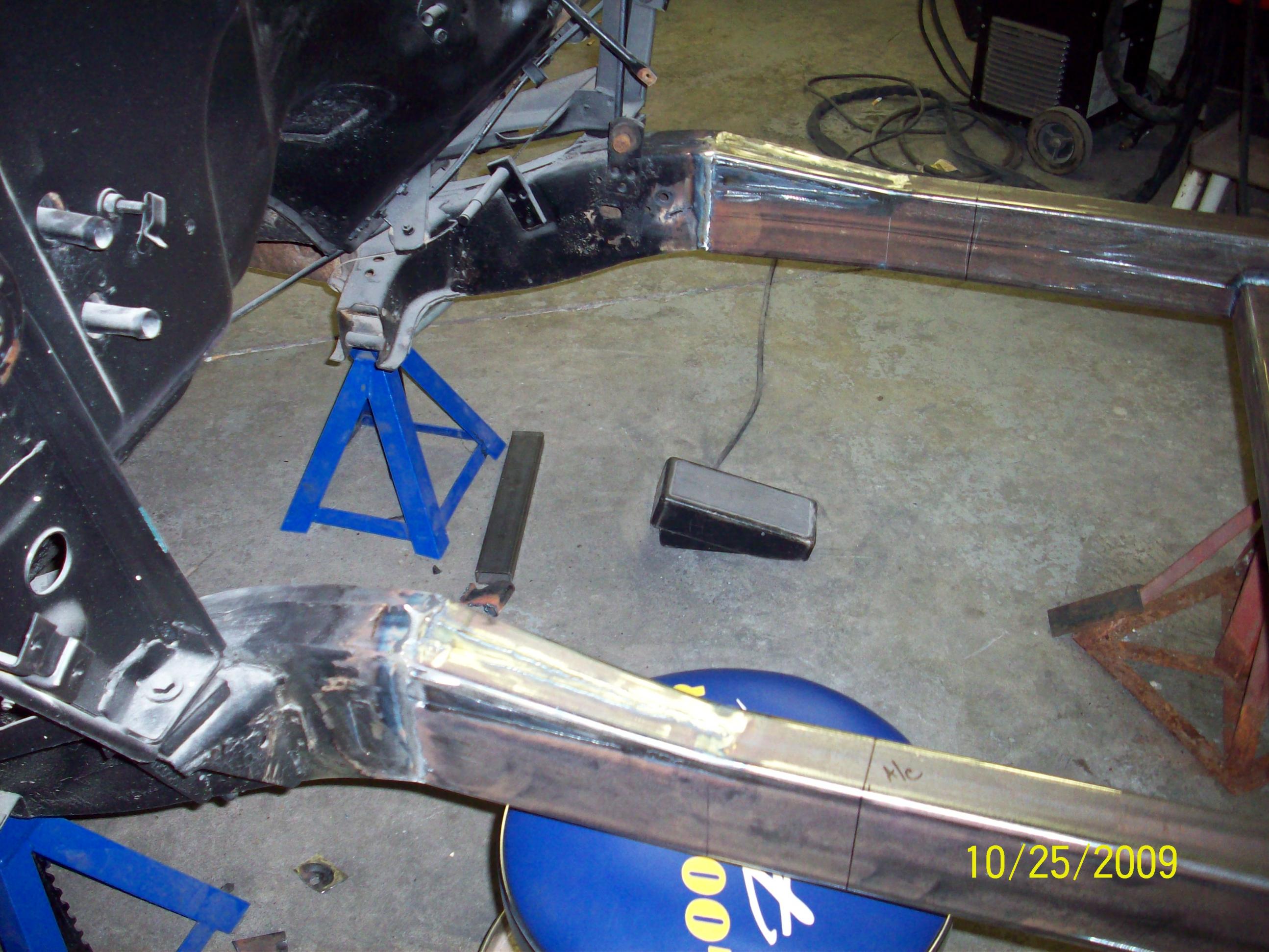

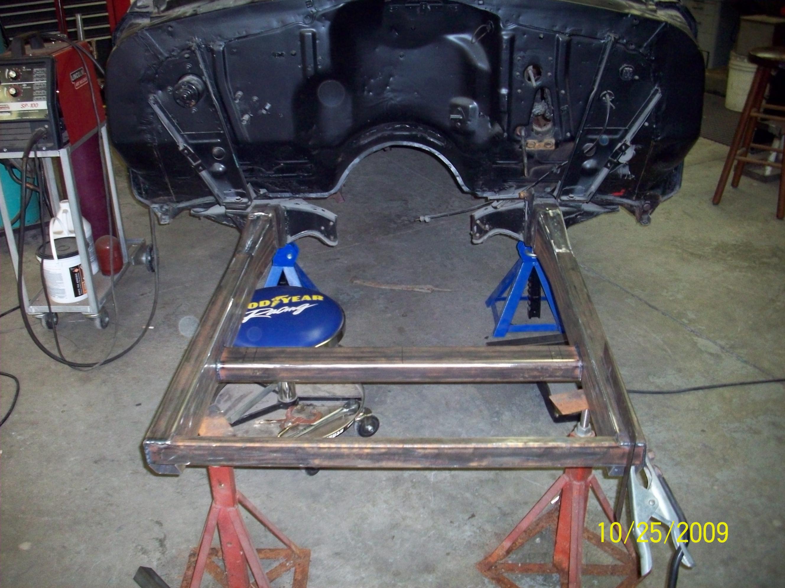

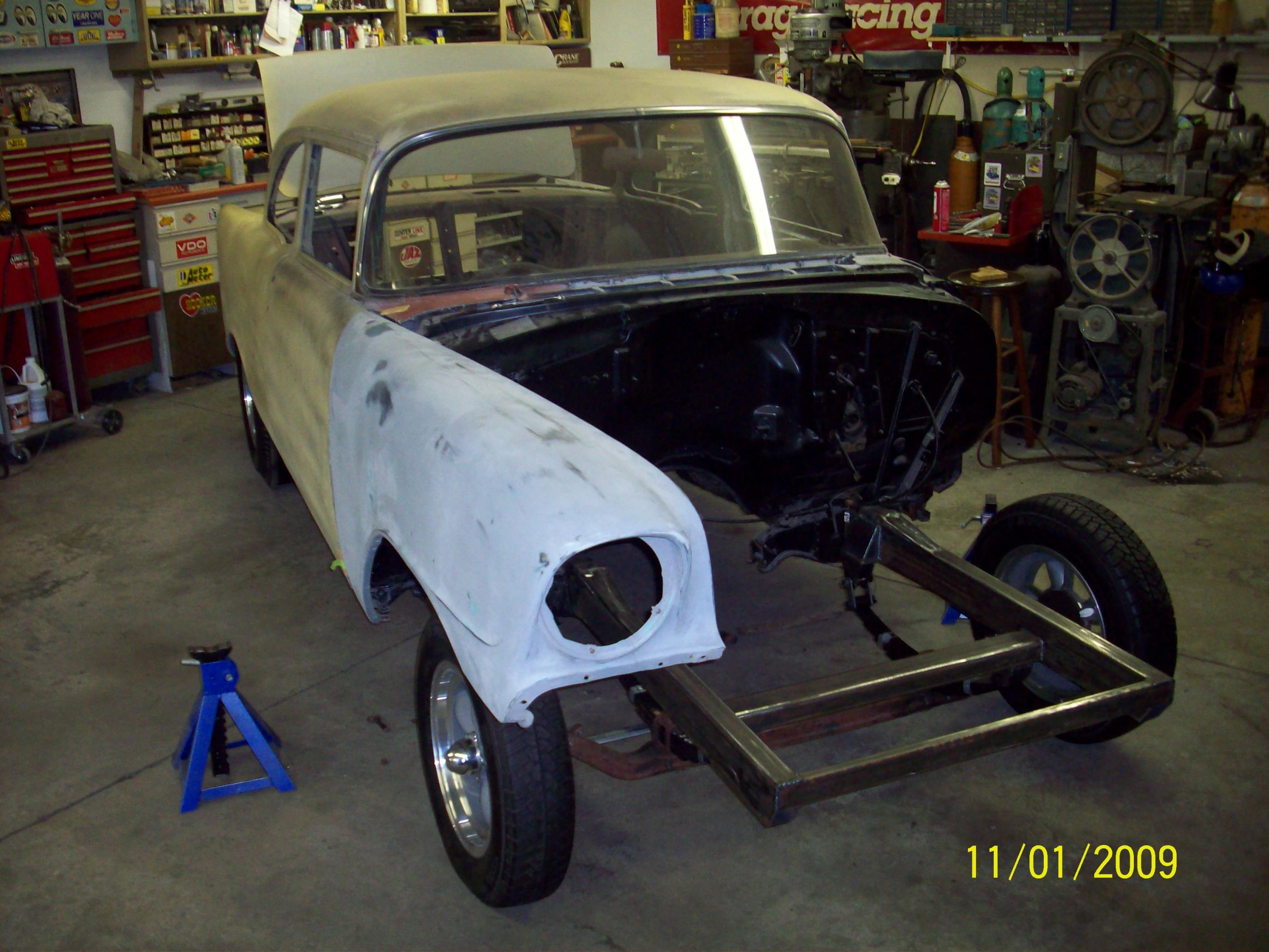

    we got a little more done......
  15. Butch M
    Joined: Oct 14, 2008
    Posts: 1,667
    Butch M
    getting closer

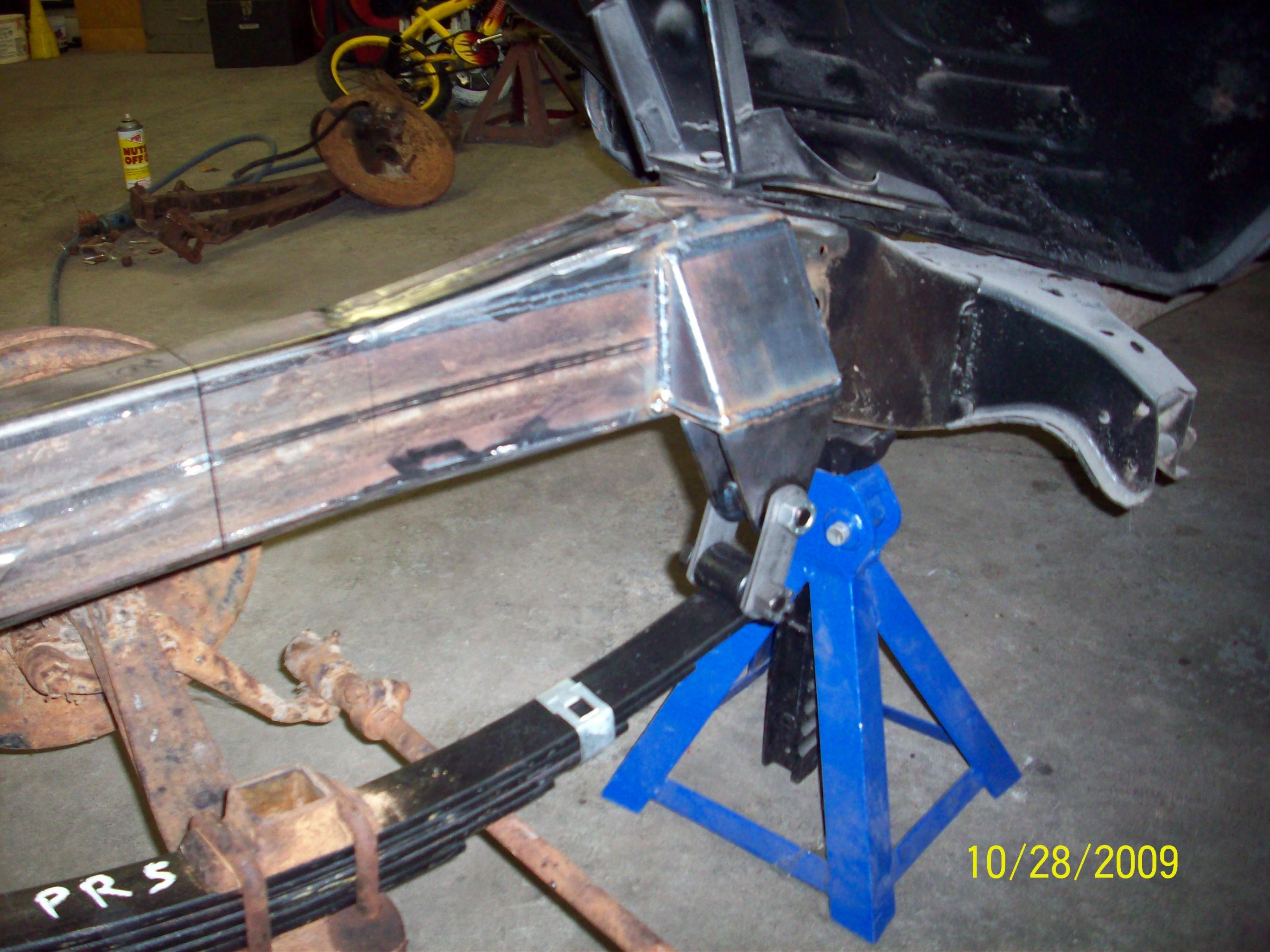

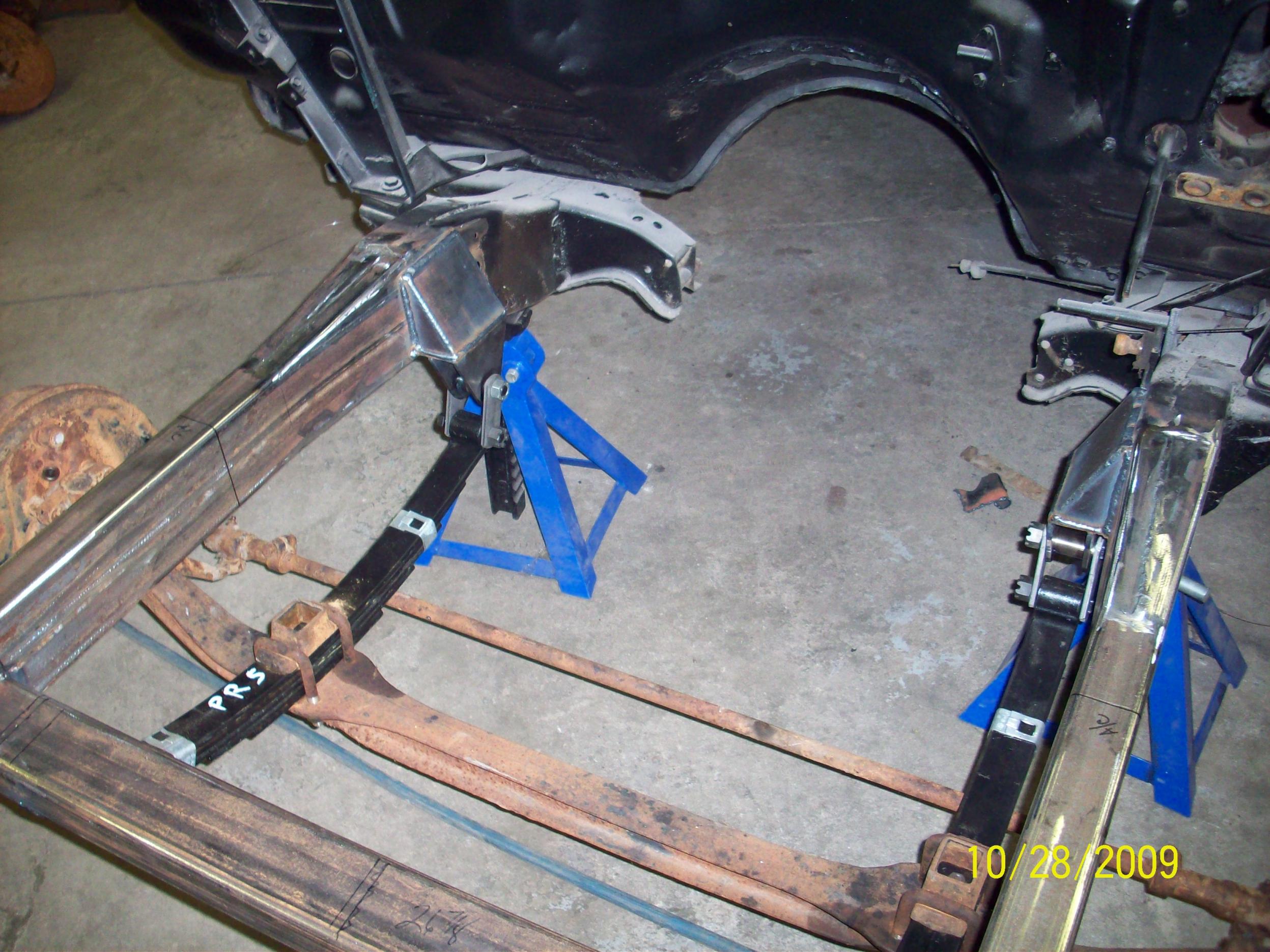

  23. Butch M
    Posts: 1,667
    Butch M
    we got the axle in......ol'e Griz has been welding his **** off. I better give him a day off

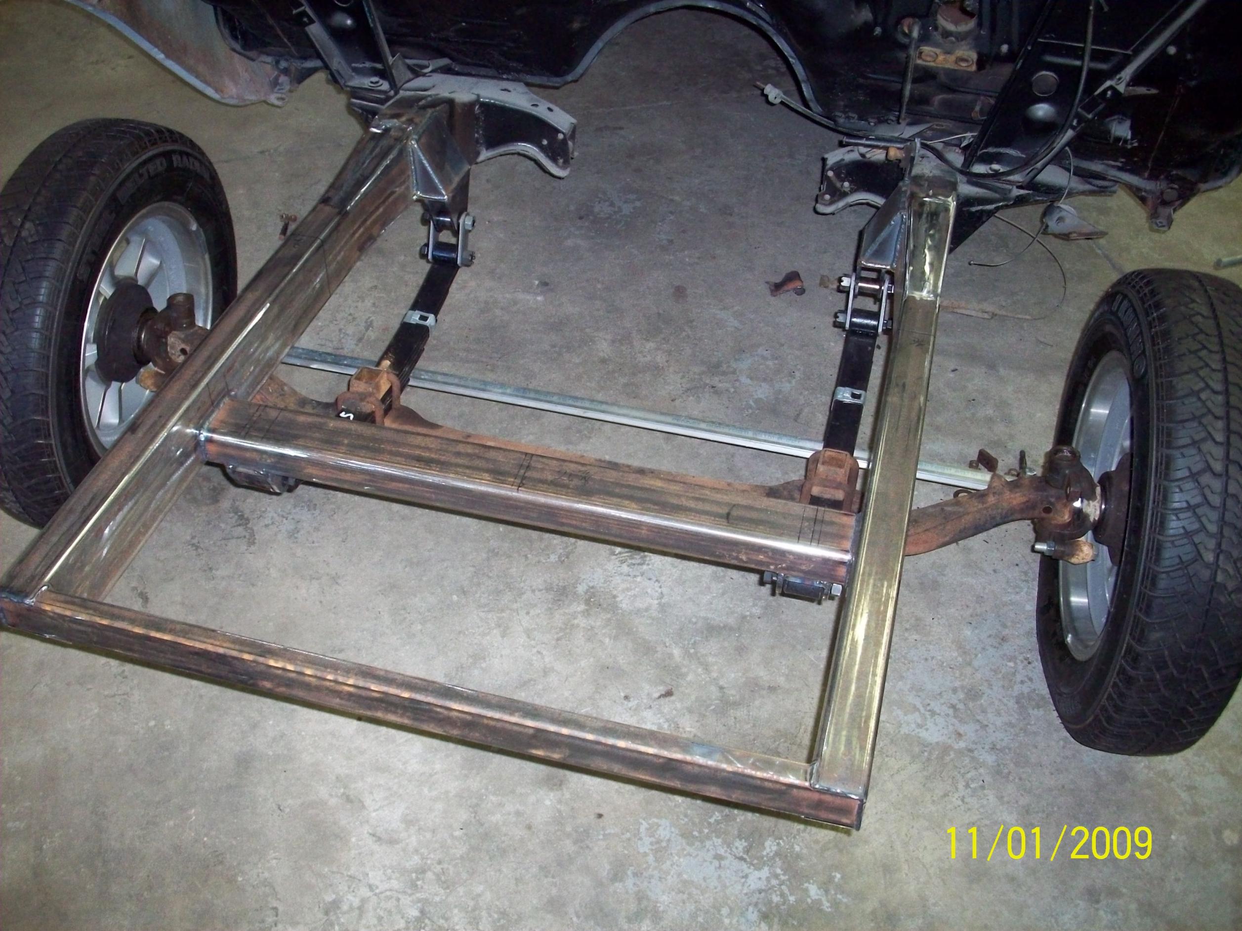

  25. Butch M
    Posts: 1,667
    Butch M
    NOW what do I do disc brakes or drum ?
  26. Butch M
    Posts: 1,667
    Butch M
    we set her on the ground.Ole Griz been givin them red beers hell....

  28. falfas55
    Joined: Apr 21, 2004
    Posts: 288
    falfas55
    Butch, the slicks look good. I would put disc on the front for your own safety. You never know when the local idiot will pull out on you. Keep up the good work. FALFA
