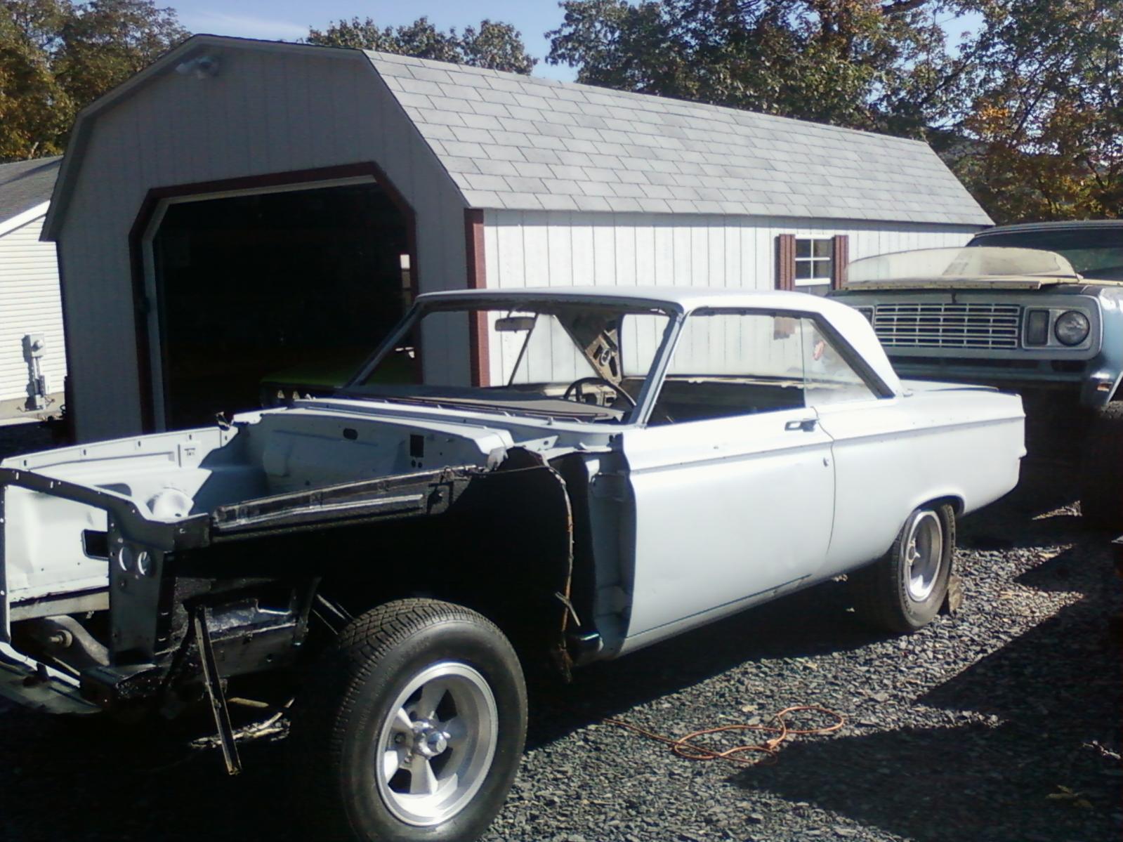

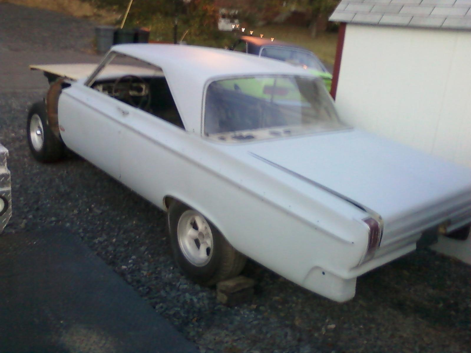

    I picked up this 65 Coronet 2 dr H/T back in October to begin an altered wheelbase car.
    After a couple weeks of sanding, grinding, and stripping undercoating and seam sealer, the cutting began.
    I have the technical bulletin from Chrysler in 1964 and am trying to do most of the things the same way they did.
    Original cars were built with a 15" relocation at the rear wheels and a 10" relocation at the front.
    I opted to move the rear section forward 19" without sacrificing cutting the door pillar area, and I plan on using an A-100 van front straight axle at 10" forward.
    Enclosed are a few pics as I have tried to document everything from the beginning to whenever it ends
  2. looks good so far why the 19 inches

  8. The difference between the dodge and ply is one inch. How the sheet metal is I don't know but the wb is one inch. I think the al vanderwoude car had a few extra inches. I have driven several awb cars and the extra offset will be noticeable when driven. It's all about weight distribution not a look.

    Does the Factory Bulletin state anything about the rear to front weight percentages they were trying to attain? More wasn't necessarily better if thry had to ballist the front end to keep the front down on leaving the line.

    The 64's had a 4in. wheelbase difference not the 65's they are only 1in. as RacerX stated.I think 19in. on the hardtop will look ungainly and awkward,but hay it's your car.Your not narrowing the A100 axle are you and you'll need shorter springs to get the 10in your after.
  13. use the stock width axle. not only does it look right its safer. i would never use the stock springs. they are long wide and heavy. use trailer springs of the right length. get them as wide as the frame. use mopar perf offset shackles with a tube welded through the frame for the rear mounts. front mounts can be fabbed from boxed tubing with one side cut off. set the caster to 5-7 degrees and go run it. it concerns me you are going to street drive this car. the mods were done for racing. let me give you a senario. you are in the left turn lane and the arrow comes on. you give it some gas then hit a bump or pot hole. the front end will come up. you now cant steer.race tracks are smooth the same cant be said about a public road. towing back to the pits it was a normal deal to have the front end bouncing around like a pogo stick. i was booked in to atco one day and did a tune up on the original virginian awb. it was raining out and we wanted to just put around. i pulled out from the tent and stood the bitch up in the rain. its on video some where. and what goes up must come down. on the street if you need to bring it down quickly due to some unexpected bump you will break all kinds of things. with the extra rear end movement you may need to hang weight up front just to get it down the street. race cars are on the gas all the time you are not constantly shifting weight back and forth. i have been wittness to or involved in broken shock mounts,bent axles,torn and bent motor mounts,dented oil pans and one bent frame. you are going to put yourself and anyone around you in real danger just to provide some silly antics. these cars are not street toys. a word to the wise should be sufficient. there is a place for these cars and its on the track. and lastly these cars achieved legendary status because they had killer engines in them. to put some pussy motor in it just ruins the whole idea of a awb car. go play with a prius if you dont want power and want to street drive.

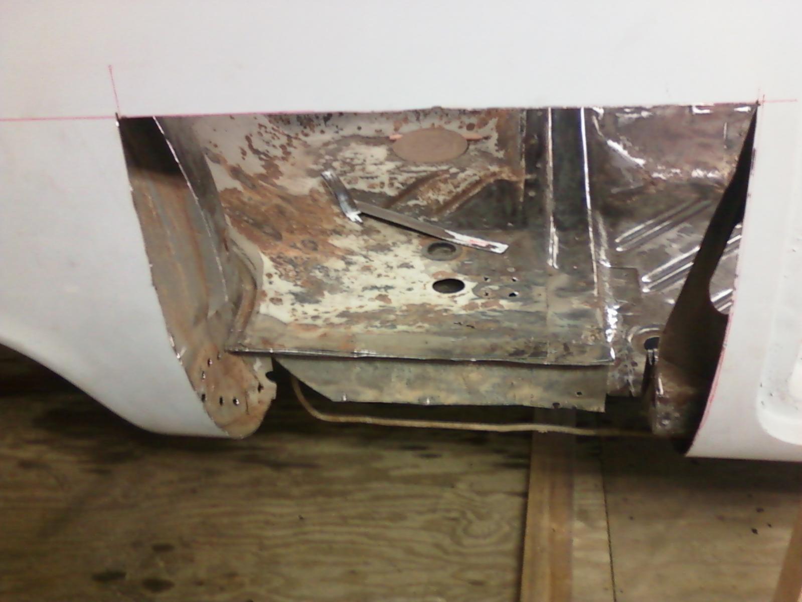

    question,why did you cut up the trunk floor like that?
