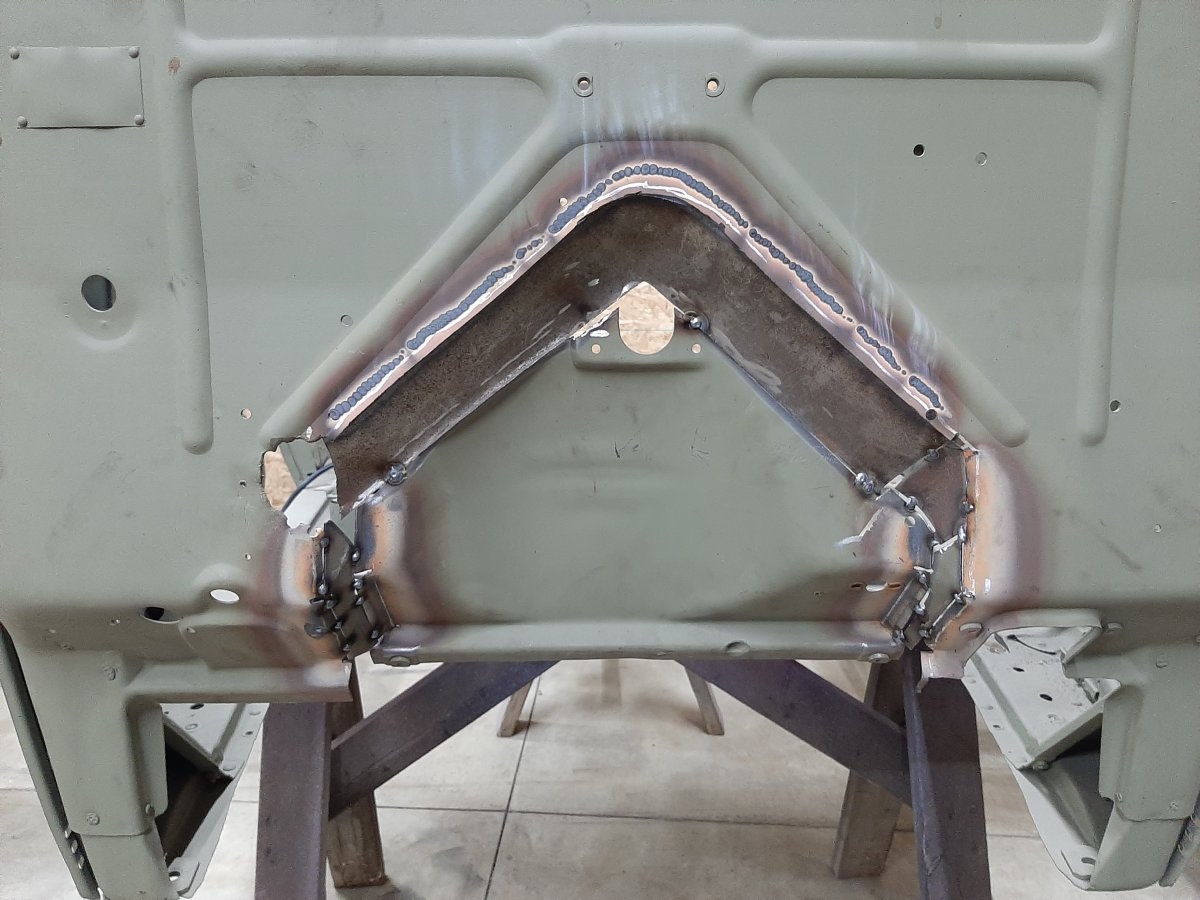

    This is where we left off for today, we used a floorboard panel we had laying around for our setback pieces, it's hard to tell in the pic but we bent the original firewall towards the rear and tied it into the radius of the setback piece, our plan is to make it look like it was stamped that way, no welds showing or tight angles.

    Got the firewall recessed

    Plenty of room now around the backside of the engine. Moving on to the steering next, looking for an F1 box if anyone's got one laying around....

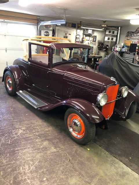

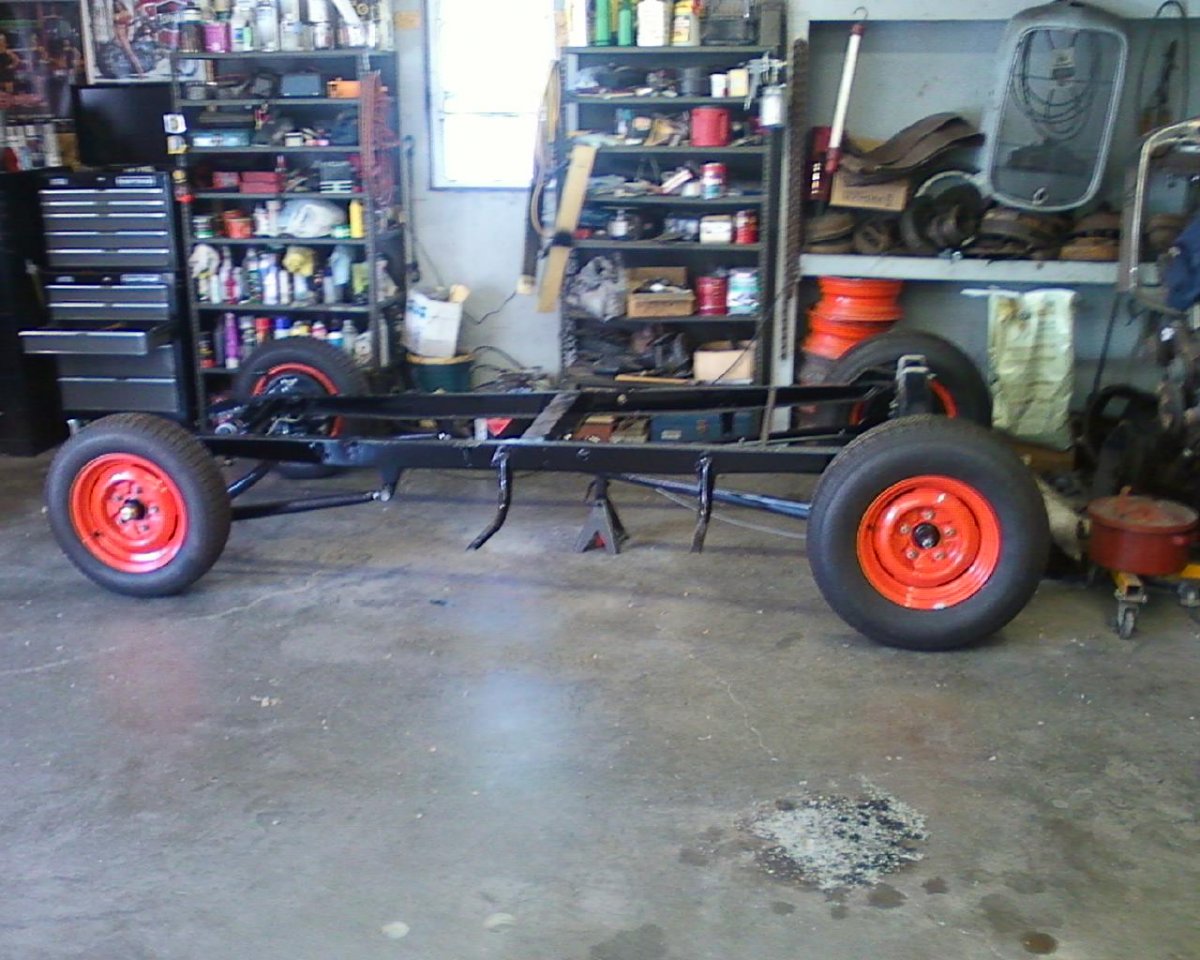

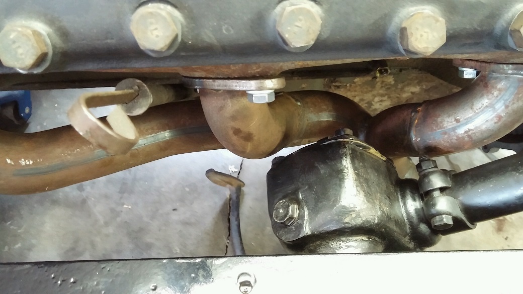

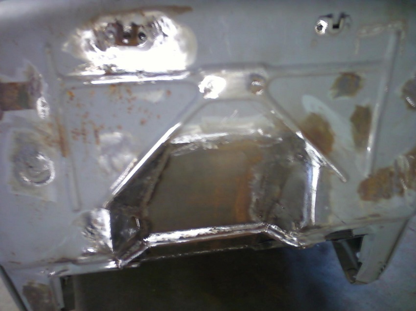

    You seem to be headed down the same path as my coupe except mine is full fendered. I didn't cut the drivers side of the firewall as much because of brake pedal clearance and wanted to run an old s**** gas pedal. I used studs rather than head bolts which was a mistake, can't pull the right head without pulling the engine if I ever need to. Same step in the rear of the frame and an F1 steering box. Modified the steering box with a Model A snout and moved it as close to the frame as possible for clearance. Looks like a good start !

    I'm running stock Model A pedals on an adapter and it puts the pedals in the stock position in relation to the steering column. I also left the notch for the steering column.
  28. Nice. I've got a lot of the same parts on my '31 ('52 8BA, '39 toploader etc), but didn't Z the frame and didn't cut the firewall. Took some engineering but it's all in and looks the part.
