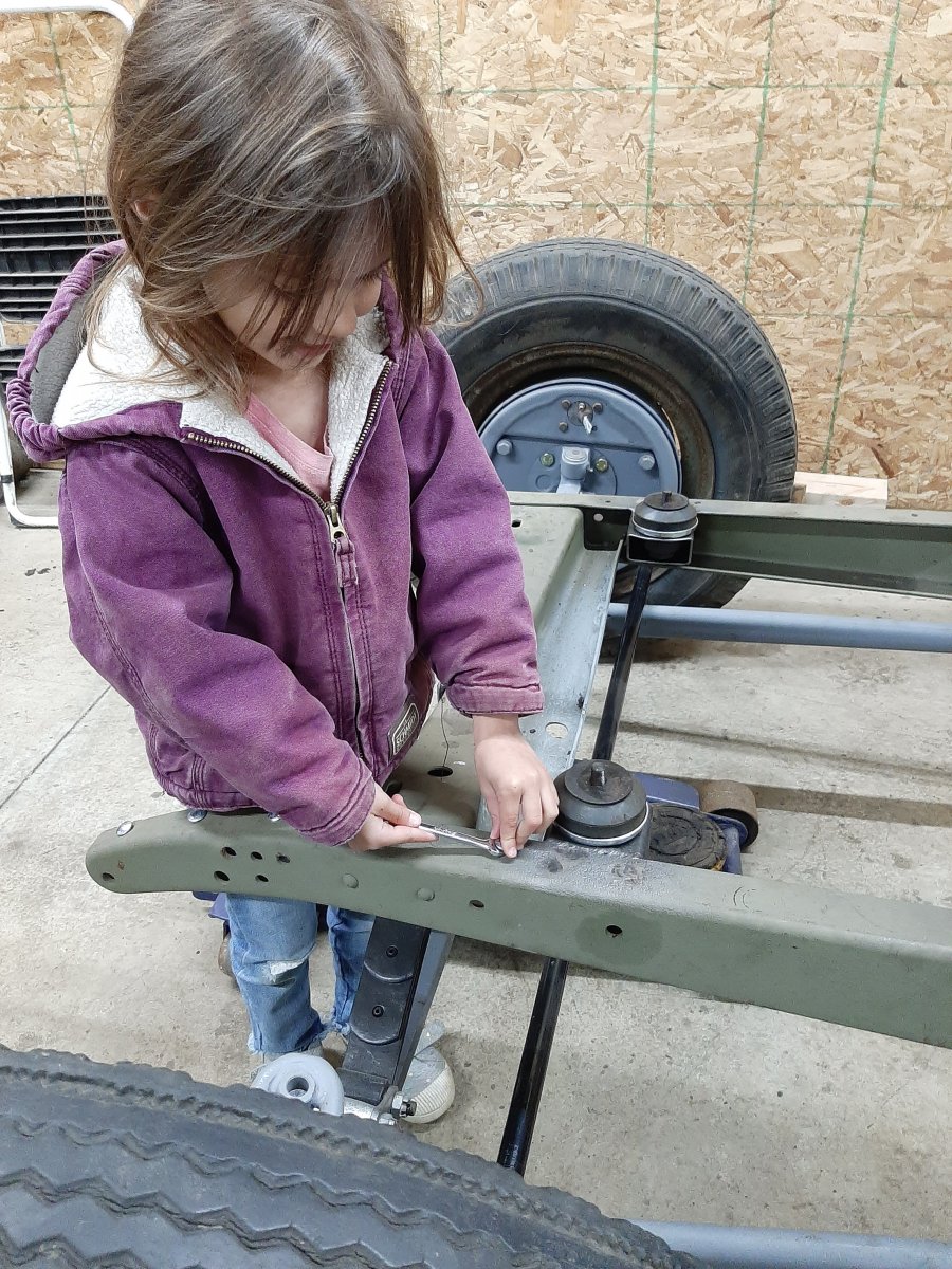

    20210328_172028.jpg Had a little helper tonight while dis***embling everything, anybody seen my 1/4" Snap-on wrench?
  21. Wild guess, the boss ( her mother) insisted didn’t she.

    from michigan
    Actually she asked to "go up to the shop" when she woke up from her nap, mostly because she knows there's junk food up there to snack on, mom was out volunteering.

  23. Well now, I’d say she’s got potential. I mean, she’s clearly interested in hot rods. [emoji56]

    from michigan
    Out of all her matchbox cars her favorite is a '32 roadster, she's on the right track
