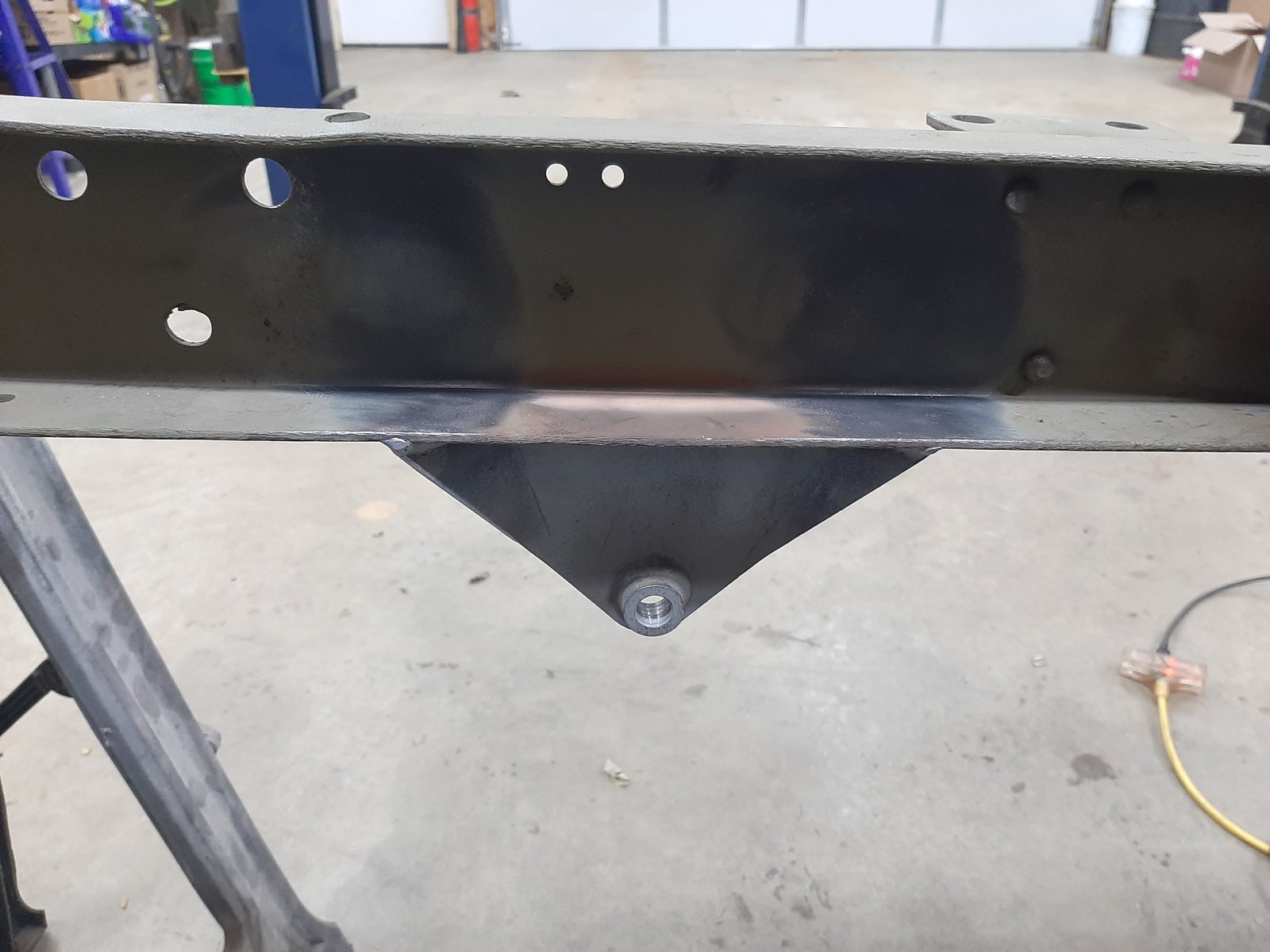

    After seeing how much the radius rod mounts flexed under load we decided to make some gussets in lieu of boxing a section of the frame.

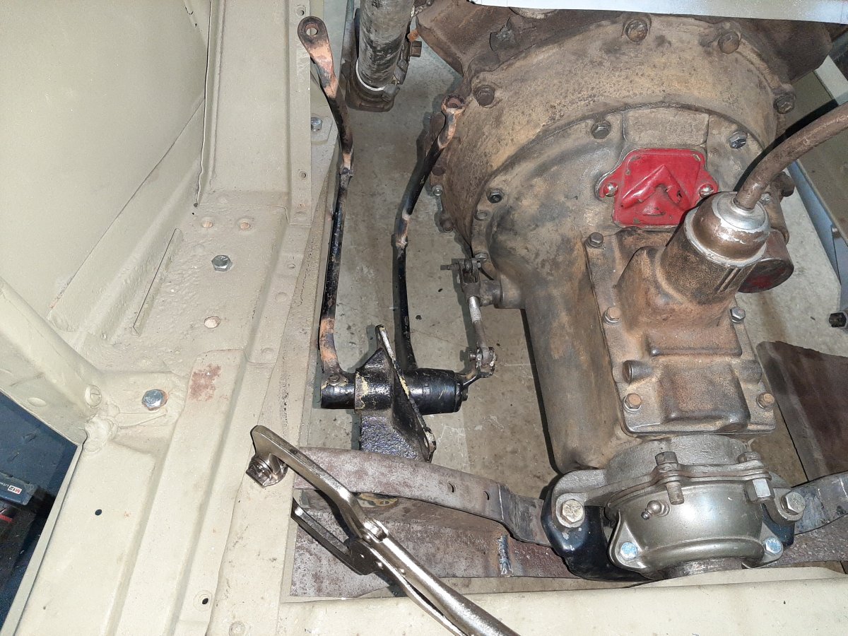

    After bolting everything back together and hooking up the clutch it was evident the three bolts at the crossmember were not going to be enough to keep the pedals in check. They moved about an 1/8" when operating the clutch so we made a bracket out of 1/4" plate that picked up the bottom two holes of the pedal bracket and bolted to the frame and crossmember.

    The new half "k" member did the trick, no pedal movement. We currently have a 39' clutch arm but the geometry of it doesn't quite fit with the set-up, what we really need is the 33'-34' arm, it works as is but puts a lot of stress on the clutch shaft before rotating the arm. We're also dealing with an 11" clutch so there's a bit more clutch pressure than most.
