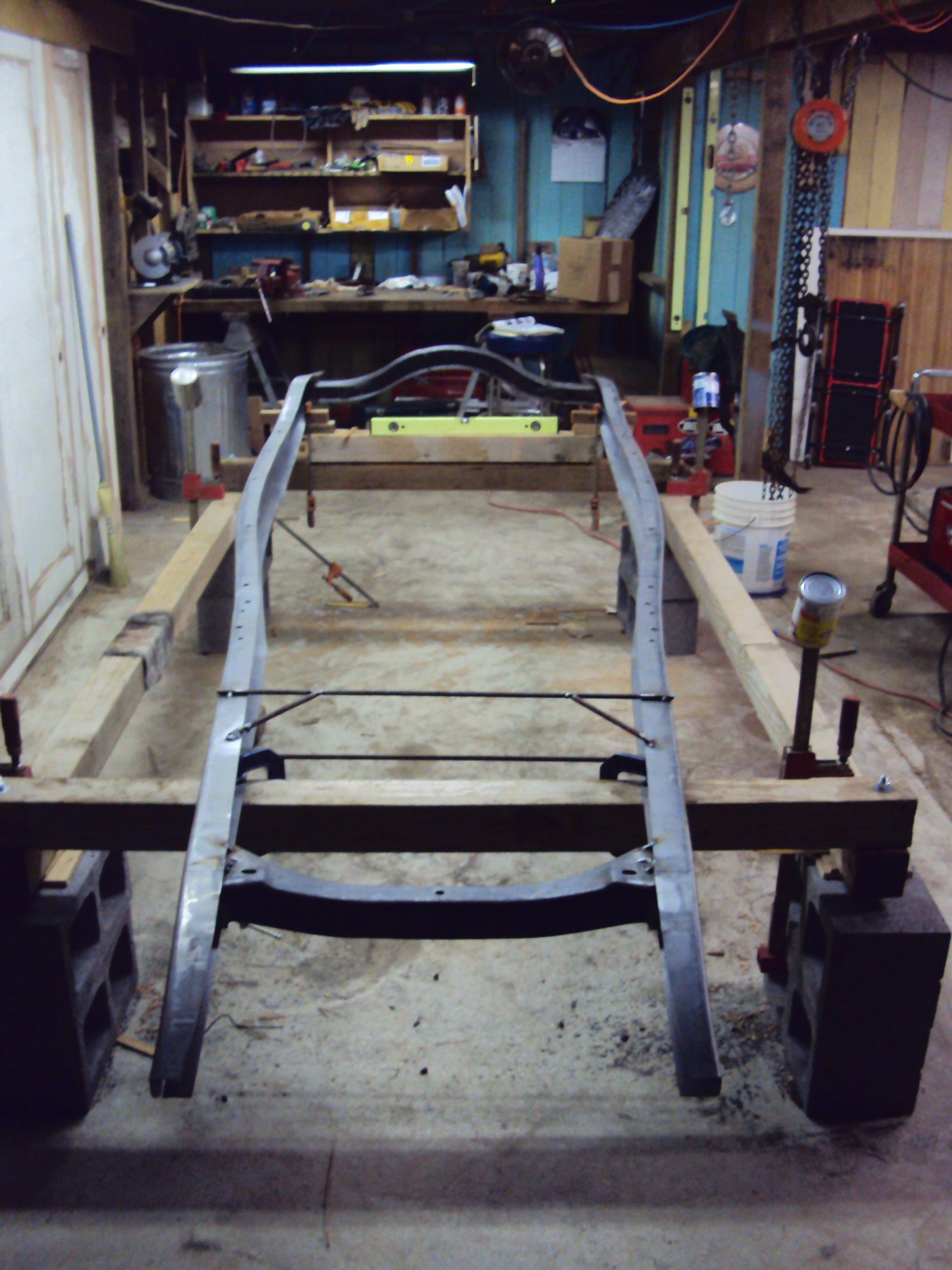

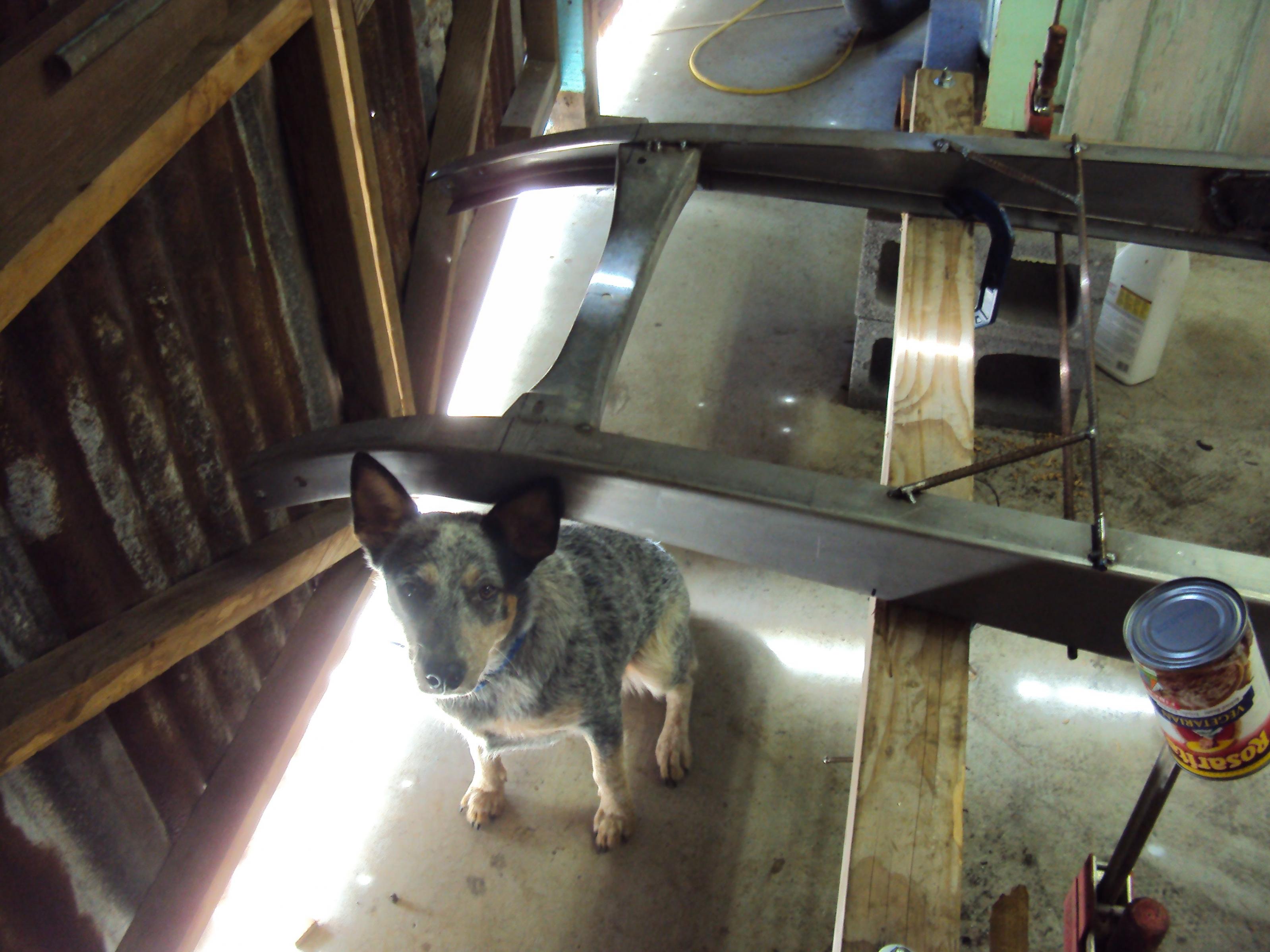

  2. heres the frame, its just sorta mocked up and nothings attached yet.
    I have a '40 rearend, '38 trans, and a '36 21 stud I'll use if its not cracked.

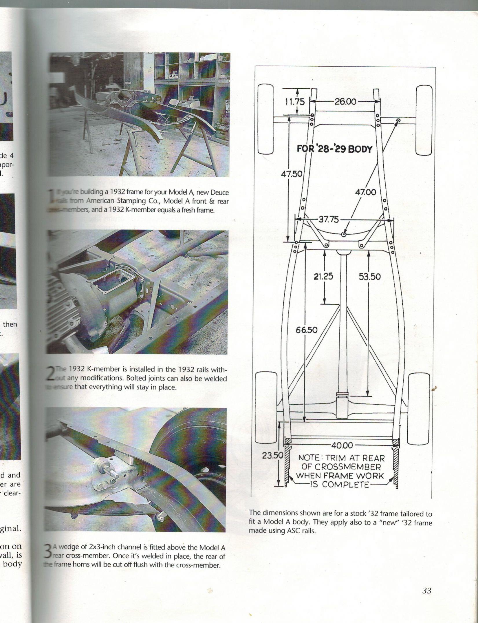

    The Tardel/Bishop book has a drawing for the dimensions of a '32 frame built for a 28/29 body, does anyone know how they would differ for a 30/31 body?

    I'm starting to think maybe the measurements are the same

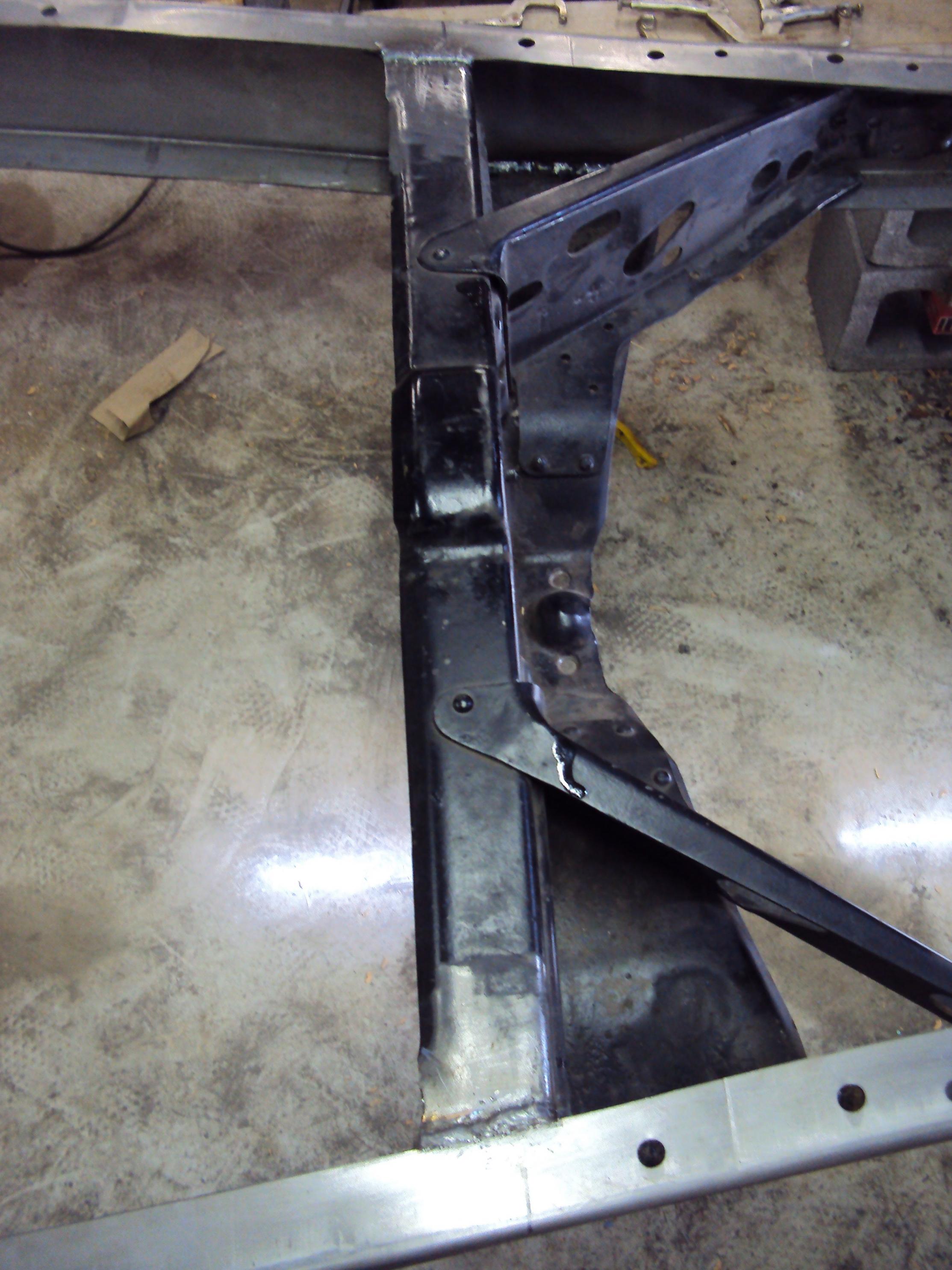

  10. Last night I cleaned up the rear crossmember, and I marked it to be trimmed. I'm almost ready to start ***embling the frame!
    thanks!

    Not all of the wescotts dimensions are right on. Found that out when trying to measure one up. I think this has been posted before

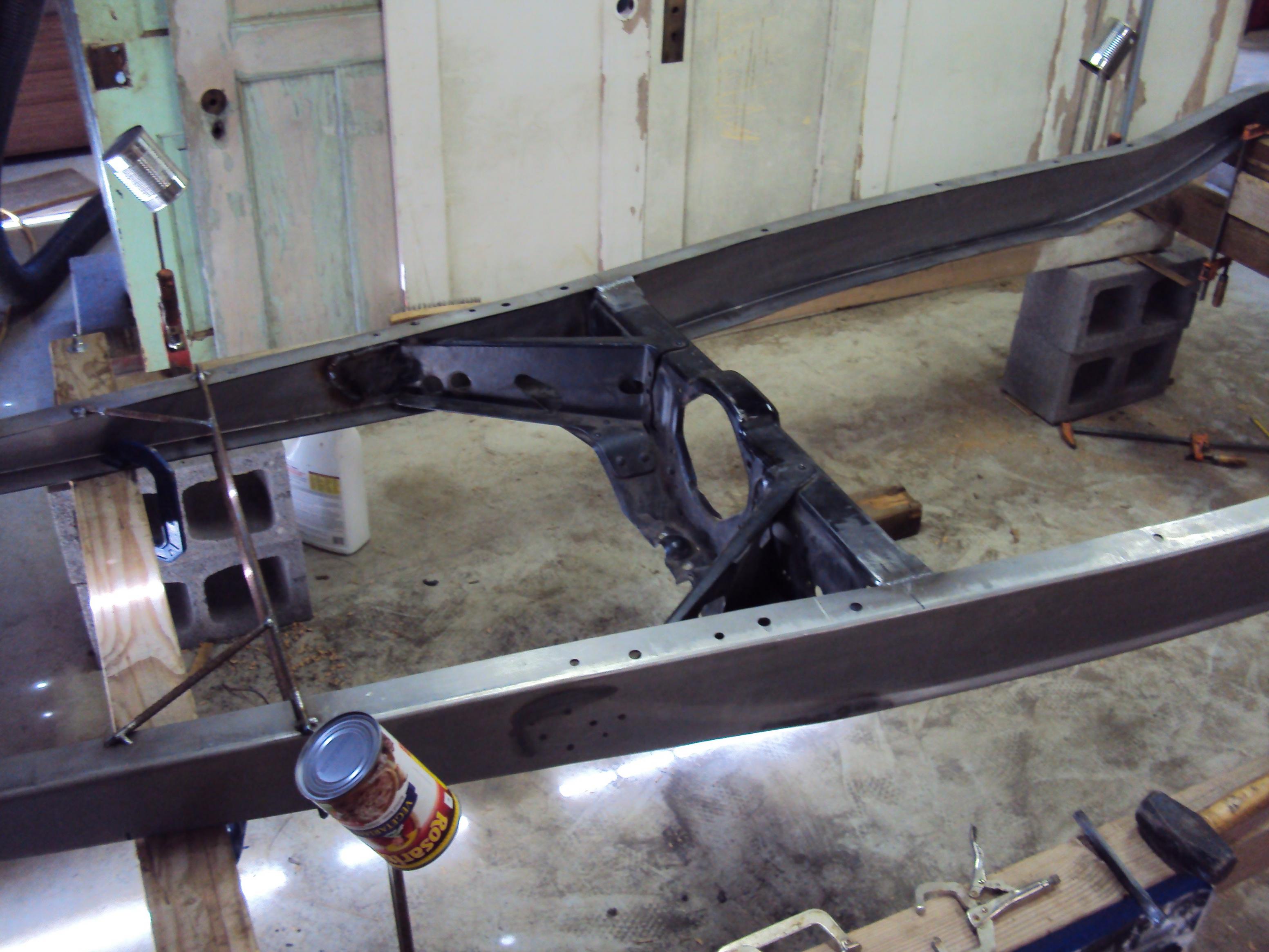

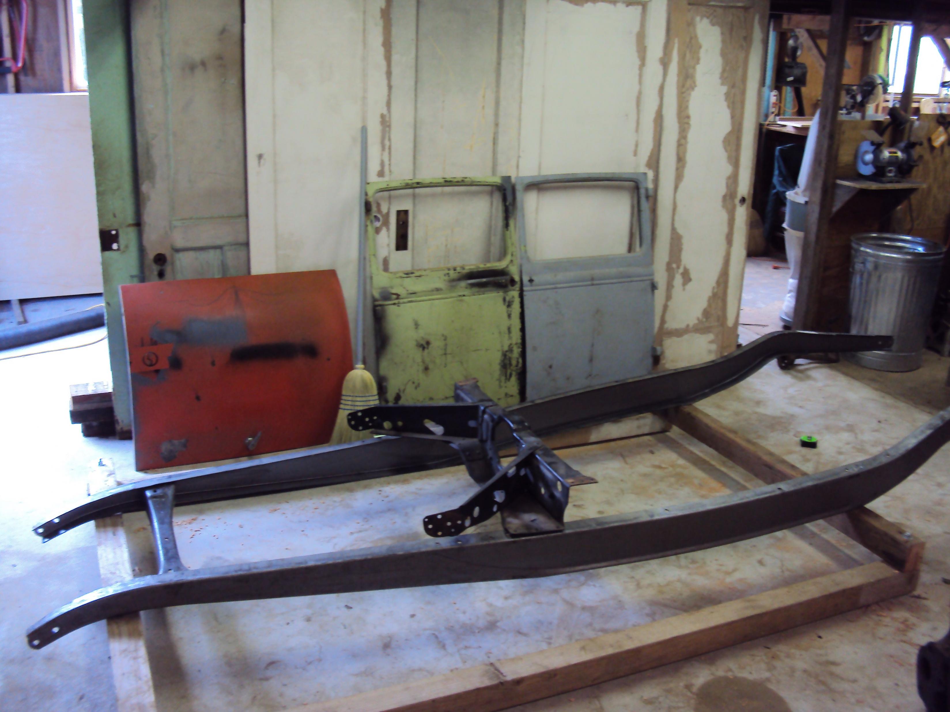

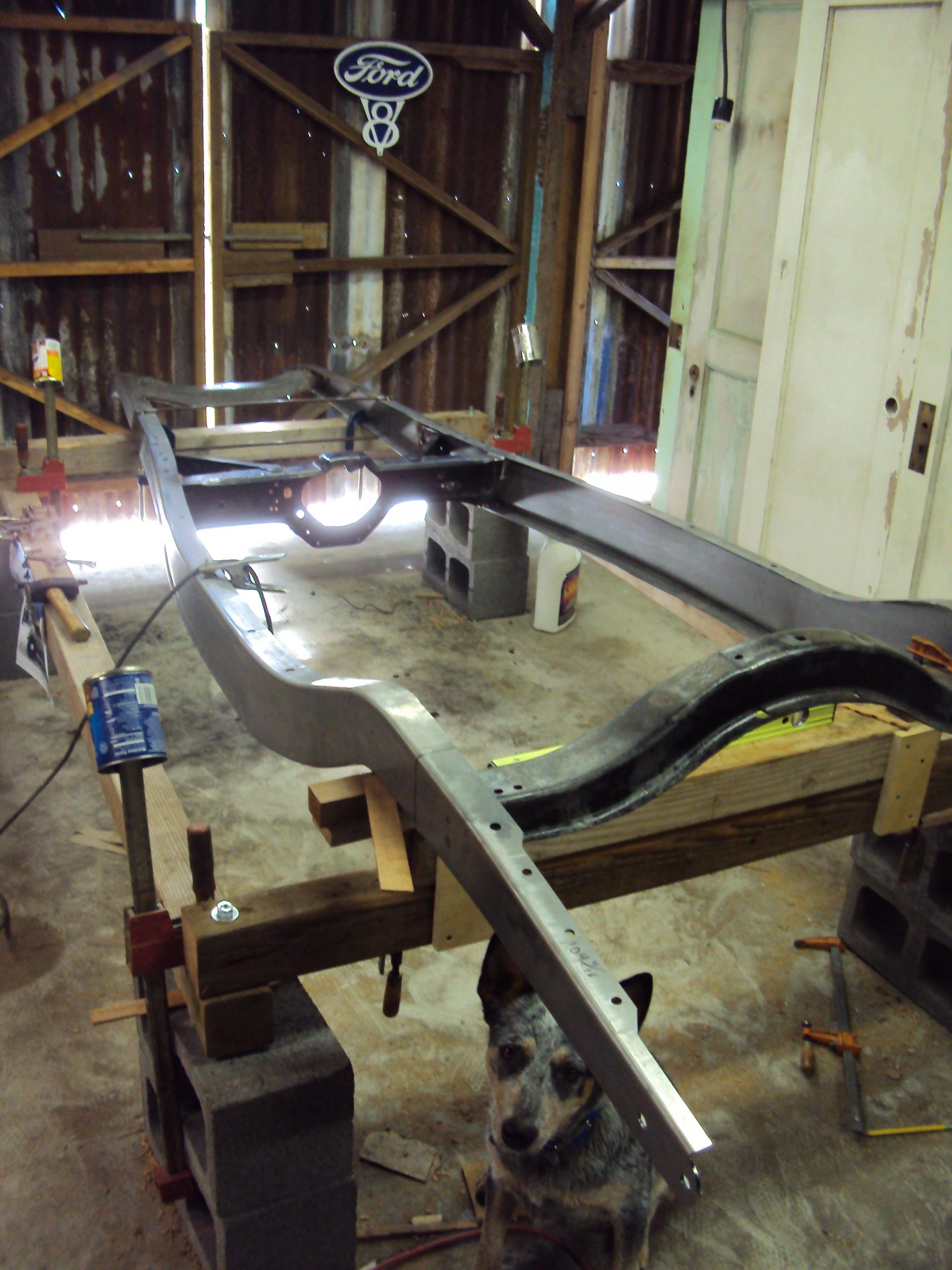

  13. Hey guys I've been working on the frame a good bit recently and I've made some progress.
    I am using frame table, although homemade it is very accurate. The diagram chopt top kid posted says 30/31 doesn't need to be pinched, which is good because I didn't.
    My frame is level and within 1/32 of square. Last night I tacked in the front and rear crossmembers (continually checking for square), and this morning I welded the K-member in.
    thanks for watching!

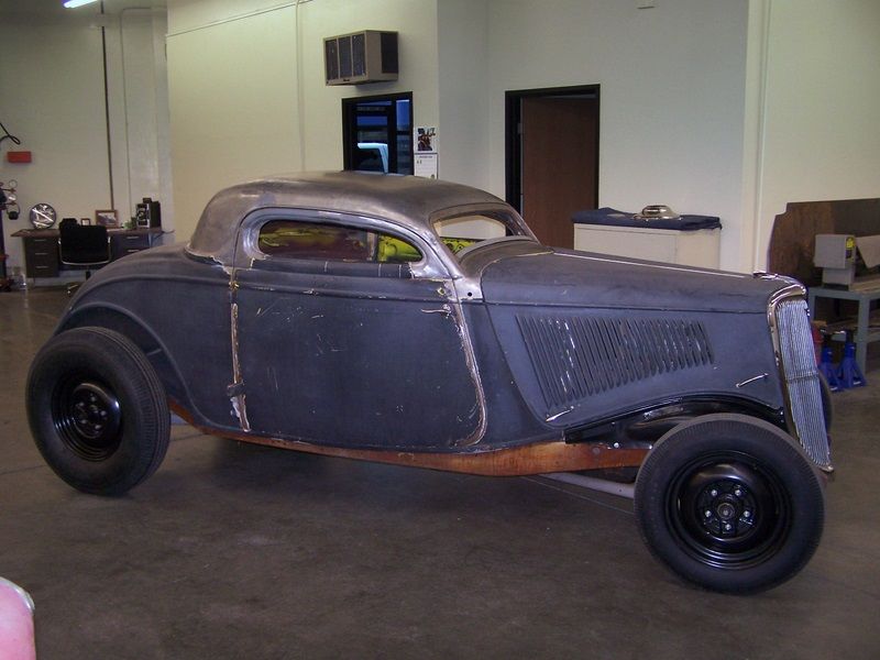

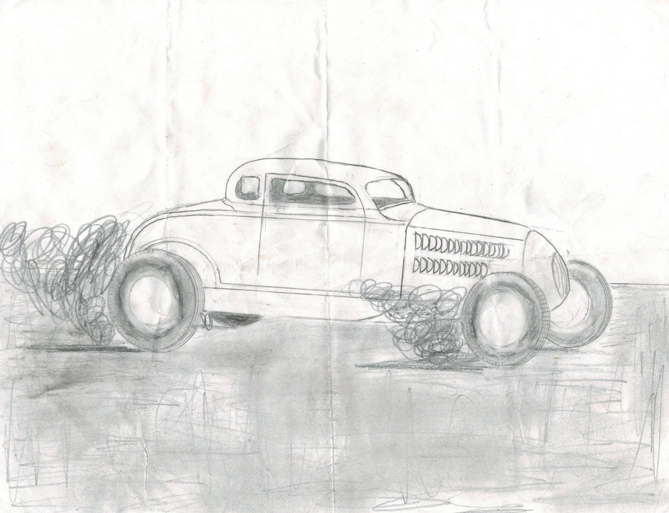

  14. ok so not much of an update, the frame is all welded up, and I decided on using the coupe(for good this time!). I did a drawing last night of how I want it to look. I kinda going for early compe***ion style coupe, like something that could have run at Russetta in say, 1950/1951. It will of course be street legal.
    Heres the drawing and the inspiration: (most of these are taken off the hamb)

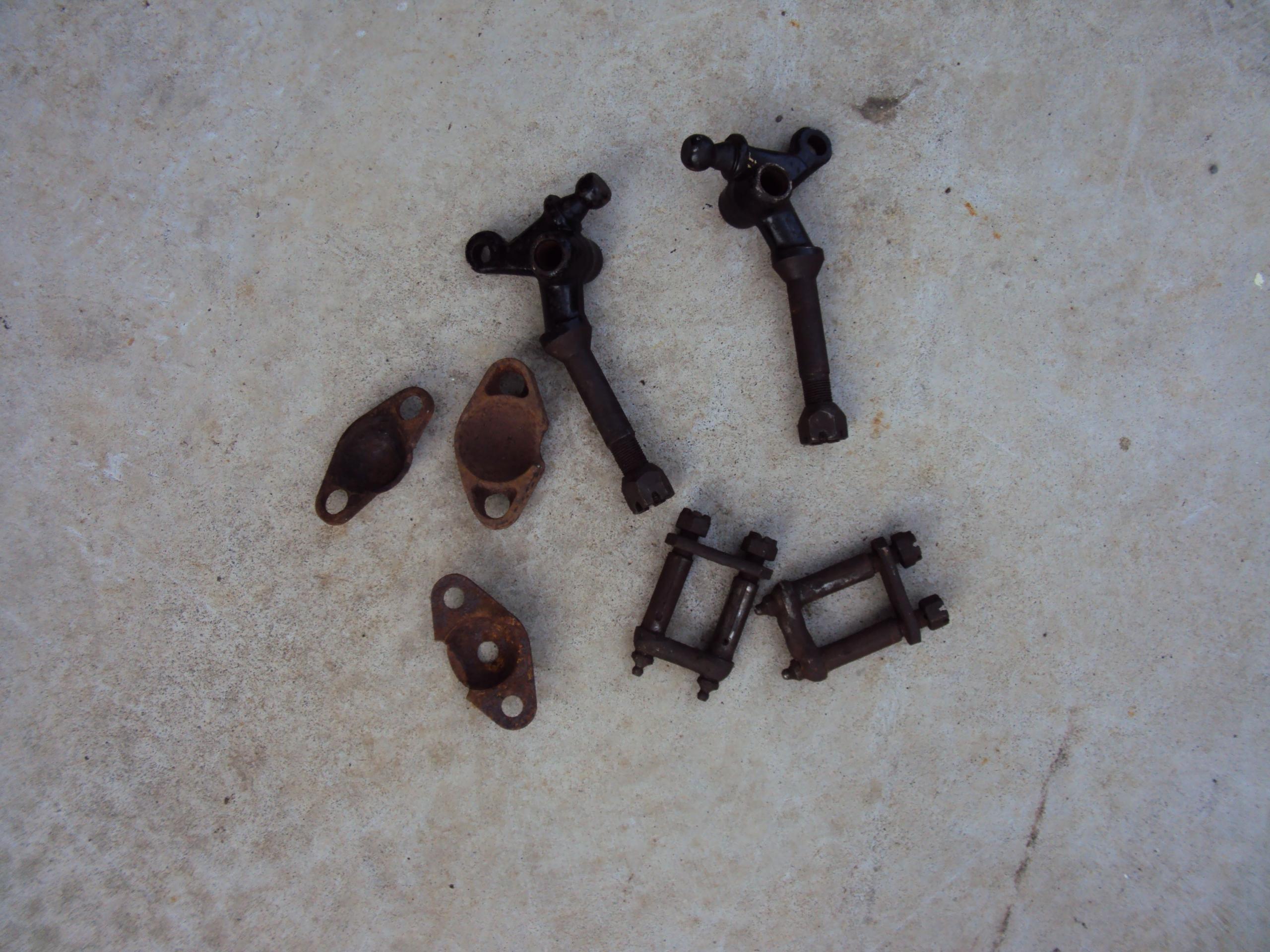

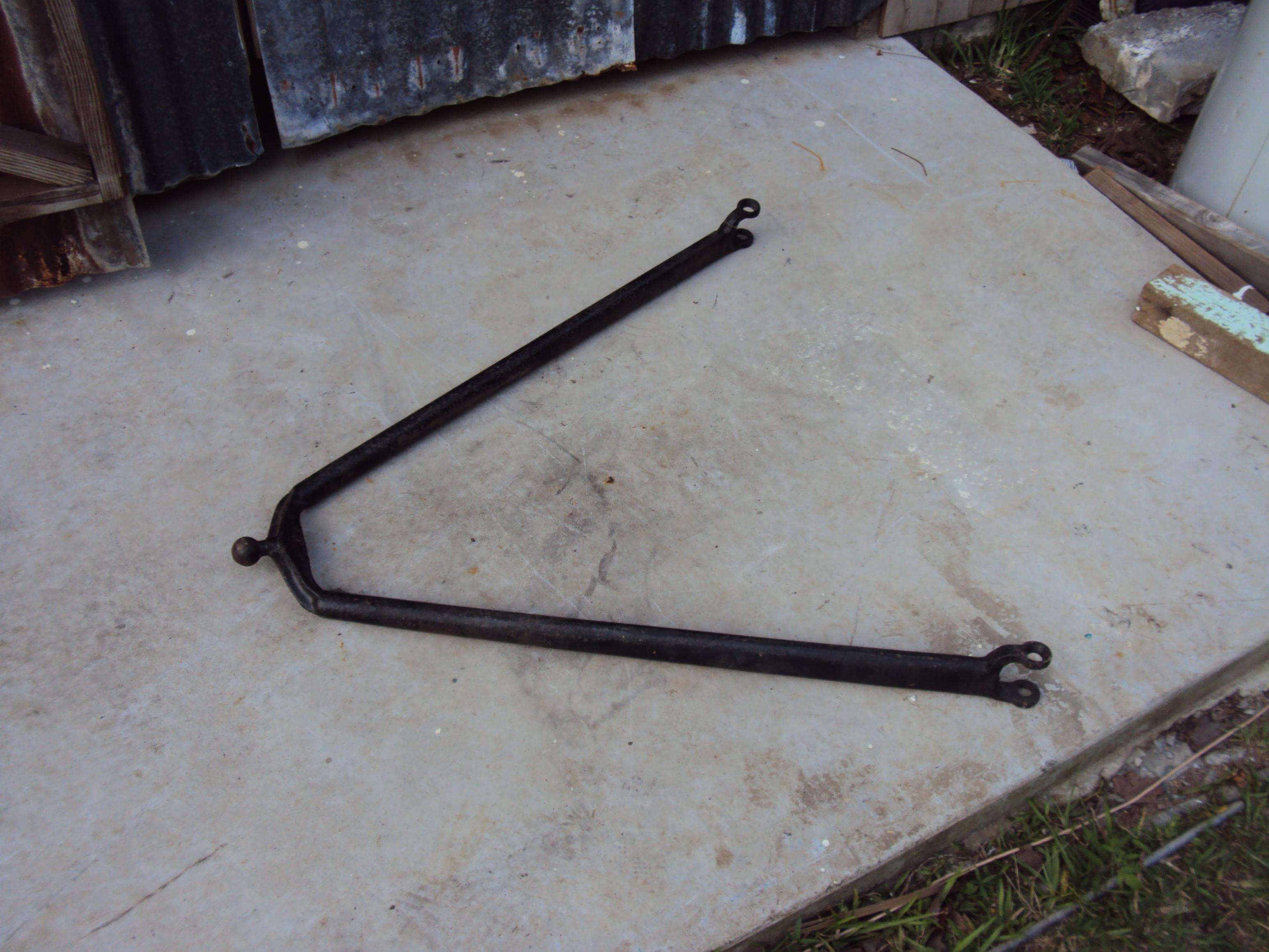

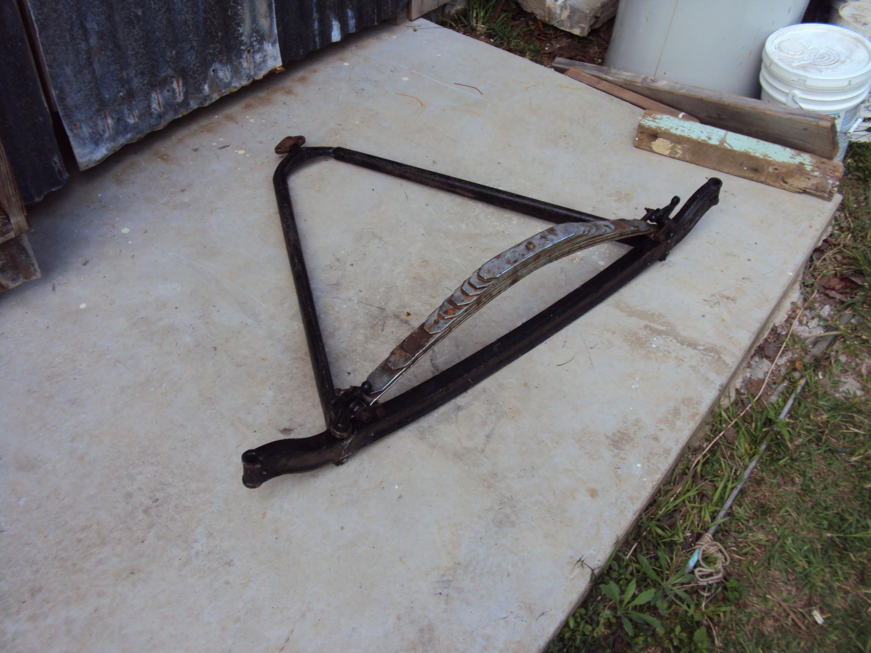

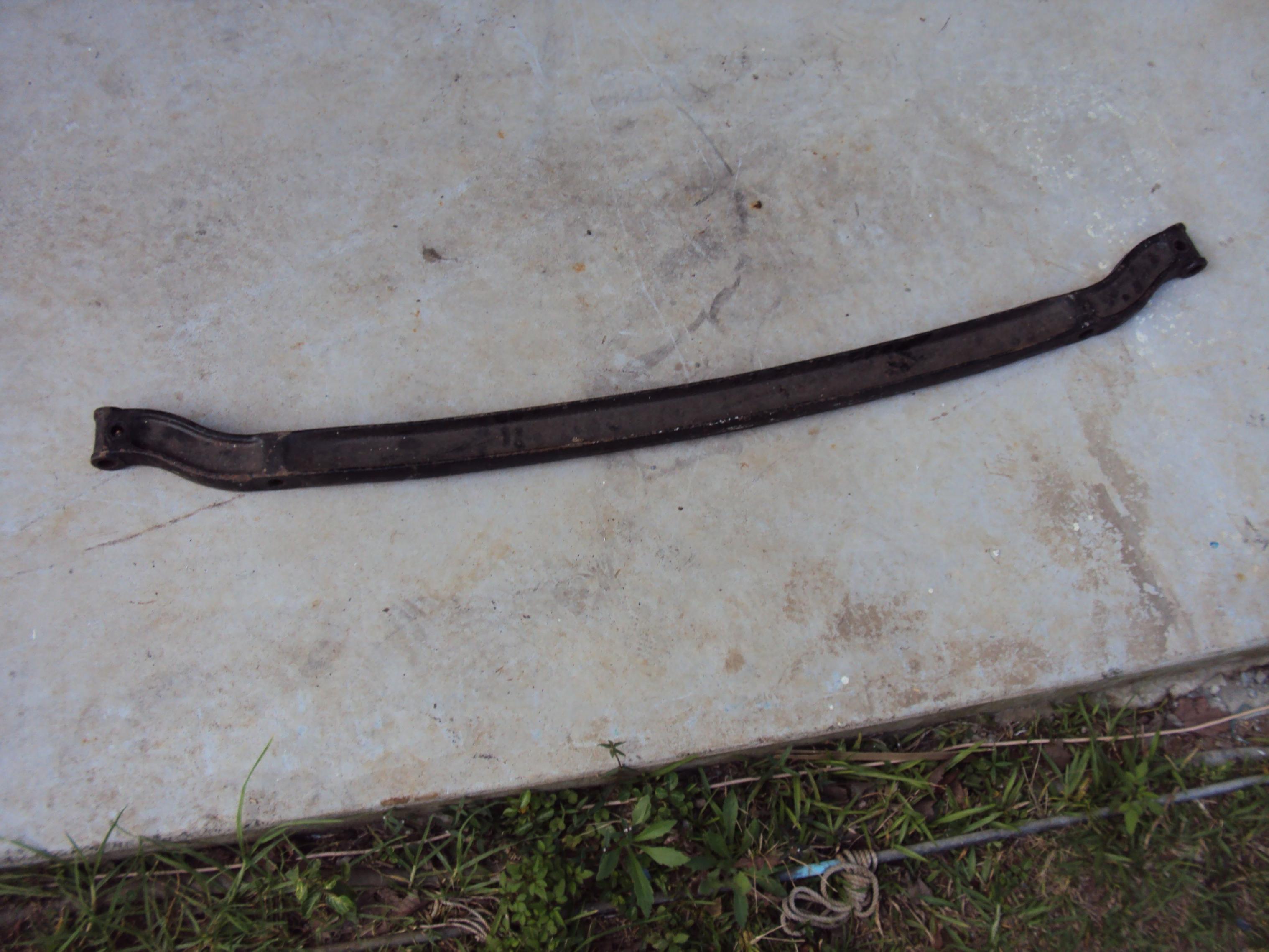

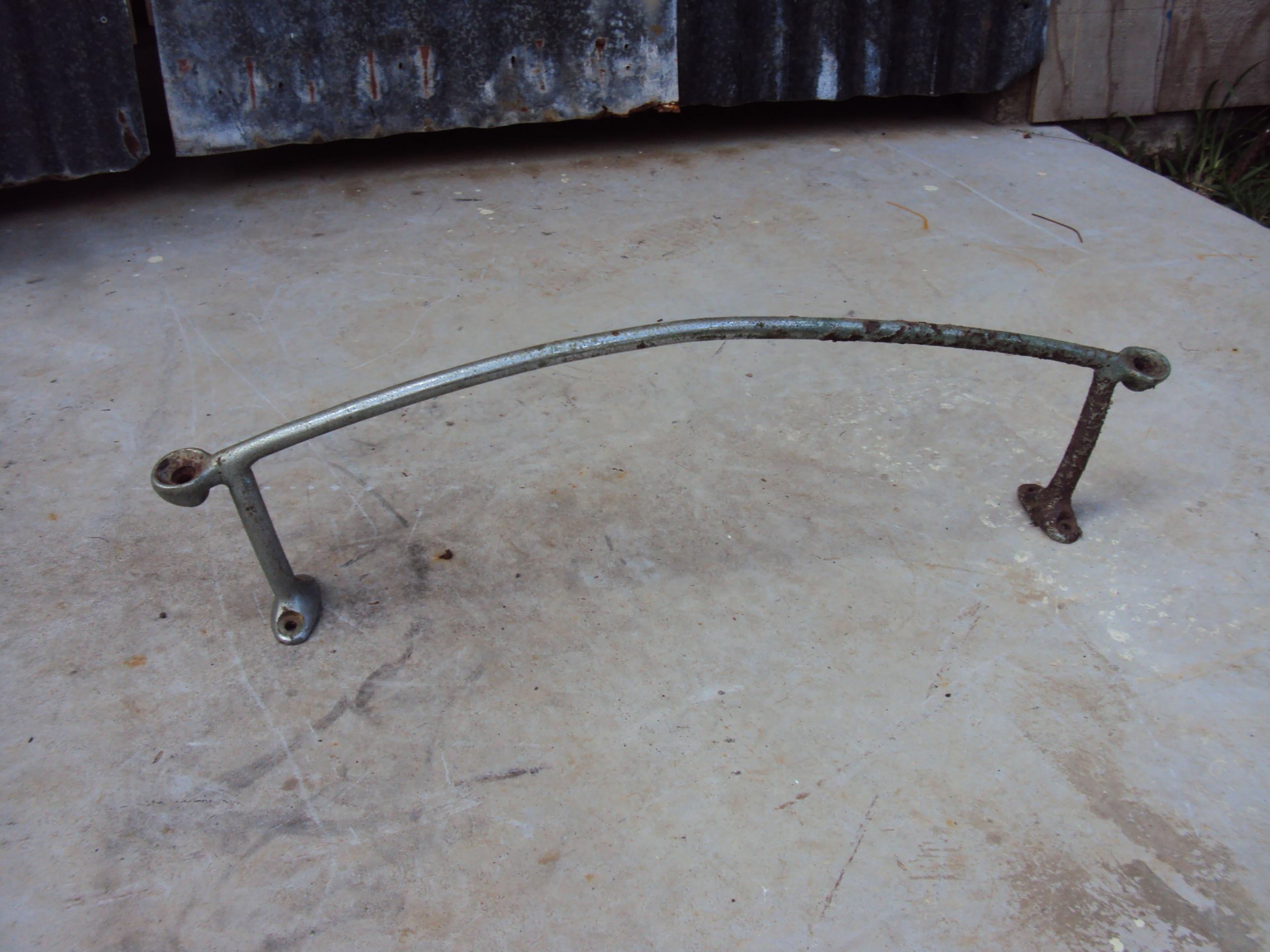

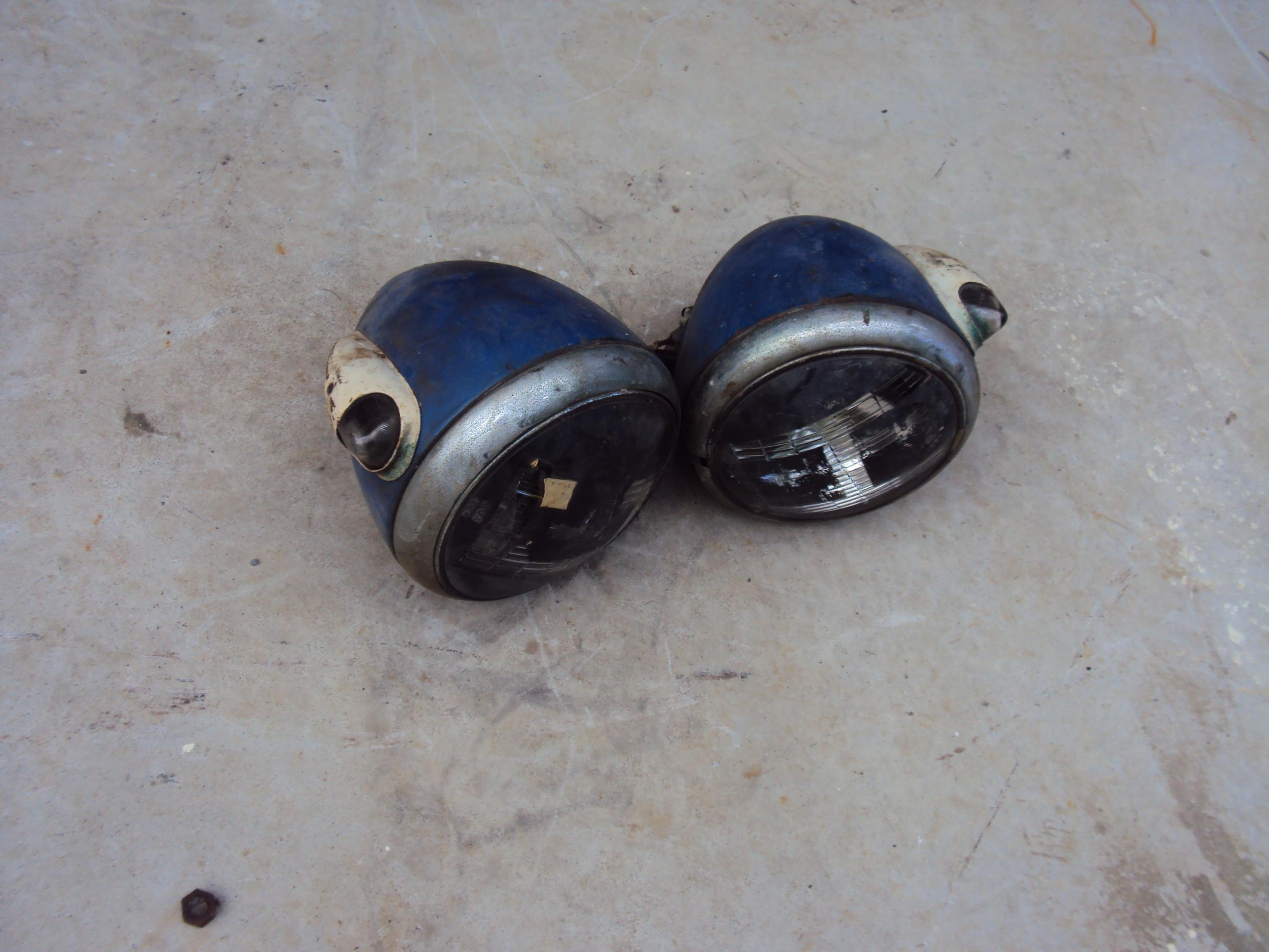

  19. so I've been out of town for two weeks, and I finally got home yesterday!! Today I went to visit this old guy up the road who has three model As and a bunch of parts, and I came home with some great stuff I've been really looking for!!! I got a '32 heavy axle(I'm pretty sure!) for $100, a pair of 682Cs for $40, a cool old chrome headlight bar and front spring, free perches and shackles, and what I think is a model A wishbone. The total was $220!!!!
    heres the photos!
    kidcampbell71 likes this.
  20. Southfork
    Joined: Dec 15, 2001
    Posts: 1,465
    Southfork
    Well, the old guy must like you pretty good.... Those are not today's prices. Good score!
  21. Carter
    Joined: Mar 18, 2006
    Posts: 1,542
    Carter
    Great score, man. That is indeed a 32 'heavy'. The perches and shackles are A. That headlight bar is awesome.
  22. Yeah I'm really excited about the axle! I haven't decided wether I want to run un-split or spit wishbones, or hairpins. Right now I'm thinking split bones though...
    dearjose likes this.

    Personally, I prefer unsplit wishbones whenever possible. It does everything you need it to with no panhard bars or extra parts. Just like Henry built em. Now if there are clearance problems and it is not an option to leave them unsplit, I'd do split bones.

  25. well originally I was gonna use a reversed eye model A spring I have, but I kinda like that chrome one I just got so maybe just remove a few leaves and call it good. The front crossmember I'm using is from so-cal, and its supposed to give an inch of drop. I may eventually send the '32 heavy to 296 V8, I was thinking maybe a two inch drop? I hope that answers your question.

  26. The thing I was thinking about with the split wishbones is if I can find a '32 or '34 wishbone, I'll use it un-split because I'm using a '32 k-member. But if I can't find one I'll have to split a model A wishbone I already have.

  29. I think the crossmember I have is actually repro model A piece, that has a one inch drop over a stock one. I remember comparing it to the one in my A frame and it was lower.....
    I think I have a lead on a '34 wishbone near me so I might be able to do un-split!
