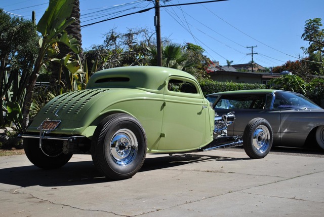

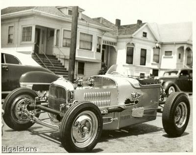

  21. Matt... I always respect your opinion, so thanks for sharing. I agree with you on the insert, its just a lot of work, and I don't have a bead roller yet. Most likely I'll end up doing it in the end though. As for chrome wheels, I think they became a lot more common as the fifties wore on, and were just rare earlier on... Which quickly turns into to "wrong period", but the look I'm aiming for is "show and go" comp coupe around '51-'53(I Like the wires, but feel they don't fit that look). I can't remember for sure, but is it the Weiand track roadster(I think early-mid 50s) that had chromed steel wheels? I've attached a couple of cars with chromies also... I really dig them on the '34, and the color I want to paint it will be green also(but darker).

    You know I like the wires, but the chrome steelies might look really good. I agree with matt on the insert... And you have more than enough hammering skill to do that without a bead roller. Use a "corking tool" and a hammer form for beads and throw the flanges by hand. That stance just keeps looking better as you get closer!
