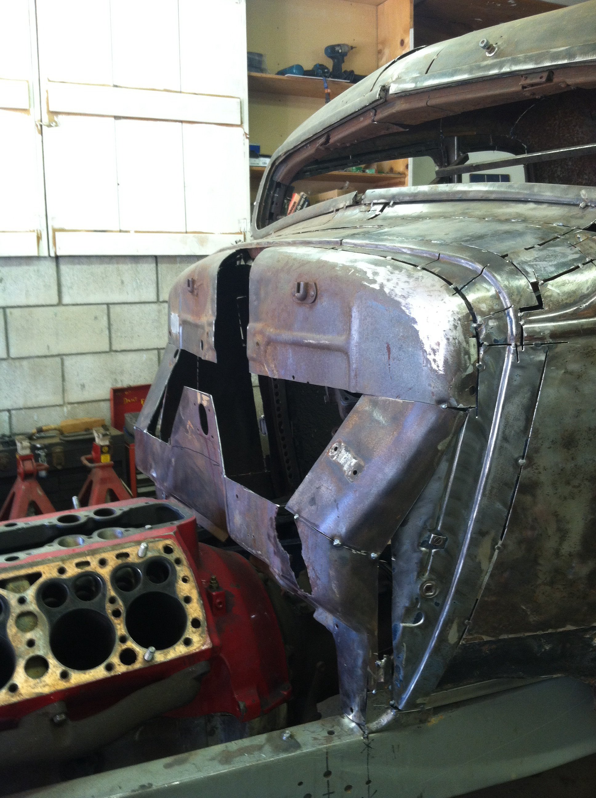

  25. Firewall update.... I'm hoping to get it ****oned up tomorrow.
    ....I'm thinkin that little triangle might be the perfect spot for a firewall mounted gauge of some sort :D

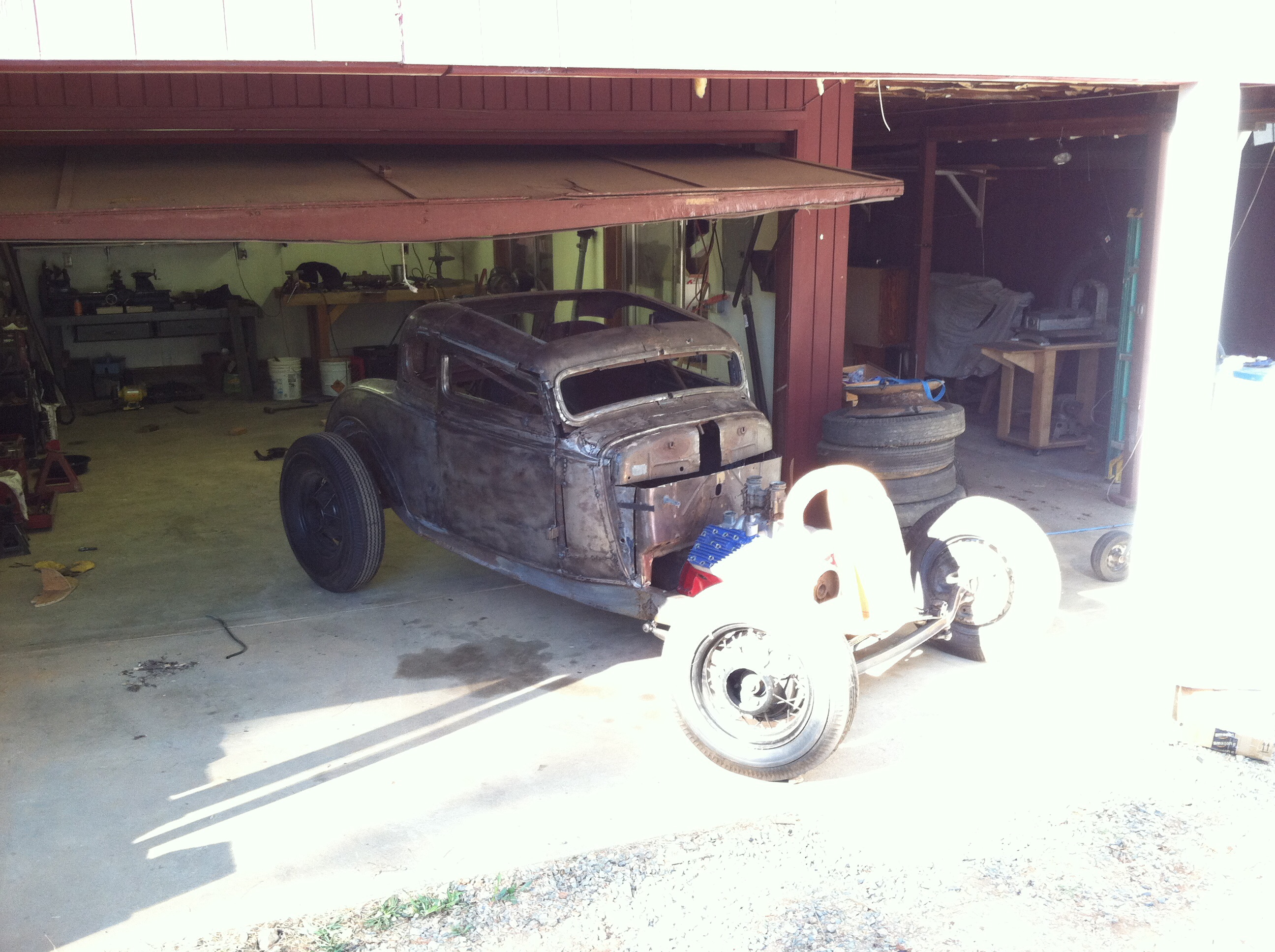

  28. So I got a little further on the firewall last night, but I ran out of mig wire.... So I didn't get it all done. I pushed the coupe outside this morning to get a good look.... Many feet of welding ahead of me on the body.
    -Joe
