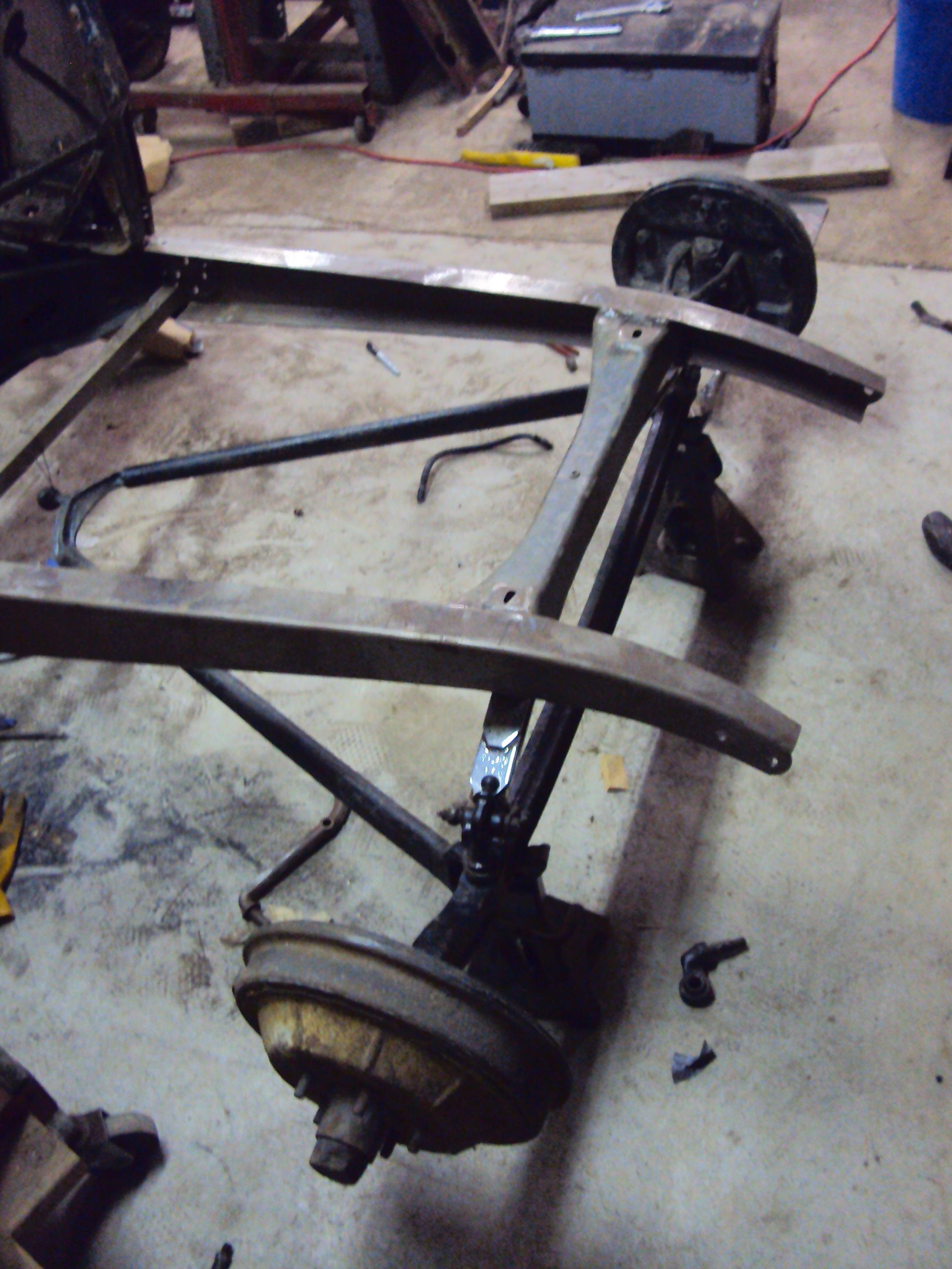

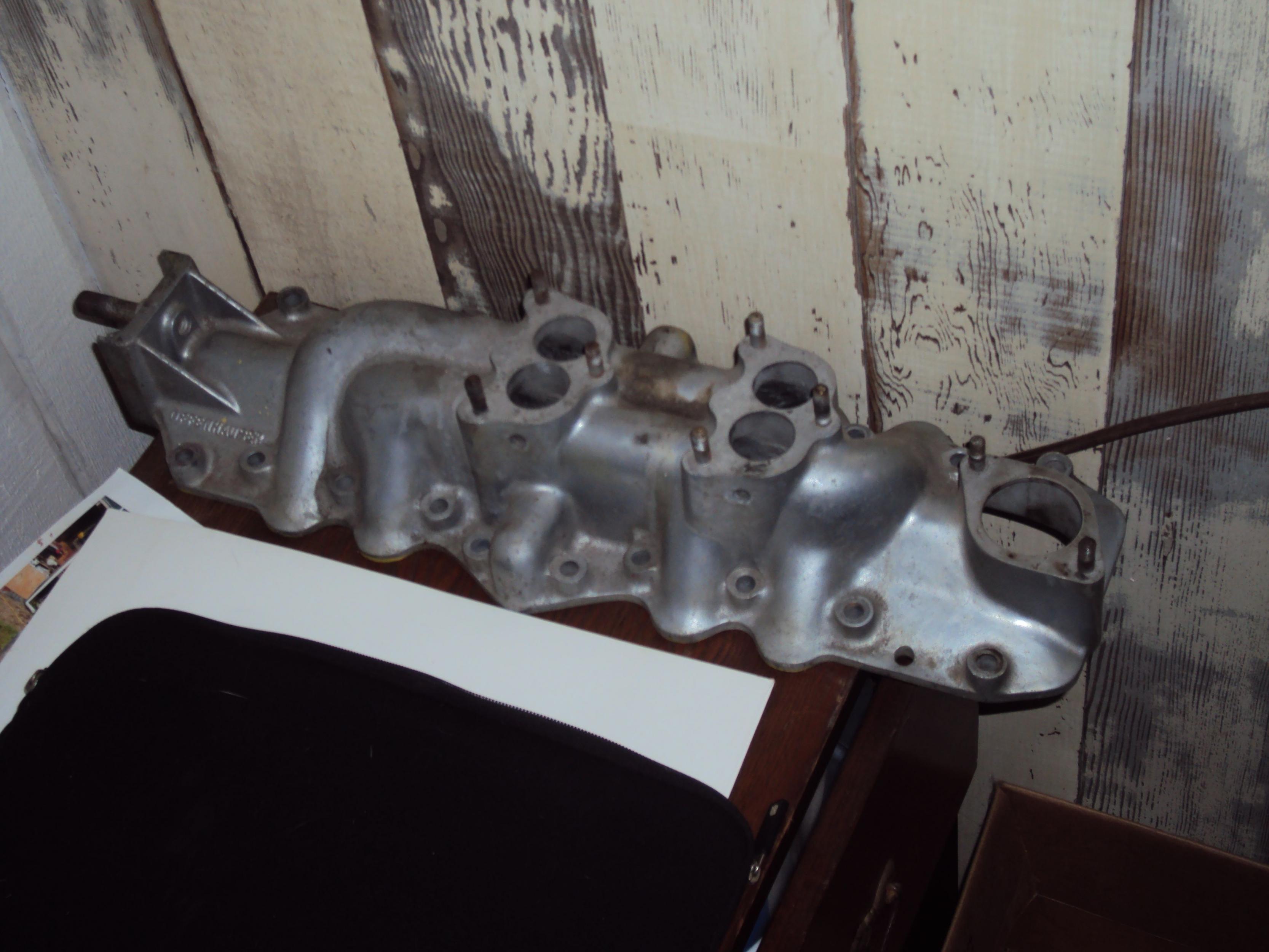

  8. Well not really a big update, but I got some cool stuff yesterday! I met an awesome guy that totally made a certain 16 year old's year(thanks Ken!)!!!!! I paid $100 for the deuce shell(kinda rough), other than that it was all free! An old dropped axle out of a '34 roadster, front juicers and round spindles, an original Offenhauser two pot(!), bomber style seat belts, and what I think is a Stewart Warner gauge panel(!!!) I'm sorta in a parts collecting stage right now so I haven't done much worked on the car, but tonight I put the brakes on the '32 axle. (oh yeah and I smashed my thumb with a 3lb hammer, OUCH!!!)
    please tell me what you think!
    thanks

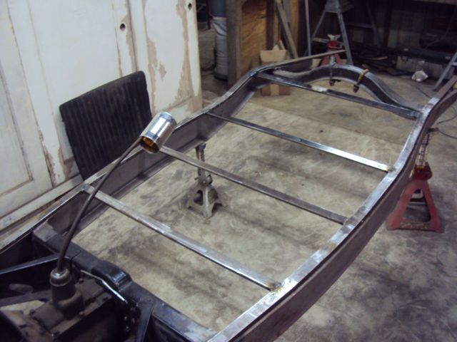

  13. Ok so its been a while.... I have been working on the roadster(I need to sell one of the two bodies I have, I tried to sell the roadster but its so rough nobody would even make an offer :eek: :eek: so I decided to see if I can fix it!!!).
    It has really beat-up/rusted/hack-job repaired subrails(which it's welded to out of whack!), so I decided to start fresh with some 1 1/2" x 1/2" 16g square tube, formed to the shape of the top of the rails. There will be 3/4" x 3/4" uprights that the rear quarters will be attached squarely.
    I have one side all cut and welded, about to start the other soon!
    Enjoy!

  16. update:
    I worked on the sub-rails this evening and got the p***enger side pie-cut and all tacked up. next is to fully weld the top and sides, grind for a good long time, then make some cross-members. once I have the two sides attached to each-other I can flip it over and weld the bottom.
    thanks for watching!

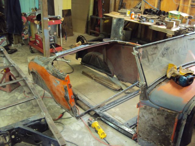

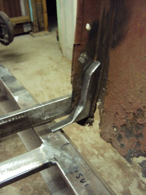

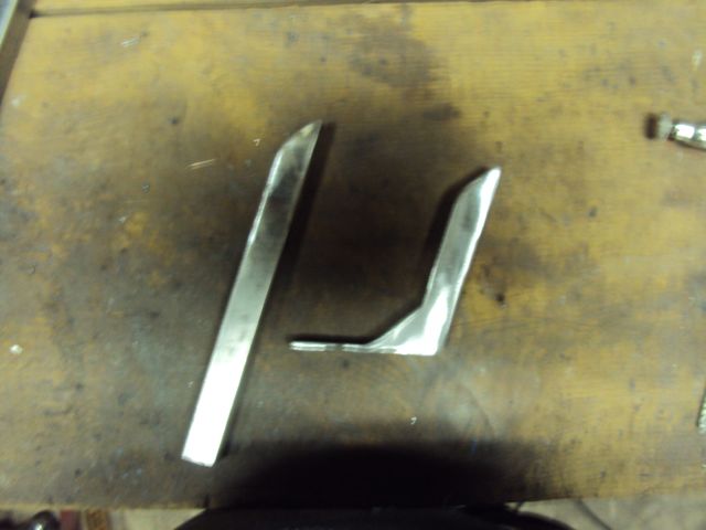

  18. well heres what I've been doing lately, got all the cross members welded to the sub-frame, and made my roadster body into smaller pieces!! My idea is to start by getting just the rear quarters on the frame and square, and then attach the cowl in relation to the quarters......... so today I cut the rear of the body off the sub-frame, then set it on the frame and got it centered. I still need to move it back about an inch(tomorrow) and I also made some body mounts for the front of the quarters, still need put a gusset on them and weld them in tomorrow!
    thanks!
