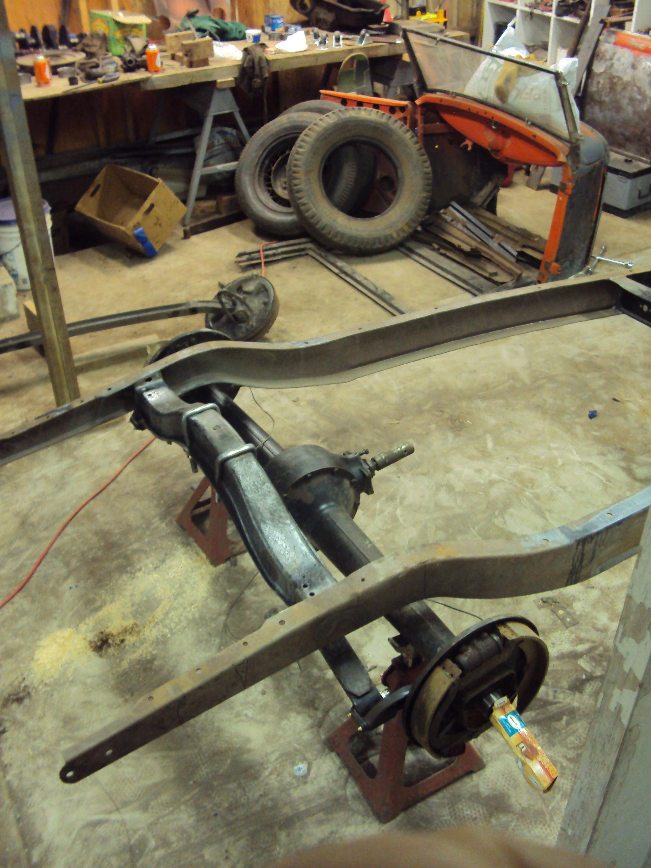

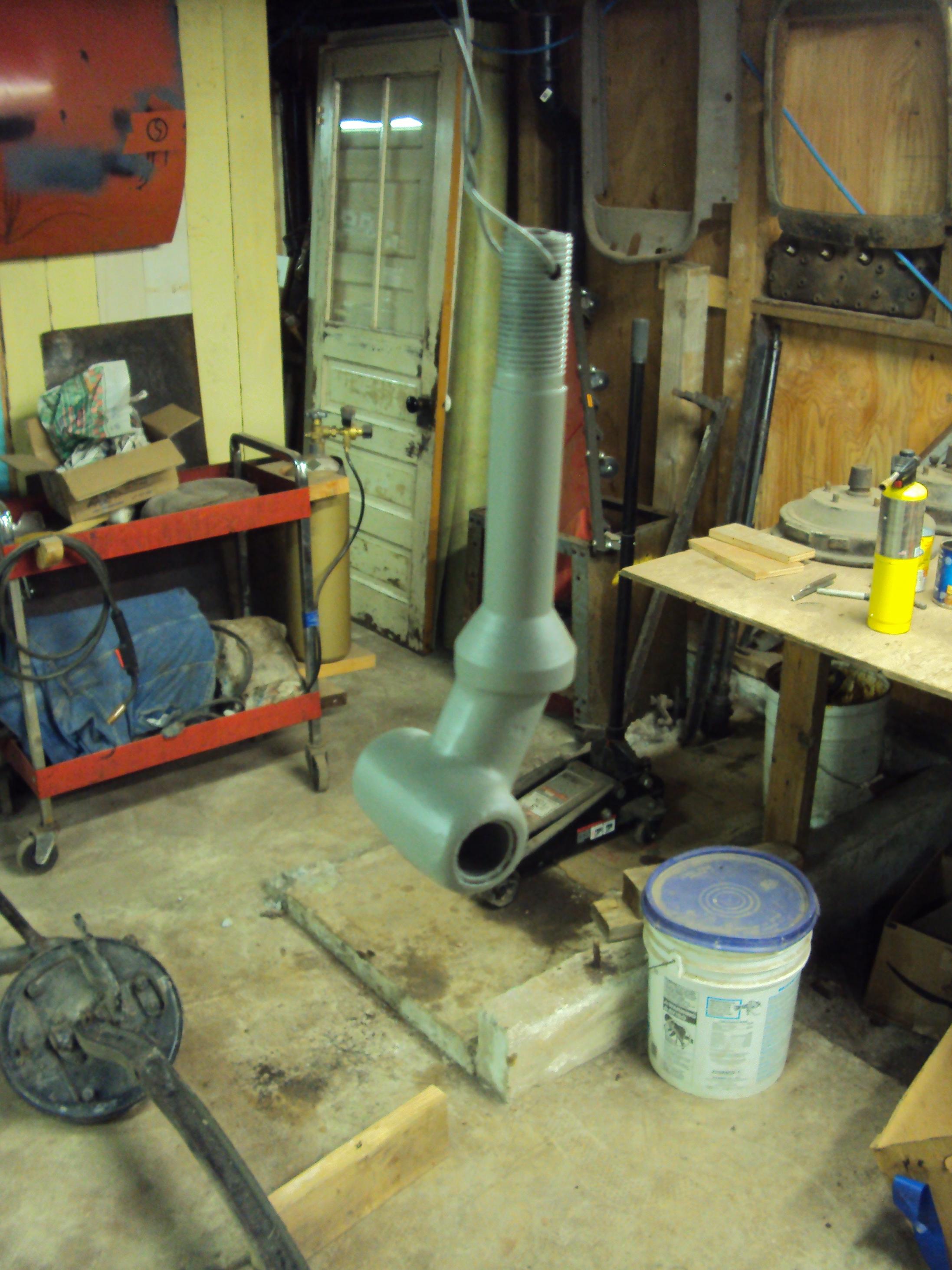

  2. thanks guys, I ended up hammering at it for about an hour or so.... and then decided to drill it out. It turns out inner diameter of the perch is 3/4" and happened to have a 3/4" drill bit, so I drilled it out using a Milwaukee angle drill. It worked great!
    Then I used a borrowed spring spreader and put the spring on the axle, and bolted it all to the frame!
    I'll post pics in a bit!

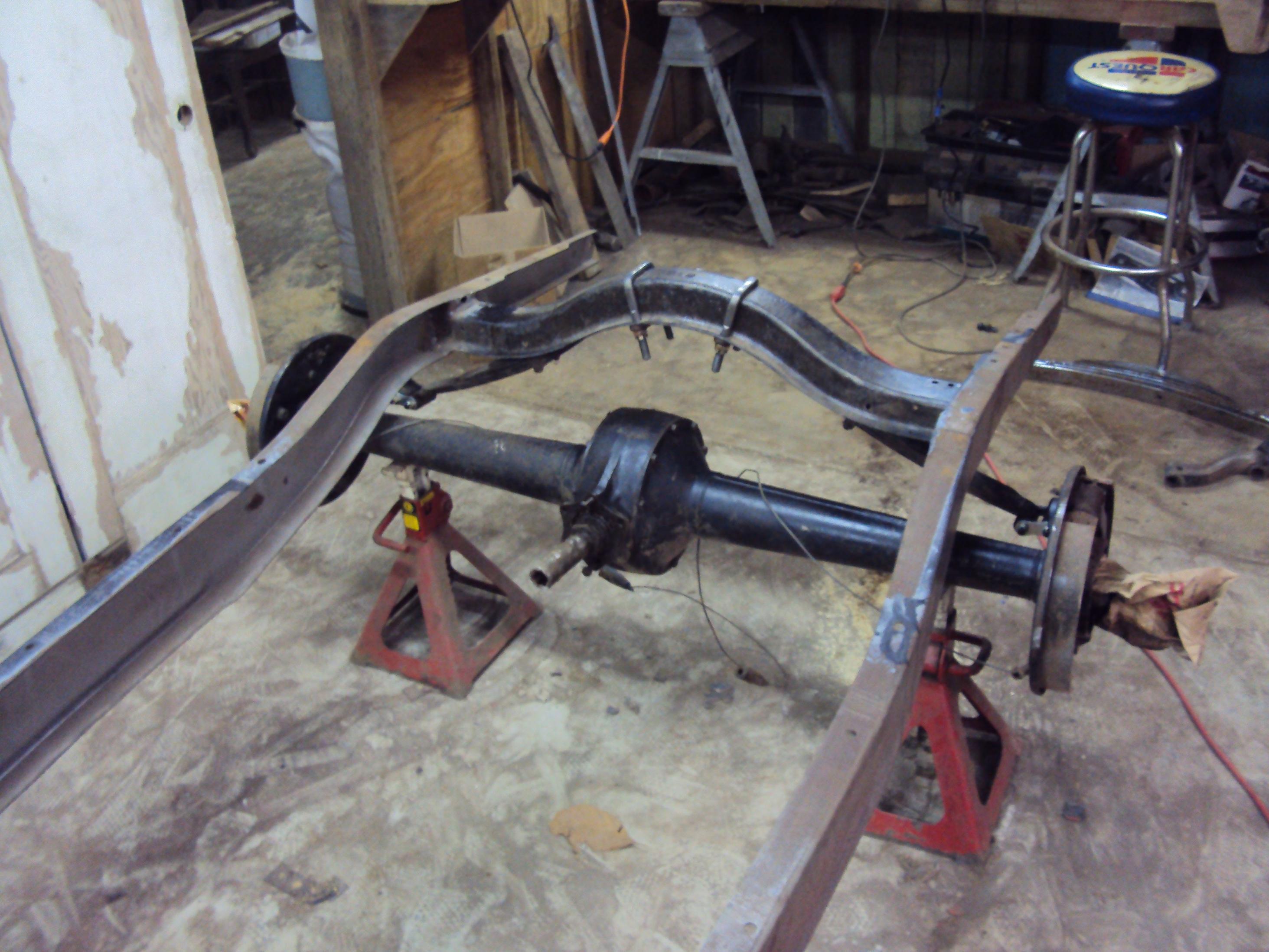

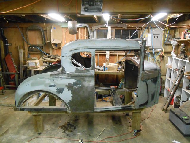

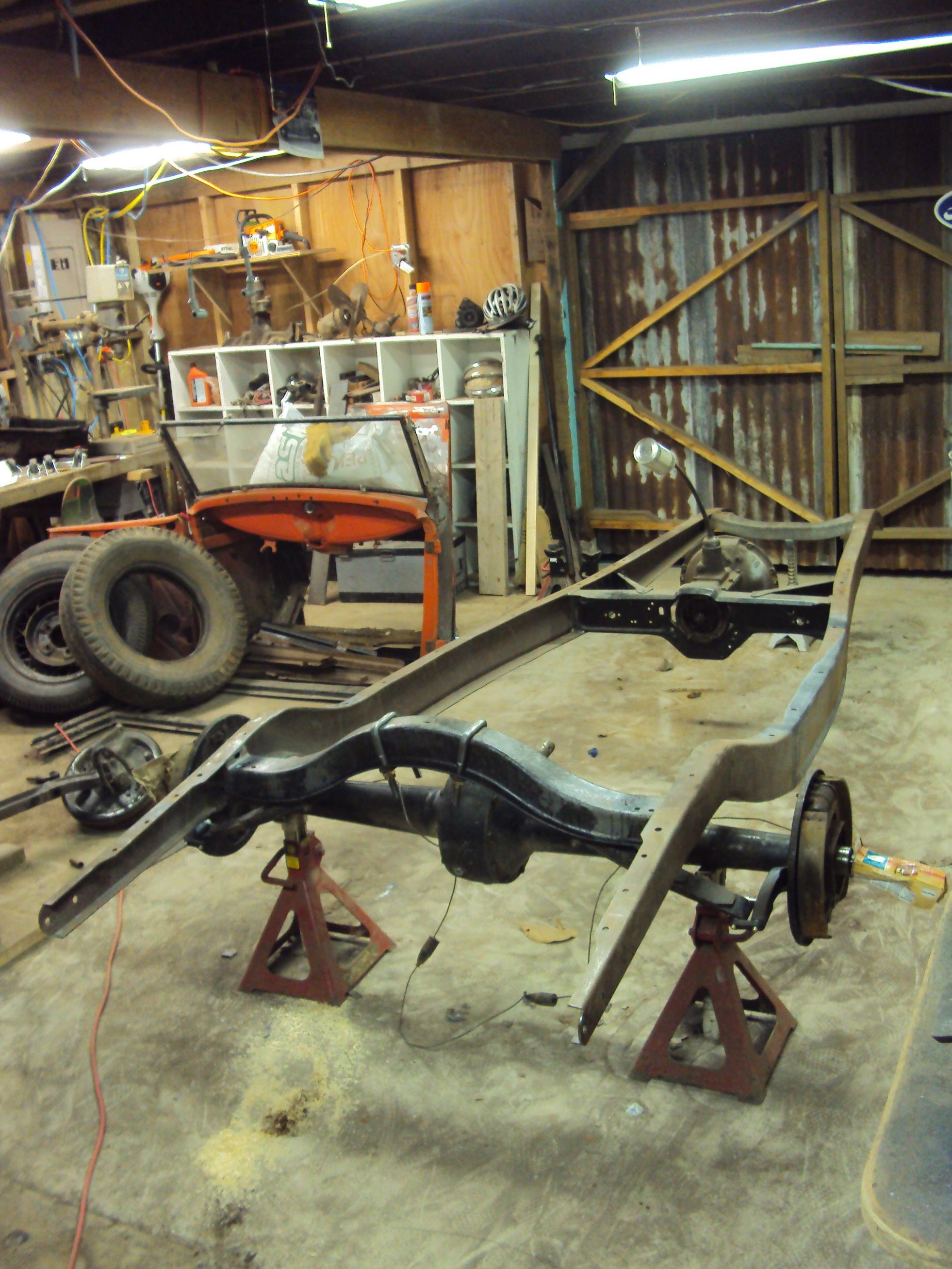

  4. Hey guys here are the pictures I promised, not much but it's what been done in the last couple of days....... oh and today I trimmed the front spring perches and primed them!
    enjoy,
    Joe

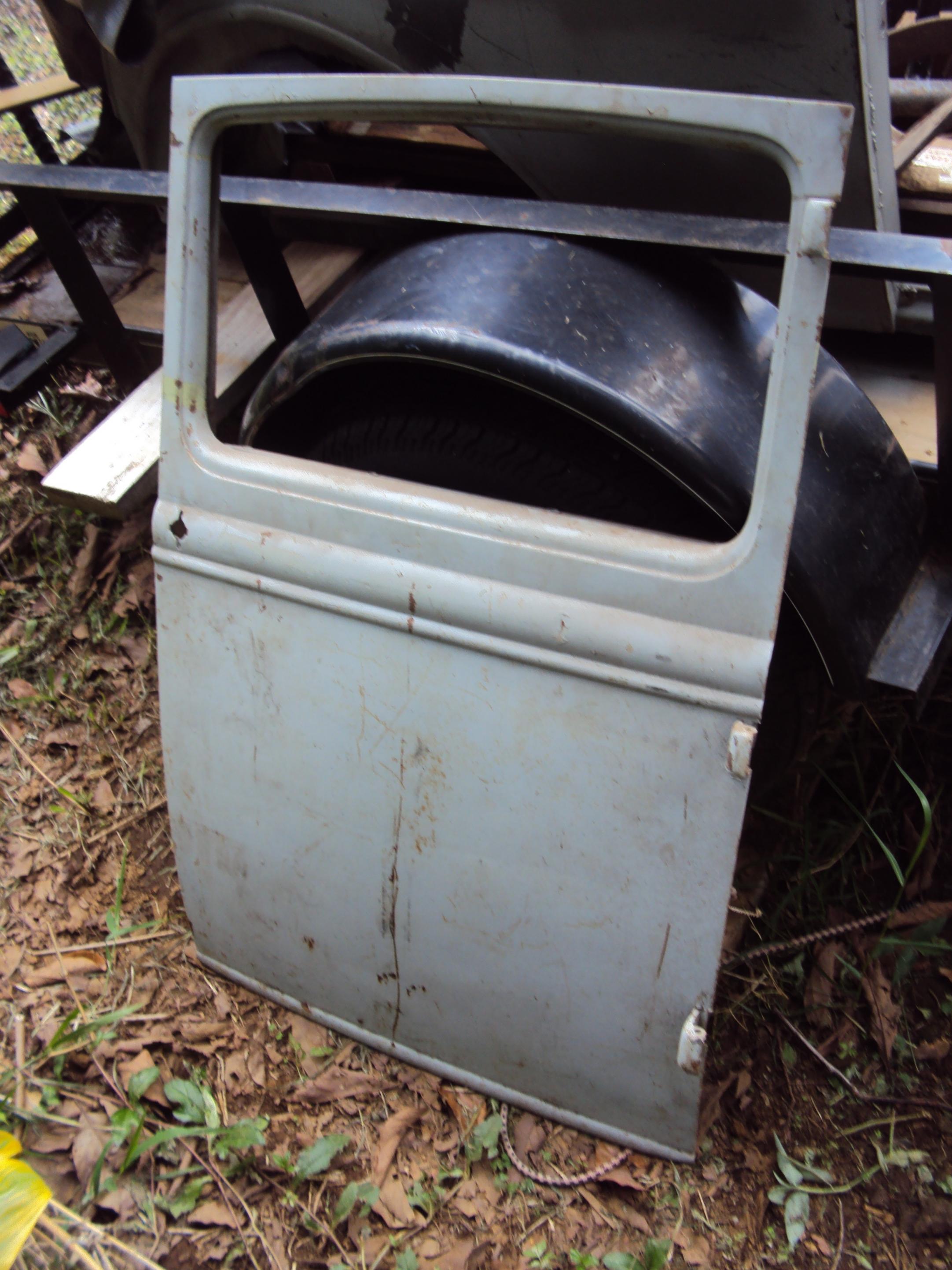

  14. Well I like roadsters a lot too, but ratty mine is a lot worse than that one! nice score! The roadster would be sweet, its gonna take just about every patch panel Brookville makes for it(it needs about $730 worth of stuff from them), then theres still gonna be a lot of pieces I'll have to try and make....
    The coupe needs wheelwell, rear-quarter, and cowl patches, and I already have the wheelwells and a ****py pair of cowl patches(probably gonna new ones). it has a really nice sub-frame, and its a little more special to me, just because I got it first.
    so I'm still thinking about which one, and working on getting the frame rolling for now...

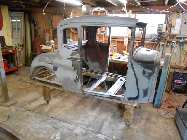

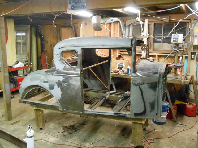

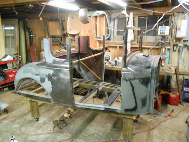

  18. Oh yeah and today I got about an hour in and built a body-dolly, just throwing together s****s...... here it is
    enjoy
  19. Heres the body on it.......

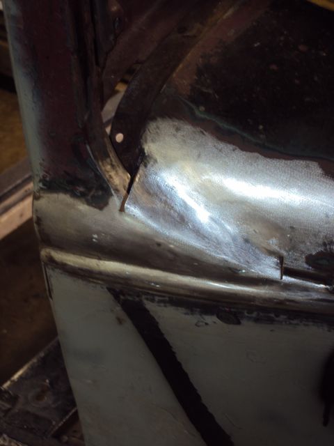

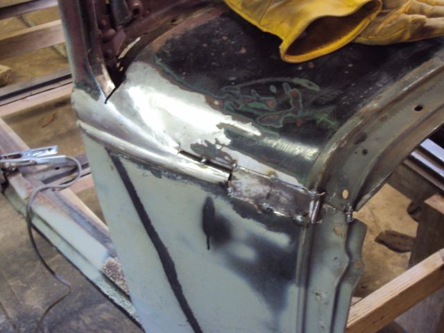

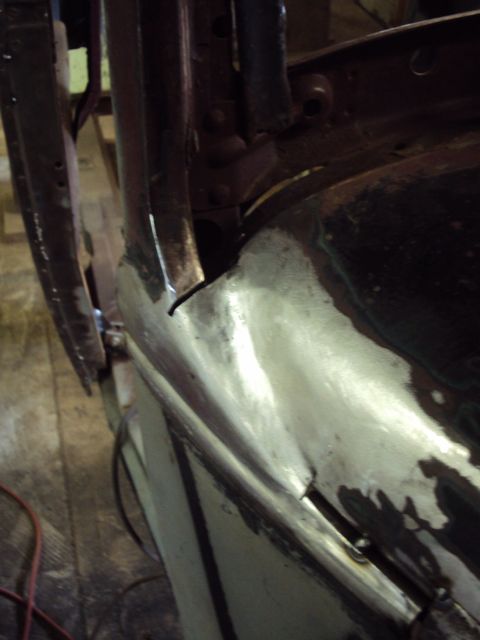

  20. well last night I removed the the tank part of the cowl top, then started molding the top to the sides. I formed a little piece that rounded the body-line and smoothed the transition to the top, welded it, and then finished it.
    here are some pics...

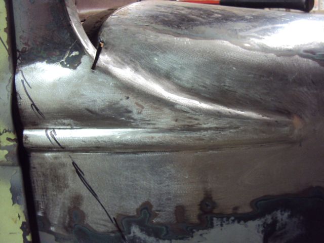

  26. Here's the finished p***enger side cowl section. It's not perfect, but I think it's pretty good for a 16 year old...... next thing is to tackle the other side. I might get to start that tomorrow.
    thanks

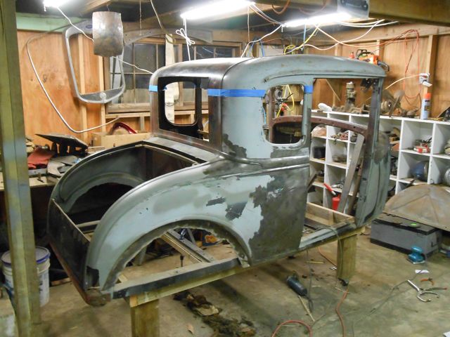

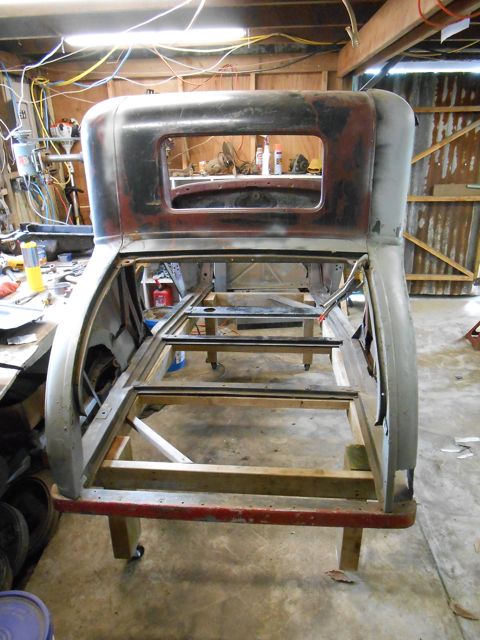

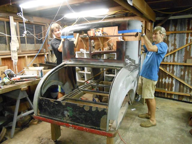

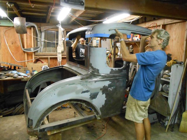

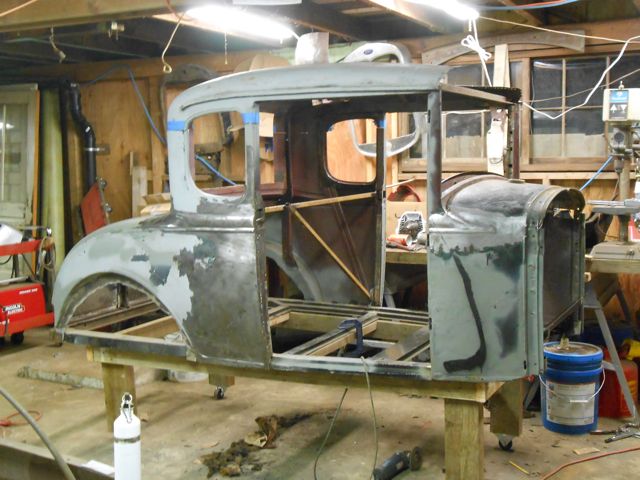

  29. Heres what went on last night in my shop!!!
    choppity chop chop...... Its only 4 1/2" right now, I'm starting with that to get my seat in there and see where my head is.... My plan is at least an inch more in the back, and an inch and a half in the front(and leaned back with no visor)....... going for wedge/lakes chop!
