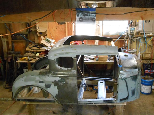

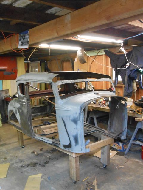

  1. Well tonight I got the chop to its final height, 5" in the back, and about 6-6 1/2" in front. I just kinda leaned it until it looked right.... Its a little less radical than I wanted, but I gotta be able to fit in it, and I'm 6'2"
    sorry no up-to-date photos....
    Joe

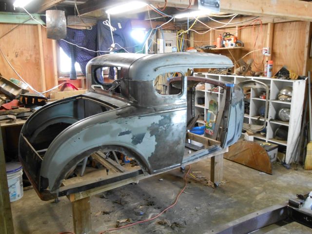

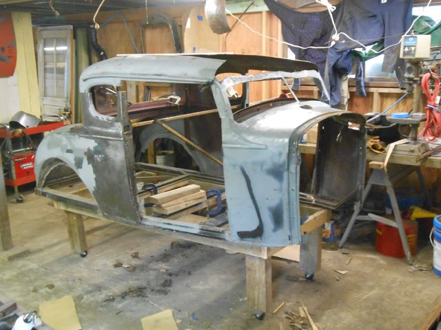

    Heres some photos from this morning

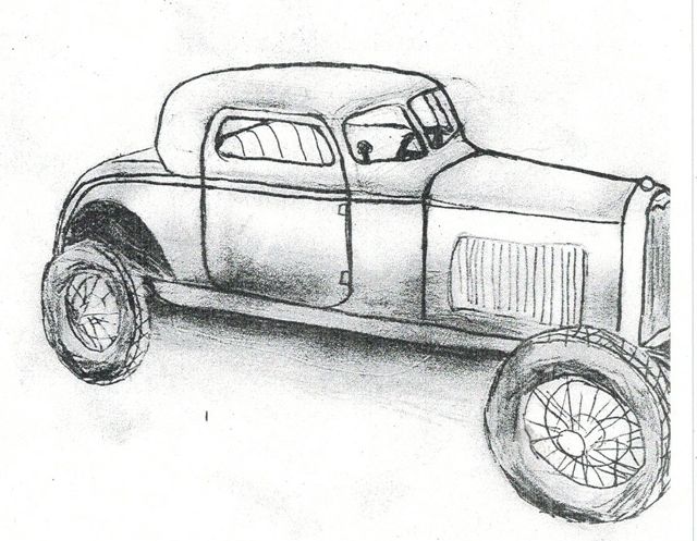

  10. Here's the drawing with the v'd windshield, I realize now that it has a lot of other mods, but just looking at the windshield area, I think it looks pretty cool... but it might not look good in "real life"
    Joe

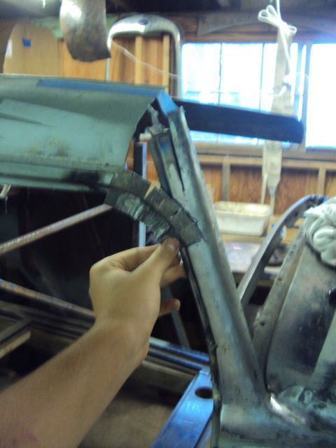

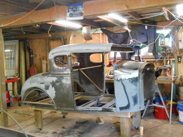

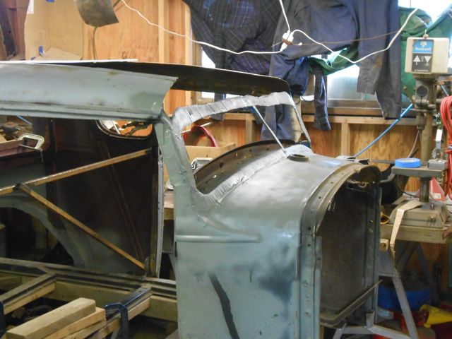

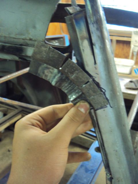

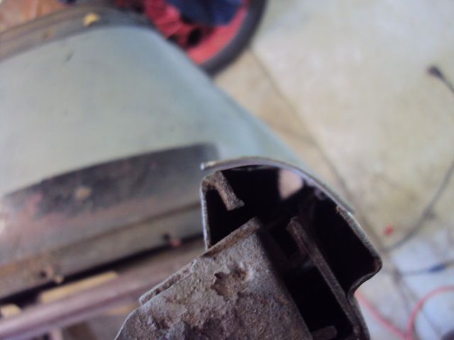

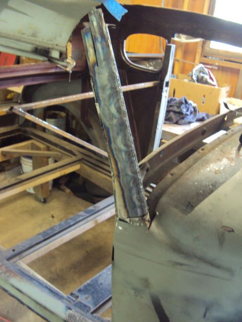

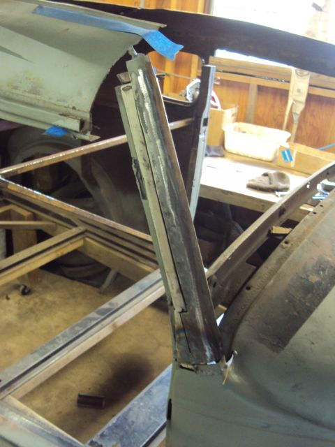

    I worked pretty much all day yesterday on the car.... working on the p***enger side A pillar. I decided to just modify the stock model A pillar, instead of using like a '32 windshield or something..... They're very square when viewed atop, so I decided to change that!
    here's some pics!
  29. round two....
  30. ugh well they aren't really in order, haha sorry
