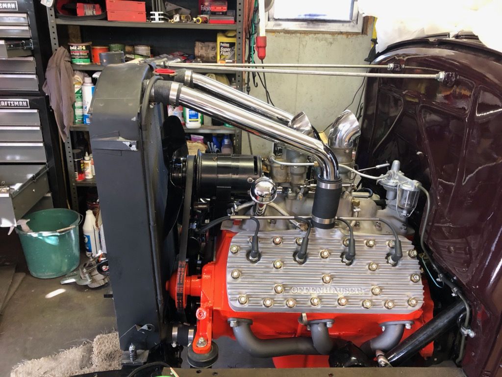

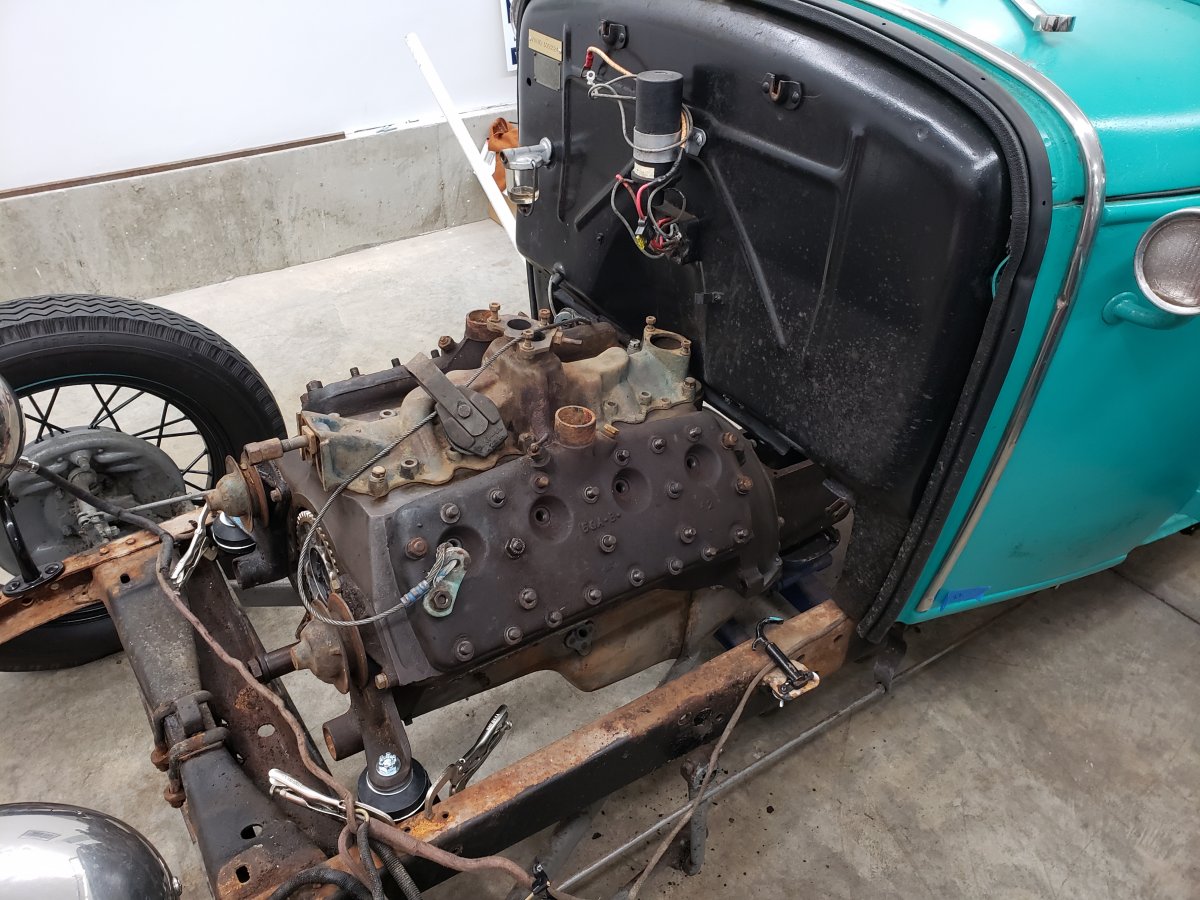

    Finally getting around to building my '30 AV8 with a 59AB and 39 trans . I'm having an issue with the engine hitting the firewall. I put the engine in bolted the trans to the torque tube and put the motor mounts where it landed. I have plenty of room up front. I'm trying to avoid cutting the firewall. The body is sitting correctly over the mounting holes, the body blocks seem to be in decent shape (although I have ordered new ones to see if that helps). I've searched the forum and read threads for hours and everyone is a little different. What am I missing?

    If I remove the rubbers from the front mount I do have the clearance I need. So to use the rubbers I would have to move the brackets lower but looking at most other builds the mounts are on the bottom edge of the frame.
    I've tried raising and lowering the trans also without much difference.

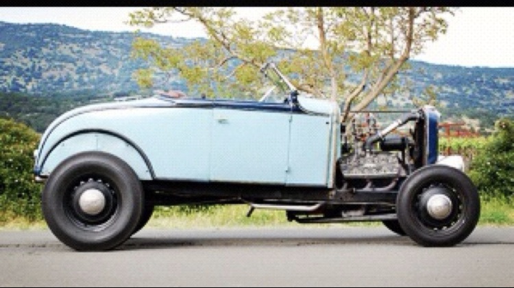

    Fellas, circling back to my response about moving body back a bit. This will give an idea of what 3/4" looks like. No fenders, no problem. Sorry for the pic quality.

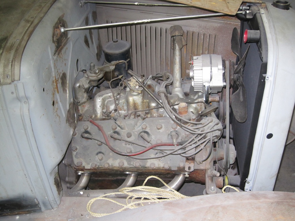

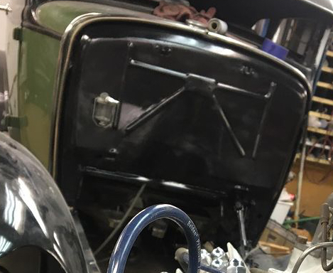

    I tried and tried and tried, then tried again, but could not fit my 8BA without modifying the firewall. But...I also have fenders and the hood, so I didn’t move the body or radiator location. I ended up welding in a portion of a shovel in place, to make a deeper firewall recess just under the beading in the firewall. Looks factory, gives me the room I needed, and tires are in the correct center of fenders, and hood gaps are good. The floor needs modifying in the center a little because of the shovel relief, at first I just ground a v in the wood, but ended up making a metal floor, so I just V’d it when welding it up.

    I was thinking of doing something like that but you lose some spline contact.
    I am trying to use a Model A rear and tube. I am planning on using a 40 rear end and tube in the future which would solve my problem now, but to make things more complicated I plan on using the A wishbone unsplit with Snyders wishbone mount on the trans, which lines up.
    I like the shovel repurpose!

    Do you have any pics of the firewall before you painted it showing better views of the shovel?

    yeah, i like the shovel idea, ingenuity at its finest. but still, this has been done for decades, and in all the old photos it sure looks like there is no mods to the firewall.

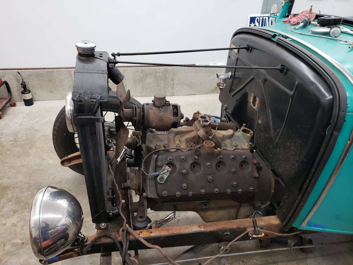

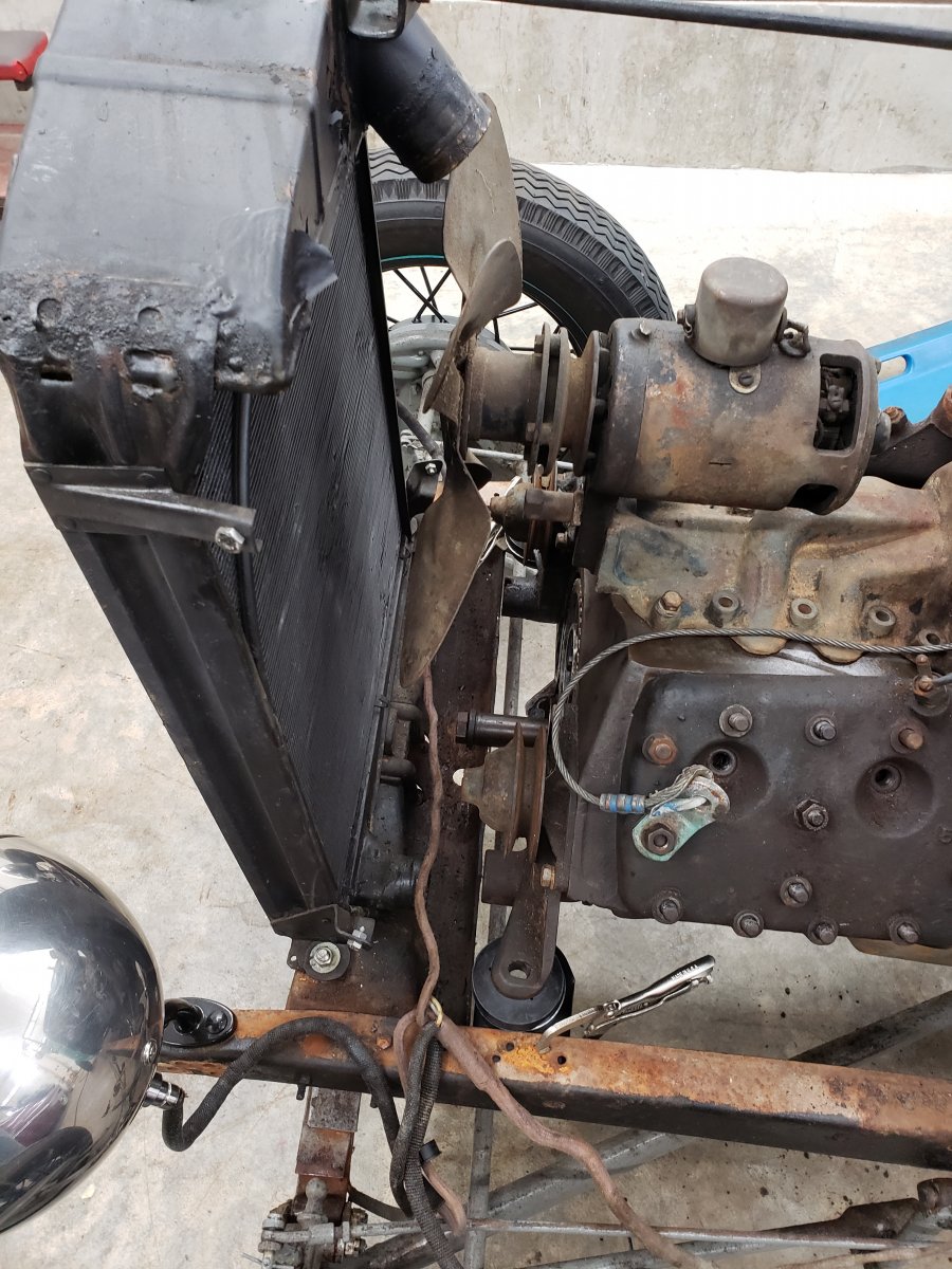

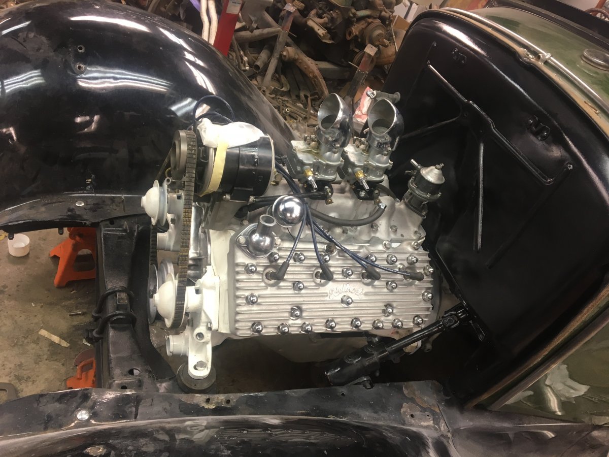

    I'm running an 8BA in my Model A and had to make a small notch at the bottom of the firewall to clear the fuel pump riser. Mocked it together without notching and was too close so did a small notch. I set the engine where the base of the carburetor is level C motor 012.JPG !cid__Photo03061434.jpg plugs.jpg

    I notched out the firewall and used an electric fuel pump , worked great.
    You can also use a torch and heat m***age and shrink to fit.
    IMO modify the filler tube then use a electric fuel pump, you will be glad you gained a few extra horses by not using the mech fuel pump and saved a bunch of grief from firewall issues.
