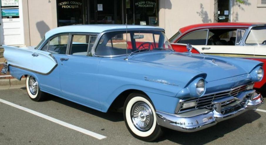

Another Barn find.. Little Christmas present to myself.

    Never2old, it always seem to work out that way! haha. I'll check it out.
    Low budget, thank you for posting that! I already had a watson inspired job in mind for it, now that makes me want to do it even more. Same color scheme even! :eek:

    I saw a 4 door one when I was a kid that was a cooler lookin shiney blue with a bunch of white scallops similar to this one is why I saved that pic when I came acrossed it.
    I remember walking from a distance at a local show to look at whatever this cool ride was and had walked part of the way around it before I realized it was a 4 door with shaved handles and scallops that kind of helped subdue the fact but that to me made it even more cool and mysteriously more interesting than if it had been a 2 door.

    Points and condenser, should do it.

    Get you a test light if you dont have one. Auto electritions best friend. Hook the aligator clip to a good ground and see if it lights up when you touch it to the + side of the coil. If not then work your way back to the ign switch and see where your loosing fire. If it lights up there then unhook the wire from the - side of the coil and see if its hot there. If not then the coil is bad.
    If it lights up then turn the motor over and see if the light flashes. If it dosnt then the points are either not closing or are oxidized to bad that they are not making contact, or the wire between the coil and points is broken. Pull the distributor cap off and see if you have fire where the wire hooks to the points. If not then the wire is bad, if so then the points are either not closing or oxidized.

    Forgot to mention I changed out the coil, along with all the battery cables too. Looks like i'll be running to get points & condenser.

    SHE LIVES!!!
    Changed the points and condensor and didn't get anything, so we byp***ed the resistor and she fired right up. Going to take advantage of my day off and the nice weather and do the brakes. Pictures later.:)
    The y-block is staying. After looking up videos on youtube and hearing it run its too cool to swap out
