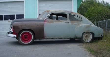

    I am normally anti-chopping of fastbacks, but yours looks like it has some nice proportions. how about a better side view

  6. My shop is a little small for a full profile view but here's two more pics.

    Perfect flow. Very nice job.

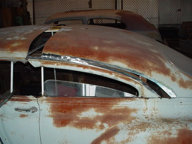

  16. Thanks for all the compliments!! I have quite a few in progress pics but most are from the same angles (I rent a small corner of a large shop and can't really move the car much) I'll try to post some here and there. The pics in black are where it's at currently, the car was purchased in '02 and the majority of the chop done 2 or 3 years ago. I just recently lit a bonfire under my *** to finish this project and purchased the rest of what is needed to make it roadworthy I hope. Still will be a major work in progrees when drivable but I can't wait anymore. Focus, focus...
    How I bought it in '02
    Doin' the deed, 5" at front windshield.
    Early mockup of 4" stretch detail (too eager to start cutting, not stipped yet) Also rear section ended up being layed down quite a bit more and front half decrowned a little after this pic was taken.

  28. A few more pics of the chop in progress.
    -Roof dropped down, 4" stretch, rear window frames forward (afterthought, but helped window/rear half proportions, plus I didn't have to fabricate a section of driprail), rear section laid down, slight decrowning of front section to start flow, filling in gaps.
