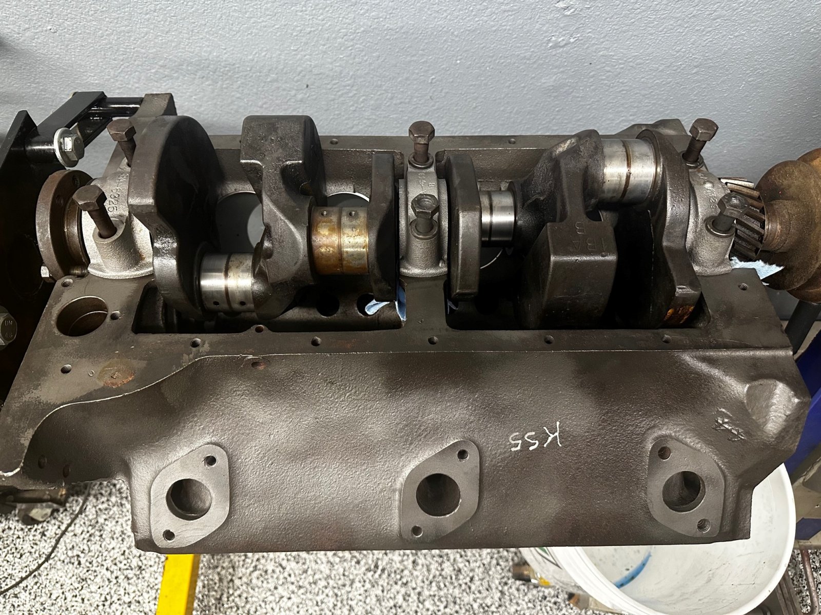

    I just had this 8BA dropped off from a guy cleaning house etc. So I decided to tear into it. Got it unstuck only to find this crack in a cylinder wall. Honestly I have never seen a crack like this. I am guessing a freeze crack from water in the cylinder? So I must ask, is this a candidate for a sleeve job? Or a done and salvage the parts?

  2. 57 Fargo
    Joined: Jan 22, 2012
    Posts: 6,328
    57 Fargo
    If all else checks out put a sleeve in it, they aren’t making anymore of them.
  3. wheeldog57
    Joined: Dec 6, 2013
    Posts: 3,910
    wheeldog57
    I'm with Fargo, sleeve, rings, and bearings.

  5. Glenn Thoreson
    Joined: Aug 13, 2010
    Posts: 1,017
    Glenn Thoreson
    from SW Wyoming
    It's pretty plain to see the whole thing has been sitting under water. It can be sleeved and sleeves are readily available. Before you spend any money on it, though, get it cleaned up to see if there are more cracks. Carefully check the oil pan rails at the bottom of the water jackets. They tend to split open first if there was water frozen in there. Usually not repairable.
  6. Squablow
    Joined: Apr 26, 2005
    Posts: 18,747
    Squablow
    It's got an 80 over piston in it already, if I'm reading that right. I know some flatheads can go to .125 but an 80 over cut is pretty uncommon just for regular daily driver rebuilder use I would think. Maybe that's what helped crack it, thinned the walls out a bit too much?
    If you get it all apart and checked and there's no other issues, it probably could be sleeved. But unless it checks out good for another 30 over cut (or more, looks rusty inside), you might end up sleeving every cylinder to keep the walls from getting too thin by the time you're done.

    8BA's usually can go to .125 with no problem. I have done three at 3 5/16" myself. The only problem I ran into was a pit exposed by the overbore in one cylinder. My machinist said it could be used as is, but I had him sleeve it anyway for $100 just to be sure. Back in the day, 296 ci flatheads were the way to go (the famous 3/8 X 3/8). A lot of guys have gone to .030 over 3 3/8 or even 3 7/16. Of course core shift or rust can get you, but Ford's quality control was very good in those days.
  10. stubbsrodandcustom
    Joined: Dec 28, 2010
    Posts: 2,625
    stubbsrodandcustom
    from Spring tx
    Had me curious also... Here we are, weird deformation by the oil pump area on the oil pan rail. Rest of the rails are solid it looks like.
    Few pics... Yalls guess is as good as mine on this little bump out area.
    VANDENPLAS likes this.
  11. dwollam
    Joined: Oct 22, 2012
    Posts: 2,880
    dwollam
    That looks like it has been welded and ground down on the pan rail. Weird.

    Well, pulled it the rest of the way down. Everything looks good, bearings and other areas. So may load it up and bring it to the machine shop and see how it fluxes out.

    The verdict is in.
    2 cracks at valve seats and the one cylinder that needs a sleeve, thats all.. So I think I will get it all sleeved to standard unless someone has some .030 pistons that are good and cheap. They said they could sleeve the 1 and cut everything else to .125 without issue but that's deff a large oversize bore.

    Yeah, I threw $ at it and had em all sleeved. Yeah its a big difference but a few of the holes were still not 100% at .125 when they cut it so I made the decision. The cracks were drilled and pinned then s***ched. They replaced the two valve seats that the cracks were by so I have 14 old seats and 2 new...
