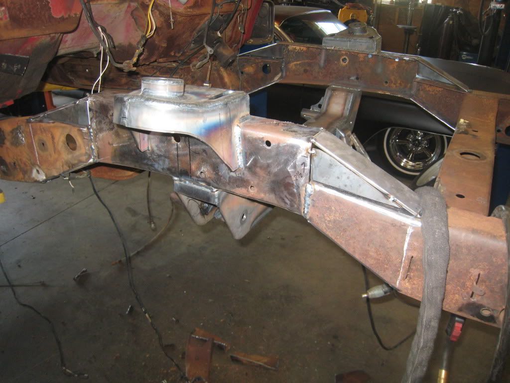

    day 6
    we got the front suspension all in and welded up, just need to make shock towers, and the bag brackets. i also finished up the pan hard bars and links. still need to do up the rear shocks
    also pulled the axles out of the 9" again, i wanted to have the axles drilled for small ford pattern, to open up wheel options in the future.

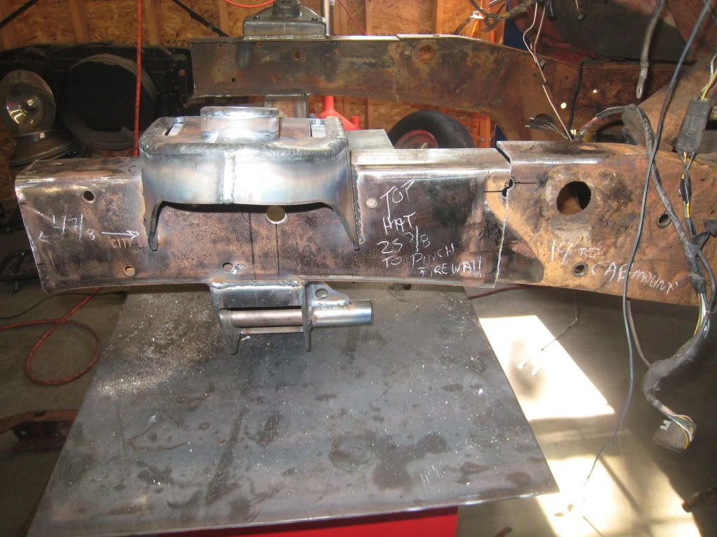

    i got the mm2 all ****oned up, frame boxed in, and the 2.5" z in the front frame rails done today, oh and mounted up the motor and trans mounts. with the frt z and this cobra gt whatever oil pan on my motor im goign to have to rebuild and section every single f'in x member in this thing.
    some random shots....

    Hey ryno I got a couple questions. Is this a homemade crossmember kit or manufactured and what is the distance between the top of your spring hat to the center of the lower CA mounting bolt? Looking really good so far and cant wait to see the finished project!!

    its a kit from jw garage i believe, my buddy is a dealer for them. it's decently priced, definitely not the nicest, but plenty good enough for what im doing here, i mean it has 2 arms and a spindle with some brakes, good enough for me!
    i measured the distance for you, but forgot the exact measurement, i believe i hooked the top of the hat at the frame rail, down to the cl of the lower a arm bolt and it was 10 1/8"....
    thanks, my body is paying for all the 16 plus days.
    pm me some more info and prices, sometimes it just doesn't make sense to make something if it can be bought, skills or not, time is money!
