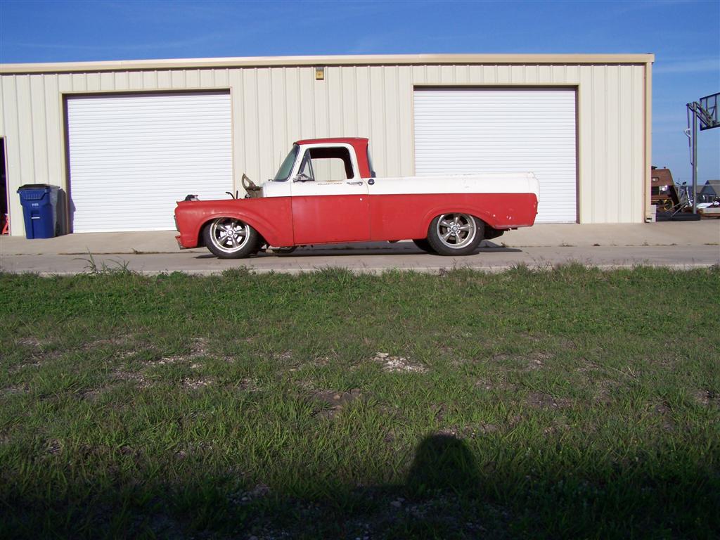

    finally finished up the bag mounts front and rear.
    sourced out some more cragars, trying to get a good fit.
    ran into a little hick up when i went to install the rack on the frame today, the rack is about 1/4" shy of clearing the cobra oil pan! damn it. so i pulled the motor and ****** out and decide it was a good time to give them a bath, so they're clean and ready for the final ***embly hope fully next weekend! im going to install a stock oil pan, one that doesn't have the extra bulges and capacity on the side.
    pulled it off teh lift and rolled it outside to get a look. im pretty pleased. i need to figure out a better fitting tire and wheel for the back. i have a set of 14x8 cragar, just need to mount a few different size tires on them and see what i like. i originally wanted to run a set of 10 wide fenton's i have with a 265 tire, but bfg stopped making them 2 years ago, double damn it!
    some pics from today..

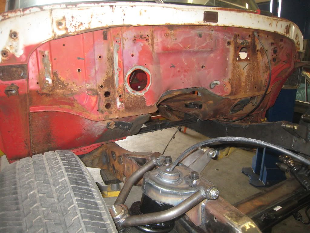

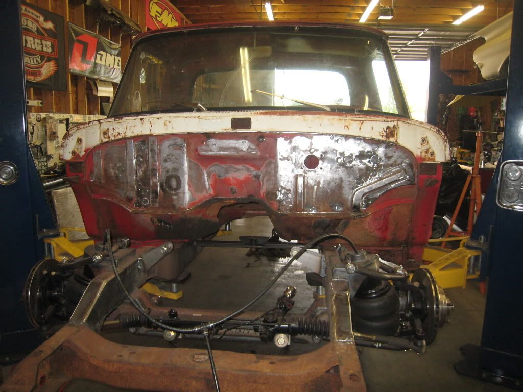

    got the whole dash and firewall gutted, pulled all the wires, switches, etc out of the cab, and got the fire wall all shaved/welded up.
    got a few different tires mounted up and fit to the rear 8" wide cragars also.

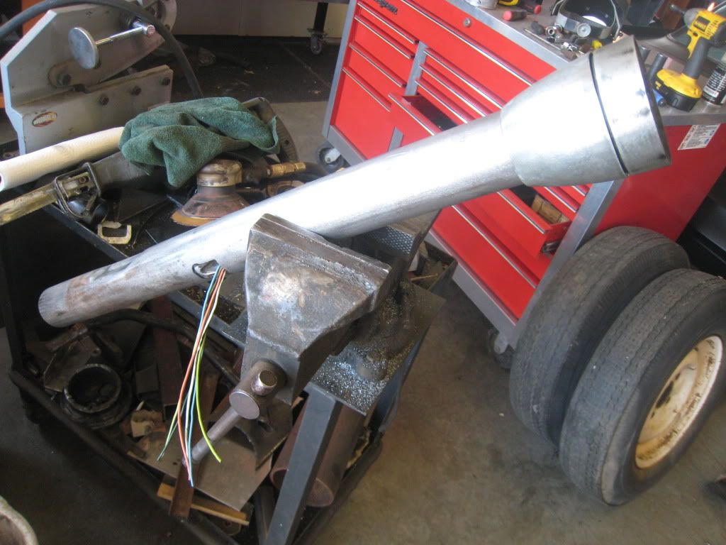

    i got the steering column all torn apart, cleaned up and da'd down for the paint work.
    moved it up closer to the dash, and centered it in the dash instead of the offset, why did ford do this anyways? shaved up the stock column shifter boss also.

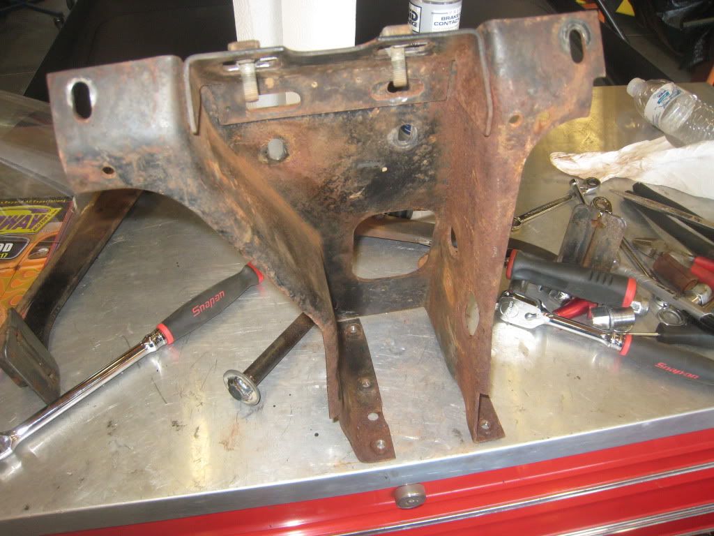

    reworked the stock brake pedal mount also. took out the clutch pedal, had to shorten the pivots up and added a new end. im going to move teh actual pad over also once i get a booster hook up to it. i don't like the factory location of the pedal.

    got a bearing and sleeve retainer made up today for the end of the column.once i get the column in place ill set screw in my retainer, it is a press fit now, but id rather know for sure for sure it wouldn't work it self out over time.
