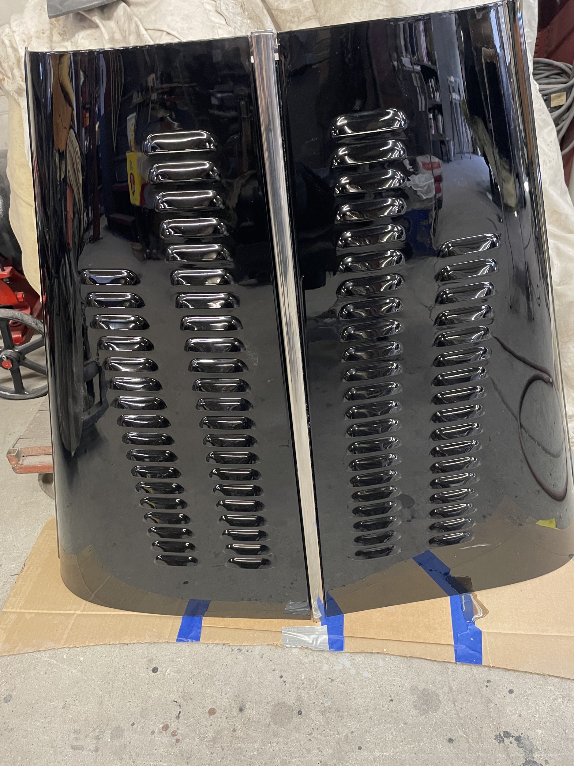

    Now I need to pay Beth too!:eek:

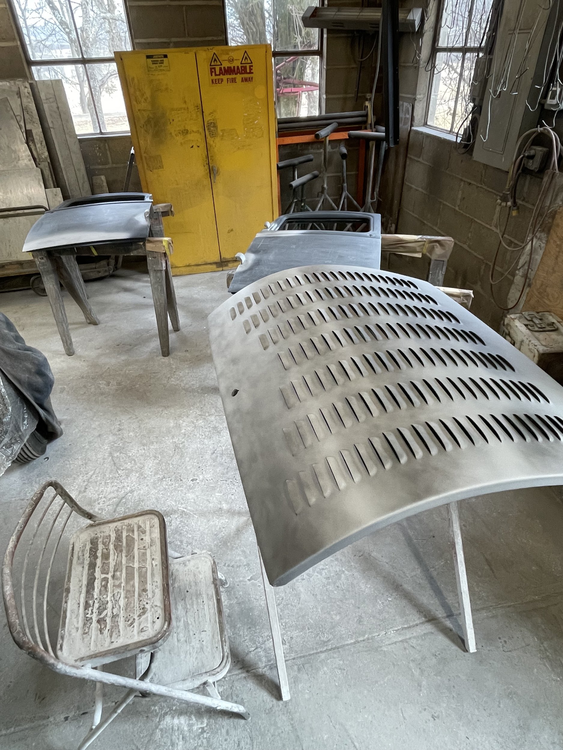

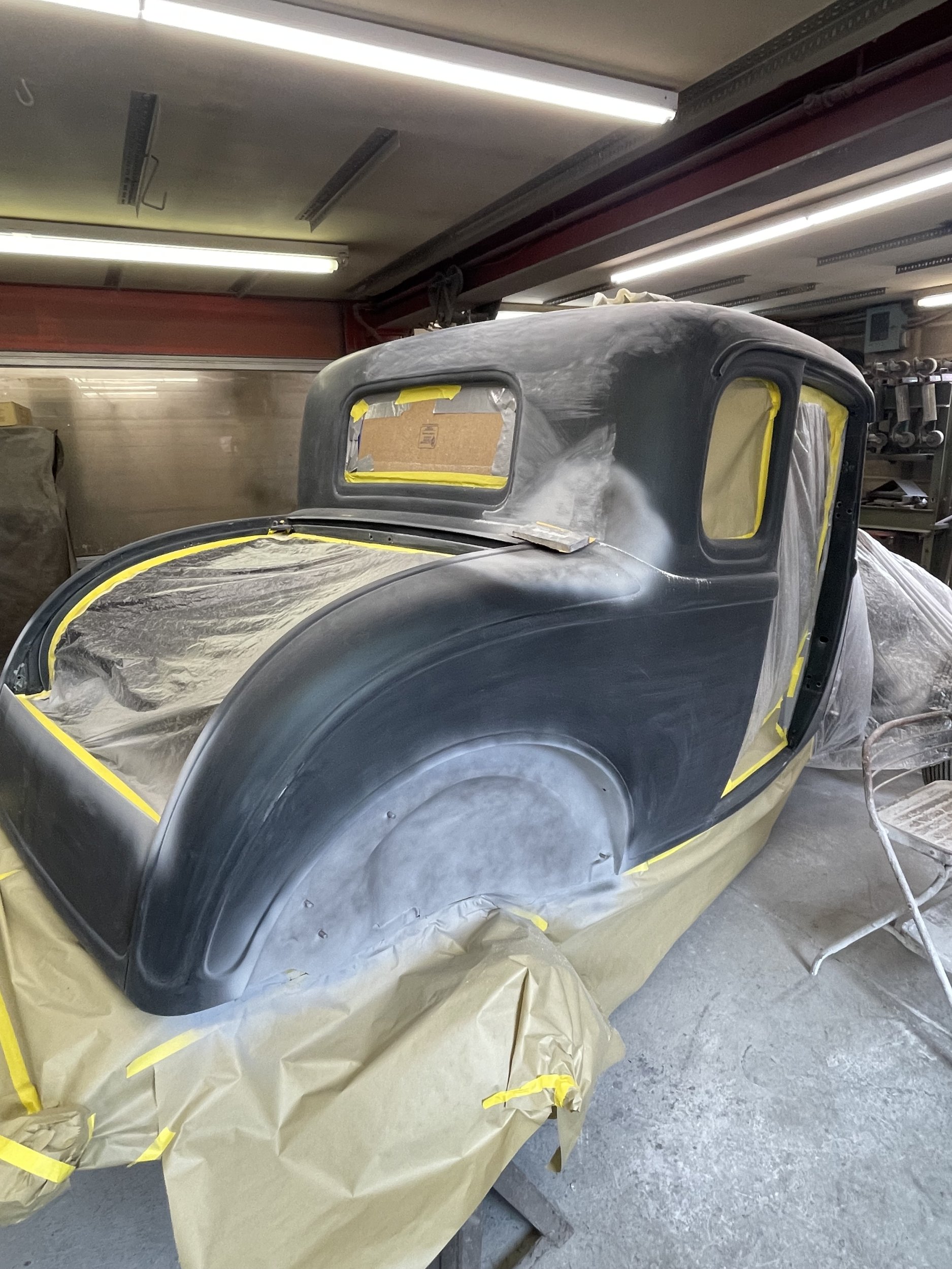

    More progress thanks to Beth.:p IMG_7697.jpeg

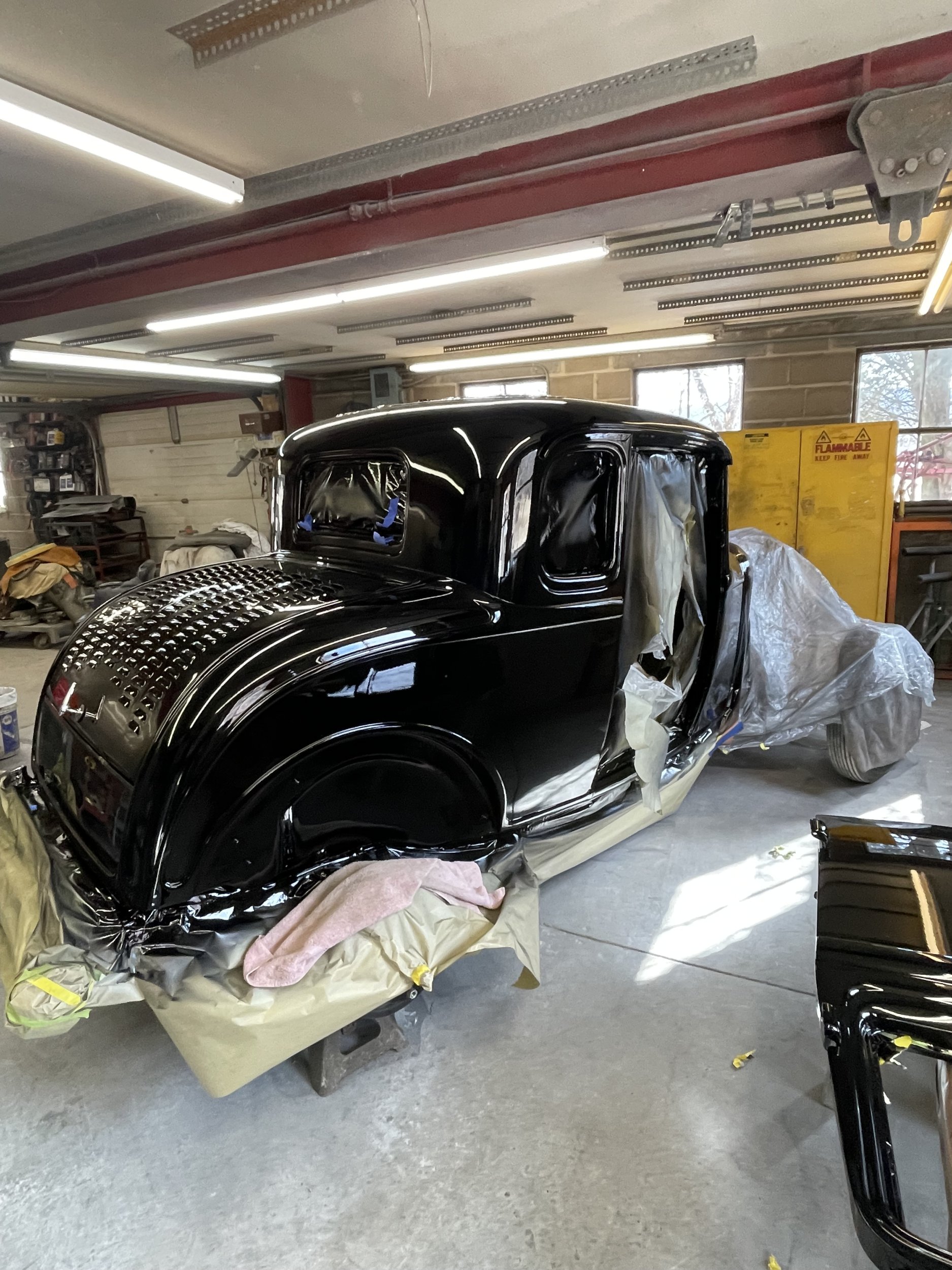

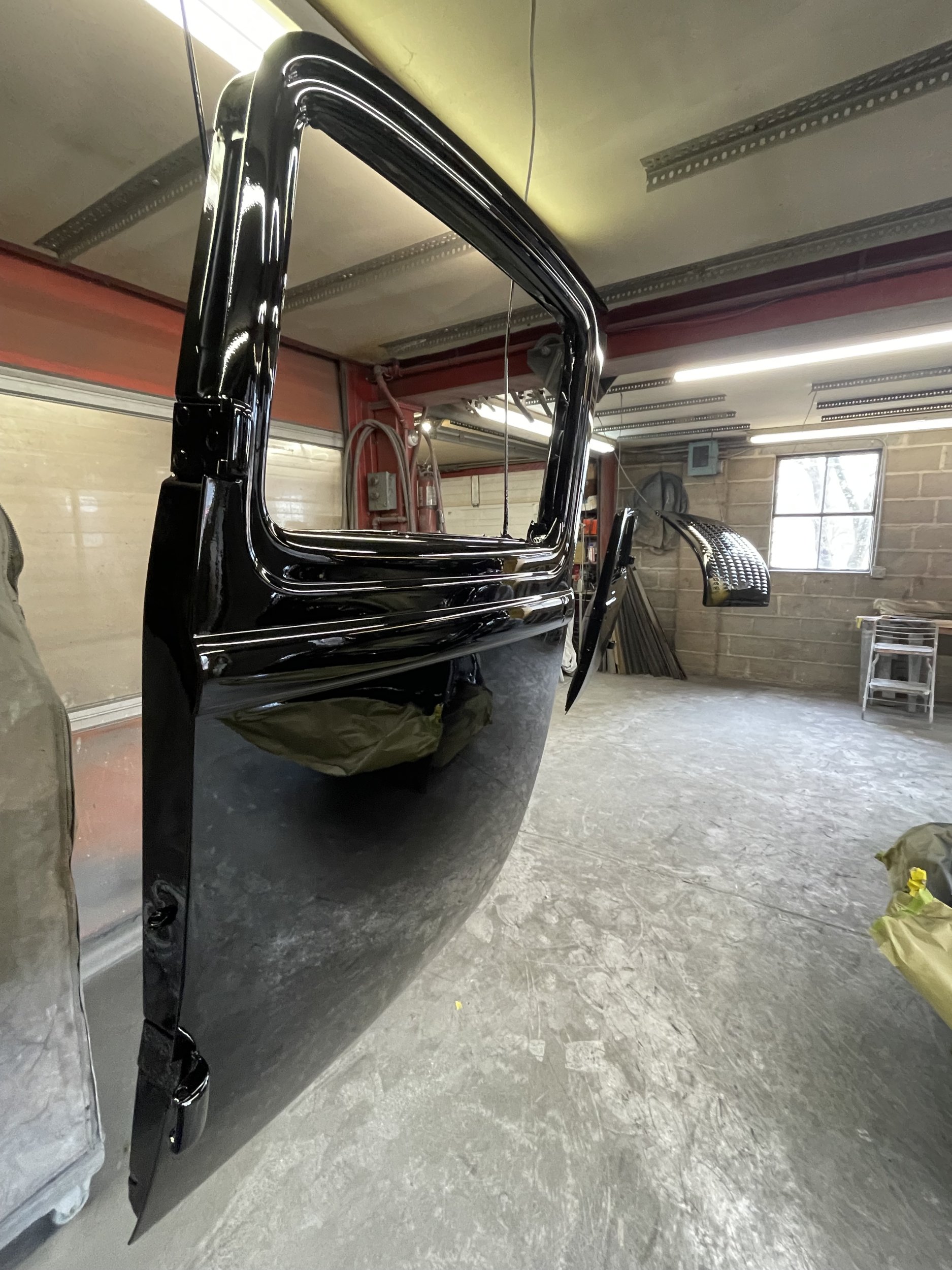

    Let the wet sanding begin!

    Looks like just compound!:cool:

    not just compound. 1500 -2000-by hand then 3000 on the soft pad DA then buff, course compound, light compound then final glaze..... pretty paint ****s....

    Ted that looks fantastic straight out of the gun. Doesn't need all that extra work. Mark doesn't need a "show car" LOL

    we could just buff it, but it will look better if we sand the little imperfections out. the devil is in the details

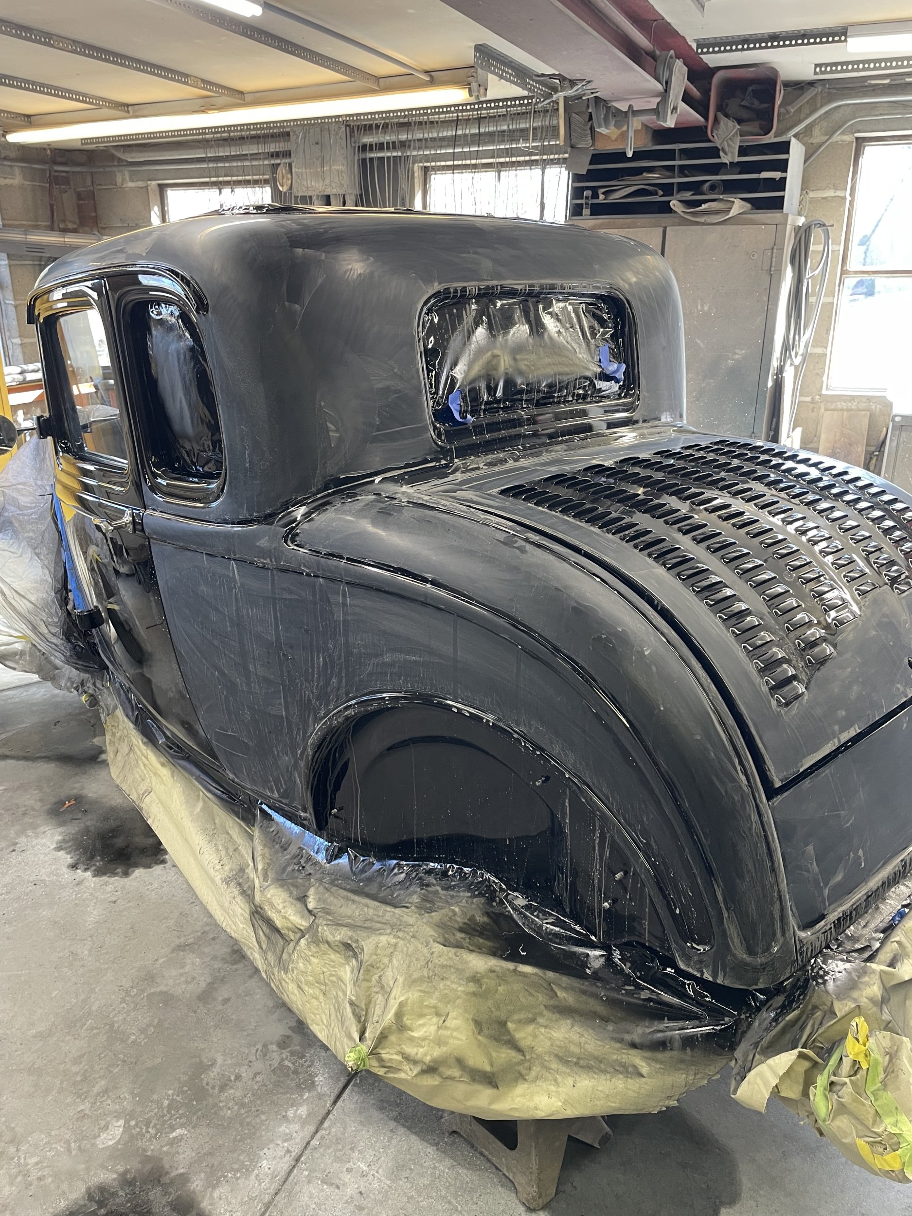

    Yes, I installed windshield, doors and lots of hardware. Car all sanded and Ted is buffing like a man possessed.:eek: IMG_7714.jpeg IMG_7715.jpeg

    long day of sanding and buffing, final two steps tomorrow

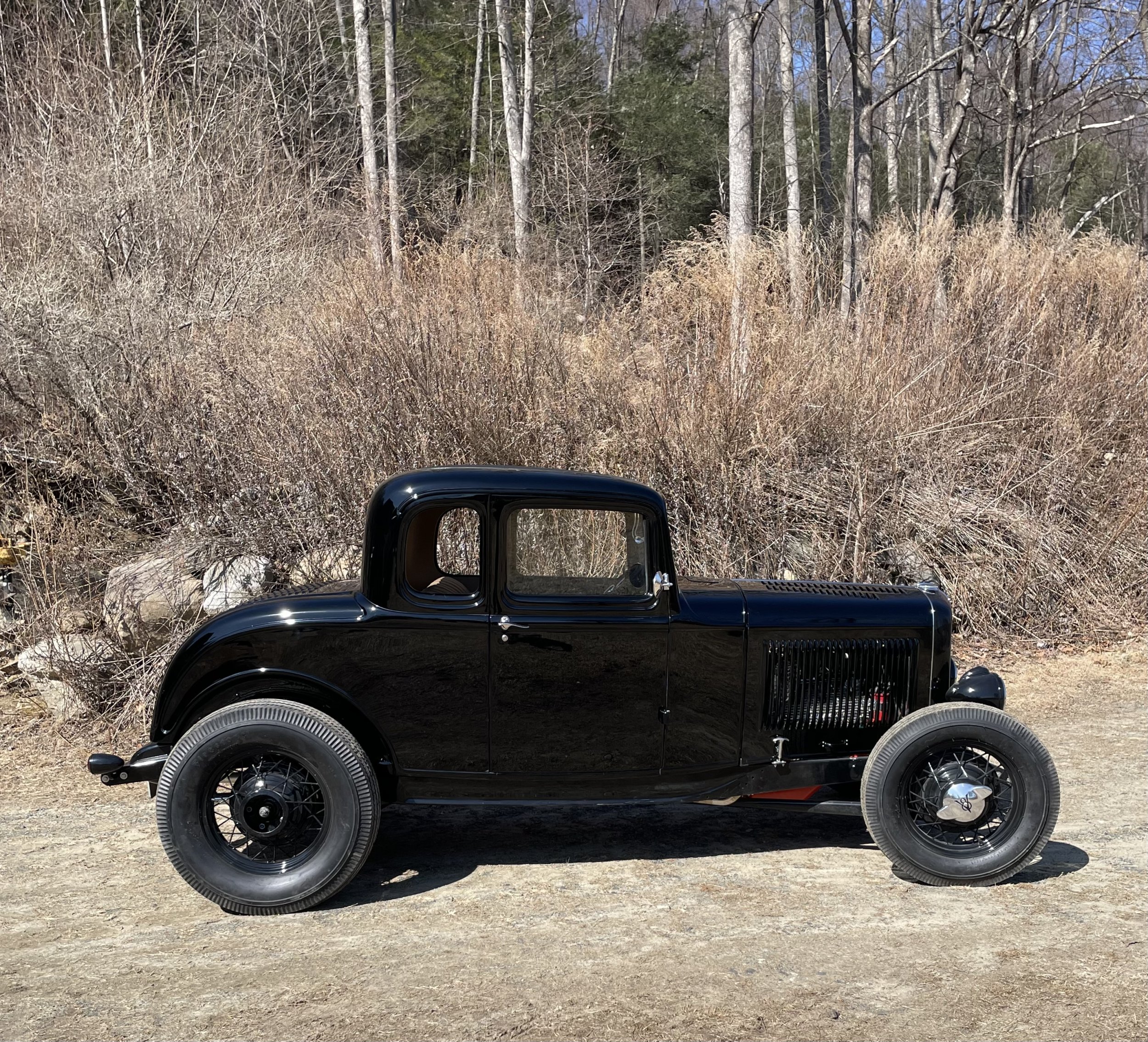

    Drove the coupe home today. Now to start top to bottom cleaning. Also need to put it all back together. Amazing how much is involved when repainting finished car. Just spent a couple of hours under the car. Just had a visit by this big guy to check it out. He likes Black!:rolleyes: IMG_7716.jpeg IMG_7719.jpeg IMG_7722.jpeg IMG_7724.jpeg
