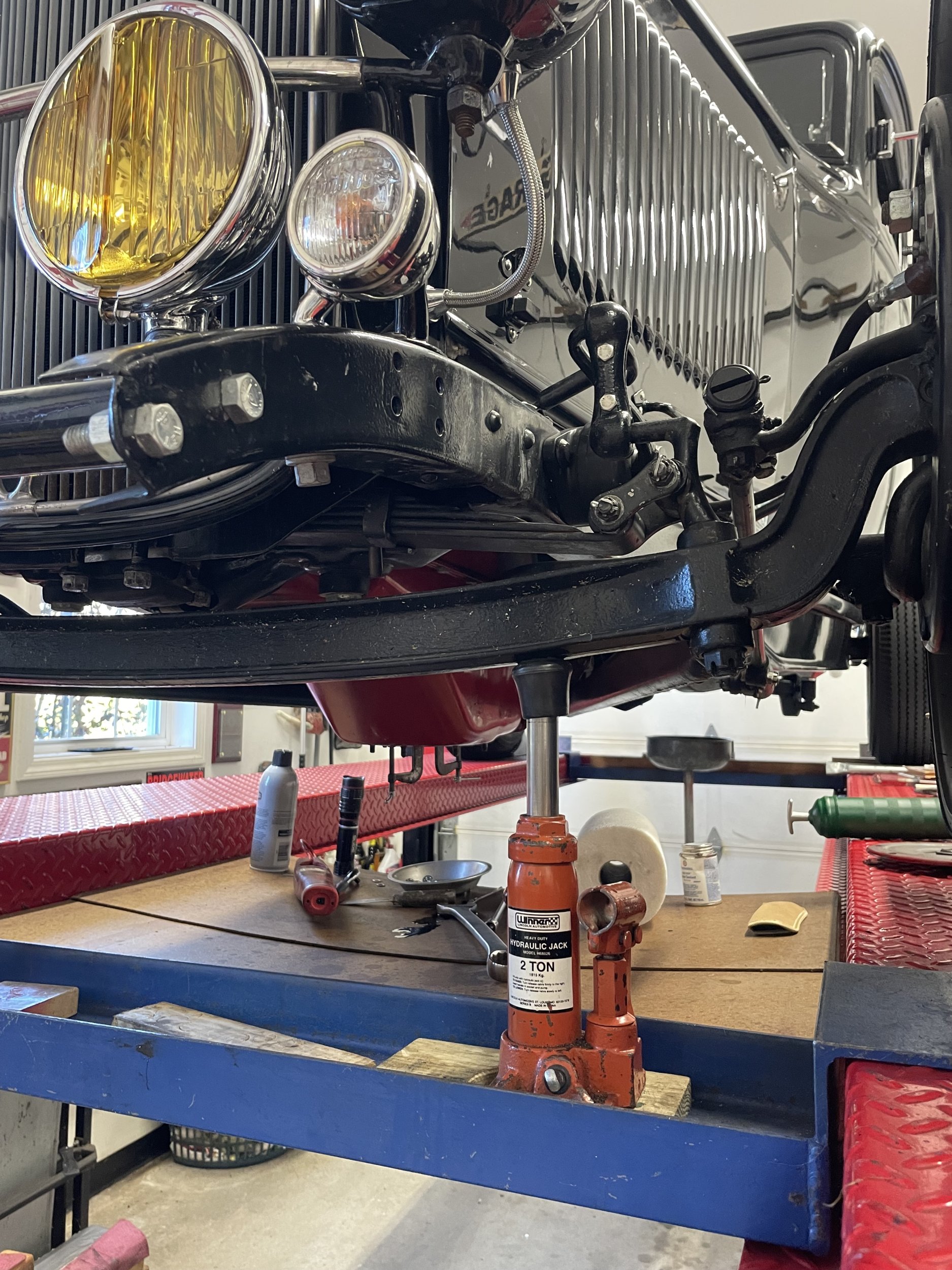

    Changed all the lubricants this week. Looked like it was never done. The Mitchell overdrive was never properly serviced either. Rear shocks will get a redo next . Remounted gas tank yesterday. Also redid a wire cover before I cut myself on it. Something's on car done so well like interior then other stuff just not up to my standards. IMG_9121.jpeg IMG_9119.jpeg IMG_9132.jpeg IMG_9133.jpeg IMG_9134.jpeg IMG_9135.jpeg

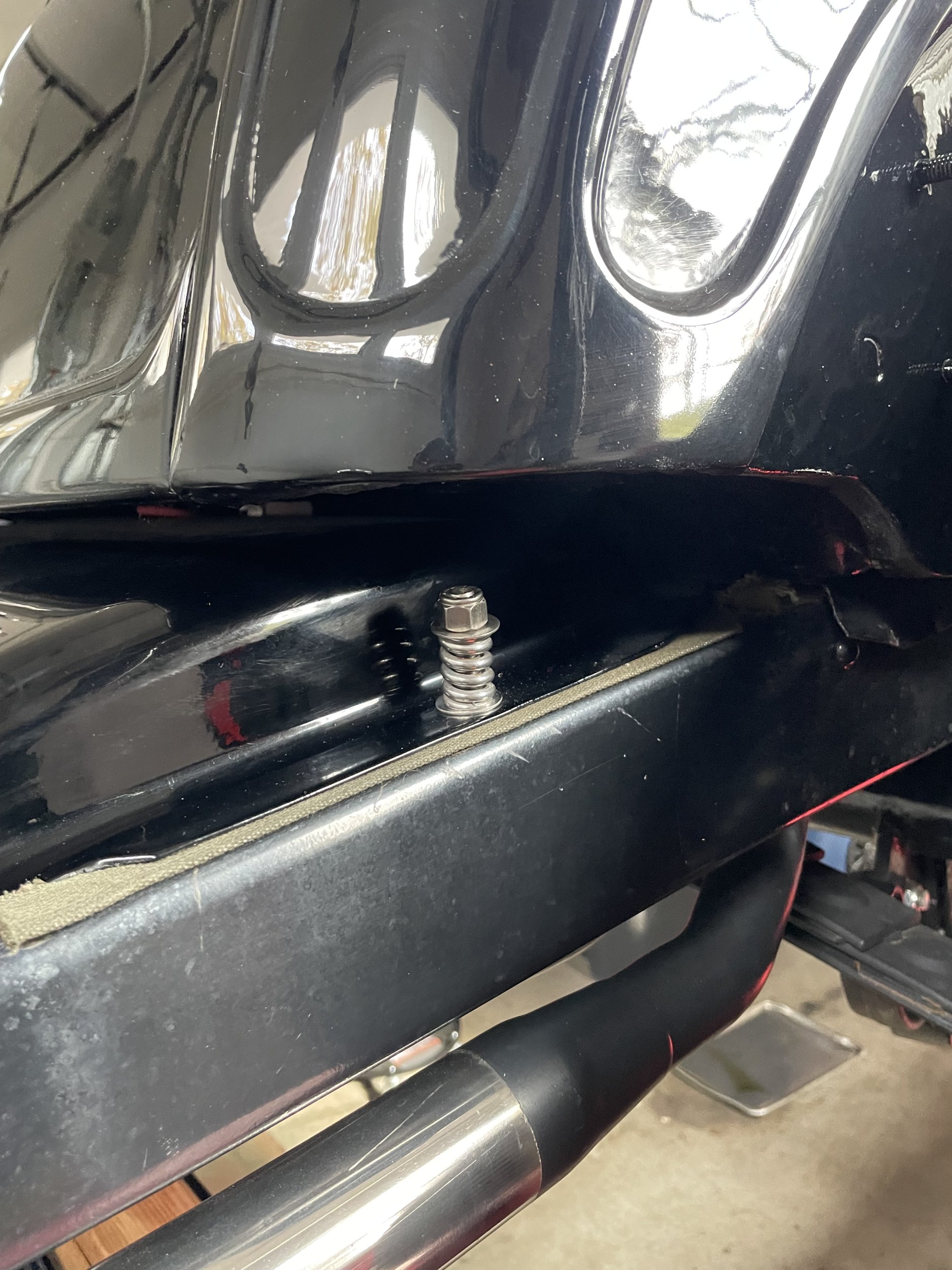

    Not feeling all that great today so I only finished off the trunk bottom rail. Had to install missing rubber stops. Because of thickness of trunk upholstery I had to modify them.
    Also put end fasteners in place. Trunk shuts nice and tight now . My rule, if it there it should be used. Whether it's a hole or a component .I just keep plugging away.

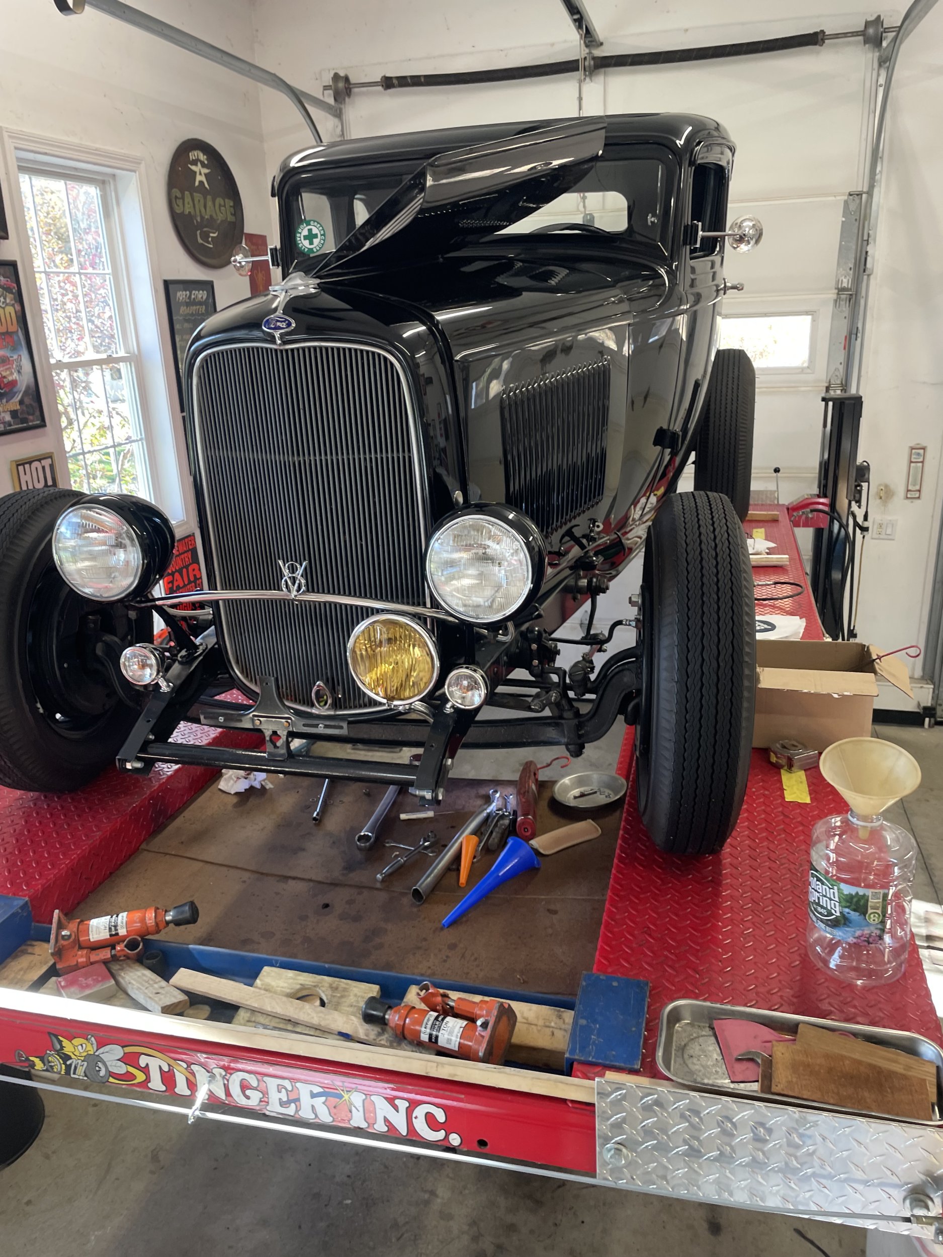

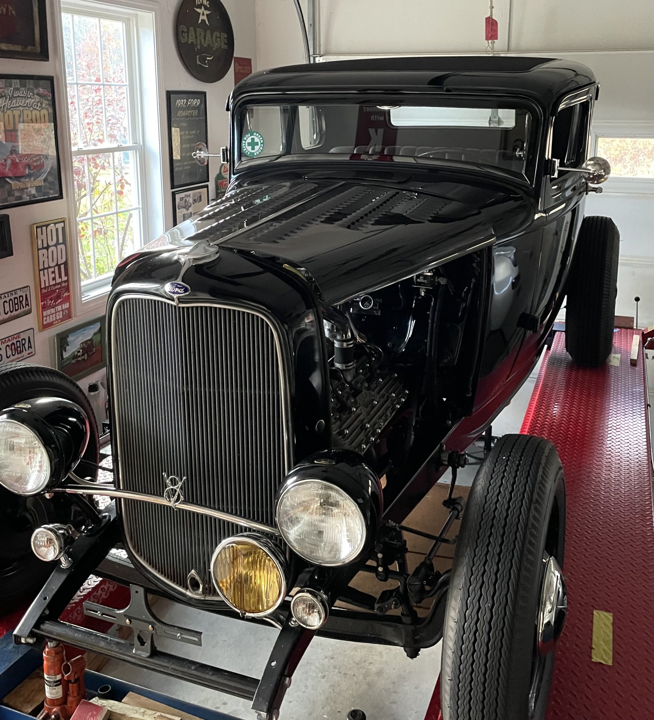

    IMG_9144.jpeg IMG_9160.jpeg Tb33anda3rd trailered the coupe for me today to get a vin verification. Just need an appointment with the DMV now to get it registered before I start digging in to this project.

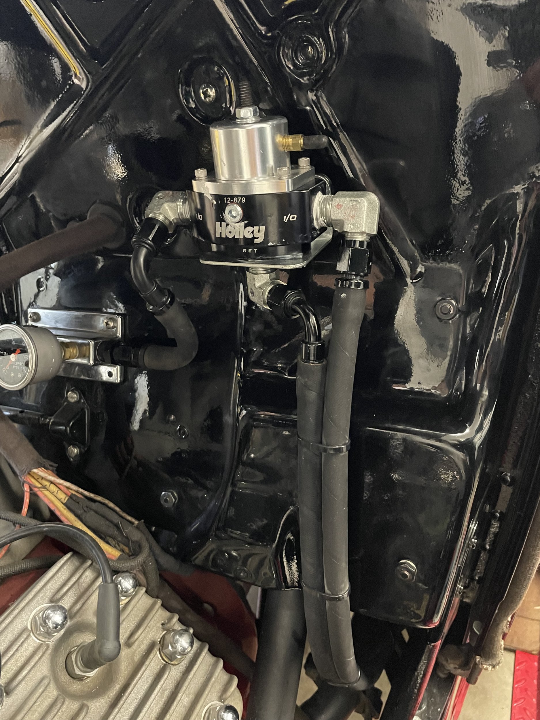

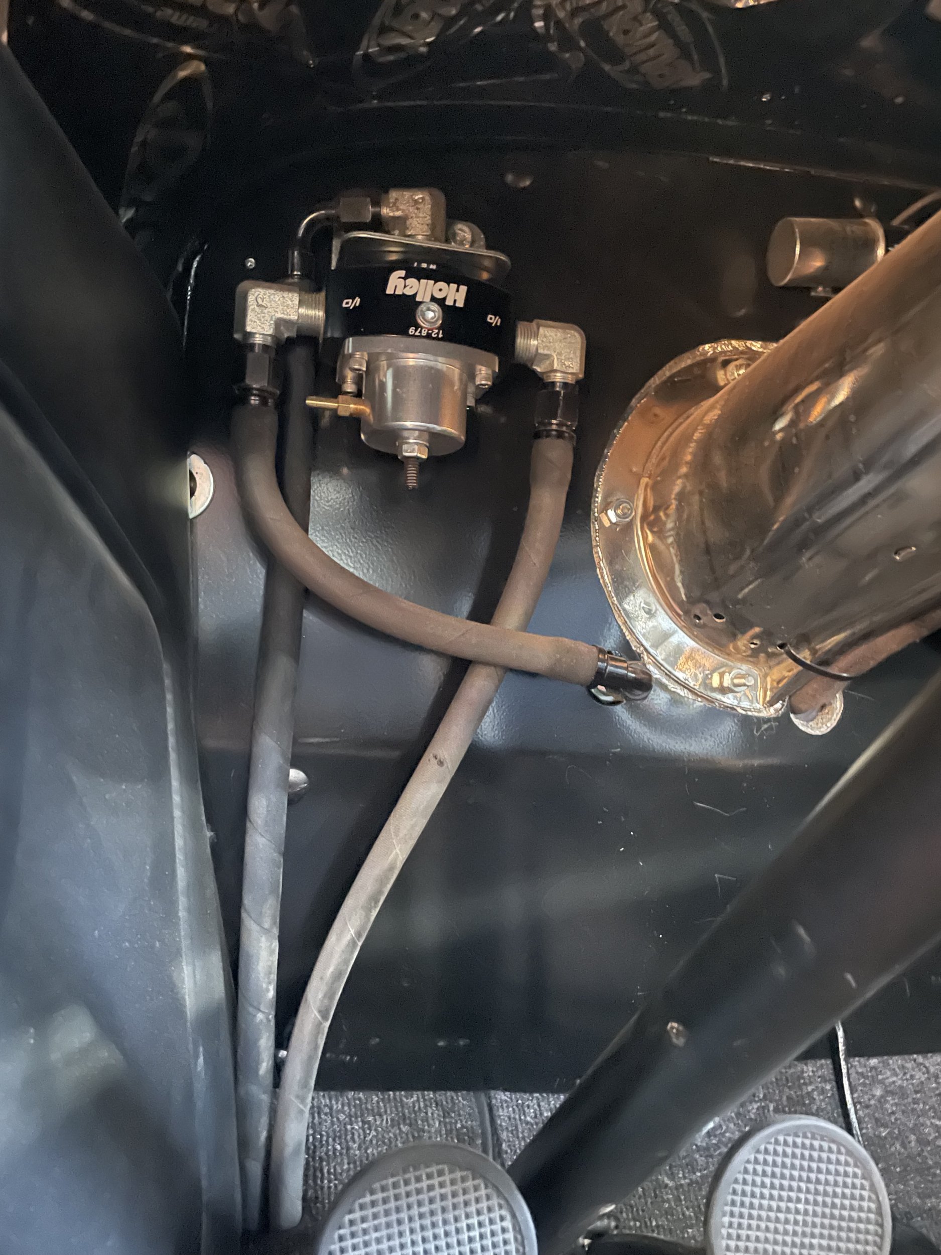

    Now I ask you , am I being too **** because I'm going to move all this fuel stuff out of the drivers compartment. Seems absolutely insane to mount the fuel lines and pressure regulator inside the car. I don't care if the car has two fire extinguishers!:eek:

    I agree terrible location for the fuel lines and regulator. Looks to be a solid '32 and with your experience will turn out great. Ron

    Amazing how nice the car looks and then we see how crazy some details are. The fuel pressure regulator being one while its a good quality Holley regulator with a byp*** to flow fuel back to the tank the location is suicide for sure.
    Mark I think its going to be a very busy winter getting things up to your standards. ;)

    This fuel situation floored me. Certainly goes in the "What Were They Thinking" file.

    Can’t comprehend why the fuel stuff would be put there and wouldn’t want it that way in my car. Good call moving it!

    The work on the fuel system was done well. Also good quality parts and probably never will be an issue but I'll sleep better if I change it. That's just me.

    Yes, definitely move the fuel stuff. Are those Pushlok(tm) fittings? I see no clamps. Clean.

    There is a reason it’s called a “firewall”
    I’m not very fond of oil pressure lines being run into the cabin ether
    very kool car and will be much better when you’re all done

    Yes. Moved everything today. Besides this I cleaned up some wiring. Can't understand how you just stuff wires into the frame instead of making them the correct length.:confused: I also repaired one outside door handle and put the tumbler back in after having keys make at a locksmith. No door keys came with the car.

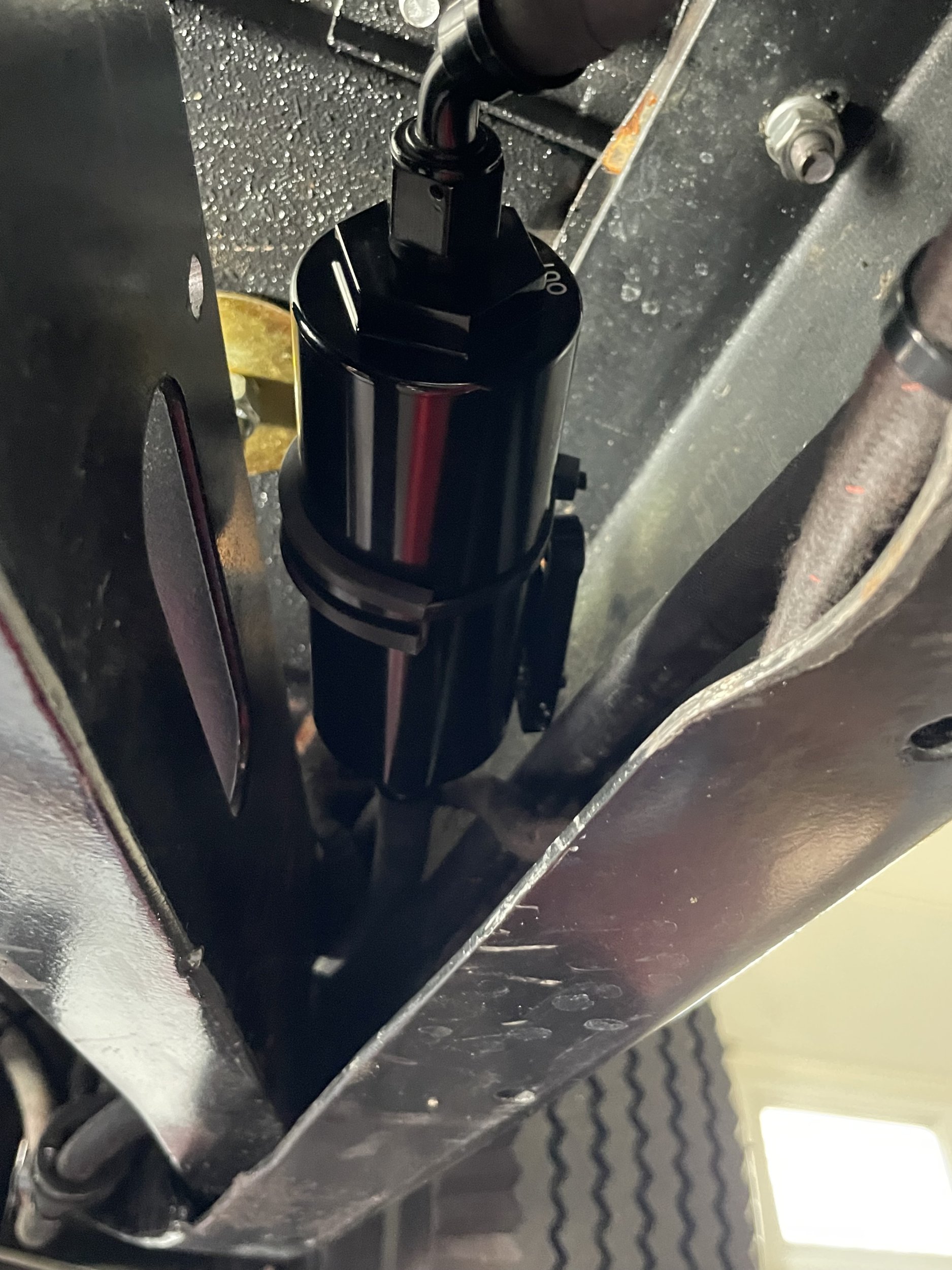

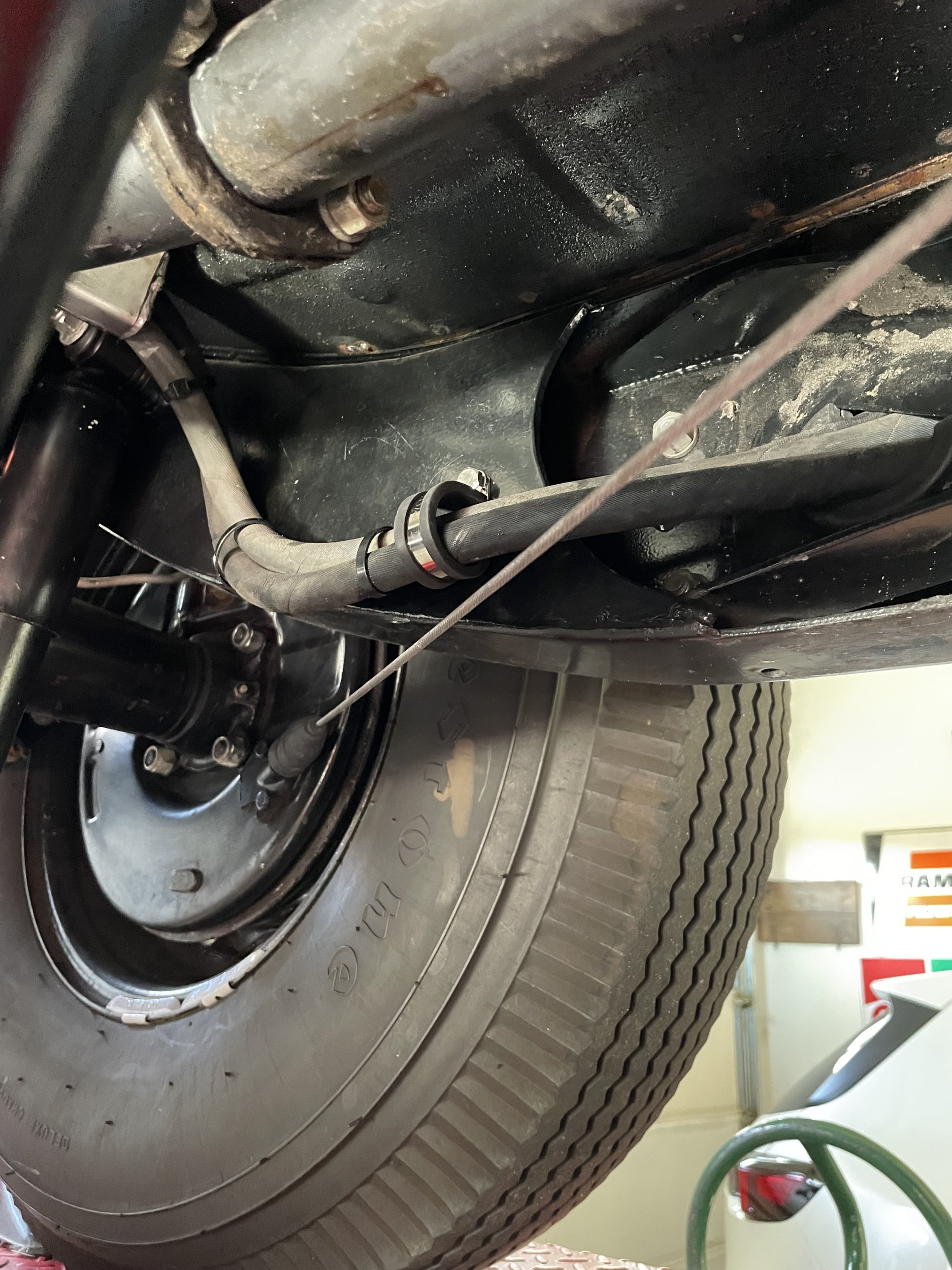

    The big item was getting those fuel lines out of the interior. Just waiting for new fuel filter with shut off valve I have on order from Hyper Racing. That way you can service filter without draining gas tank. :cool:

    Finished fuel front to back with new Hyper Racing filter that has built in shut off. Quality part for sure. :cool:

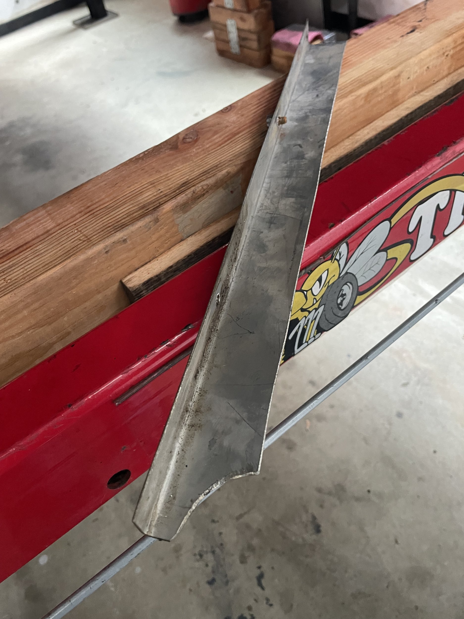

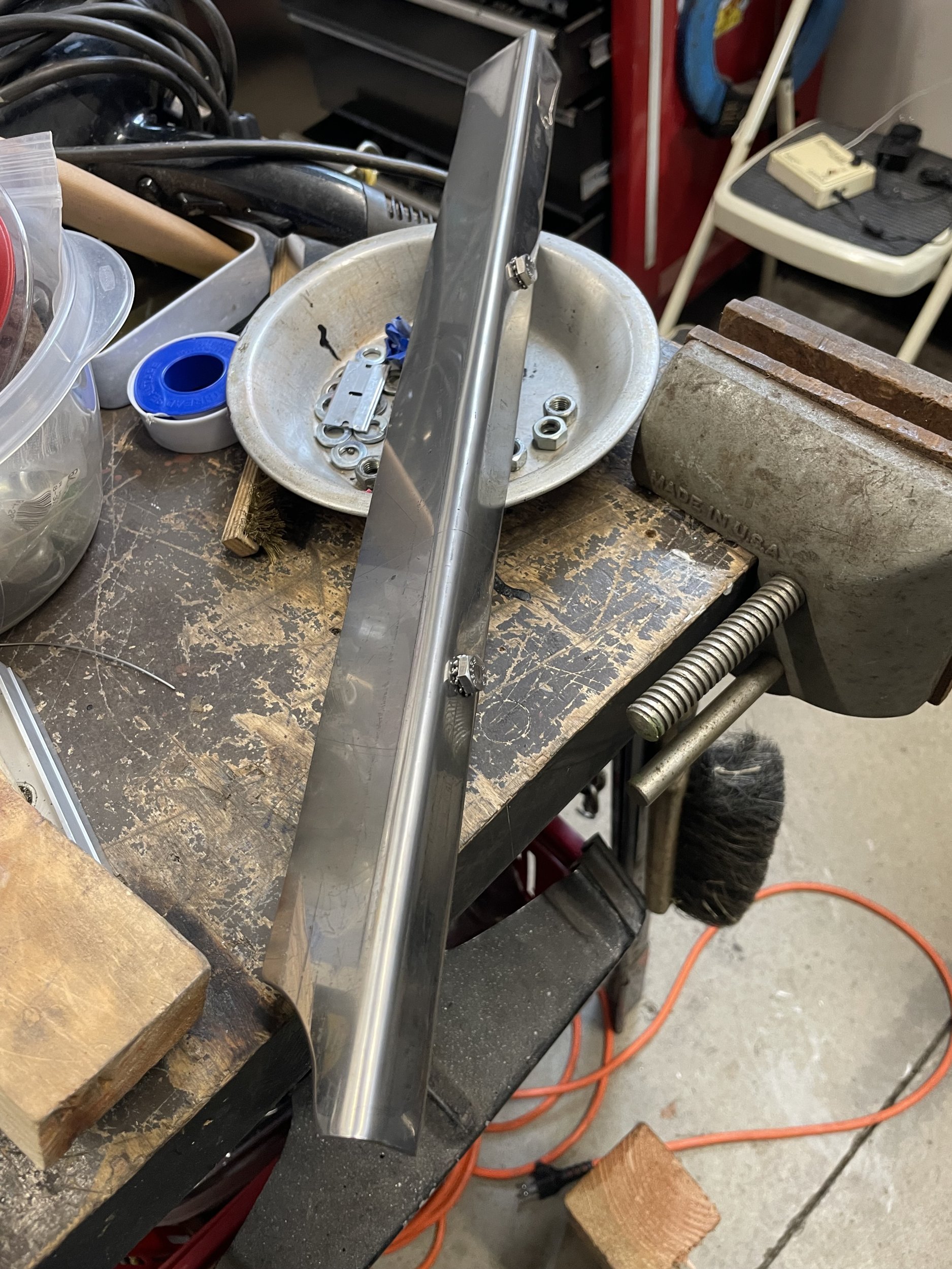

    Started making new rear hold down brackets and welding up numerous holes on top of frame and drilled the ones needed. Looked like they drilled holes wherever ?? IMG_9217.jpeg IMG_9218.jpeg IMG_9219.jpeg IMG_9223.jpeg

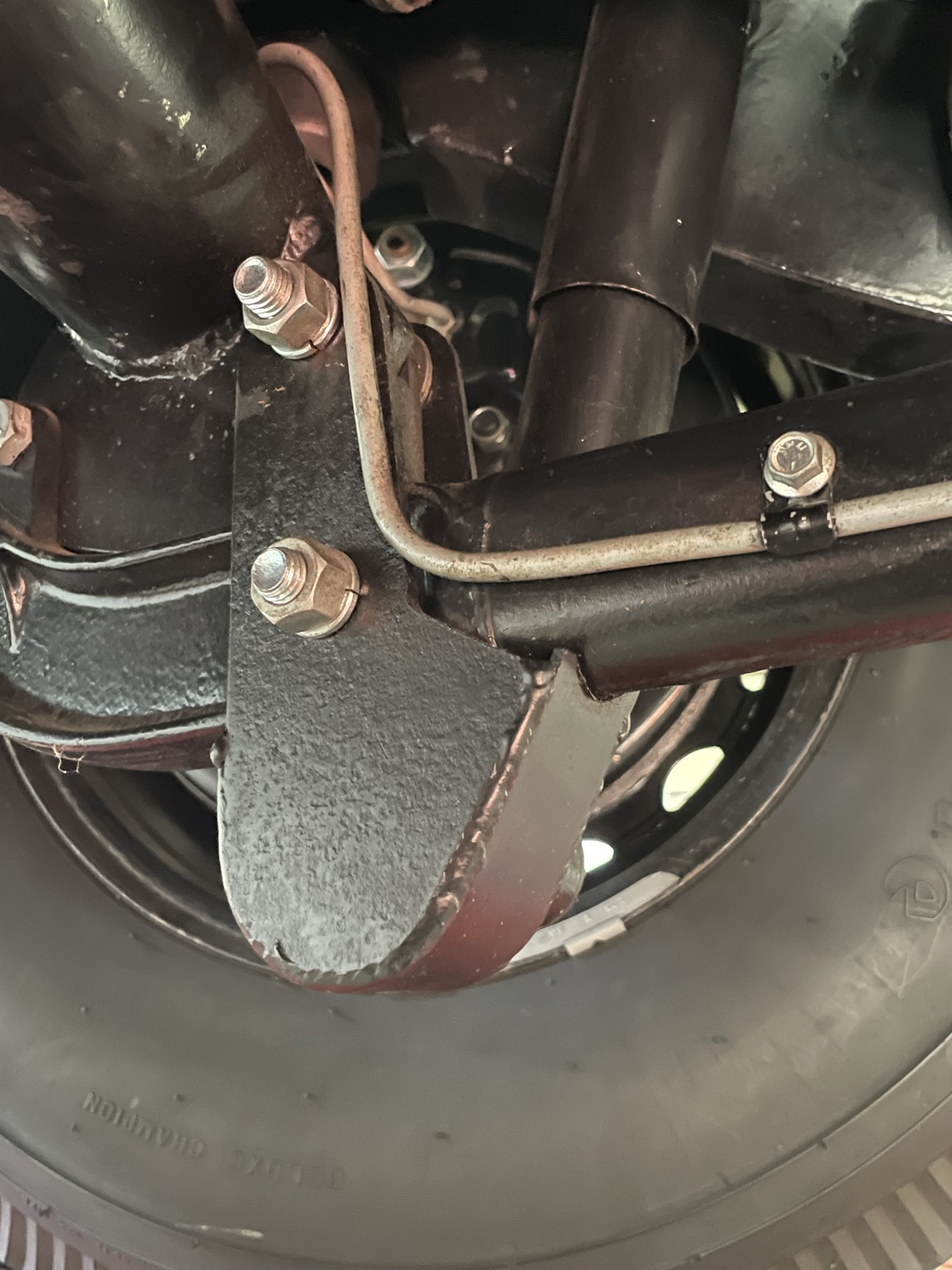

    Also finished rear shocks. New simple design with shorter shocks. IMG_9268.jpeg IMG_9267.jpeg
