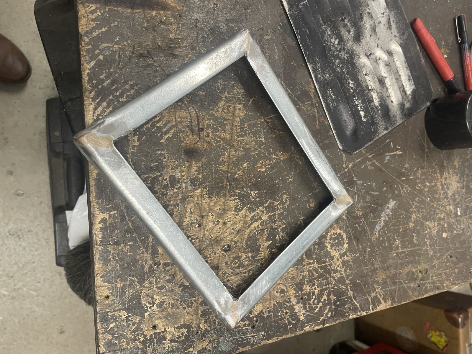

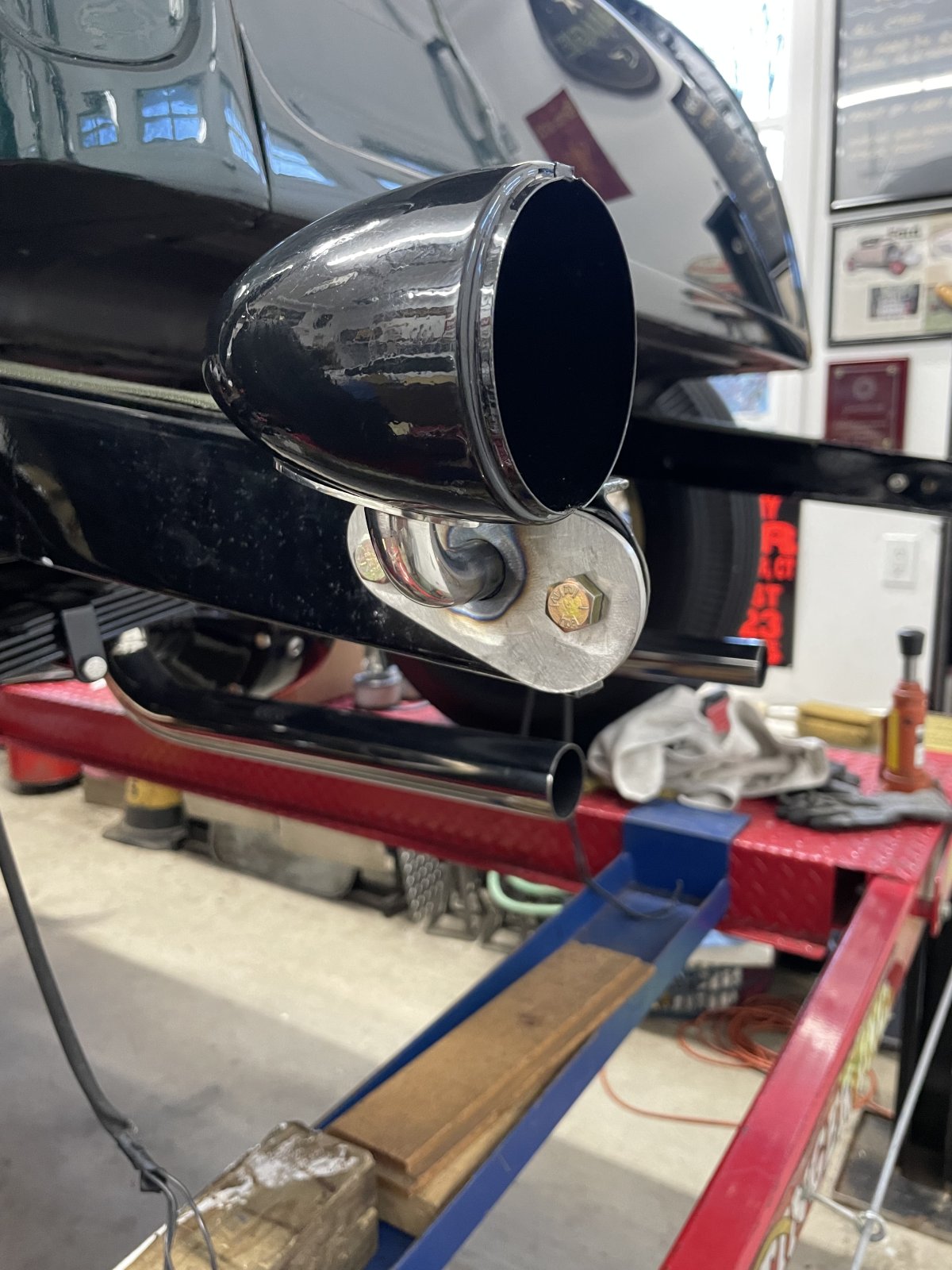

  10. ct1932ford
    Joined: Dec 3, 2010
    Posts: 13,499
    ct1932ford
    IMG_5507.jpeg 72134173675__B6EF87D3-7B66-440A-A7BE-B6A533CC70CE.jpeg IMG_5515.jpeg IMG_5514.jpeg Made a bracket for fuel tank safety vent check valve today, also made tail light brackets and mounted front headlight bar that I finished painting. IMG_5508.jpeg IMG_5510.jpeg

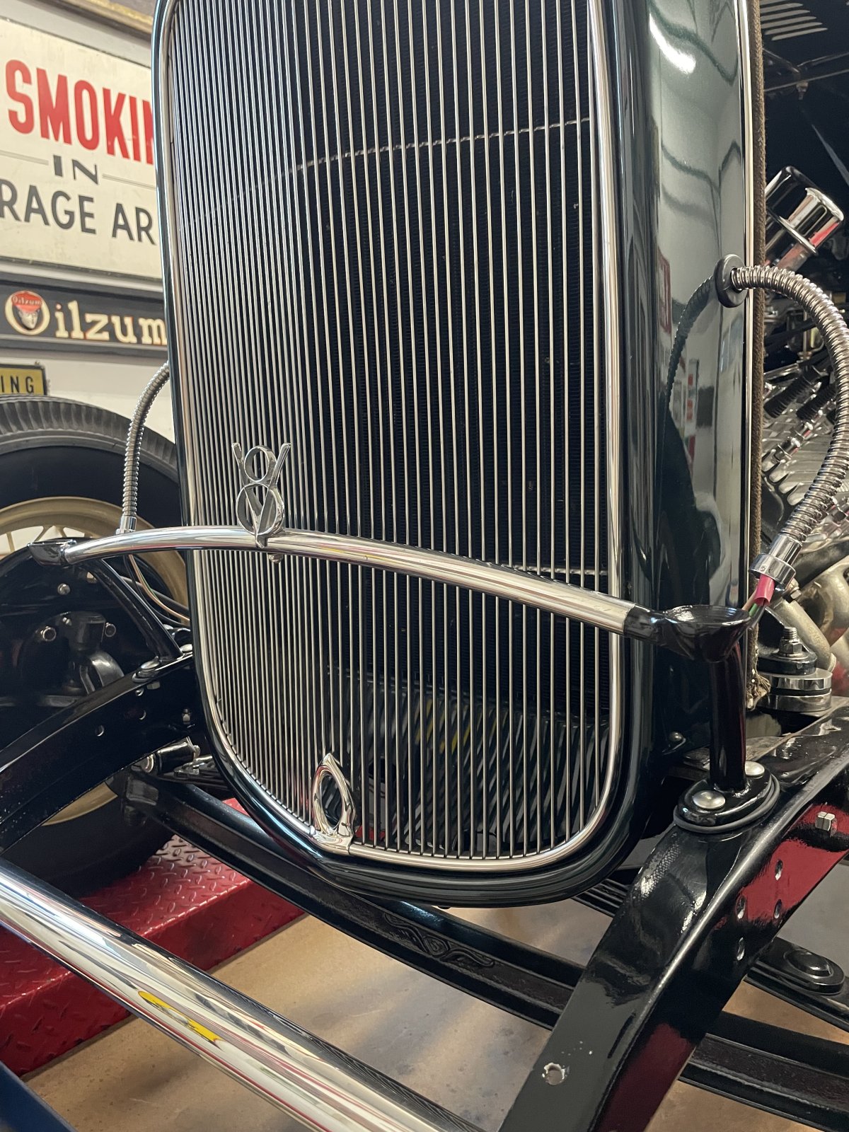

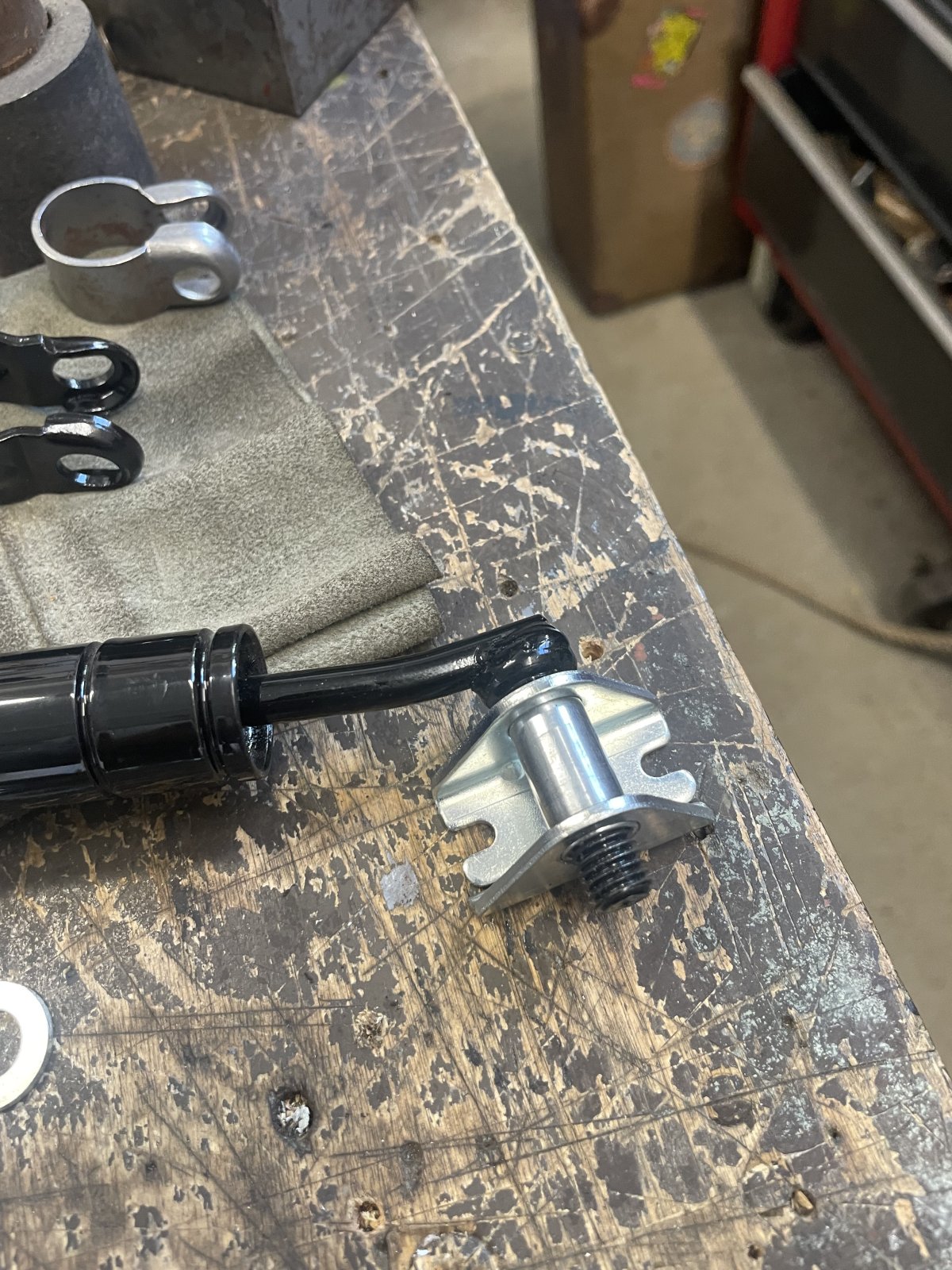

  17. ct1932ford
    Joined: Dec 3, 2010
    Posts: 13,499
    ct1932ford

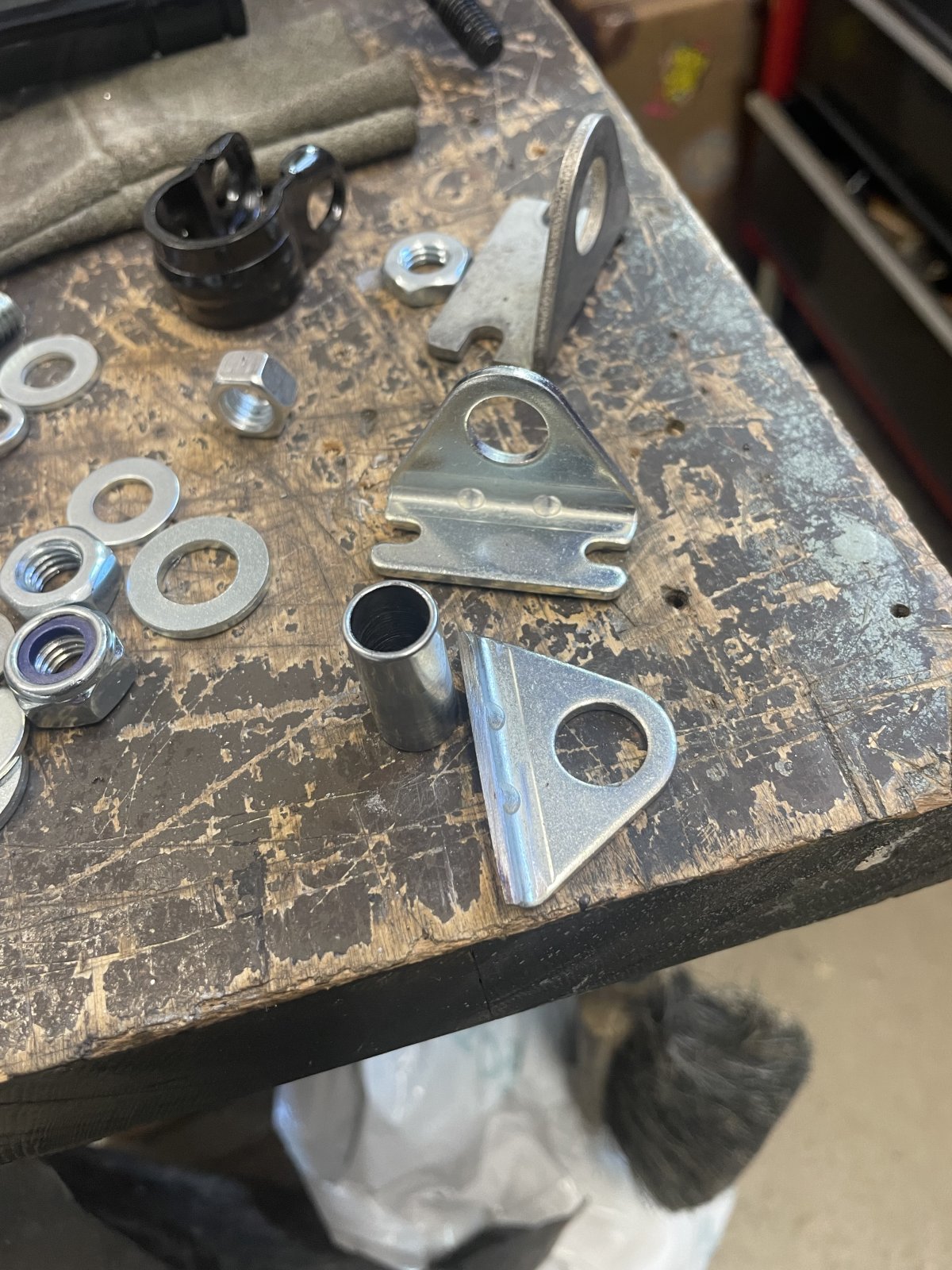

    Working on several things at the same time. Finished off brake lines. Just waiting for tank to be painted.
    Started on front end damper. This car did not seem to need one , but I think the steering will feel a bit firmer. Anyway, I always use one. Working on my signature mounting bracket. IMG_5522.jpeg IMG_5523.jpeg IMG_5524.jpeg

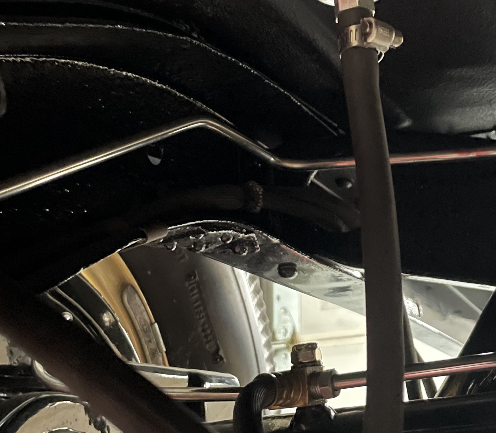

  21. ct1932ford
    Joined: Dec 3, 2010
    Posts: 13,499
    ct1932ford
    When you buy a car sight unseen you usually get some things that are expected and some things that make no sense. This car is no exception.
    Nice body on car and then the inside of the doors were a mess. So, I completely redo them.
    The frame all finished and painted nice , yet the bump stops on frame over rear axle we’re just hammered flat and painted over. I cut the rivets clean and paint area and install new ones.
    I’m not complaining, I just don’t understand some building practices.
    Back to my upgrades etc..
    Besides bump stops this week I finished steering damper, and started battery holder.
    The battery mount on this car was another not so nice job. With the cut off switch having to be cut into pieces in order to remove it. Must have been installed prior to installing body on frame. :eek: IMG_5510.jpeg IMG_5532.jpeg IMG_5535.jpeg IMG_5537.jpeg IMG_5538.jpeg

  26. 19Eddy30
    Joined: Mar 27, 2011
    Posts: 5,149
    19Eddy30
    from VA
    just asking , Having the vent under , No gas fumes circulating back into ****pit? When I had my vent under both Duces
    Fenders & non with loop ,gas smell , So I ran Vent in side rail upper side about 1 inch before end ,
  27. ct1932ford
    Joined: Dec 3, 2010
    Posts: 13,499
    ct1932ford
    We shall see. That rollover check valve needs to be higher than the tank. That is as high a spot as I have unless I put it in the trunk :eek:
    That ain’t happening.

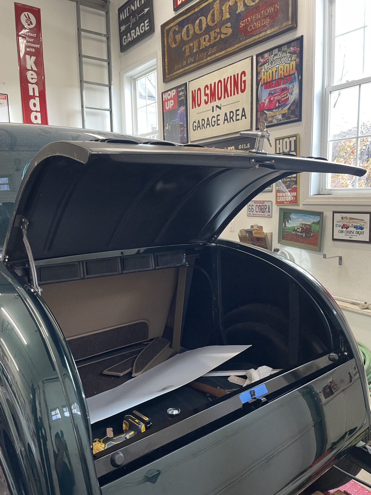

    Mounted new kill switch. Will have carpet binding done this week for switch cutout.
    Working on mounting battery. Here is on picture. It will make more sense when you see it finished. I promise :rolleyes: IMG_5537.jpeg IMG_5538.jpeg IMG_5542.jpeg
